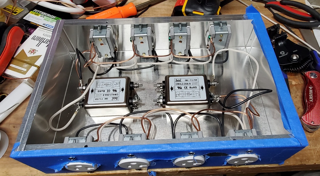

I know my house has electrical issues, add to that many receptacle's per breaker, 2 outlets for my entire audio system and so on I thought may be my system could benefit from a line conditioner. Did a bit of looking, built what is known as the Hagerman. I simply cannot believe how much better the sound imaging is. Sounds so much more holographic. In my rooms sweet spot, the sound is all around me, and NOT just from 2 definite points in front of me.

Yea, I have read this as well many times. Hard to quantify until/unless you are the one who can enjoy the improvement. Often times the touted benefits in real life are barley noticeable, if at all. For me, this was huge. I guess the degree of richness and warmth (what I have missed so dearly) that I hear was NOT expected to be so outstanding..

I used 2 of the following...
https://www.amazon.com/gp/product/B073MCGBP5/ref=ppx_yo_dt_b_asin_title_o03_s01?ie=UTF8&psc=1
And for receptacles used something like...
White Round 20A Single Electrical Receptacle
Lastly, the IEC connector I used is rated at 15Amps.
Simple hole saw, through the chassis... (If you want better holes back with some lumber clamped in place....
The NEXT one I build will use hookup wire that can be twisted reasonably easily, what I had on hand was 12 gauge solid and very stiff, so wound up not beating my self to death trying to twist it. After hearing how damn well it sounds, I wish I went all out...

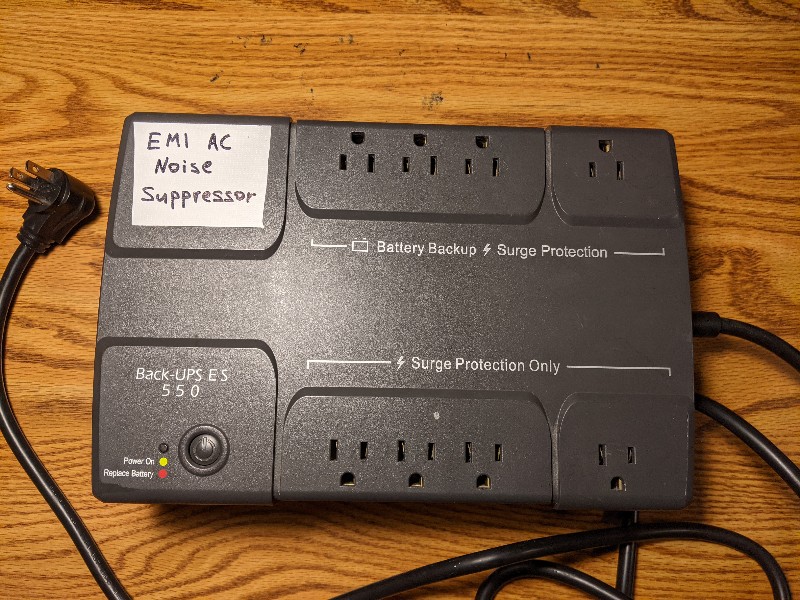

I was curious to try the EMI filter AudioFanMan posted a link to, and low and behold it arrived today from the online superstore. I had a broken UPS lying around waiting to be recycled, so I gutted and re-used it as a temporary enclosure with the built-in AC sockets. A few 12 AWG wires and an hour later I plugged my trusty DYI KT88 amp into the new "EMI suppressor", cranked the volume all the way up with the preamp off... and I believe the small amount of AC noise that in the past got into the signal path and was amplified at very high volumes so you could really hear it, was gone! I need more time for proper testing, but for now I declare it $16 well spent! 🙂
