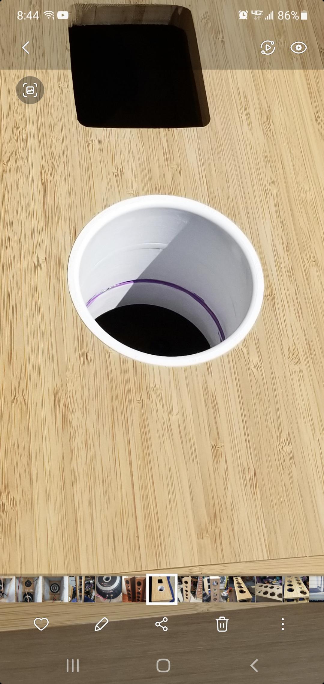

Thanks for all the great responses - I have nailed down where to source all the parts except the 90mm ID PVC tubes in the US. The only suitable candidate I can find is this: CANTEX Mfr#: 6141630 3" PVC Conduit Coupling 3-7/8" (98.425mm) long, 3.5" (88.9mm) ID X 4" (101.6mm) OD with a stopper ring in the middle. They are available locally in any HD stores for $2.70 each. I assume I will need to cut down that stopper with a utility blade somehow. Would these couplings work OK for the ports (or are there any other ideas except from buying the metric PVC tubes internationally)?
I took 2 3" pvc couplings, hogged ouy the stops in the center and glued together, than cutting to length.. i used the porth length calculator available in this thread somewhere, and added 1/4" for good measure (i also fabbed another with 1/2" to be safe)

Scott, that Ebay option for the flared port tube does look good. Is this what you used in your build? If so, to what length did you cut it down? I assume because of the flare at one end, the total length would be 100mm + some portion of the flare length (may be ~1/2 of the flare length). I know that one can measure the actual tuning frequency and adjust the port, but wanted to know if you already have done the work.

Just to clarify, 75mm cardboard tube length did not include the plastic flare length, correct? I think my build will be quite similar to yours, as I like your suggestions for the internal damping material(s), 20mH crossover coil and now the port tube. Appreciate all the recommendations, Scott!
