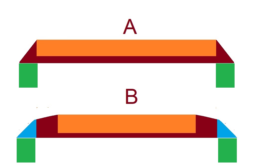

It was said few posts back only minimal chamfer on elsinores because of diffraction. Maybe you could get that kind of chamfer if you make speaker bigger so the front baffle stays the same size?
I think there was a build where the front baffle was 14mm wider than specs and they put a chamfer on it to bring it back to 11" (280mm). Not sure how that affects the BSC that Joe has built in.
Compound chamfer on baffle
What I have in mind is something like Baffle B.
Will not be easy though...
Baffle A is easier, but Baffle B would be a superior option?
While some might say that the steeper slopes on Baffle A can make the baffle a tad narrower and affect BSC designed in the XO, would the gentle slopes of Baffle B maintain the "full baffle width" and hence no adjustment to BSC would be required (in theory)?

I can understand your plan for the baffle shape well. I also made a lot of considerations and then rejected them. Joe has pointed out several times that the baffle width should remain unchanged and only a maximum radius of R6.2 is unproblematic. In addition, there was the recommendation that only a change in the depth of the case is unproblematic, for example if a different wood thickness is used to adjust the case volume. I think your Form B and additional distribution of the box not only lead to a change in the BSC but also the edge diffraction, which can only be corrected with precise measurements and adjustment of the crossover, with the hope that this does not affect the overall concept of the crossover.
better not do this and stick to the recommendations. take a look at engelholmaudio.com. the design of the floorstanding loudspeakers is perhaps a good alternative for building the elsinöre which I like very much and which keeps the deviations very small ... (I hope so)
best regards Steff
The Elsinore's crossover does not include any such attempt, so I see this as moot (without prejudice as to the whys and wherefores).
The facts are that..
A radius of 6.2mm is small, and has an operating band beyond the range of hearing for many of us, so is of little help.
Reduction of diffraction, as pertains to conventional designs, is generally considered a good thing. The higher frequency edge diffraction you mention is of particular interest due to its various concerns with audibility, and it is relatively easy to round over a baffle making this band a likely target of such efforts.
The idea of modifying the baffle step frequency has not been shut down in this thread that I'm aware of. As has been mentioned the 2.5 way type of crossover is easy to modify for a change in BSC, and besides.. zman01 has only expressed an interest in a small change, so the workload should be minimal, if necessary.

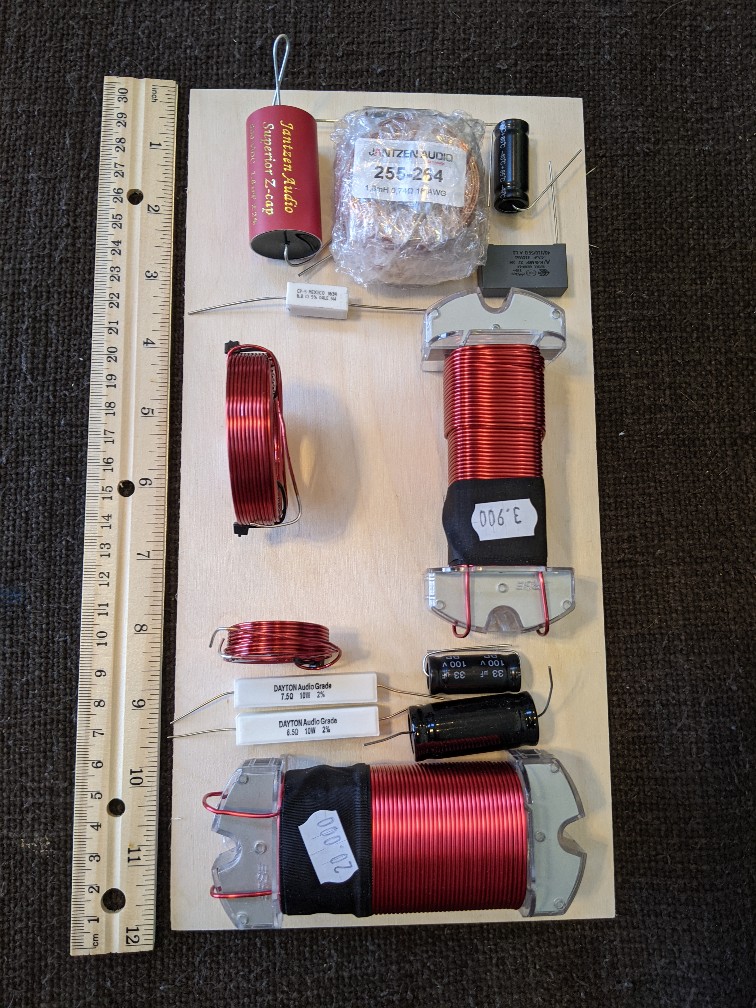

I would like to place the crossover into a 4" pedestal under the actual speaker cabinet, and so I am trying to squeeze the crossover parts onto a 6"x12" board. The 0.1 and 1mH coils are on their sides. I would appreciate any comments if there is anything wrong with the layout in the picture below. Thanks!
918561d1612403076-elsinore-project-thread-baffle-width-chamfers-jpg
We have done the 1st often and the 2nd turned into the Ellipsa And a set of curved Pensils). The more segments you add the closer it gets to a smooth curve.
I have been following the round over conversation with interest. My understanding is that at the frequencies involved, a chamfer needs to be quite large have an affect at lower frequencies and will only make response higher than it is effective will be smoother and have less time-smeared and physically distanced pertebation to the direct radiation.
If one wants to know the affect of 20mm increase in width…
BS(-3) ~ 4560/width (an imperial equation, width is in inches).
Add 20mm (0.78”) to the width and you will see how much.
305 Hz vrs 298 Hz. about 5%. Less than the tolerances in the XO.

The idea is that the inductors create a magnetic field, that field can induce current in nearby inductors. The 2nd post above I believe talks about hooking up anything that can create a signal to one inductor and hooking up a speaker or headphones to another inductor. By simply moving them around, you will get a hear the phenomenon and get a feeling of what placement creates the least amount. I was very surprised to learn that pivoting one inductor even a very small amount reduces the cross talk significantly. This exercise is simple to try and tremendously insightful.
That said, I know some here are VERY familiar with what works well, if your not going to try as mentioned, may be someone else here can fill in any gaps...
