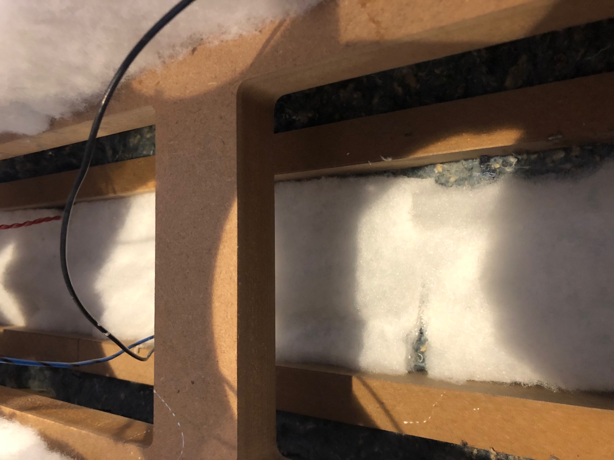

I also saw your earlier post about using the Ultratouch denim insulation (50mm / 2" thick) sourced from Home Depot, and bonded Dacron (25mm / 1" thick) sourced from Meniscus Audio for internal damping. Did you end up using just Dacron in the front, and a combination of the Ultratouch & Dacron in the back?
I find that the Ultratouch insulation produced quite a bit of dust inside the enclosures in another speaker project I did, but maybe with Dacton on top of it, it will be less prone to sending particles into the air.
Aa007:
Exactly! The Meniscus-sourced 1" Dacron was used on the sides and on top of the 2" Ultratouch on the rear. I wasn't aware of any dust issues with the Ultratouch; it just happened that we covered the Ultratouch with the Dacron.
Good luck with your build!
