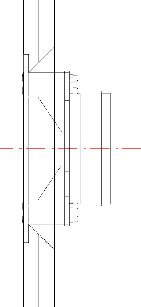

We tend to use a BIG 45° bevel on the inside of the circular cutout if we do a double thick baffle...
May be I had a longer day than I thought...
Not certain... no strike that, Im pretty positive I don't understand that response...

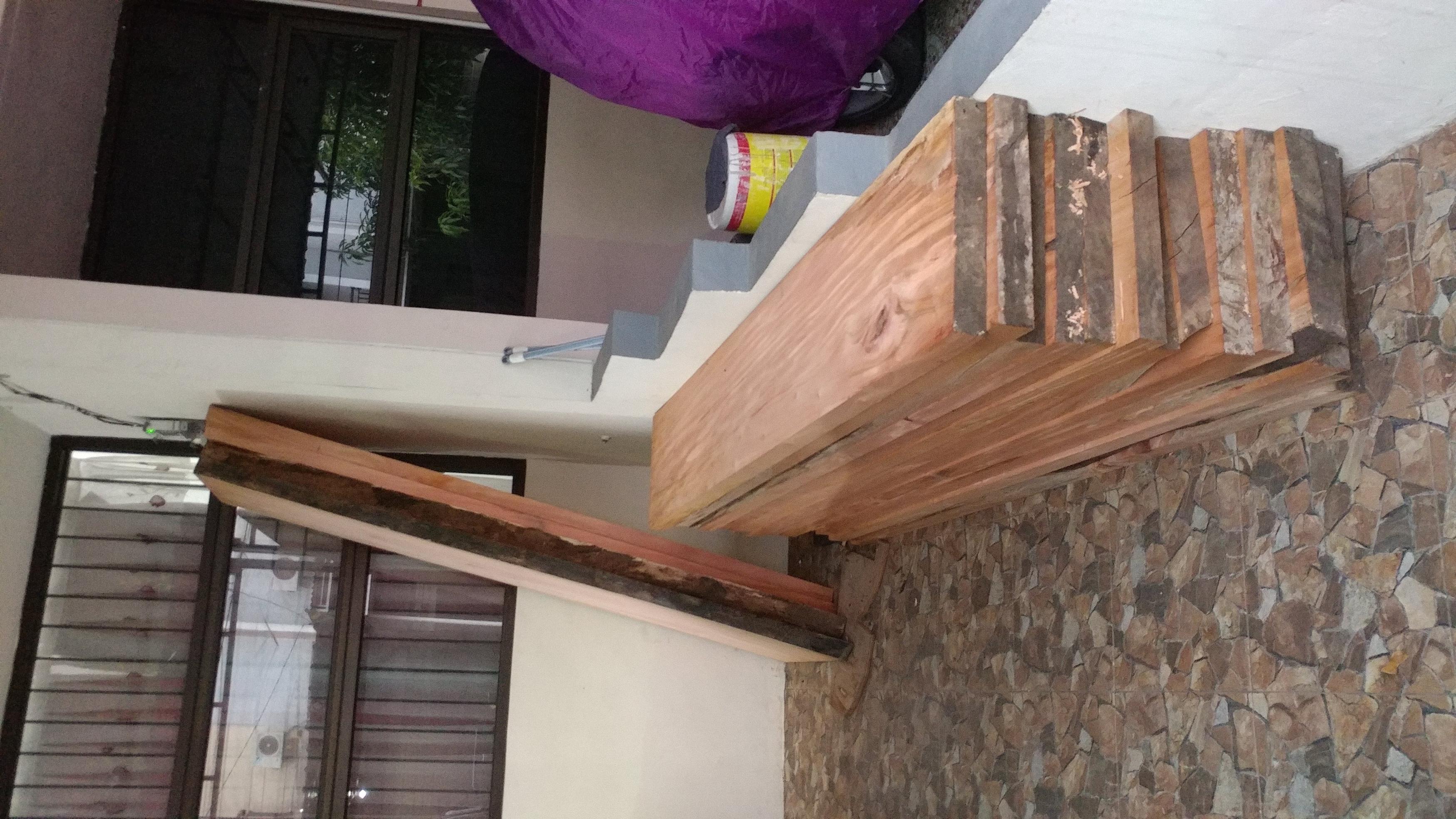

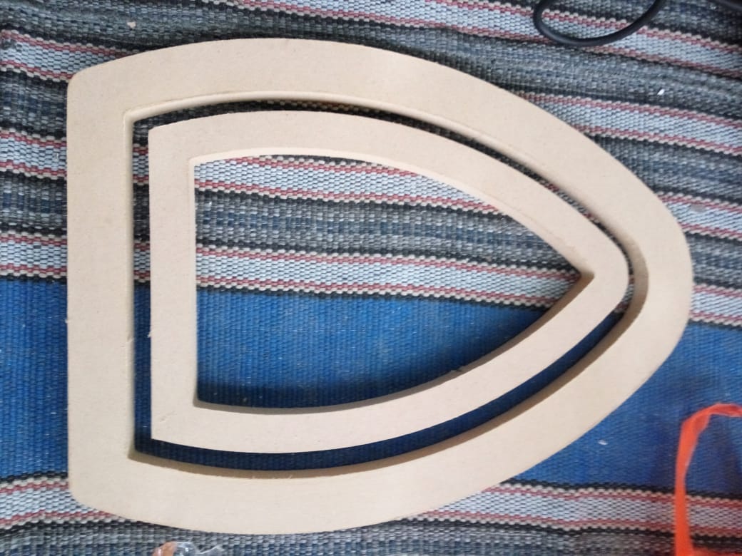

wood arrived at my home, i started to think on how to chamfer routing on driver holes with 35mm thick wall. or just leave it circled?
i also ordered smaller template with 25mm thickness that can be utilized for bookshelf someday

Circle cutouts inherently provide more strength than square cutouts, was thinking about changing the rear main panel as shown...
Anyone care to give me opinions either way ?
There are basically two reasons, the irregular shape it gives to the combined front panel (two pieces) distributes the potential frequencies that it can ring (everything rings, the sound you get from tapping any material is basically ringing) and the other is that the rear of the driver radiation is better into the box and that part of it being irregular also plays a part as the spreads out the frequencies. You could indeed round chamfer it as well, but that is still a single radius that will show up at a single frequency. Like all things nothing is perfect, but the simple technique employed in the Elsinores is quite effective. Keep in mind that the idea that even if only using basic MDF, it would still be a good performance.

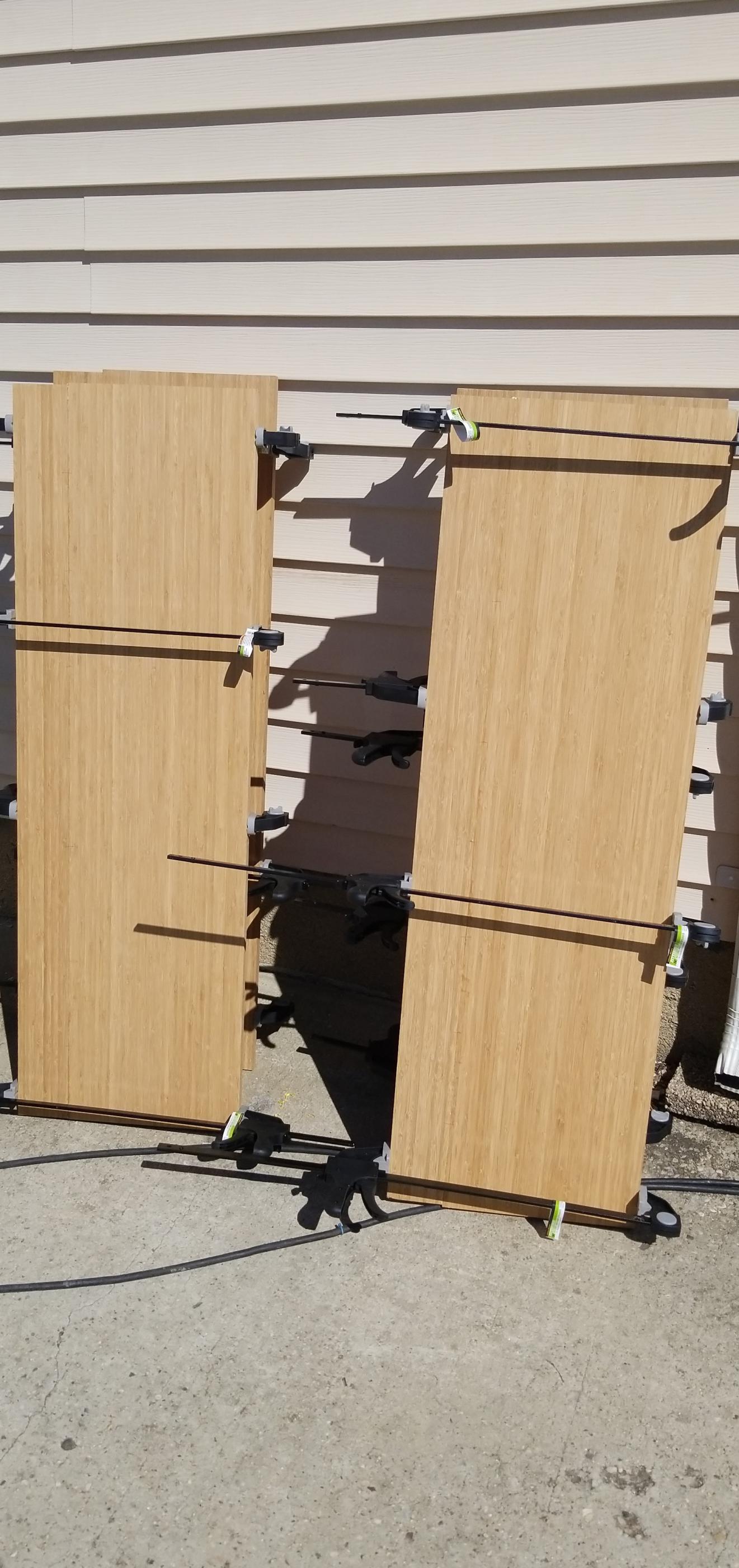

Yes, 1x12 bamboo board, shown is stretched 1x12 (lol) 15.5" wide by 48"
Stretched it by biscuit joiner and tight-bond!
Have 5 panels, 4 are sides and 1 for top's and bottoms.. Doing whats known as waterfall construction. Grain of wood on largest dim's follow up the sides, across the top, back down and under...
The 15" wide panels represent enough movement..
As a highly scientific test, I took two cut offs, that measured almost exactly the same, 1 was 1.080 and the other 1.082...
Put one in a cup of water, nearly 24 hours later it measures 1.090
So, it grew 8 thou when soaking wet. Dont imagine it could get much wetter.
In comparison the second block was placed on a warm surface (Laptop power supply) for almost 24 hours now measures 1.076 or a reduction of 4 thou...
Even if I take the difference, of the two, add them its .012
Since the samples were almost 1" to begin, multiply by 15 and I get a whopping .180 or a hair under 3/16" Since I dont plan on submerging these anytime soon, Id say thats pretty dang stable.
That said, I don't think the planned MDF interior lining will move in those directions. Even if the width changes by 1/2 of the .180 in normal situations or .090, it still could grenade the bamboo so allowances must be figured for movement... Fun times... 😉

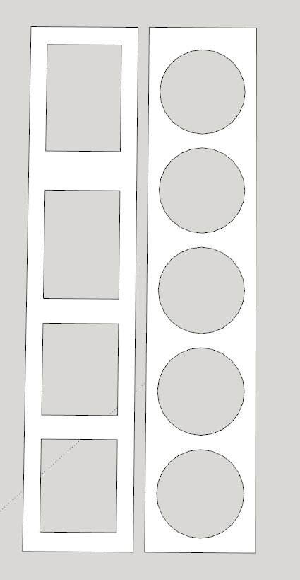

The cutout on the left (purty close to Joes org design) has cutouts measuring 1.42 Sq ft.
My idea, shows a total area of 1.36 Sq ft (cut out).
That said, I'd still bet a McDonald's Dinner that my drawing as shown would be stiffer..
But the real question is 2 fold. Would Joe approve (Nothing but respect and love!) and would it amount to anything measurable..
