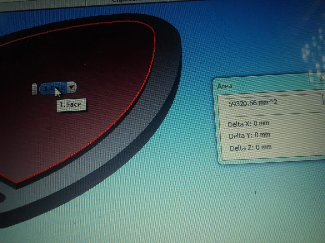

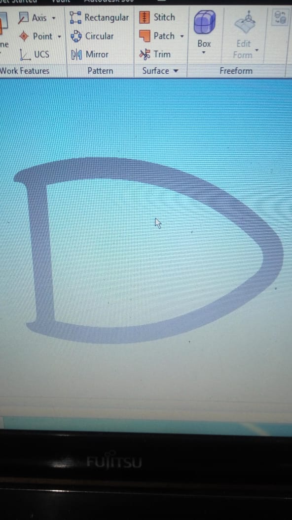

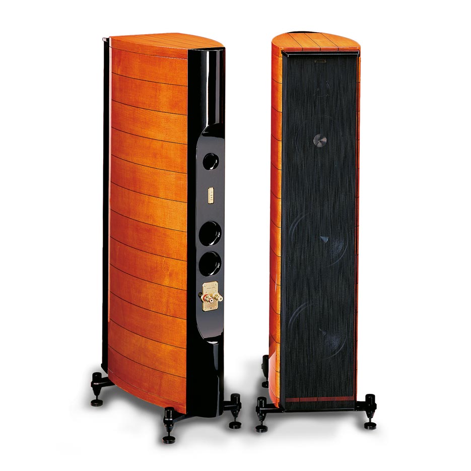

for a long time i had a wish to clone SonusFaber floorstand and i think Elsinore can take that shape, but i'd like to get opinions on this curved box by keeping same internal volume. is it a go or not?
i'll order the box to my friend with cnc service, built-in waveguide with green mdf which is claimed more durable. either original Elsinores box in red paint or curved like SF

Go for it!
Just make sure to keep the baffle dimensions, driver positions on the baffle, and box volume as specified in the Elsinore drawings.
sure i just ordered cutting template, overall 30mm width. this will cost me around 5 sheets of plywood for stereo build. 10cm extra base + another 10cm on top will be incorporated in my build because with original height, i'm short of around 10L internal volume

Go for it!
Particularly the width of the front panel, try not to make it too narrow and as close to 280mm wide as possible. It is about not shifting the tonal balance to much due to diffraction loss that affects the lower midrange (the transition from 2Pi to 4Pi). There are more than one kind of diffraction type involved, but basically keep things flush and not major change to the front of the speaker. How deep it is, that is not much of an issue.
If the baffle width ends up a lot narrower, I would suggest reducing L1 inductor to 3.5mH.
About the internal fill, line near the front panel and drivers (inside sides), and then the back of the enclosure near 50-60% fill, the material not too dense and not too close to the port. Keep the port at the rear and bottom, but I suspect you would so that anyway. Yes, there is no such thing as an entirely noiseless port.

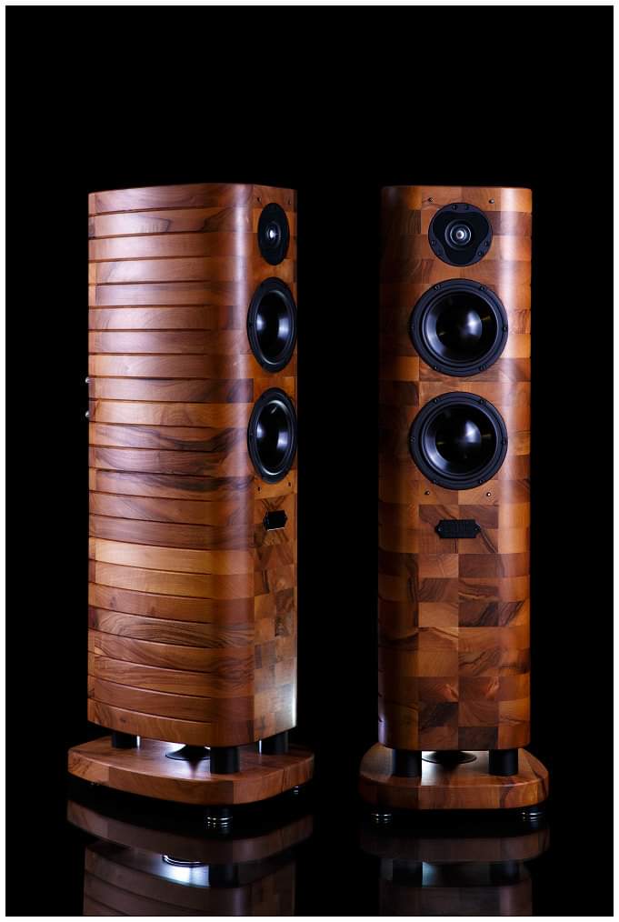

with 5 sheet of laminated plywood which will cost me around $250, i just realised with the same money i can get hardwood like mahogany/soarwood for 1 meter cubic which should be enough for Elsinore and for sure it will look much better 🙂 so my reference design just changed.
this is what i'm expecting now
attachment.php
i'm still negotiating with my colleague about working cost with cnc, my basic plan with 5cm thick wood that he cut the template up to 2cm deep and i will continue finishing with hand router, then gluing and sanding.
or another option that he will do all that dirty work 😀 i just have to justify which one is better
with this design i will use bottom port
