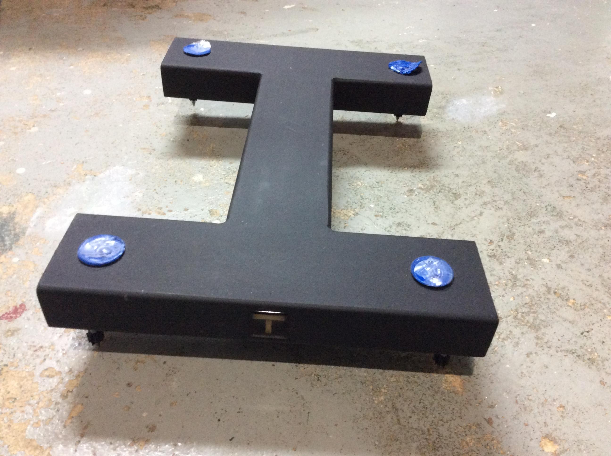

This may not appeal to you, but I had custom Sound Anchor stands made for my Elsinores. They are about 90mm tall (including spikes) and do the job quite nicely. The price was about $320 (US), delivered (albeit within the US).

As it happens, yes. I'm in the process of repositioning my Elsinores following a music room renovation, and I haven't reseated them on the stands yet. The stands exactly fit the base of my Elsinores, and the deformed blue discs on the top are sorbothane-like absorbers that Sound Anchor supplied with the stands. They do a nice job.

Thanks for sharing the pic and some details. Those stands look well made and strong.
I am thinking of housing the cross overs inside the stands (approx 10-11 cm height altogether).

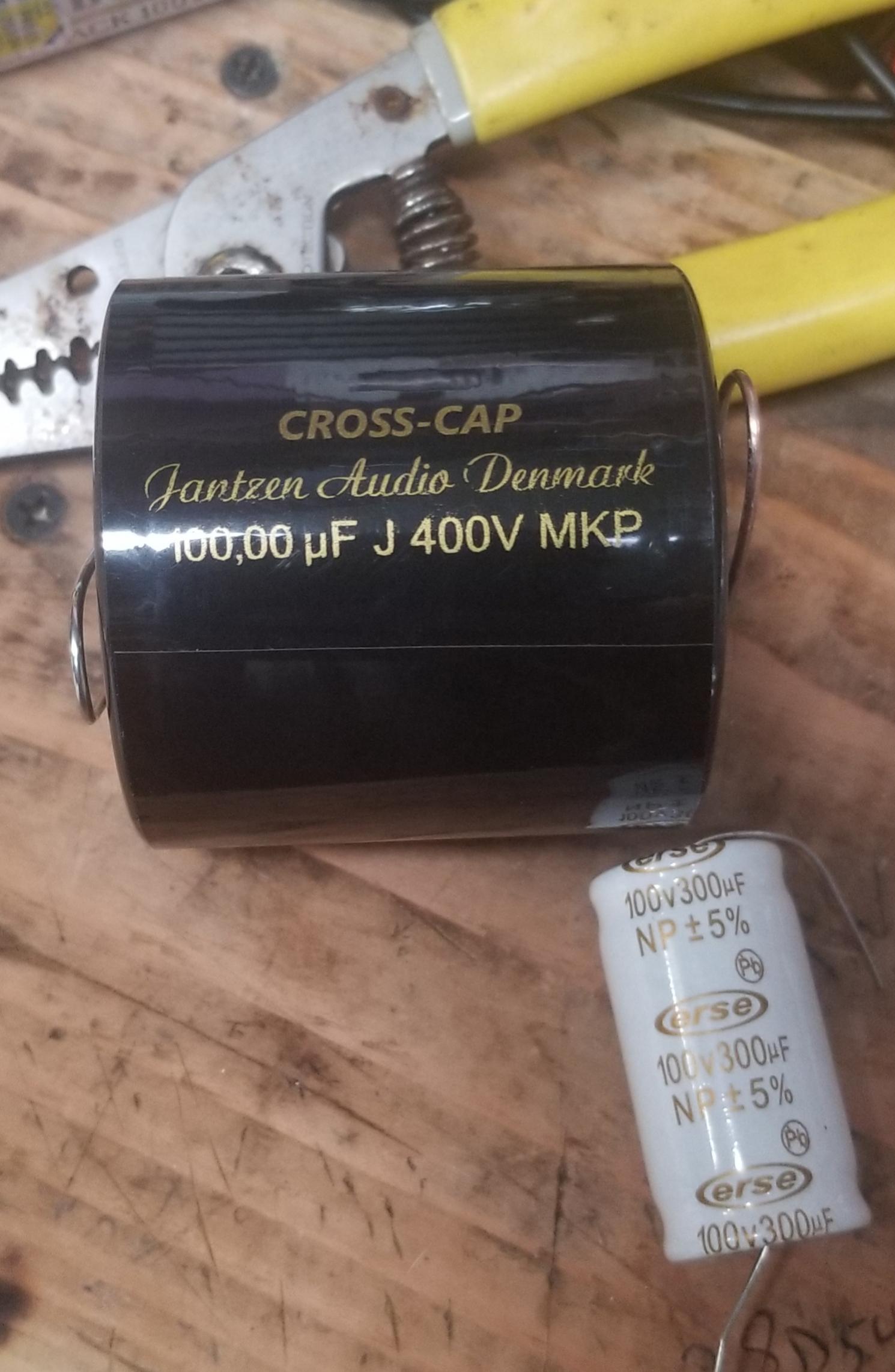

Question about caps, specifically C3, Joe specified 300uF, and in note 4 suggests that 3, 100uF or 2 150uF get used. For what ever reason on my first go around sourcing and ordering I picked up 6 Jantzen Audio 100uF 400V cross-caps and forgot to check the box for ordered in my BOM, next day i ordered 2 300uF 100V erse caps.. Deleverys all came (Wave guides look fantastic!!) And organizing I see my duplication...
Which is better to use?
