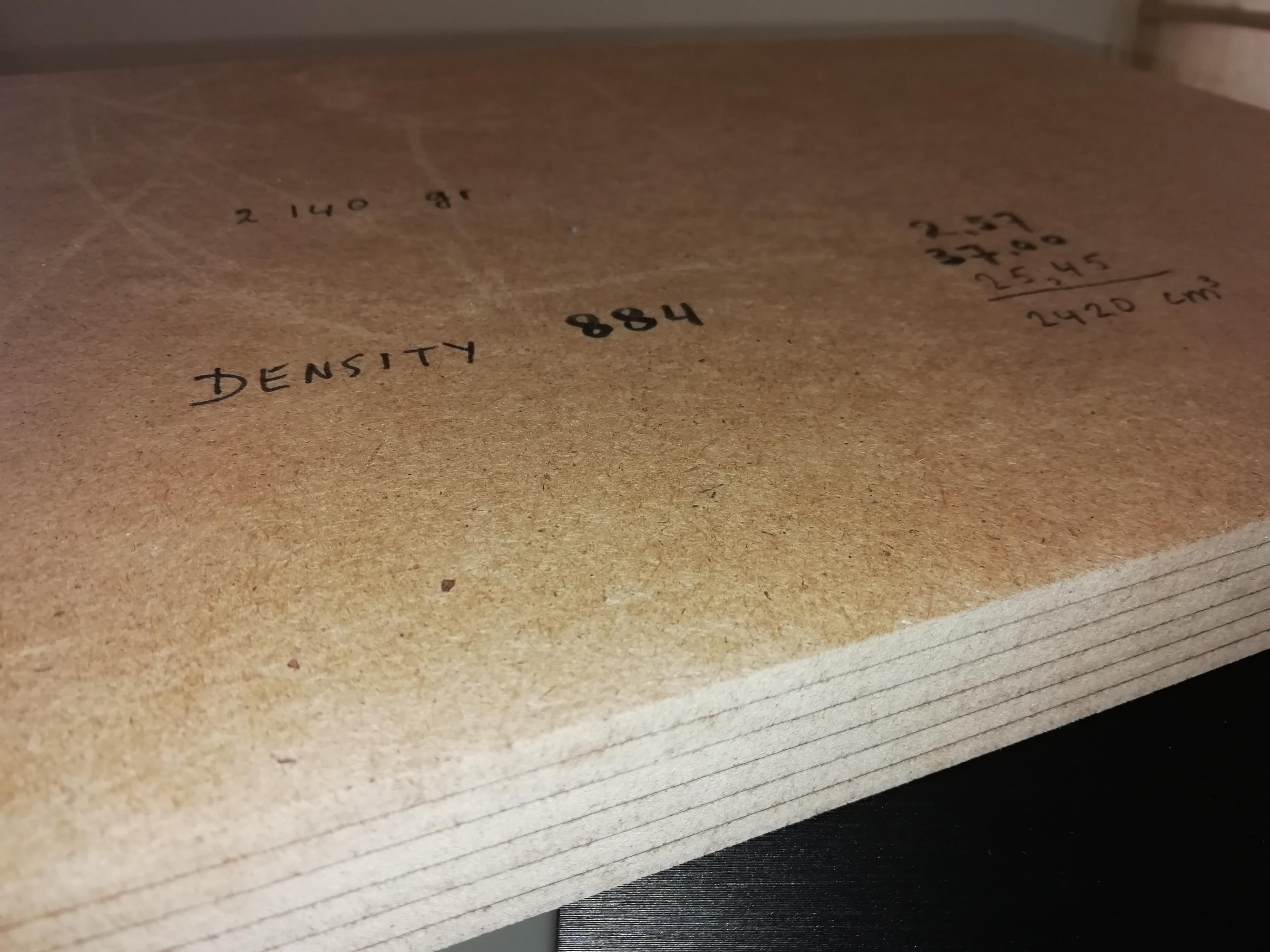

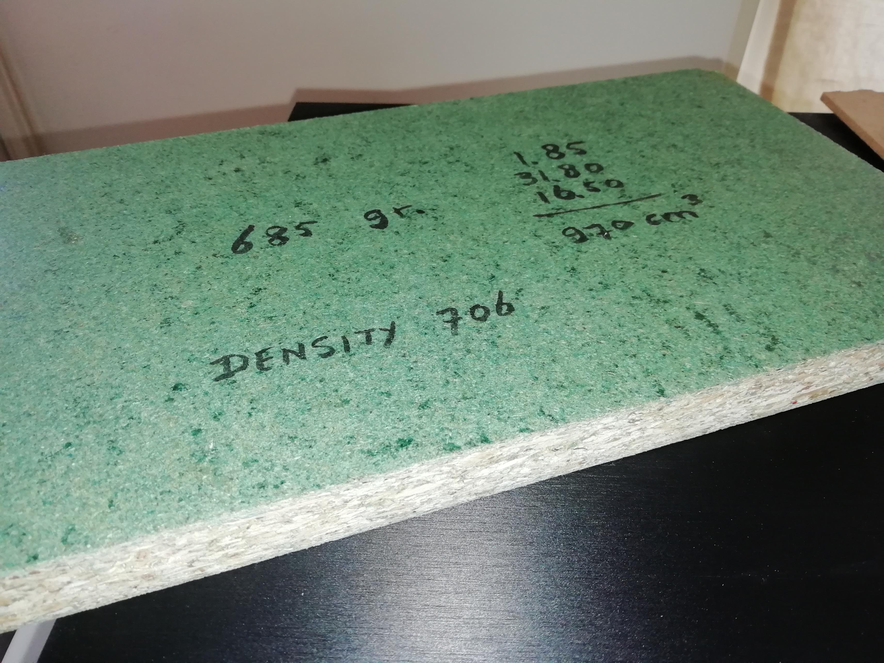

Expensive Birch ply is not necessary at all!
In my opinion (and long experience building enclosures), if you want to cut cost and get results at least as good as baltic birch ply enclosures:
- take what we call here 18 mm thick waterproof floor sheets of chipboard (see picture) for the enclosure less baffle; it is about three to four times cheaper than low grade BB, has density comparable with BB (about 700). This stuff has very hard pressed surfaces to withstand wear when used as floor. You can also apply screws into the crosscut sides (try that with MDF....);
- compose your own baffle by making a sandwich of 4 mm thick MDF sheets; this way you can make your preferred thickness. This MDF sandwich sheet has a density of almost 900 compared with some 600 of a normal MDF sheet and is very stiff!!
For the enclosure apply enough bracing, and you'll have a cost effective and very high quality enclosure for a fraction of what a BB enclosure would cost.

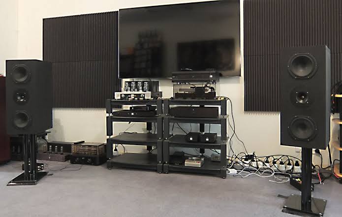

@Joe
regarding hamlet, i find this image on google and just realize that this is just small version of elsinore. my intention to use hamlet as center by positioning it on horizontal seems will have issue. am i correct? or is it possible to lay hamlet horizontally?
After finishing my Els, depending on how it went, I was going to build a Hamlet for a horizontal center but never considered if it was appropriate to lay on its side. Will be interested in hearing the answer.
Sideways MTMs. while popular for centres, do not work well. It should to be oriented vertically. For those with spec issues, a simple MT would be best.

...has density comparable with BB (about 700)...
Density is mostly irrelevant. Less dense with the same stiffness is better. Partical board/chipboard has been shown to work better than MDF, but “falls apart” easier.

For you maybe, not for me. For baffles I prefer mass and stiffness.Density is mostly irrelevant. Less dense with the same stiffness is better.
Not the floor sheet waterproof variety unless you are clumsy with woodworking.Partical board/chipboard has been shown to work better than MDF, but “falls apart” easier.
No idea what K3 chipboard stands for.I started out my speaker building with loots of K3 chipboard. Most memorable was when we dropped 5 sheets out of the back of the pickup into the middle of a major intersection n Calgary. I will not use the stuff anymore.
Like MDF, chipboard comes in a variety of qualities with respect to density and water resistancy.
Like said before by others, when the enclosure has sufficient bracing, and the material is applied properly, it just does not make a noticeable difference when using chipboard, MDF or ply. All subjective statements are just that....subjective.

@Joe
Actually, you have it right, it can be used as both. That indeed was the idea from the beginning. It can be used in three different ways, 1) as a smaller stereo pair, 2) as additional speakers if going multi-channel and 3) use as a single speaker laterally for centre channel, maybe (?) put the screen on top of it.
