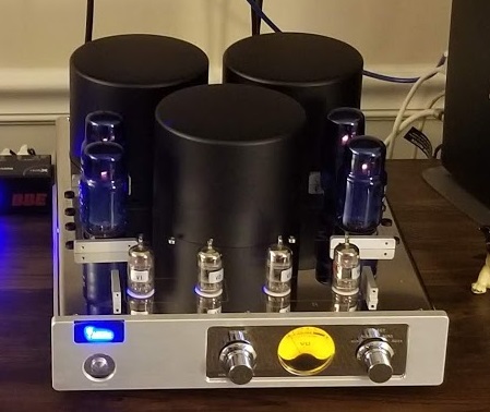

YAQIN MC-13S
I could be wrong but this amp may have a low output impedance *. Regardless, this impedance will short and thus act against variations that saturation may cause in the case that the inductor is not the preferred choice. Here is a test you can do.. listen, then disconnect L4 at one end and listen again. Is there much difference?
All the same, I might point out the opportunity due to the series resistance of 7 ohms in the crossover. This means you can use a high resistance coil (traded against the resistance itself). This can mean that an air core using smaller gauge wire is possible.
Watch the tradeoff though, the coil resistance will consume a little power. Too much could overheat it.

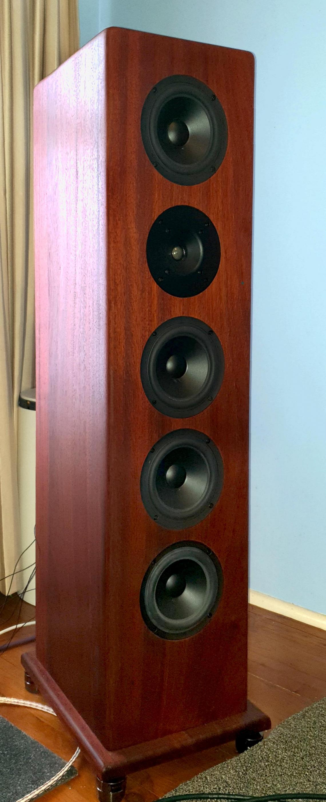

I visited Greg H. on Saturday, he has built what I believe are the most expensive Elsinores so far. It is made of Sout African hardwood called Padouk. It cost around AUD $8000 just for the boxes and near AUD $11,000 in total. They replaced a pair of speakers made in Denmark that retails for AUD $83,000 - you might have fun guessing what it is and a hint is that it uses a very expensive ribbon tweeter. They are now for sale on consignment with a major hi-fi shop in Sydney. Greg sums up the Elsinores as "they do EVERYTHING!" and that is a common refrain.
Take a look below, the photo does not give full justice, but hope you like it:
