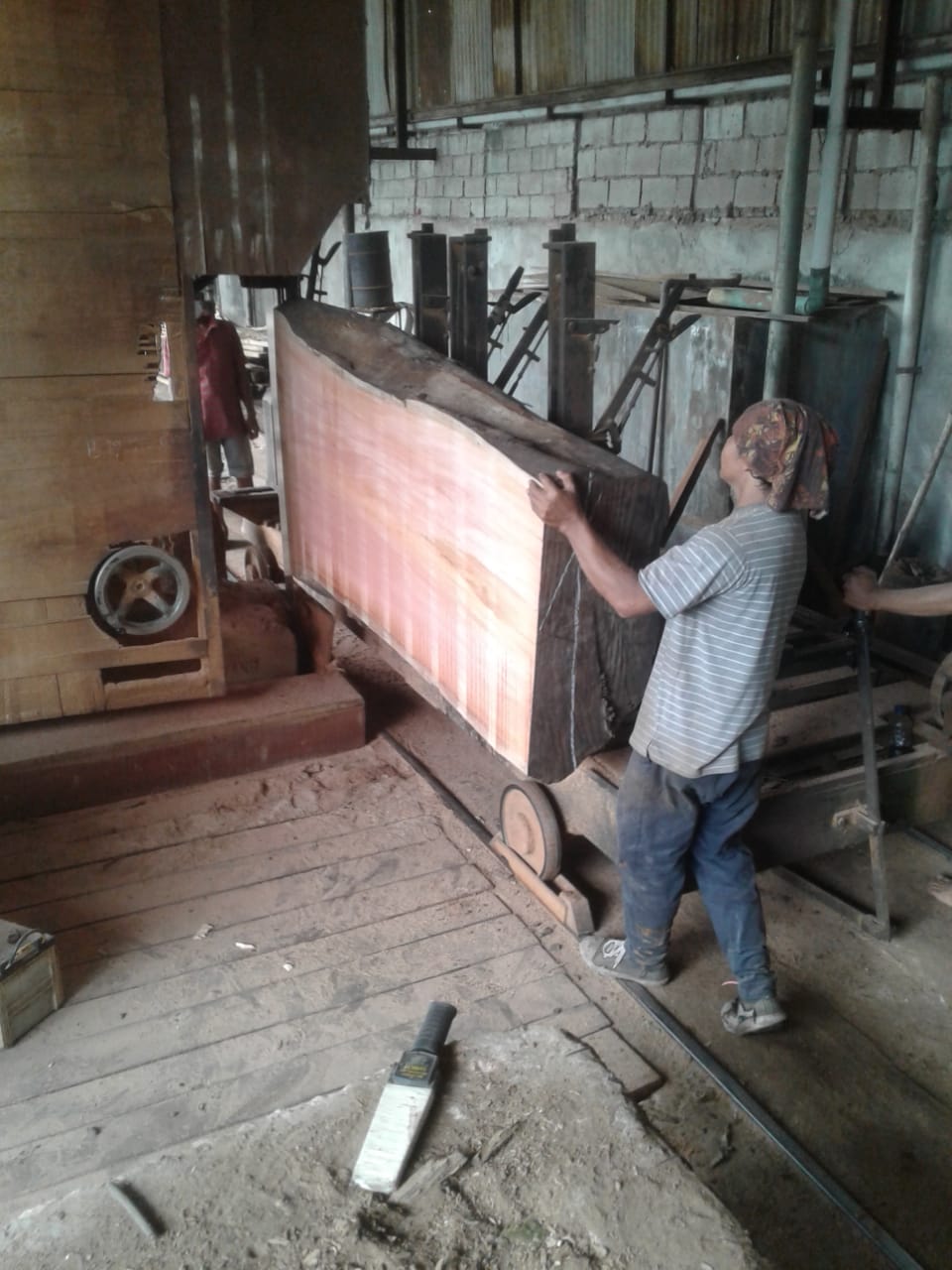

due to high cost on cnc service almost $600 and i'm lucky enough to get an old mahogany log > 1m diameter. with same money, i'm ordering 0.5m3 with 200x35x5cm cut for elsinore, another 3 piece of 200x50x5cm for my audio rack and 1 piece of 200x80x5cm for my dining table.
i just consider my man hour work as $0 for this hobby 😀
looking at the picture sent by wood supplier already teased me

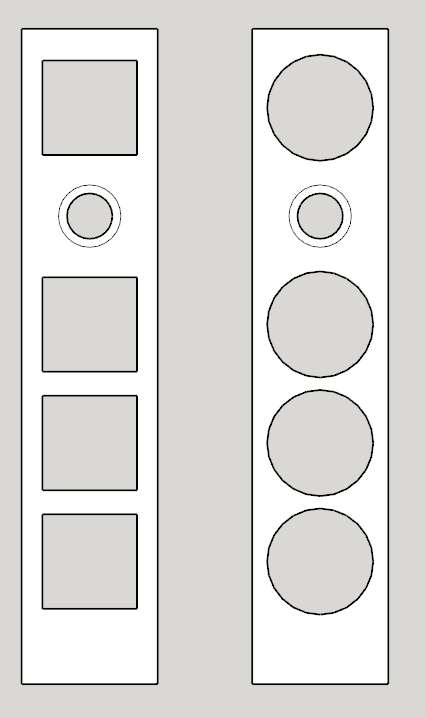

The sub front panel from Joe's layout has square cutouts.
I believe round cutouts offer more strength.
In area only, the circle cut out is only 1 square inch less than the slightly modified square one. I say modified as I converted the mm to inch (160mm=6.29" and adjusted to 6.25") regardless, Im pretty sure the Romans discovered long ago that force exerts itself around and can carry much more weight than a square... That said, we aren't building aqueducts or bridges but a structure is a structure.
Anyway, that's my argument, and Im hoping to hear opinions on it.
Im sorry If you gave me one, and Im not getting it...
That's great if the force on the bridge is downward. Try ramming it from the side.
if the bridge is already on its side, I will take the pass.
I believe the forces Im thinking about are best tamed by this design.
The largest panel on the elsinore are the sides.
the movement or unwanted vibration of that side panel is limited to 2 directions and the brace as joe designed it I believe is the best way, or at least a fantastic way to keep the loudest movement to a minimum.
I believe if I have read correctly, many are focusing on stiffening the front panel to improve the good stuff. I think a loud side panel is bad stuff.

Why do you think of the bridge laying down, are you talking about a horizontal piece with an arch cut into it supporting one line behind the baffle?
Dave was talking about connecting the front and back panels. Some prefer to connect all four.
