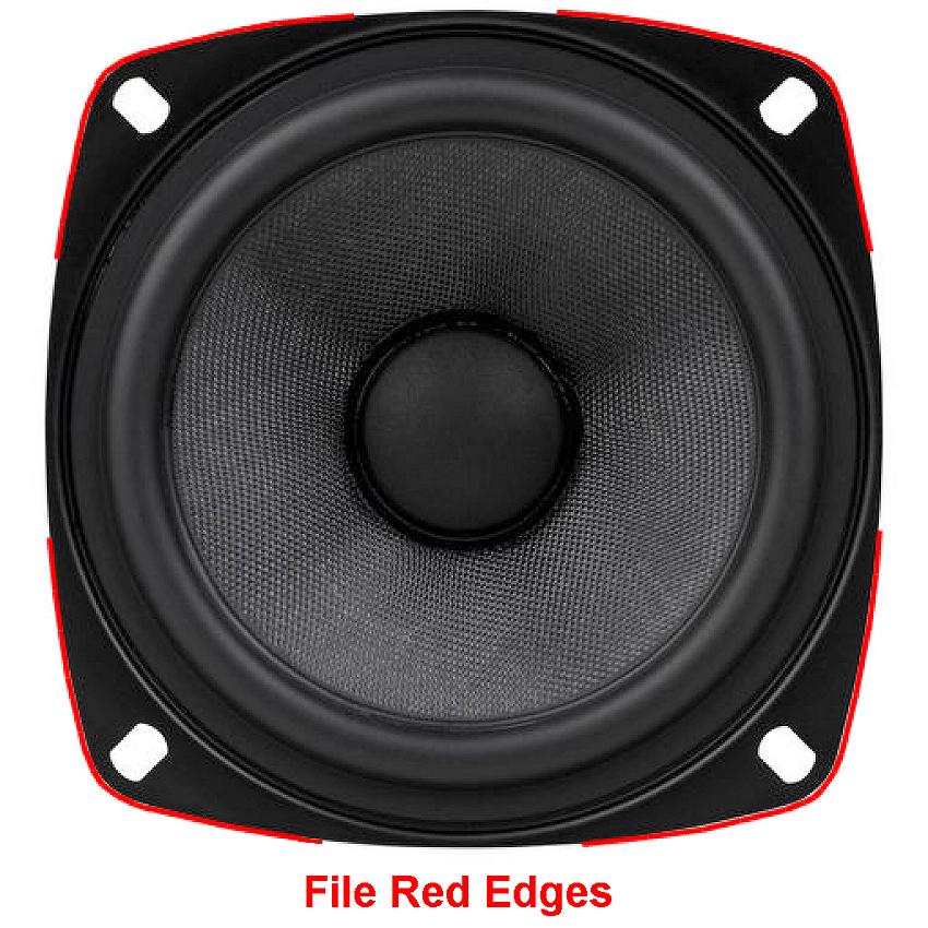

I will let you in on the first step that I have already done. The AMT tweeter is of course, the attraction here, but it uses a cheap (only so-so OK) polypropylene mid-bass driver... so we replace it with this:
IMPORTANT: Must be the 8 Ohm version as shown - Dayton PC105-8

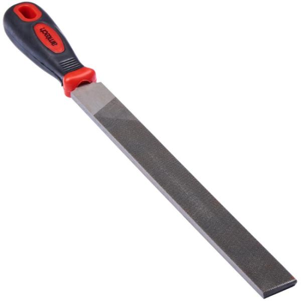

Just replace with this much better driver, BUT it is not a straight fit, you will need to file away not quite a millimeter where the four holes are, as it is a slightly larger driver. The existing mounting holes are just fine.
Later, we shall develop this into something more advanced and take advantage of the drivers that are now both of them good, and not just the AMT tweeter.
Use it like that for now, it is amazing value and we shall make it better still after I have done some measurements etc.

Prepare the driver by filing the edges where it is shown in Red.

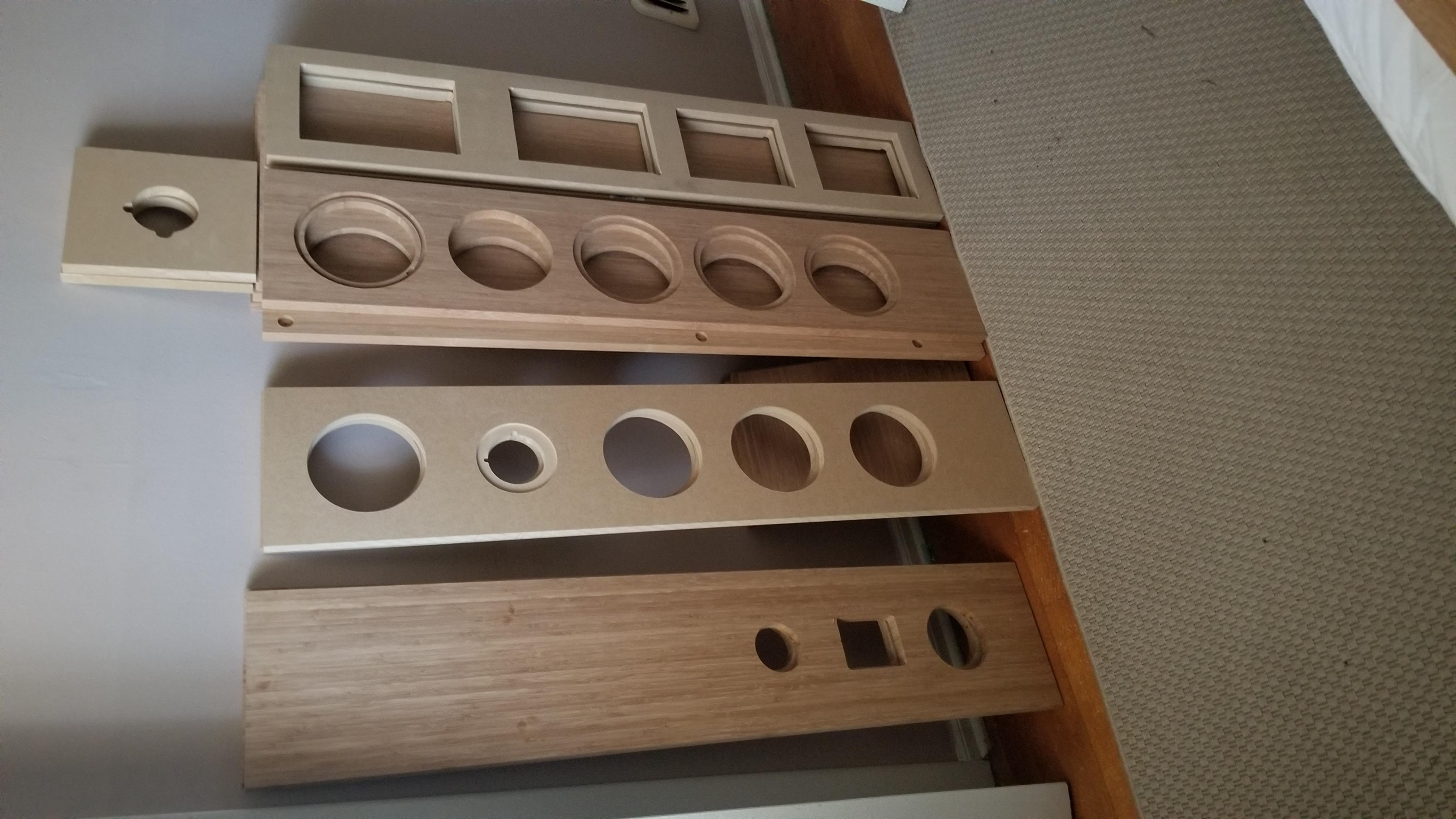

So, back story. I dreamed of a great sounding system for sometime.
I chose the ELAC because of the phenomenal reviews. some one said, if you dont appreciate them, buy a 10,000 speaker system. You will LOVE them once you realize how good they are.. SO, Im building my Elsinore because these dang little speakers give me CHILLS every time I listen... SO stoked to hear the Elsinore, dang crossover cost more than the ELAC's but omg.. they are amazing...
So, took the AM and built a table saw sled, and late AM, had at it…
7 hours later I have both of the enclosures cut to size with speaker cutouts...
Have to find port material and can get going on cutting them in along with the speaker terminal blocks.
All that's left is to make the cutouts for the main brace and rear sub panel... need a little more MDF to line the side panels and will be ready to break out the biscuit joiner! Guess I should start the crossover soon too!
So, I learned there is ALOT of wood (or grass in my situation) in these.
Hoping to have these bad boys done in the next 3-4 weeks, and as long as I stay healthy, should be able to...
By the way, the bamboo boards cut amazingly well. The router did almost as good, but I did have a little tear-out on one cutout. Im not to bummed as I need to hit the entire exterior with a bit of sand paper, I have a feeling it will be un-noticeable when Im done...

What kind of router bit? Straight cut or down cut or what?
Spiral Up cut, i chose for better chip extraction. Knowing i went slow on the 1st 1/4 debth cut. Think the little blow out was because I was cutting with the rotation (forgot which way it spun for a second) and i let the tool get away from me for just a second.
Tip for any one using the jasper jig, mark and center punch all speaker centers, drill pin holes with a drill bit that lets the pin slide in easy. Then set debth of cut to 1/4" and cut all 4 at that diameter. Next pin change should be less than diameter of router bit, or 3"16 for me. Than cut all 4 again. Did that one more time finishing the shelf the speaker sits on. At that point reset pin for cutout size one more time and 3 passes at 1/4 inch deeper should finish the cutout for all 4. Than the tweeter cutout by it self.
The first front panel i reset the pin in the jig 4 times per hole and 16 adjustments for 4 speakers took nuch much longer. The 2nd front being more comfortable I went into production mode. Probably took a quarter of the time..

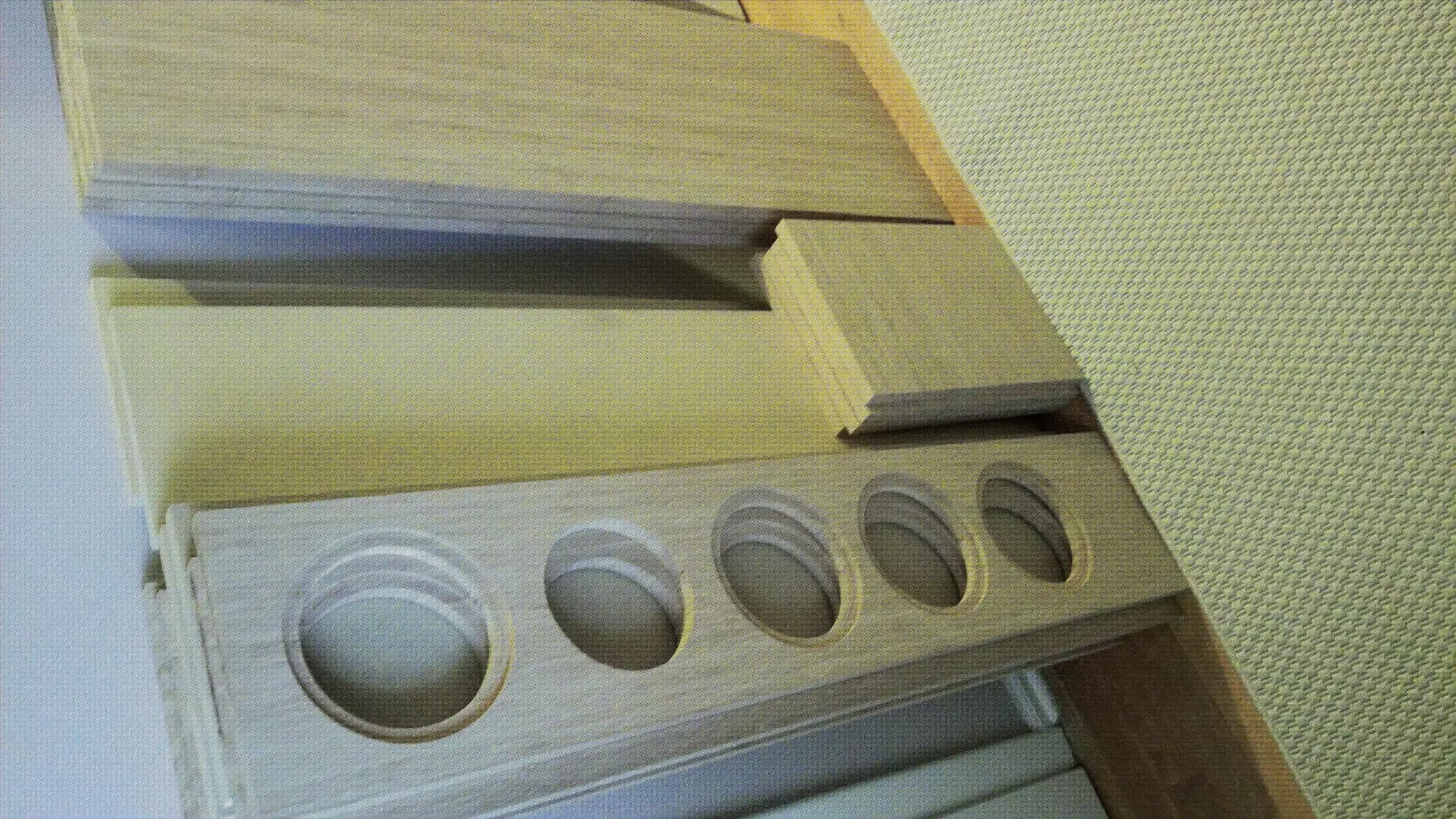

Played hookie today. Finished (I hope) all of the cutting for my Elsinore's
Wow, lots n lots of sawdust was made. A few years ago I built a 16x12 shed, double doors and windows.. Guess Im getting old as I feel like I have put that much into this build lol..
Have to tell you.. The Jasper Jig is amazing. Like Forrest Gump, I liked mowing lawns so much or something like that, couldn't stop using the jig and instead of square cutouts in the sub front panel used the jasper...
Now to source 1.5" 8/32 cap head screws as the dang 1" ones are a quarter inch too damn short...
While at it, I wanted to mount speakers a little more refined than plain old wood screws... I picked up T-nuts but hear folks like the Hurricane nuts for MDF more... Anyone hear use them ? What I like about the T-nuts is I can slobber some construction adhesive around the edges to help lock them down.
What I don't like about the T-Nuts is I have to pre-drill 4 teeny holes so the points get started...
