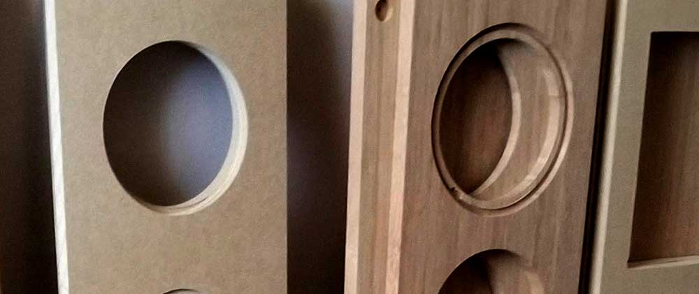

Doesn’t look like you have any chamfer at all on the back of the cut-outs. You do not wan tthe driver sitting ain a cyclindrical tunnel. It will screw up lots of things but mids the most. Got a big *** 45° router bit? And the hole in the back baffle should be what the inner side of the hole on the front baffle is (or even a bit bigger).

Joe had a very good expalnation of his rationale for a rectangular cutout on the inner baffle, and you seem to have done it in the worst way possible.

Thank you for your input!
And yes, I do have a 45, will run it round... The hole is already bigger than the speaker cut out. Also, Im working with 3/4" thick material not 1". So, I have 1.5" thick while Joe's design is 2". The 1/2 less offers me (I believe) a little more clearance.. But warning heeded..

Notably the "Sub Front Panel" should have those rectangular cut-outs, NOT circular cut-outs.
So:
1. the baffle should have the circular chamfer on the interior of it's panel.
2. the "sub front panel" should have the larger rectangular cut-outs.
Elsinore Construction
..if you just have a circular cut-out for the "sub front panel" (chamfered or not) then you are going to screw up the result.

I don't see the chamfer recommendation on Joe's construction for the front baffle.
He doesn't have that.. but it's not a bad idea to do this (..excepting of course the mount-points).
..at 18mm with inset it's probably not needed though. At 25mm it might be more important. (..and it also depends on the frame of the drivers - if there is a "lip" on the inside of the circular mount (rear of driver) then you can't do anything about that amount of extension of that "lip" - so the baffle doing the same isn't going to be a problem.)
Note: after looking again at the square cut-out for the "sub front panel" - they absolutely should have chamfering. (..far more important than the baffle having the chamfering.) I didn't look at how close the square cut-outs for the sub-front panel were in relation to the drivers. 😱
As to why the square vs circular cut-out for this board: circular is concentric - it groups the reflections and resonance, square isn't great - but it's a lot better than circular.

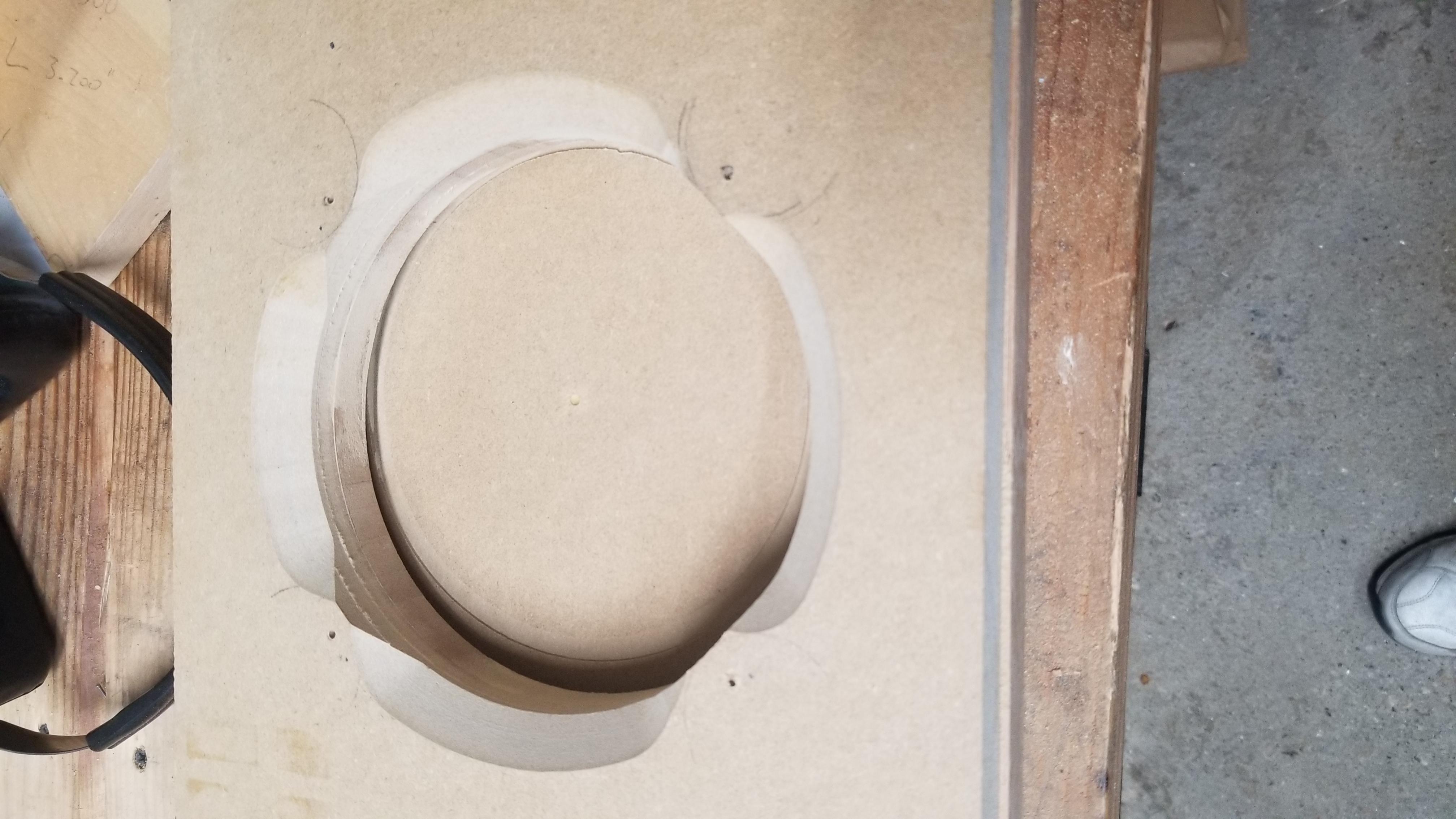

Rained most of the day, but had to kick up a little dust.. attached shows 2 passes with the 45, probably have 2 more to go but this is the general idea...
I understand this is no mans land, and im wrong frequently so ..
If sound is vibration in air, and movement, i believe a 45 degree offers less resistance than a 90. Well, i should say I know for a fact asking air to move through around 90 vs around a 45 creates much more resistance, turbulence and total equivalent lengths are much higher.
What i admit to know nothing about is sound frequency, standing waves and most of all, speaker building!
That said, i offer my self up to the gods of chance and plan to proceed. My hunch is, if im correct the nox will appear to be slightly largerand tuning the port length might be affected. I also think that i may have to hire a consultant to tweak cross over values (hint!) But won't know until I learn much more about testing the speakers...
That said, if anyone had to take a stab in the dark, and if my assumptions are correct, is a box appearing to be larger a bad thing?

Yes...the front baffle. I suppose with a bamboo board front baffle it should be solid enough.
It depends on what frequency you are talking about. As the size of the “feature"
approaches the wavelength of the sound the affect becomes greater.
dave

-looks like you've got almost *3/4 inches of concentric "tunnel": not good. 😱 (..peak resonance I'm guessing around 2.4 kHz.)
*I'm assuming almost 1/2" of bamboo and at least a 1/4" of mdf from the picture.
Will be making more passes with a 45 deg. router bit to bring down to the 1/2", except for the mounting points...

How did you come up with the 2.4 kHz number?
If I consider the "tunnel" as a tube with open ends, the resonance wavelength would corresponds to 2 x tube length. The corresponding wave length would be 38 mm, or 9 kHz. This is well beyond the pass band of the woofer, so it would be entirely irrelevant.
A tube closed at one end is a 1/4 wave resonator, open or closed at both ends it is a 1/2 wave resonator.
A 1.5” deep tunnel closed at one end will have a 2.26 kHz resonance —assuming the driver closes one end. But of greater concern ar ehighish frequencies reflecting off that 90° edge back thru the cone.
