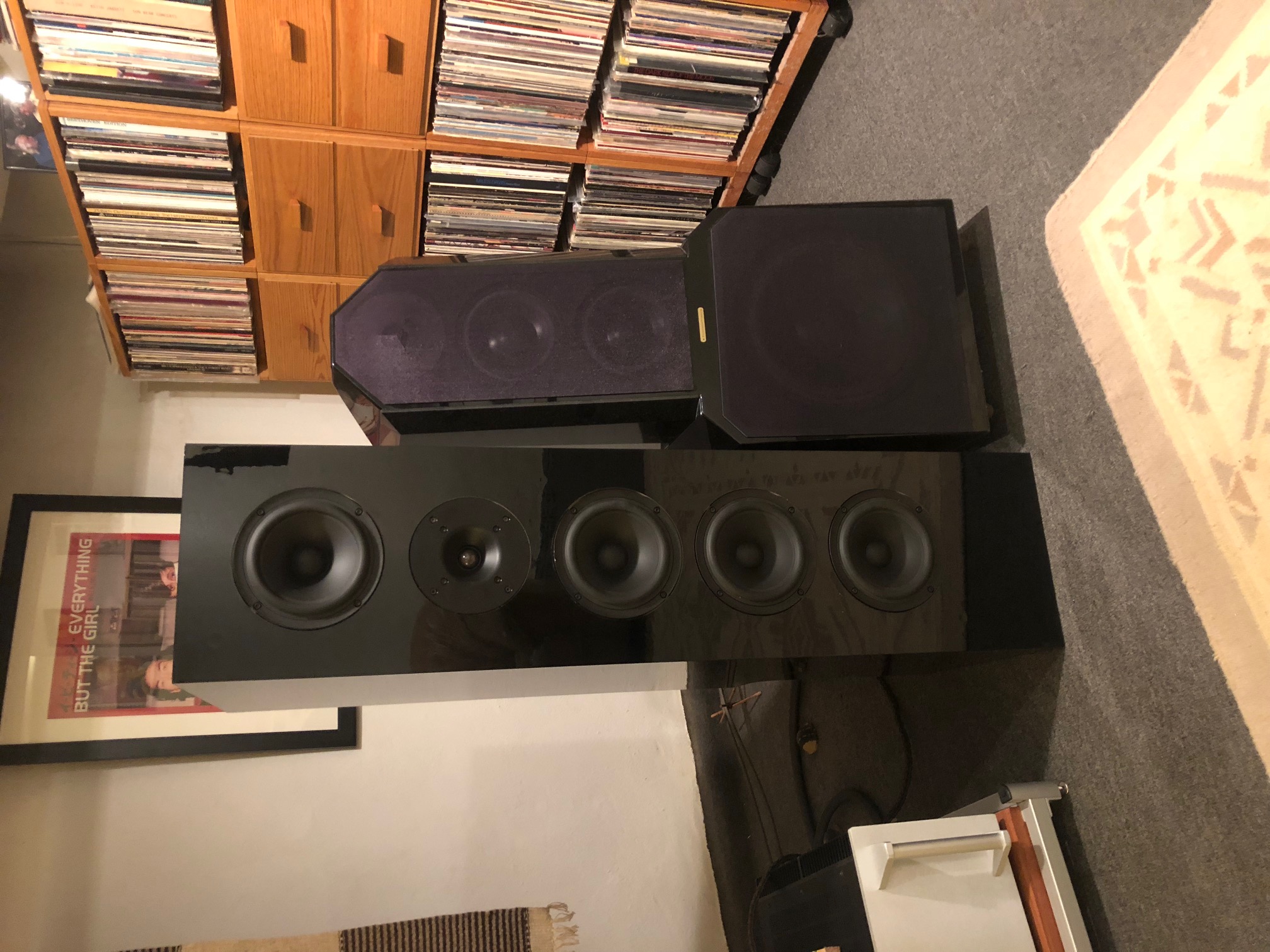

just finished 3x hamlets to go with my elsinores. still need to veneer them but they are great. cheers joe.
SB17NRXC35-8

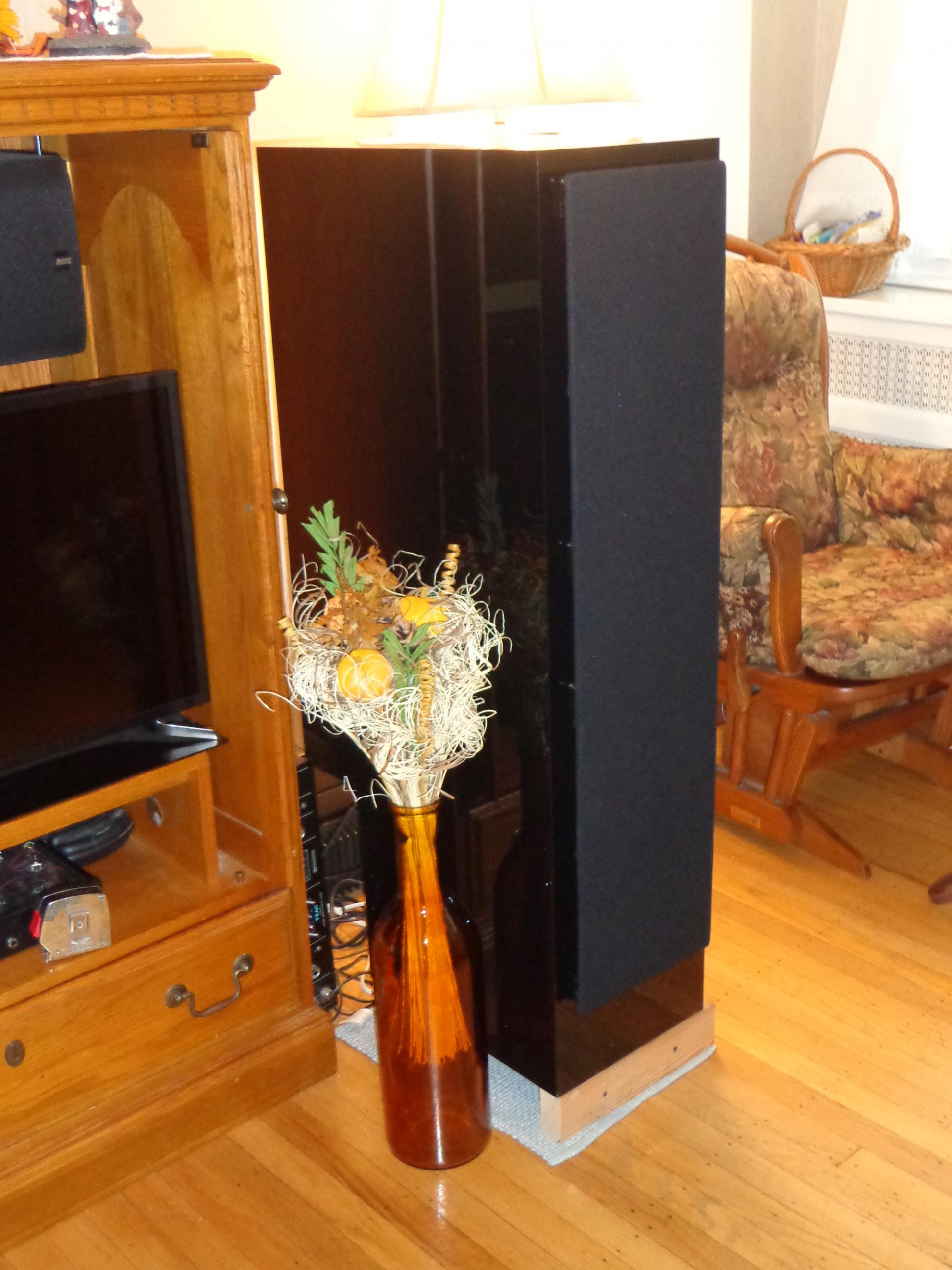

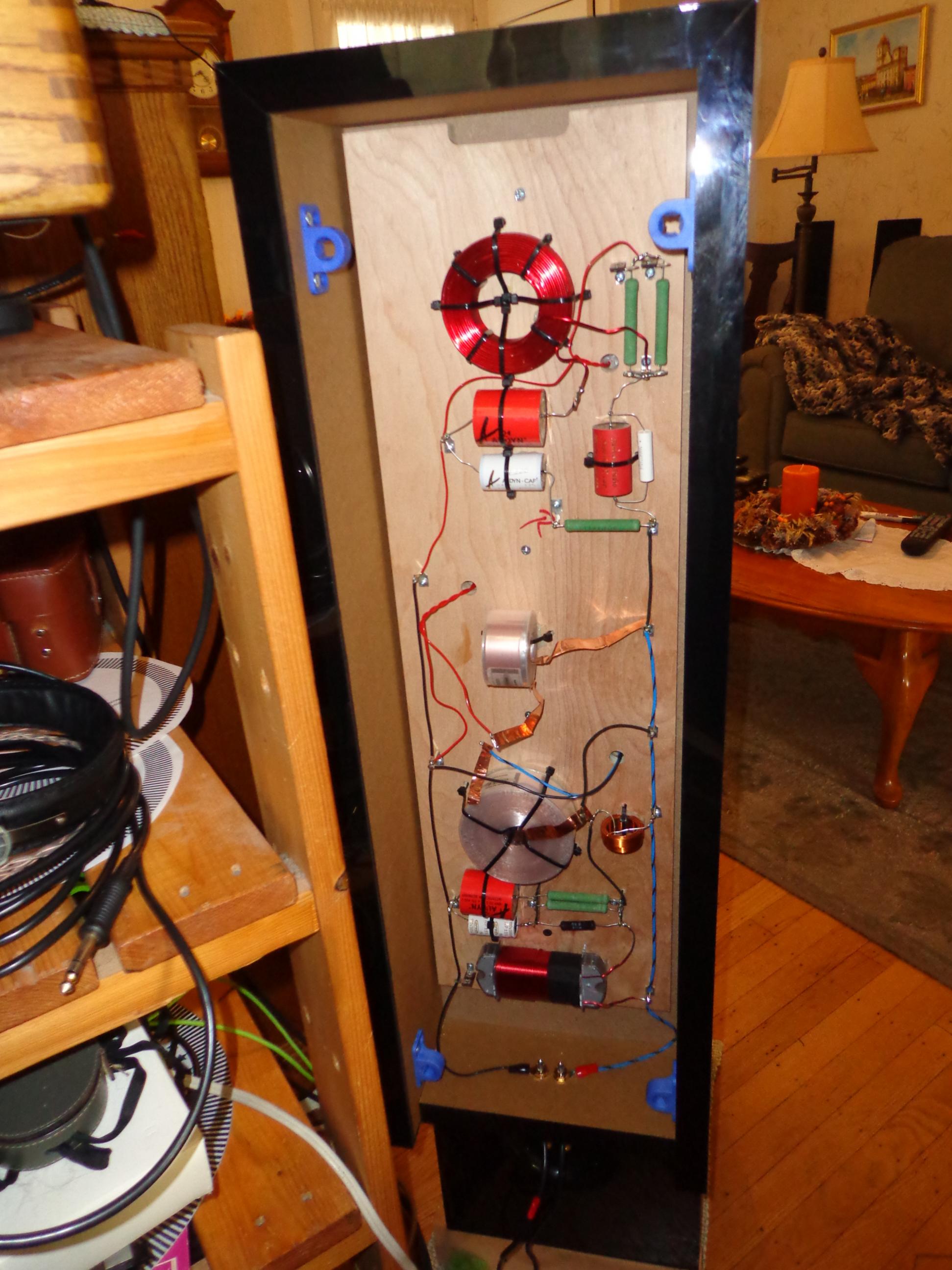

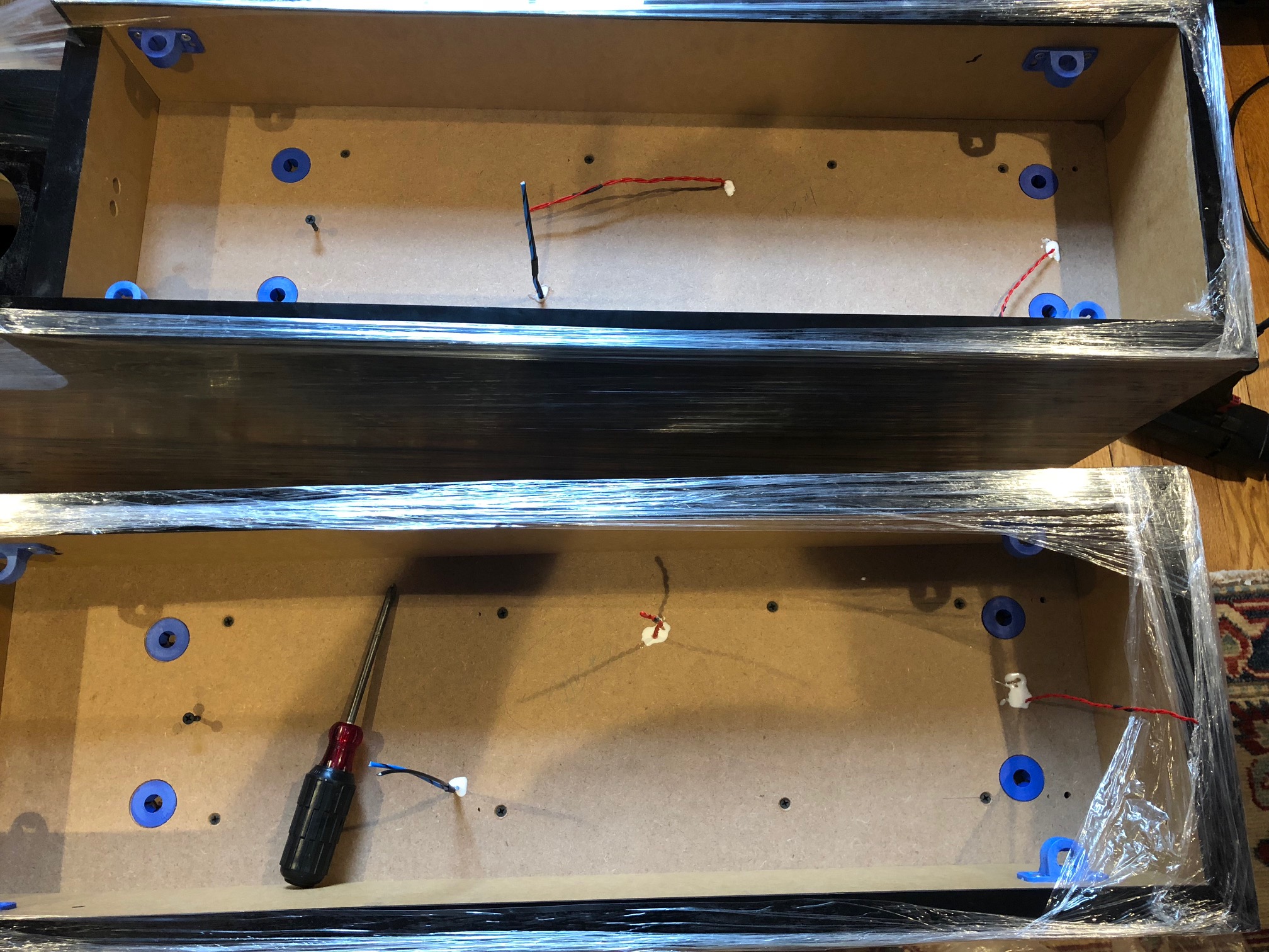

Folks:
I have been derelict in writing up my experience building the Elsinore loudspeakers. It’s time I stopped procrastinating.
I began discussing the idea of a speaker project almost 5 years ago with a friend who has, on several occasions, “piggy-backed” on my audio projects. We’ve built Gainclones, Aleph P 1.7 preamplifiers and FirstWatt F5 Turbos together. Joe loves music but doesn’t sling solder and needs a lot of help on each project. But one of the things that Joe brings to the table is a local network, and when I proposed building Elsinores he informed me that he knew the owner of a high-end furniture manufacturing business not more than 40 minutes from my home. Since I have no woodworking experience or equipment, my friend’s friend became integral to our plans.

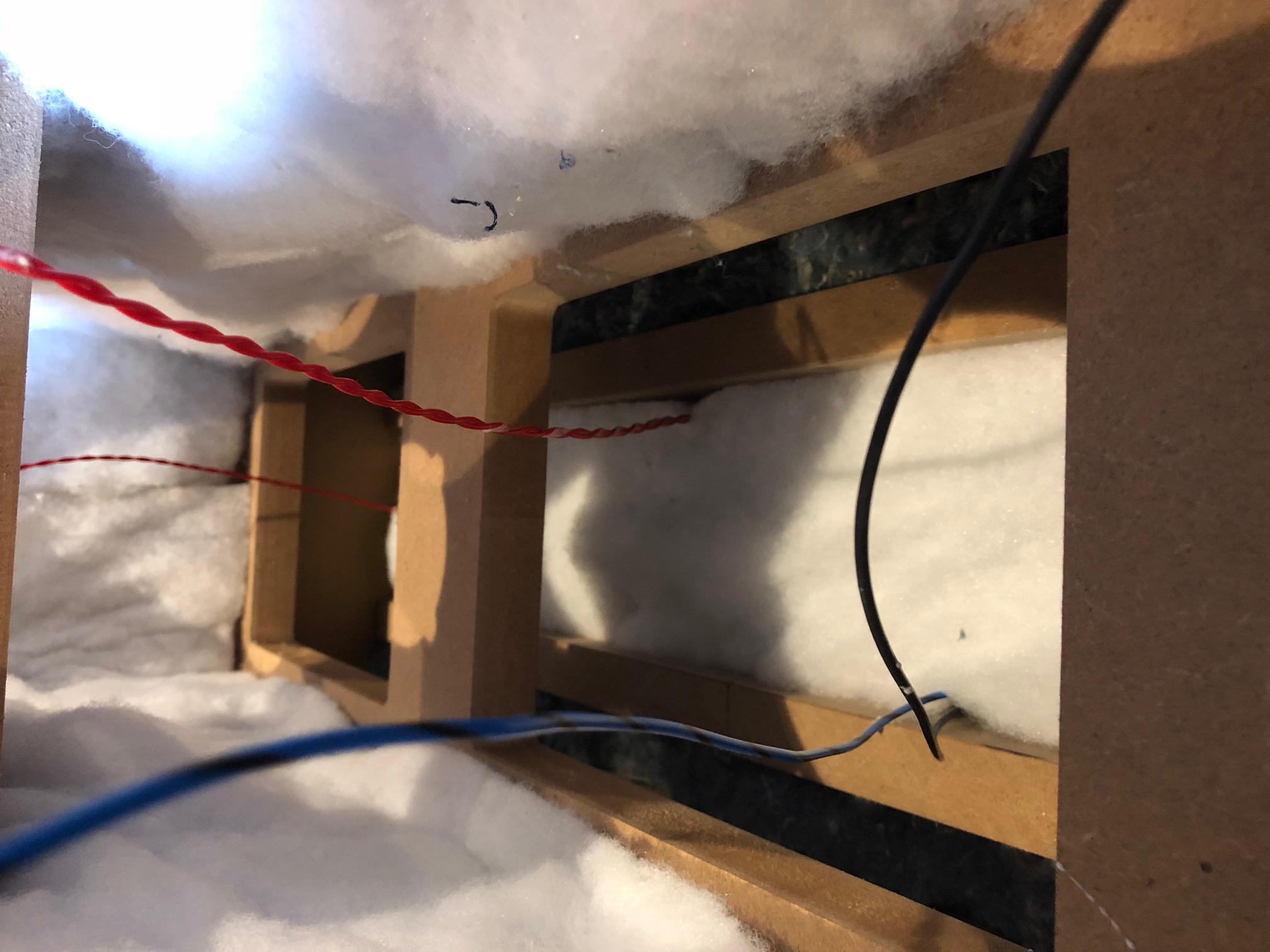

The factory owner agreed to a meeting fairly quickly. We sat down in a conference room at his factory (an amazing place – enormous by any rational standard and equipped with state of the art everything) and I laid out for him the Elsinore design, including a series of modifications I proposed making to the cabinets (more on the mods to come). The factory owner expressed interest – he is a music lover and liked the idea of building the cabinets, in return for which I would do all of the fit-out work. However, he wasn’t convinced that I was anything more than a crackpot, so I invited him to my home to listen to music and to discuss the project further. He agreed but our play date was delayed – he had a series of medical issues that sidelined him for about 1.5 years. When he finally came to my house he announced he only had 45 minutes to spare. My basement system at the time consisted of a Maplenoll Apollo turntable with a Lyra Lydian phono cartridge, a diy Pearl / Ono phono stage (a group buy project), a diy music server (running Daphile), the Aleph 1.7 preamp, F5 Turbo V3 mono-blocks and Egglestonworks Andra loudspeakers. The system sounds pretty good. Three and a half hours after he arrived, the factory owner declared he was in on the project, told me to work with his engineer to develop the CAD drawings and that he’d commit to building three pairs of the cabinets. Joe and I were finally on our way!
The engineer was easy to get along with. I supplied Joe Rasmussen’s cabinet drawings as a starting point. We made a few changes to the cabinet’s design, including inserting neodymium magnets in the front panel to hold metal grilles in place, threaded inserts in the bottom of the speaker for adjustable feet and adding a removable crossover panel and an extension off the back of the speaker to house the crossover. The cabinets were to be made primarily with HDF (a few pieces were MDF) and a piano black veneer was selected for each pair. None of the internal dimensions or panel widths of Joe Rasmussen’s cabinet design were changed, but the engineer had a full schedule and designing the cabinet took another year.

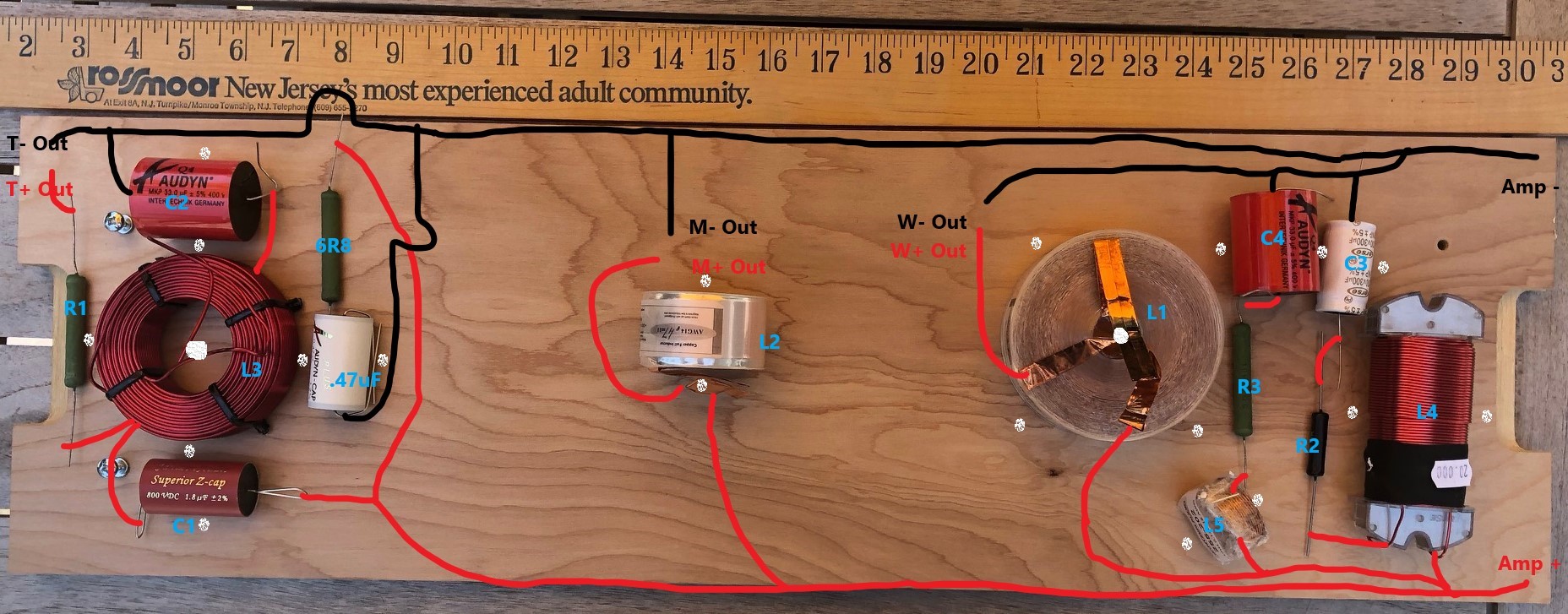

I began obsessing about the BOM early in the project, trying to decide which crossover components, wire and other parts to buy. The Elsinore thread was very helpful, as was trolling around on the ‘web. Weighing the performance vs price value of components is tough enough when you know what you’re doing, but when you’re as inexperienced as I was/am in speaker building there’s a lot to consider. In retrospect, I am pleased to report that my time was well spent.
Around the time we were finally ready to go into production the factory got really busy and our small, boutique project had to be “temporarily” shelved. Then there was yet another lengthy delay while the factory owner underwent another series of medical procedures; he was too consumed with recovering from his surgeries and managing his business remotely to entertain our request to slip the cabinet building into the production schedule. Finally, in the early summer of 2018 the factory owner notified Joe and me that he was sourcing the materials needed to build the cabinets. I mentioned this project to another couple of friends and one (Dave Price, known as “schubert”, a member here) expressed interest in joining the group buy and build. The factory owner agreed to build a fourth pair of cabinets and by early August the cabinets were finished.
I then ordered the parts for four pairs of Elsinores. The deal was this: the factory owner supplied the cabinets and the rest of us bought the rest of the parts needed to finish the speakers. Joe, Dave and I split the cost of the components for the factory owner’s pair of Elsinores. It turns out that if you’re buying that many parts, some of the larger suppliers will offer attractive discounts (our order with Madisound, for example, exceeded $3,500 and with a little encouragement they offered a 30% discount).

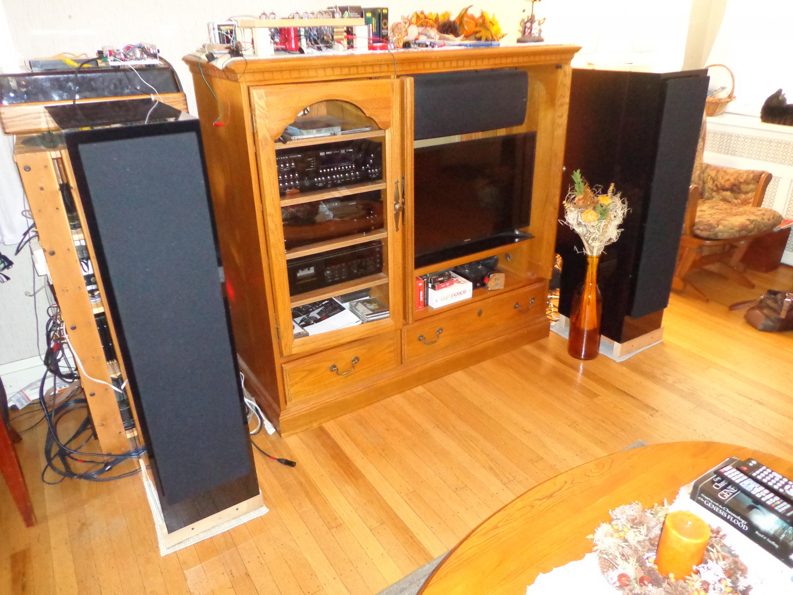

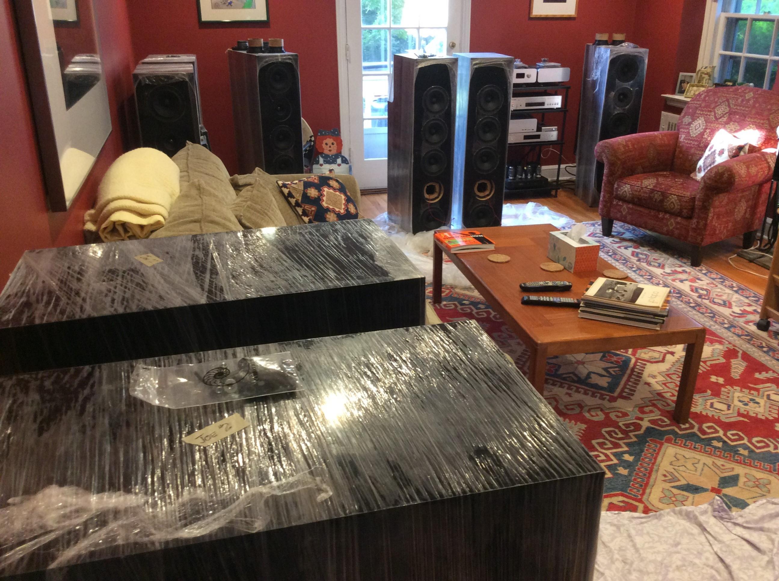

Joe and I carted the four pairs of cabinets from the factory to my living room in mid-August 2018. Dave and I worked together on the crossover layout. Joe, Dave and I then spent about a week fitting out our Elsinores. My hat’s off to the pros out there who have scratch-built Elsinores; if you’re not building cabinets, assembling Elsinores is time-consuming but pretty easy. For everyone else, it’s clearly a lot of work. A few photos are attached.
So how do they sound? Over the past 6 or 7 months, about 20 people have auditioned the Elsinores in my basement listening room. A couple were diyAudio members (Dave included), two are semi-professional musicians and the rest included friends, neighbors and family. Everyone had a chance to compare the Elsinores with my Egglestonworks Andras and the nearly-unanimous assessment was that the Elsinores were the superior loudspeaker. The only person who was unsure was me, mostly because I thought it was hubris to believe I could build something better than those Andras. But I’m slowly becoming convinced.
What I’ve long loved about the Egglestonworks Andras is their effortlessness. The Andras are never fatiguing; they always sound like they’re comfortably striding along, easily making music. They have a very natural mid-range and over the past 18 years or so I’ve come to really love them. But the Elsinores are better: the low end is a little more coherent, they seem to be an easier load on my amplifiers (they are certainly a little more efficient) and their tonal balance is incredibly engaging. Nothing too forward, no stridency, beautifully balanced, very engaging. I cannot tell you how pleased I am with these new speakers. I doubt I will ever be able to fully express my appreciation to Joe Rasmussen, whose brilliance appears to be matched by his extraordinary generosity (Joe, if you ever find yourself in the Philadelphia, Pennsylvania, USA region, you have a place to stay and a great bottle of wine waiting for you).
I could not audition the Elsinores before committing to building them, and Joe, Dave and I took a big leap of faith. That leap paid off in spades. But if you are considering undertaking this project, live anywhere close to me and would like to listen to the Elsinores first, reach out. Auditioners are invited.
Highly recommended.
And before anyone asks, no, the factory owner saw this project as a one-off and is not interested in further boutique speaker builds. He has a business to run and he already has his new speakers.
Scott
