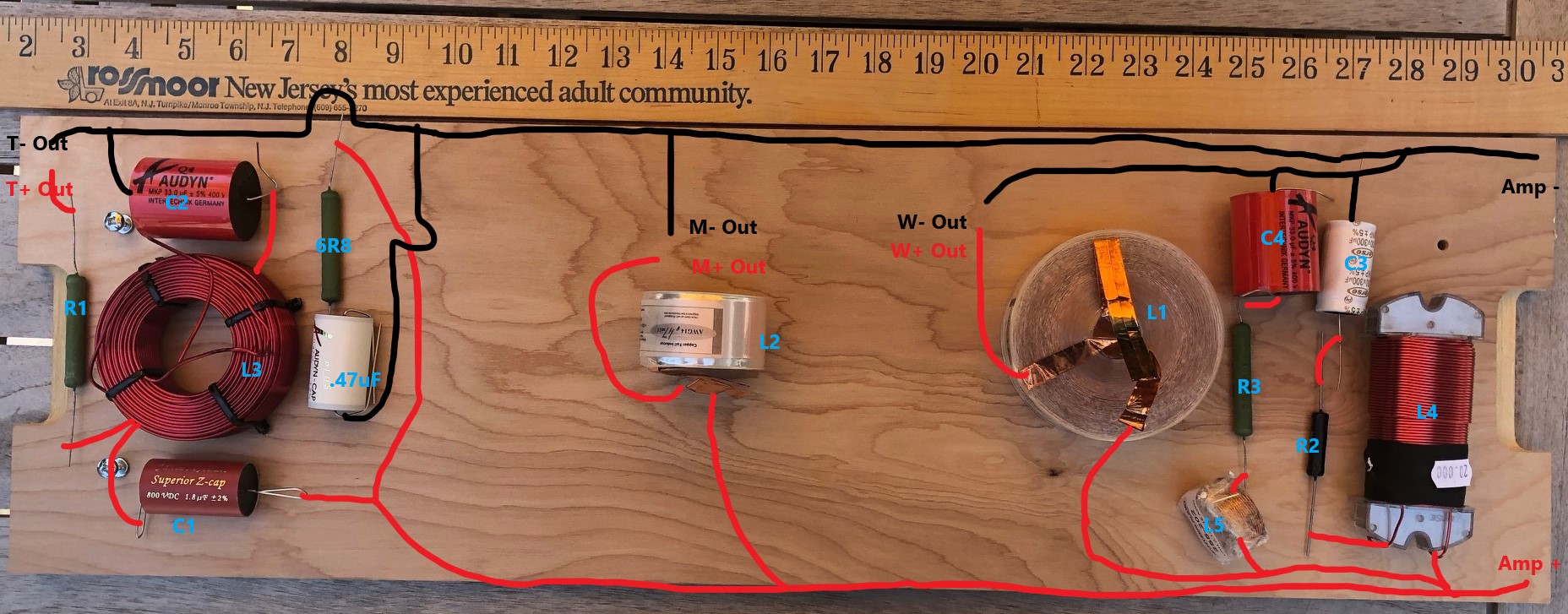

I'd be grateful for feedback on my crossover layout for an Elsinore project. The crossover will be mounted on a board measuring 8.5" by 26.5" (21.6cm x 67.3cm), which provides plenty of landscape. In this design L1 and L3 are oriented the same way and will be about 14" (35.5cm) apart, with L2 about mid-way between them as shown. I'm hoping that the orientation of L5 will not be an issue.
One note: yes, I will switch the positions of the 0.47uF cap and the 6R8 resistor.
All guidance appreciated!

Those distances look fine to me. Most crossovers I see have them much closer than that. How's the cabinets coming along?

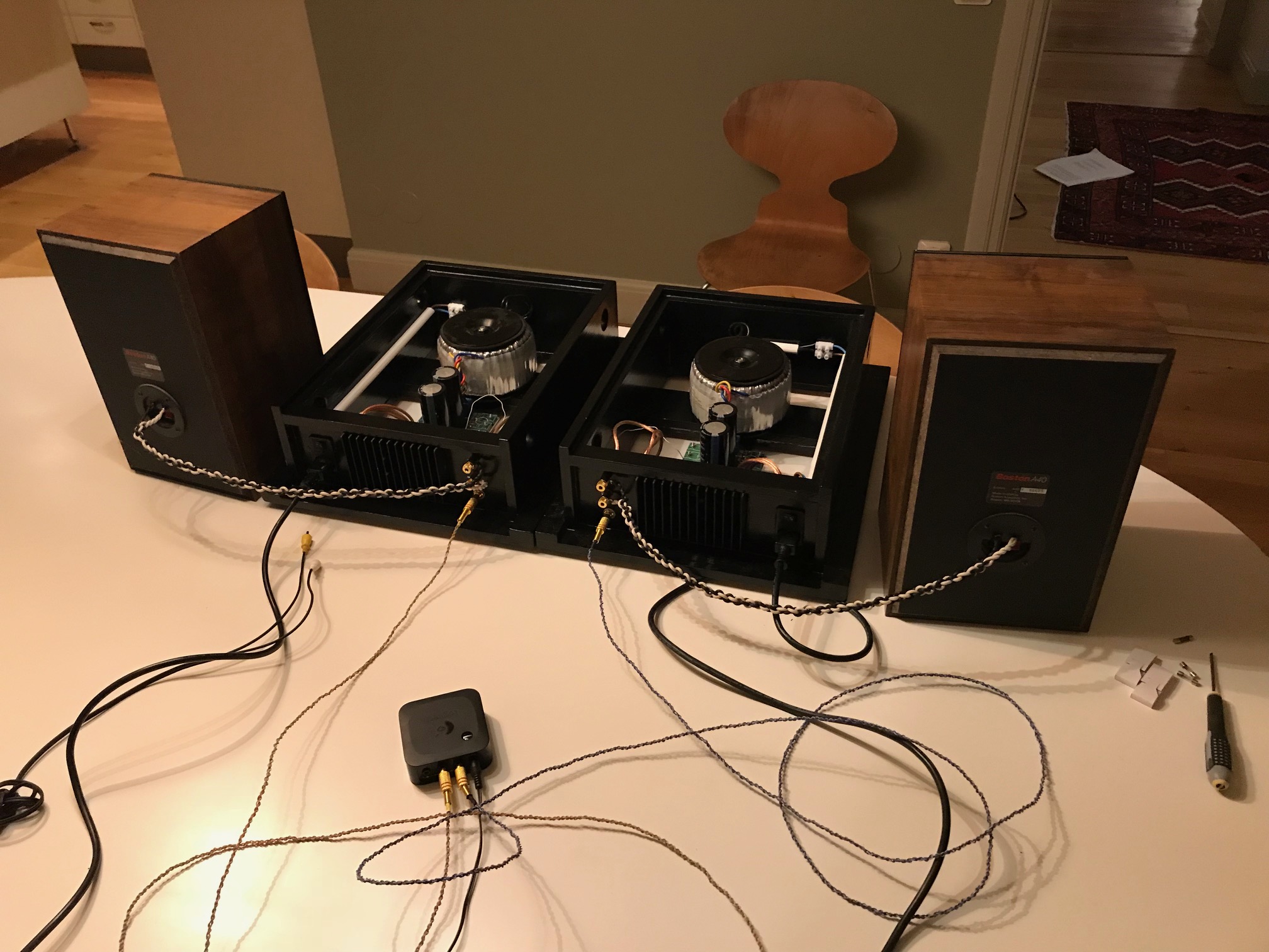

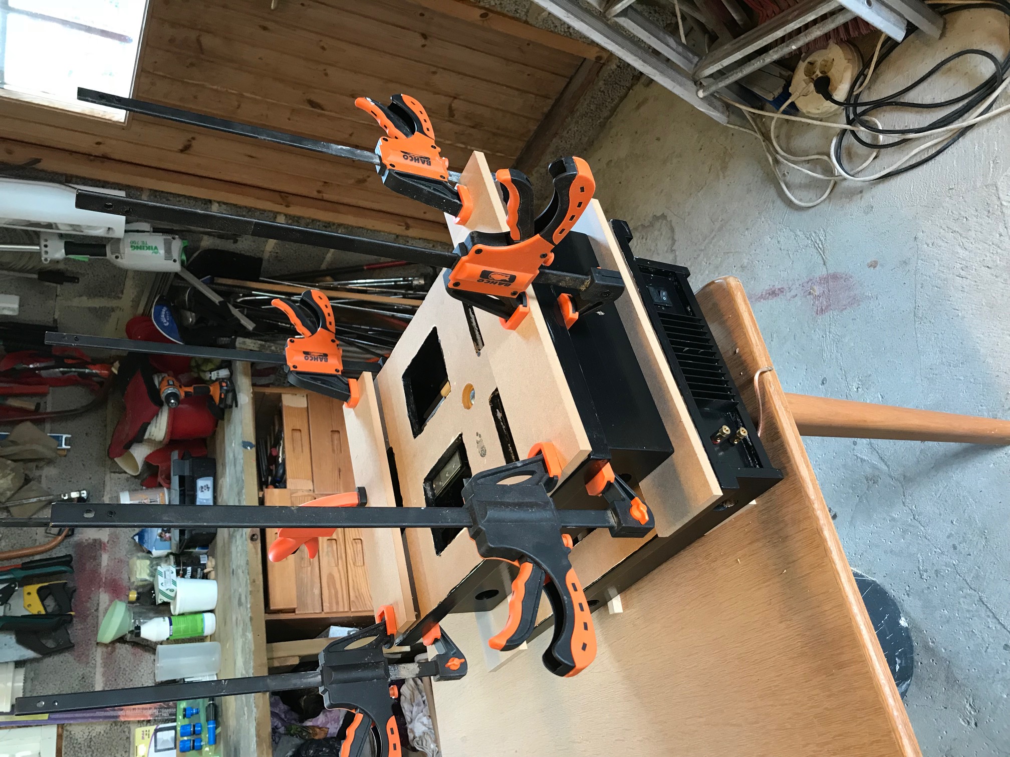

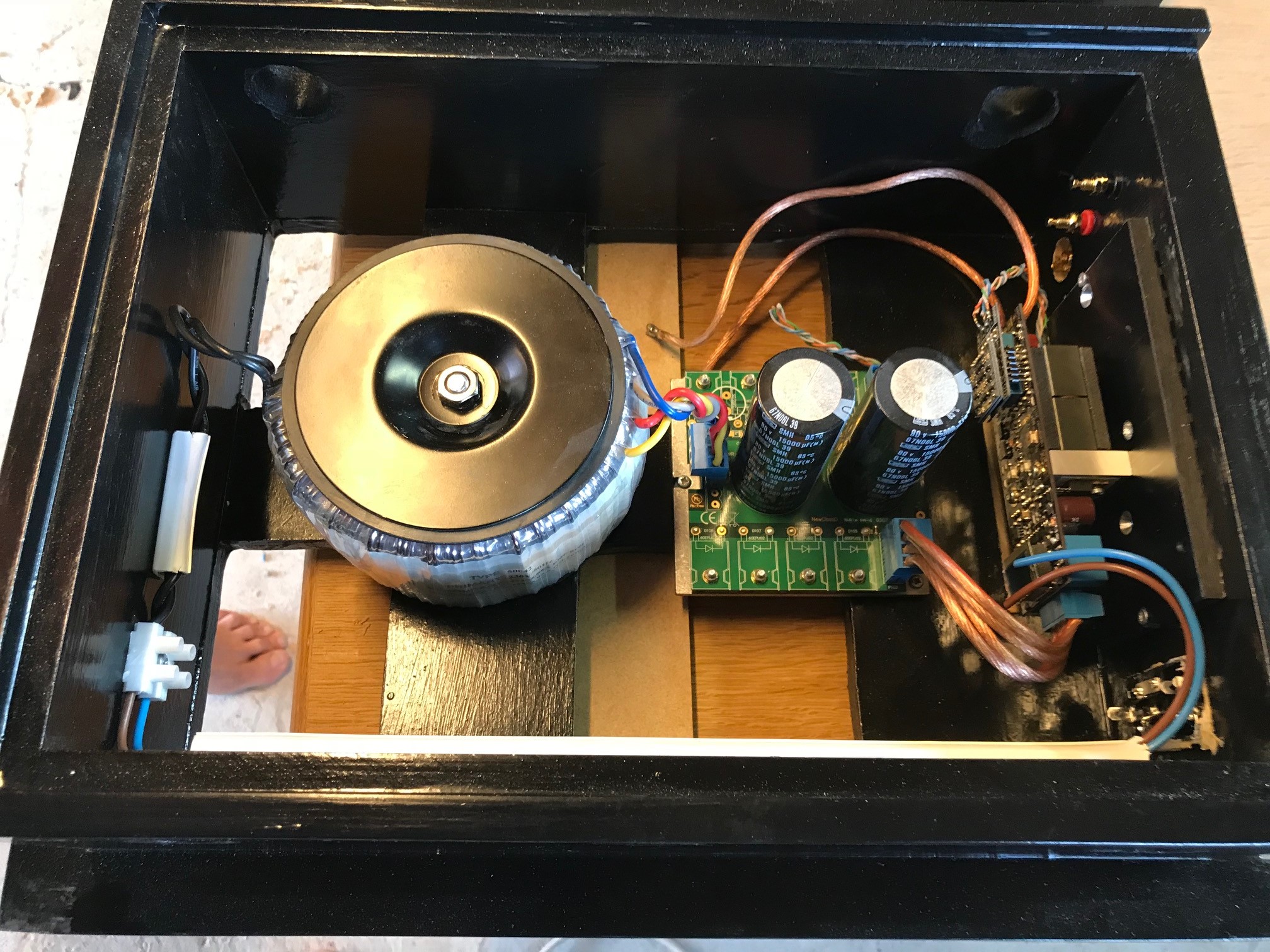

Hello again all,
Just s little update. As i read some year ago that the Elsinore sounded even better placed a bit above the floor i made myself a small building project. New NEWCLASSD mono blocks in mdf as footings on my mk5 Elsinores. And yes it worked out well. And yes the newly home made four twinned signal cables (and also new short speaker cables) a la Svalander audio are working over my expectations (as always).
