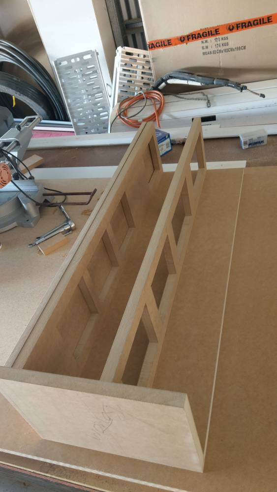

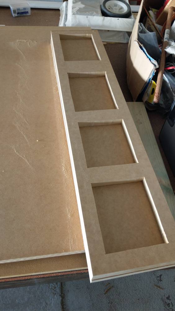

rampage101,
Good to see that your build project has commenced! Good luck with your build and look forward to more updates and pics.
Are you using the SBA drivers or Peerless?
I'm using the SBA's and the round waveguide, mk6. Thought it'd be a nice change as all the other speakers I've made have been Peerless.
Thanks, 3600x1800, two sheets of particle board flooring for the top 😀
How's everyone doing the speaker holes? Last time I did some I used a hole saw and a rebate bit to flush mount the driver. I've only got a 9.5mm rebate bit which isn't going to cut it.
I used a router with a template guide I made out of 4mm craftwood. The router has a guide collar fitted so you make the template radius larger by the distance between the collar and the router bit. (hope that makes sense). Since mine were the MK5 version I did not need to rebate the drivers as the Peerless drivers are designed to be mounted directly on the surface of the baffle. I ended up making templates for all the cutouts, even the ones for the brace etc. It makes for very clean edges, even on internal parts which are unseen, (but I know they're there).
