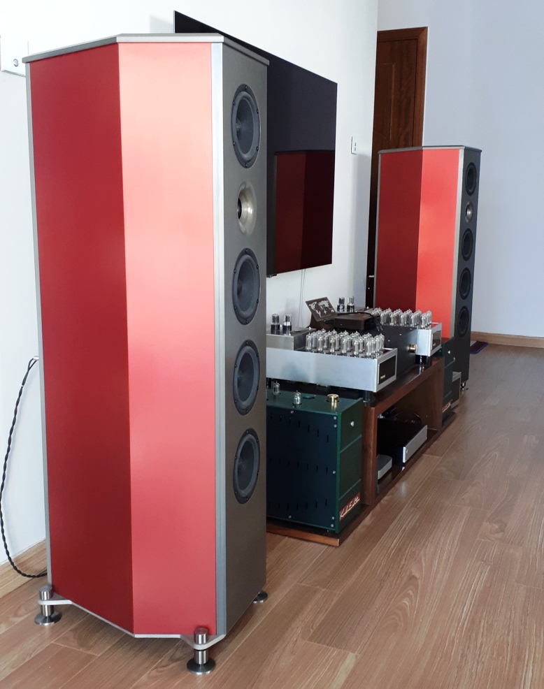

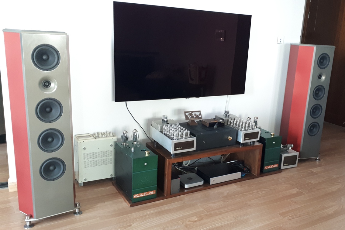

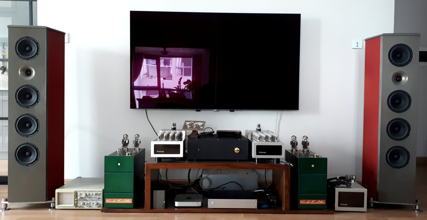

This is my Elsinore speaker Mk6 SE version. My speaker version using the woofer Satori MW16P-8 and tweeter Satori TW29RN. However, the biggest different with the Mk6 is the enclosure. My speaker enclosure are made by aluminium & stainless steel. It's shape also quite abnormal to make sense of different. All of these material make my speaker extremly heavy, the final weight is 125 kg.
The sound from speaker quite impressive. The speakers sound is clean, open in vertical and horizon, deep in sound stage and I think it sound no coloring any band.
Thank alot for Joe

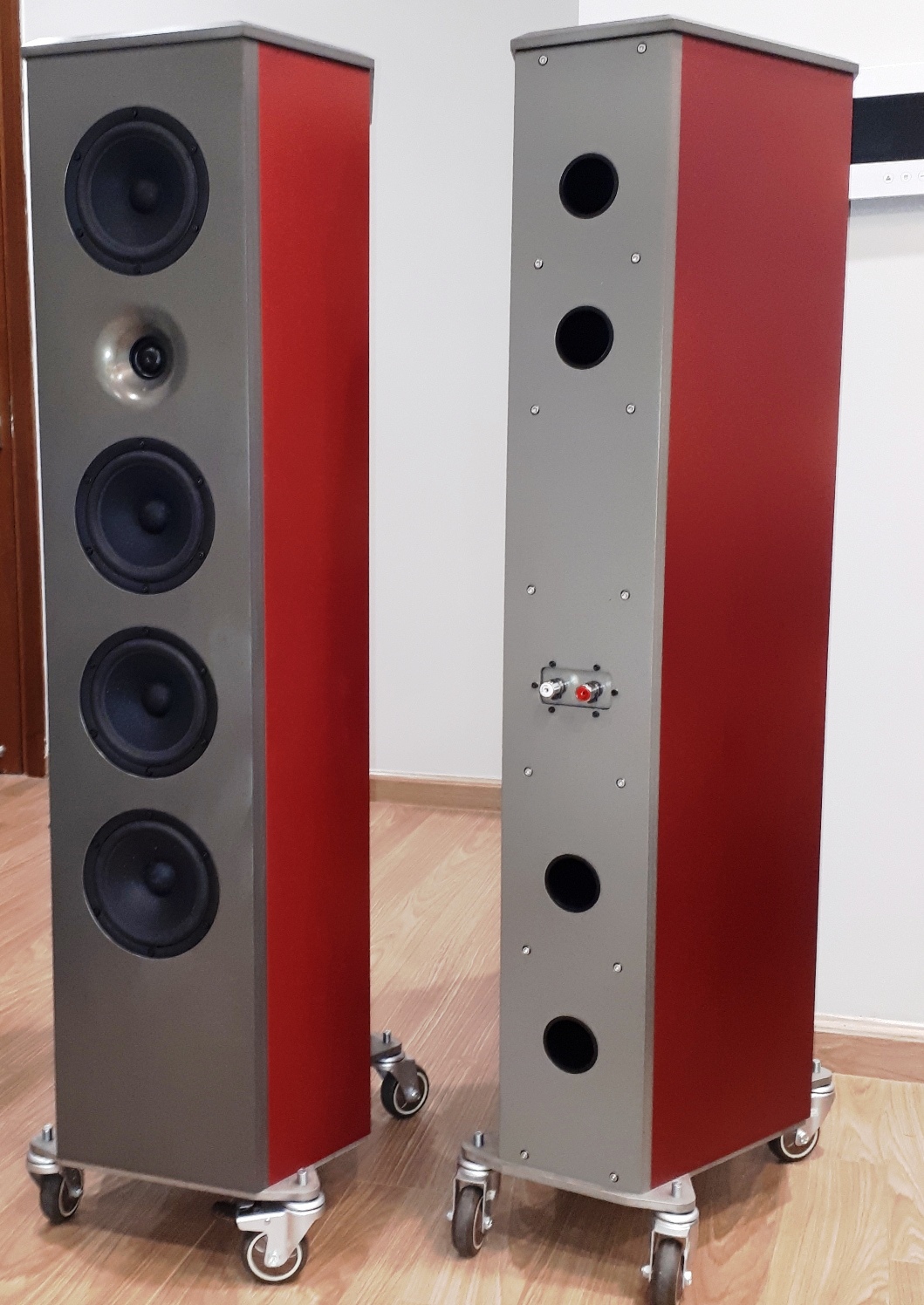

I tuned at 31Hz by using 4 vent of diameter 63mm with 200mm long.
Expense for the enclosure much more compare to drivers and crossover part

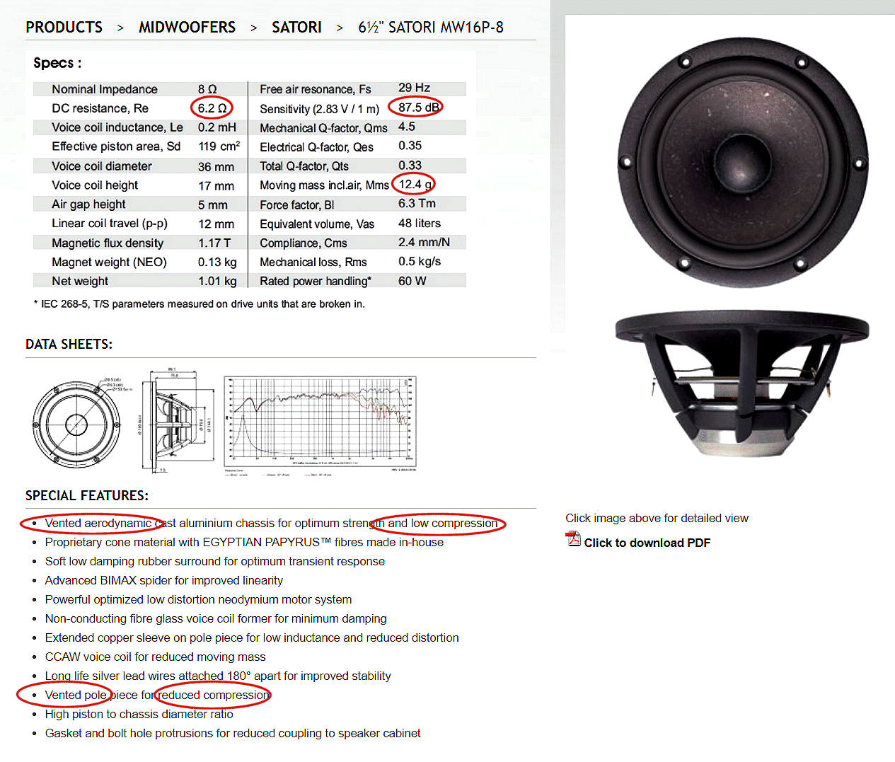

I am taking a bit more interest in the Sartori MW16P-8 and the only slight downsides are the lower sensitivity, this is due to Re being 6.2R an where it was 5.7R aand the slightly higher cone mass 12.4g up from 11g.
Note where it says "low compression" and "reduced compression" and "vented aerodynamic" - I have no doubt this is a reference the thermal compression. From the beginning, this was always a big consideration from the first Elsinore speaker when it was first conceived back in 2004, running the voice coils much cooler than usual. But it is interesting that heat and compression are clearly associated/connected in their minds too.
Has anybody noticed that the Elsinores are effortlessly dynamic? That's why!
Interestingly, line source speakers also run very cool internally. So there is an influence of line source influencing Elsinore development.
The other thing that I can see is that the radiation pattern, going on their measurement, is more consistent, the on axis is smoother and less elevated above 2KHz, 30 degrees of axis near on par, perhaps Sartori slightly better, but 60 degrees the Sartori wins hands down.

It won't be a rush, but perhaps in 2019 there could be a Mk7 'Pro' - but it will clearly be costlier. The tweeter and waveguide will be the same. The box will be the same, but the diameter of the driver is different, the Sartori being slightly smaller. The crossover will of course be different, but perhaps not by a large degree, but definitely some values will need to be changed. I can see that 1.5uF will be needed instead of 1.8uF for the tweeter. The box will also need a longer port as we need to tune down to 31-32 Hertz.

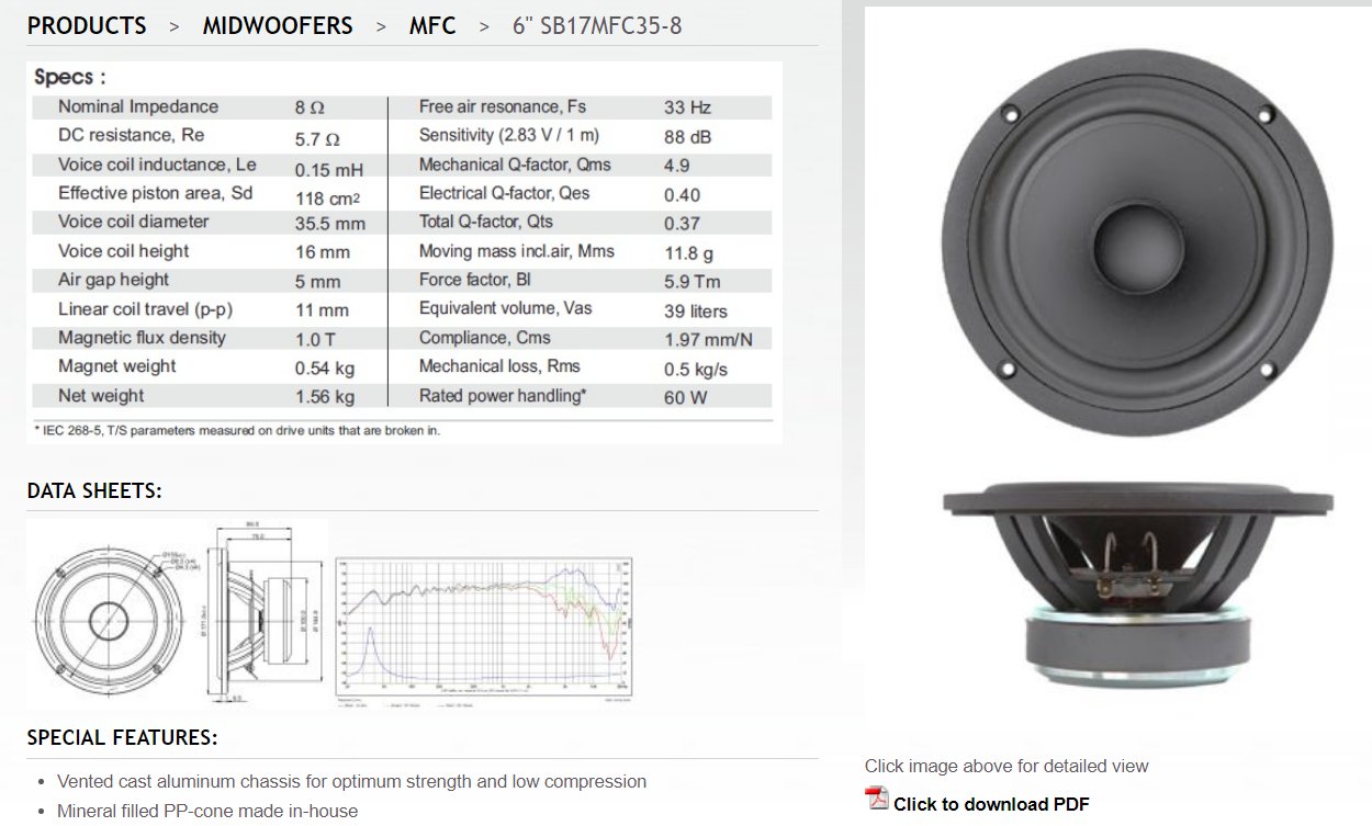

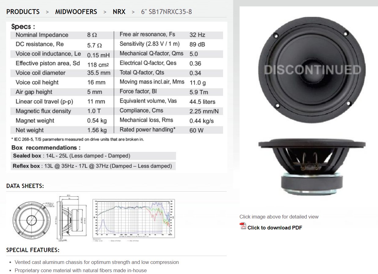

Sorry for the delay, been considering things re finding a replacement, but SB17CRC35-8 is not the one. A drop of 2dB is just a bit too much and due to cone being heavy at 13.3gr - but I have this one in mind:
SB17MFC35-8
This only has a 1dB drop and that is the same as Peerless Nomex HDS driver.
I would prefer a fibre cone, definitely not so much metal and ceramic cones, but the SB19MFC35-8 is a mineral loaded PP cone. Interestingly, the motor system is the same and the PP driver version is a bit more expensive than the fibre cone we have been using - this means that the mineral loaded PP cone is more expensive to make and that is reflected in the price.
I have attached both fibre and PP cone versions specs below, if anything, the response above the 'knee' of the driver (the frequency when the driver stops working as a piston) looks smoother according to SB's plot.
The 1dB lower sensitivity should mean that the sensitivity is still somewhat above 90dB. The voice coil will run 20-25% warmer, but so was the Peerless HDS and so not too bad.
Since coil and motor system is the same, has the same low rated inductance of 0.15mH, I see little need for change in the crossover, the only one would be an increase on the series resistor on the tweeter, it is 2R and I would increase to 3R or 3R2 - and that should be it.

Just a few more notes on the differences between drivers. The both use the same motor system, so the cone is what sets them apart. The key here is the difference in mass, our original driver is 11.0gr and the new 11.8gr. That would explain the 1dB difference in output, 89dB reduced to 88dB because of the higher cone mass. The other difference is a slight increase in Qes, which means slightly less electrical damping, but mechanical damping not changed. The slightly lower Vas offsets it. The Fs has barely changed.
Bottom line: The driver will work in the same box alignment with very little change, keep the port 100mm long. Build the box exactly the same way as before.
Mineral loaded cones are used by Dynaudio drivers, and very good results, this is not going to be a bad driver going ahead. It is just a little bit more expensive, but not by that much.
