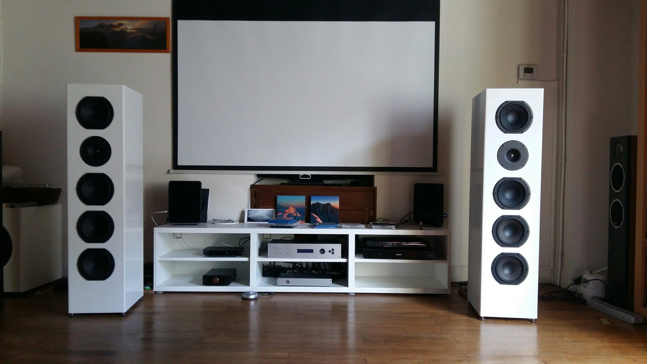

Hi David,
FYI I've build my Elsinore with 19 mm MDF and bitumen pads.
I've reduced depth of the boxes from 380 mm to 360 mm to keep the same internal volume.
BR, Pascal
