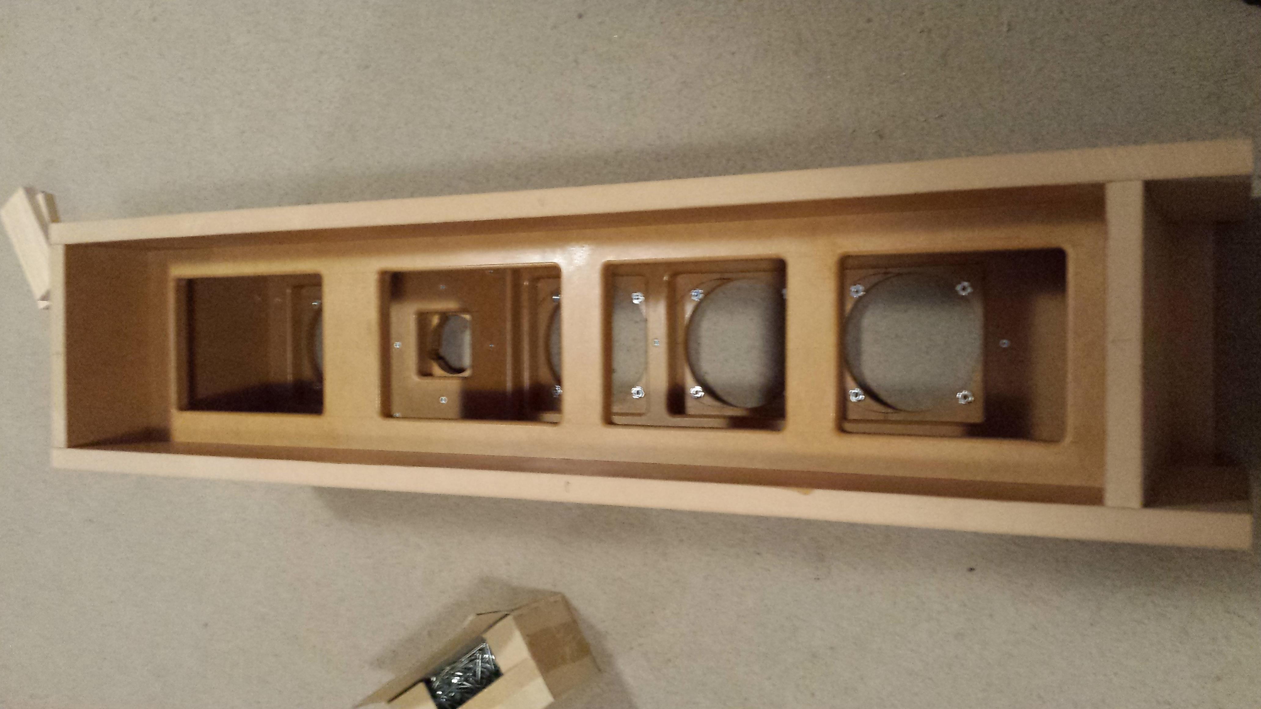

Hi David,
FYI I've build my Elsinore with 19 mm MDF and bitumen pads.
I've reduced depth of the boxes from 380 mm to 360 mm to keep the same internal volume.
BR, Pascal
Pascal,
Thanks for the info, and the picture of your speakers. What thickness of bitumen pads did you use? From what I have read, one needs to build up a pretty thick layer to effectively dampen the enclosure walls, something like 6 to 8 mm, which would take up most of the increased volume if the exterior dimensions are the same. Is the enclosure quiet and free of resonances? I have also been considering use of CLD by adding 1/4" (6mm) HDF panels bonded with a thick layer of polyurethane glue, which retains some resiliency instead of using bitumen pads.

Pascal,
David
I've used 7 mm bitumen pads (5.5mm felt + 1.5mm bitumen pad) :
Insonorisant Infrasound feutre sur masse bitumeuse - comptoirauto.com
I've build my Nomex 164 from TG before the Elsinore also with this combo MDF 19 mm + 7 mm bitumen pads. Both enclosure are OK for me IMHO.
BR Pascal

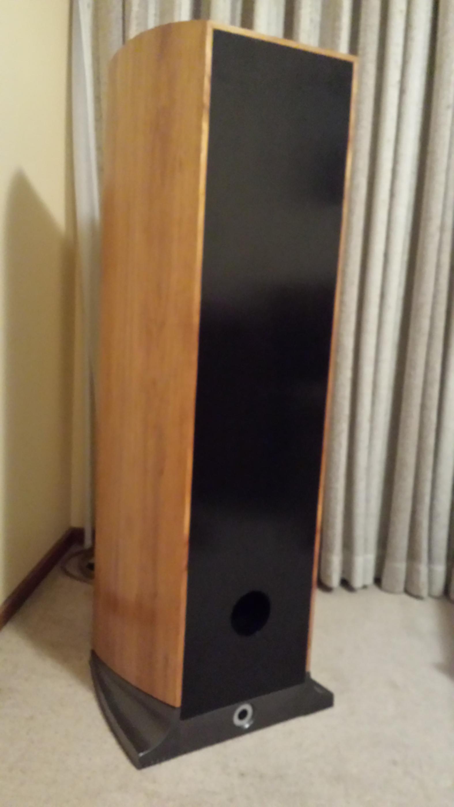

I'm not sure it's a good idea to put the crossover inside, but it can be mounted on the back of the cabinet. See posts #2407 & 2415.
Port is 90mm diameter and 100mm in length mounted flush with rear of cabinet. 90mm storm water pipe is used.

Thanks irext.
I can´t get a port with 90mm inner diameter, so i will use a 100mm with 135mm length.
I hope the new length is ok.
Don’t guess: http://p10hifi.net/FAL/downloads/ChangingPortSize.pdf
dave
Very good advise since 90MM stormwater pipe seems to be an Australian standard only and not available in other countries.

The Australian 90mm pipe I have here measures around 90.5mm outside diameter and around 87mm inner. Wall thickness not totally uniform being between 1.6 and 1.8mm.
What would be the difference be between 87mm and 90mm be with 100mm length? The 87mm will tune to a fractionally lower box frequency, but much to worry about.
