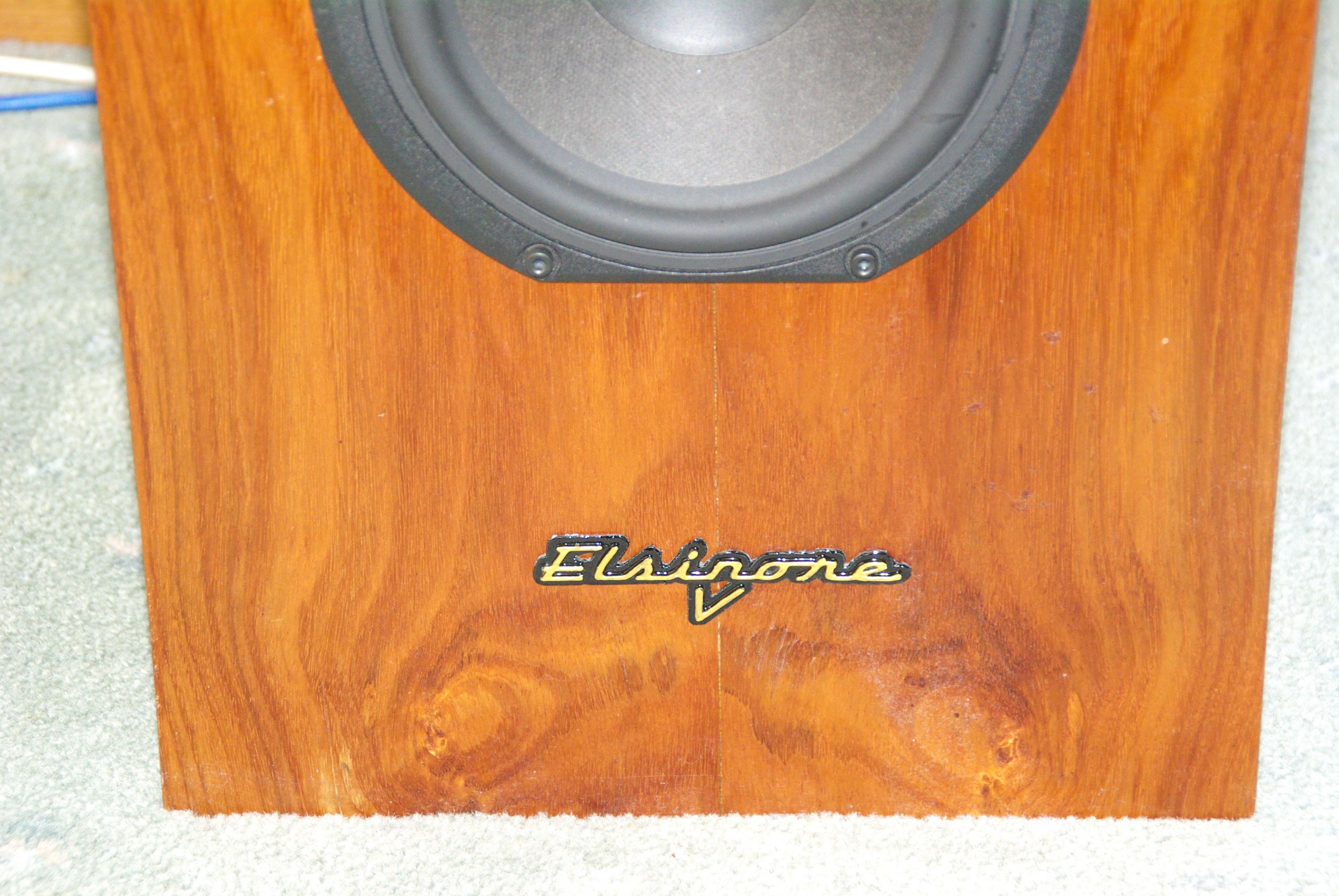

The final touch (after 4 years). With thanks to oZmoZis and his 3D printer.
Nice!
You are tempting me? Maybe I should get a 3D printer and find interesting uses for it?
They are getting cheaper all the time. They used to be thousands of dollars not long ago. Now they are hundreds. I think I paid around $600 back in the early nineties for a dot matrix printer! Hard to imagine.
