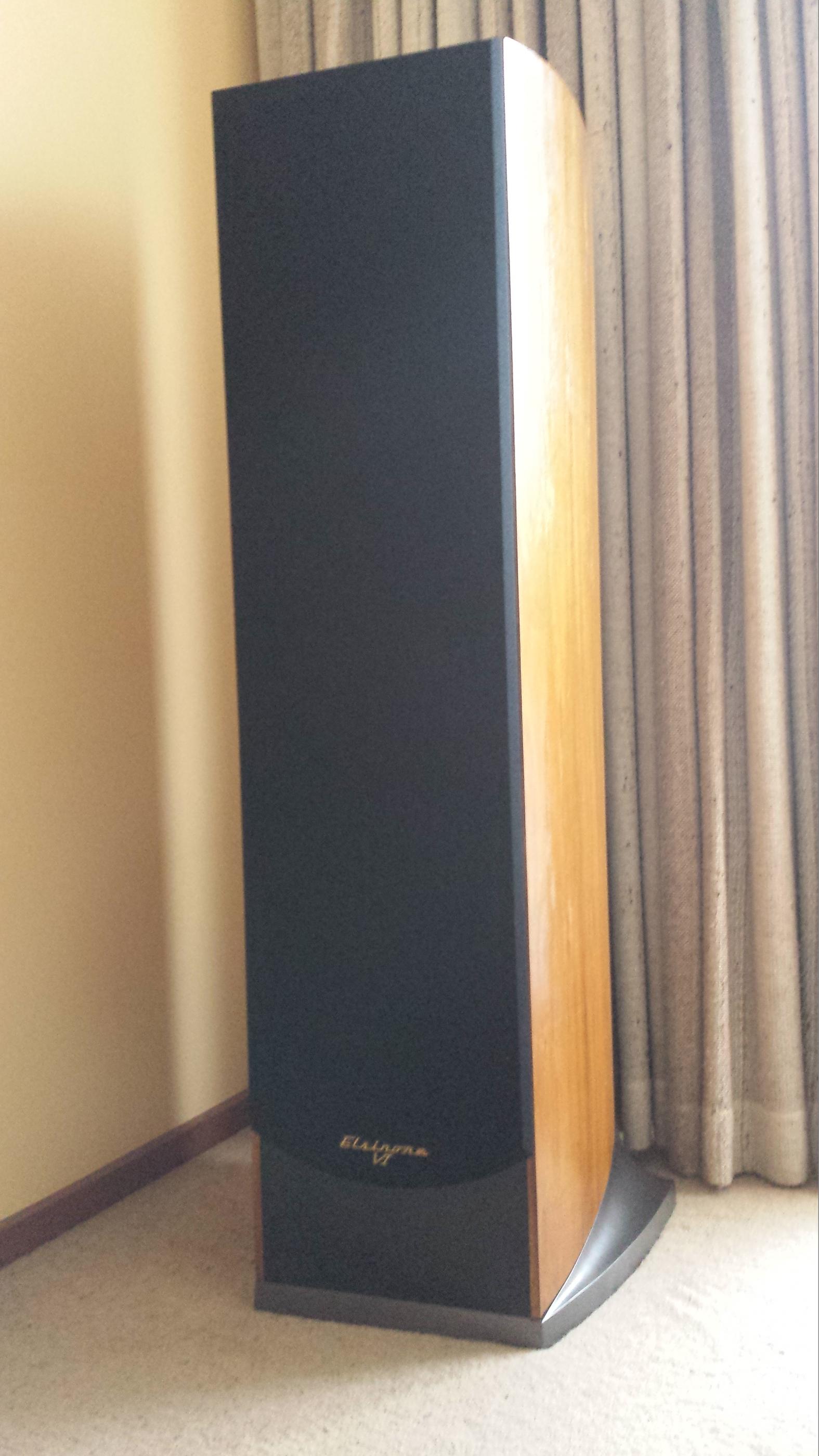

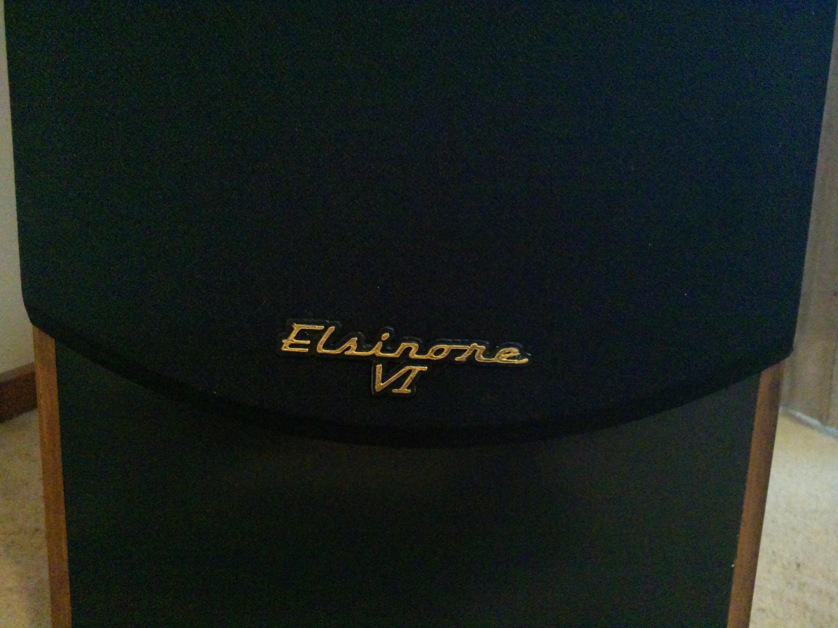

Made some grills for the Mark VI and fitted them with a badge. During construction i embedded some rare earth magnets in the front panel.There are more magnets embeded in the grill so they are held in place without physical couplings. Therefore when the grills are removed there is no distruption to the finish of the front panels. I have attached a couple of pics.
OZmOzis,
Grills tastefully done - good addition to an already handsome set of speakers.
Embedded Neodymium magnets for holding up the grilles is a smart way of enabling the grill option, and at the same time preserving the clean look of the front baffle sans any pesky little holes. Grills can come in handy, especially if there are kids in the house.
