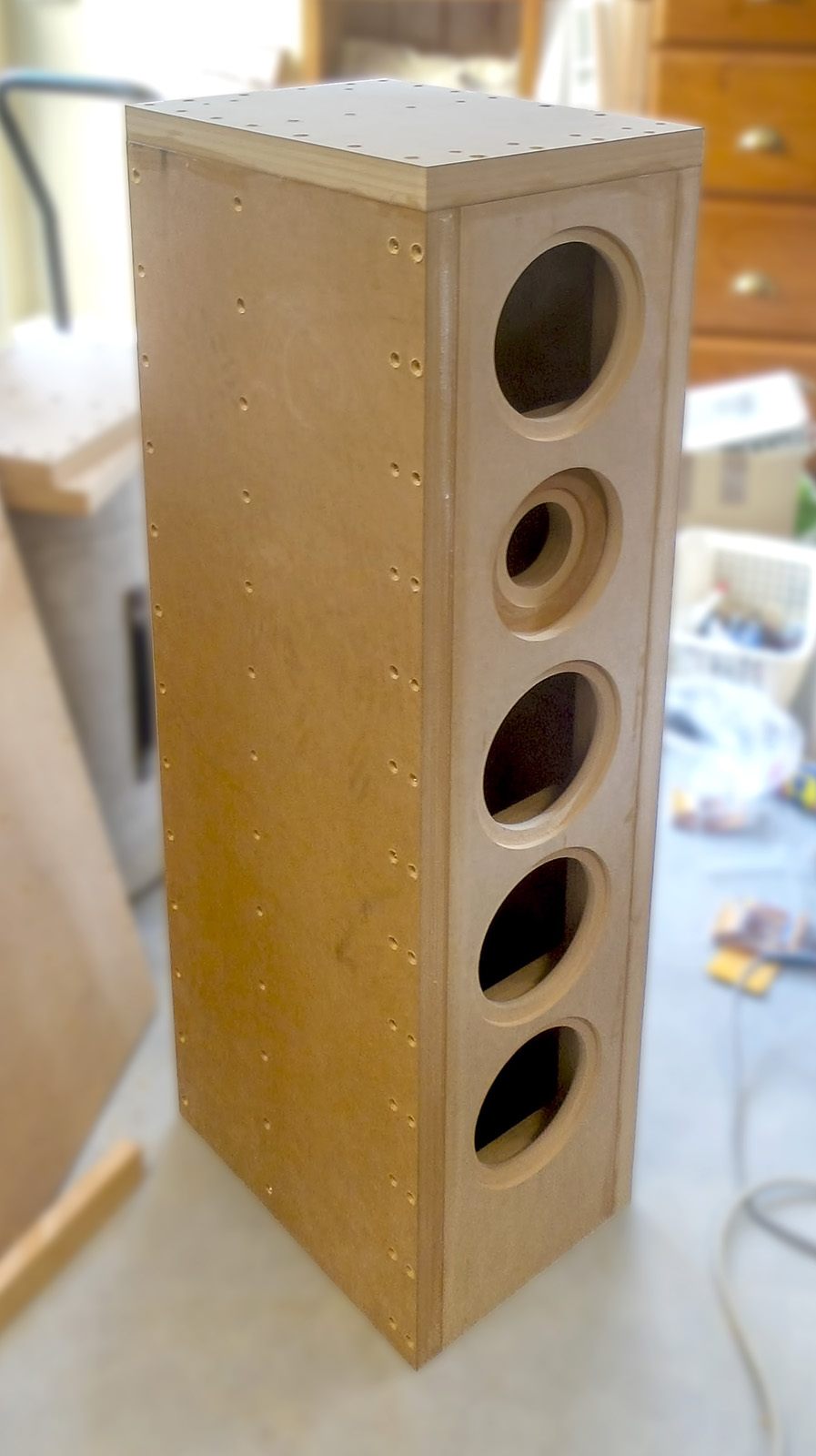

I completed building my Elsinores a couple of months back now and I am VERY pleased with them, Thanks heaps Joe.
Joe R. and the late Allen Wright always steered me in the right direction.
My Elsinores are plain satin black. A good friend of mine kindly created CAD files of all the MDF parts and I then payed a commercial CNC company cut all the MDF exactly to size. That made assembly very easy. I then had the enclosures professionally spray painted.

can you post some photos?
I'll upload a couple of pix shortly
The guy with the big flatbed CNC machine who cut all my MDF pieces offered to cut all the 25mm thick pieces in 32mm MDF because he had plenty in stock and would have had to buy in the 25mm. So I thought why not? So we had to adjust sizes in the CAD files to have exactly the same final volume. They ended up 14mm taller, 14mm wider etc, etc... and just that bit heavier to lift. (BTW For those who requested copies of the CAD files I given you the version for 25mm MDF)

Here are a couple of pix

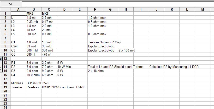

I am going to get some prices for professionally etched PCB's. They are done on a panel basis so you fit as many boards as you can to a panel. At present I am etching them at home which gives a nice result but is quite labour intensive. For an outside company I simply give them the Protel file and the boards are sent to me. They can even have screen printed overlays etc at an extra cost. As for different components, I've designed them using Jantzen Inductors, resistors and for the C1 cap (Superior Z cap) which I feel is as good as they need to be and overkill in some areas. If you are going for foil inductors etc they will not fit and I have no real plans to do a PCB for them. Otherwise unless the components are vastly different in size they should fit. I have taken great pains to eliminate inductor crosstalk and as you can see separated the LF and HF sections to separate PCB's. So stay tuned and as soon as I get some quotes and work out costs I will post some prices. I hope you are O/K with this arrangement Joe R. I don't want to step on any toes.

Have you made any progress on finalizing pricing for your crossover pcbs? An ETA would be great, if you don't mind. Also, would you mind posting the BOM for the components used on your crossovers? I'd like to order parts relatively soon.

Hi Scott. Sorry I haven't got any further with getting them done professionally yet but I'll send you my parts list in the mean time. There always seem to be something else more pressing to do but I will get to it. All the components I used are Jantzen and I can attest (and so can oZmoZis) that they sound very good.
