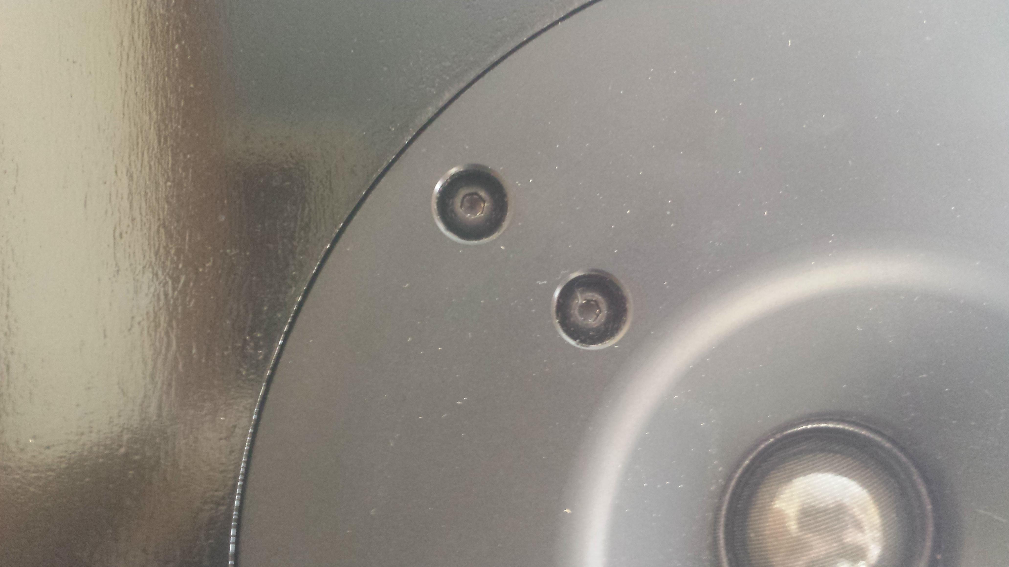

Well spotted:
Thanks Joe...
I didn't think to post the picture.
Look at the two holes on either side of the voicecoil assembly. Those two holes line up with two studs on the magnet/motor so it only goes on one way.
It is easy as pie and or a piece of cake if you have to switch out or repair (the repair may not be easy, but taking it apart is), that voicecoil. You do need a small allen head socket I don't know what size off the top of my head.

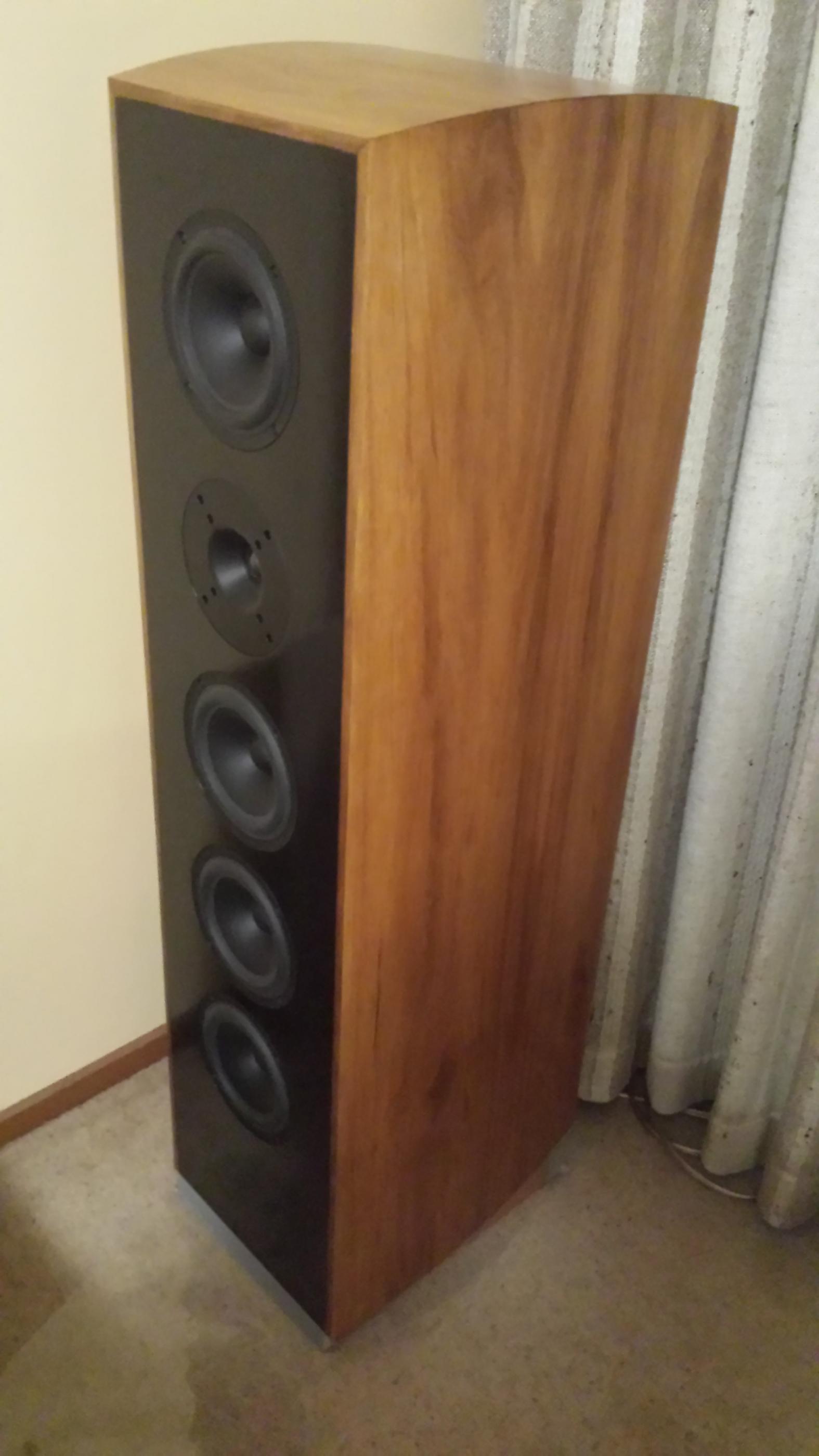

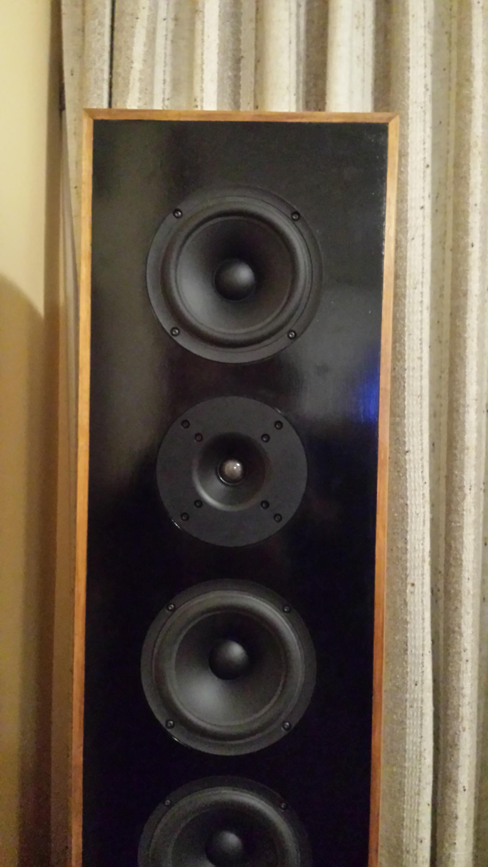

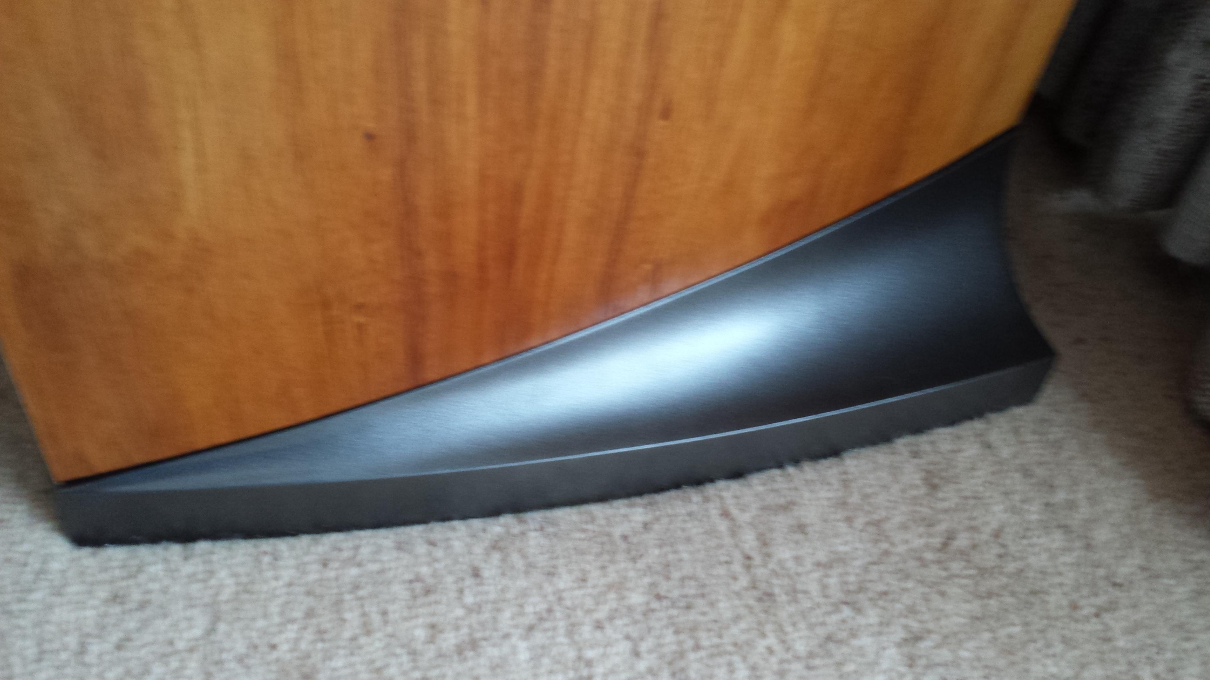

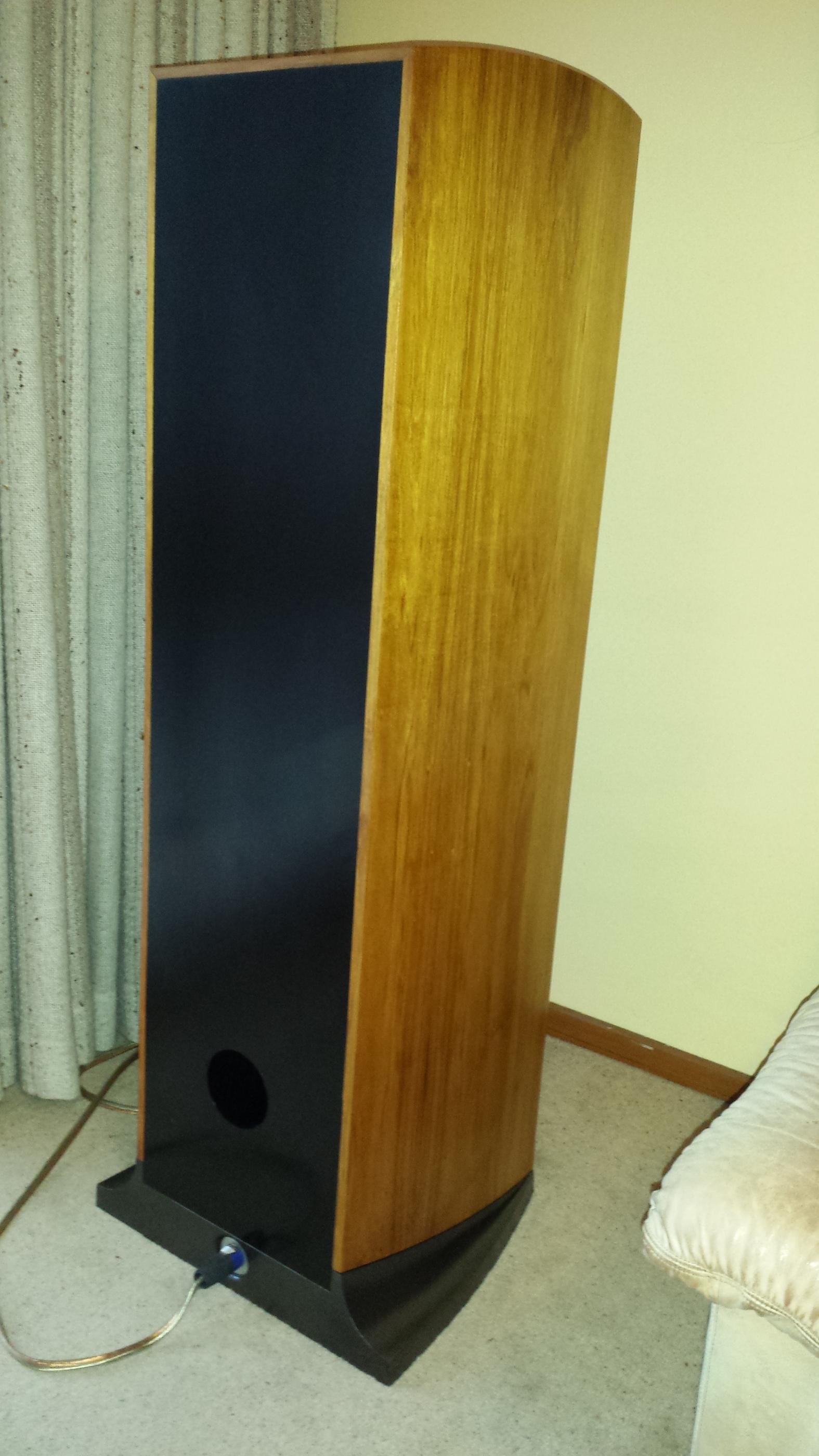

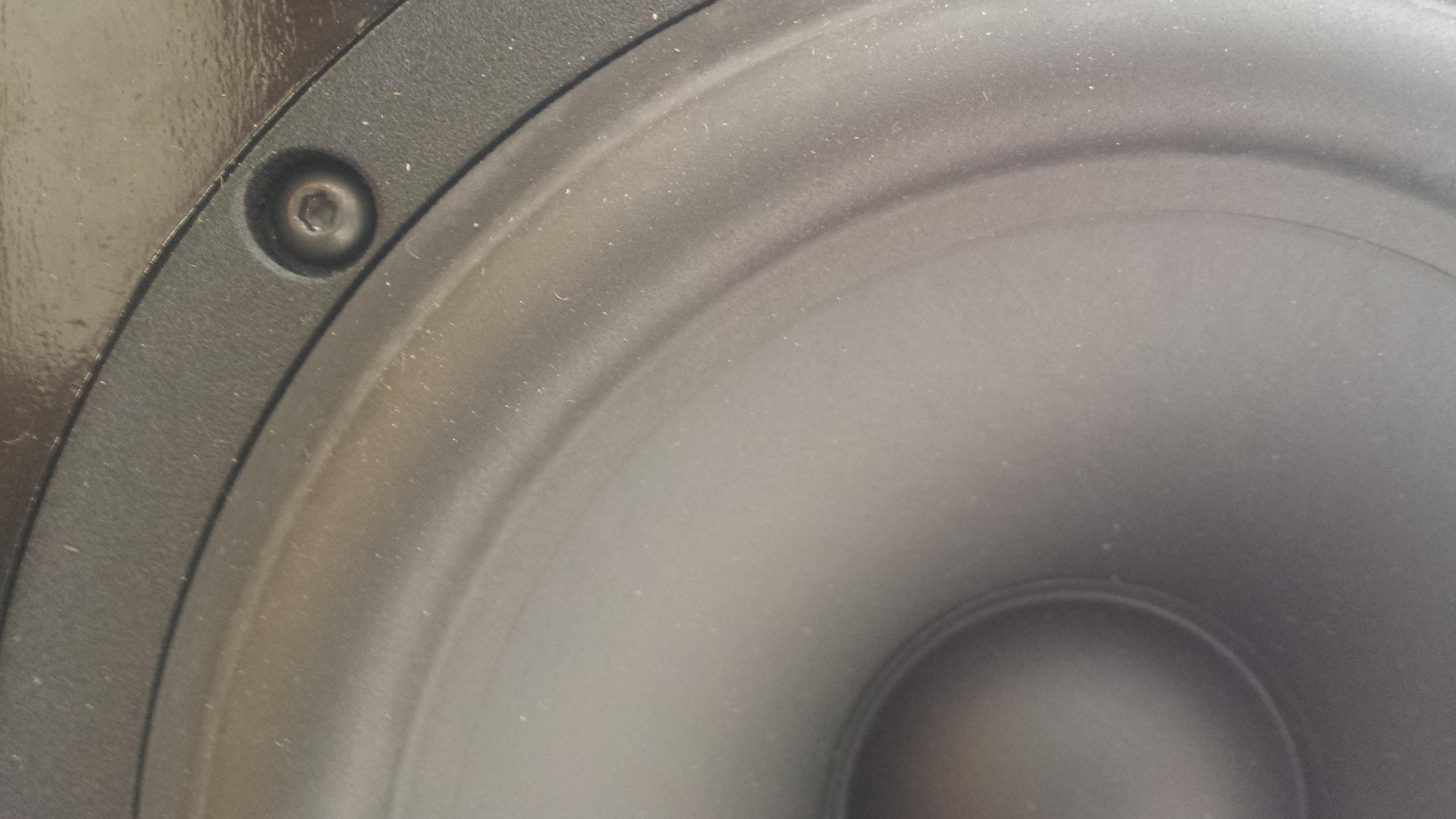

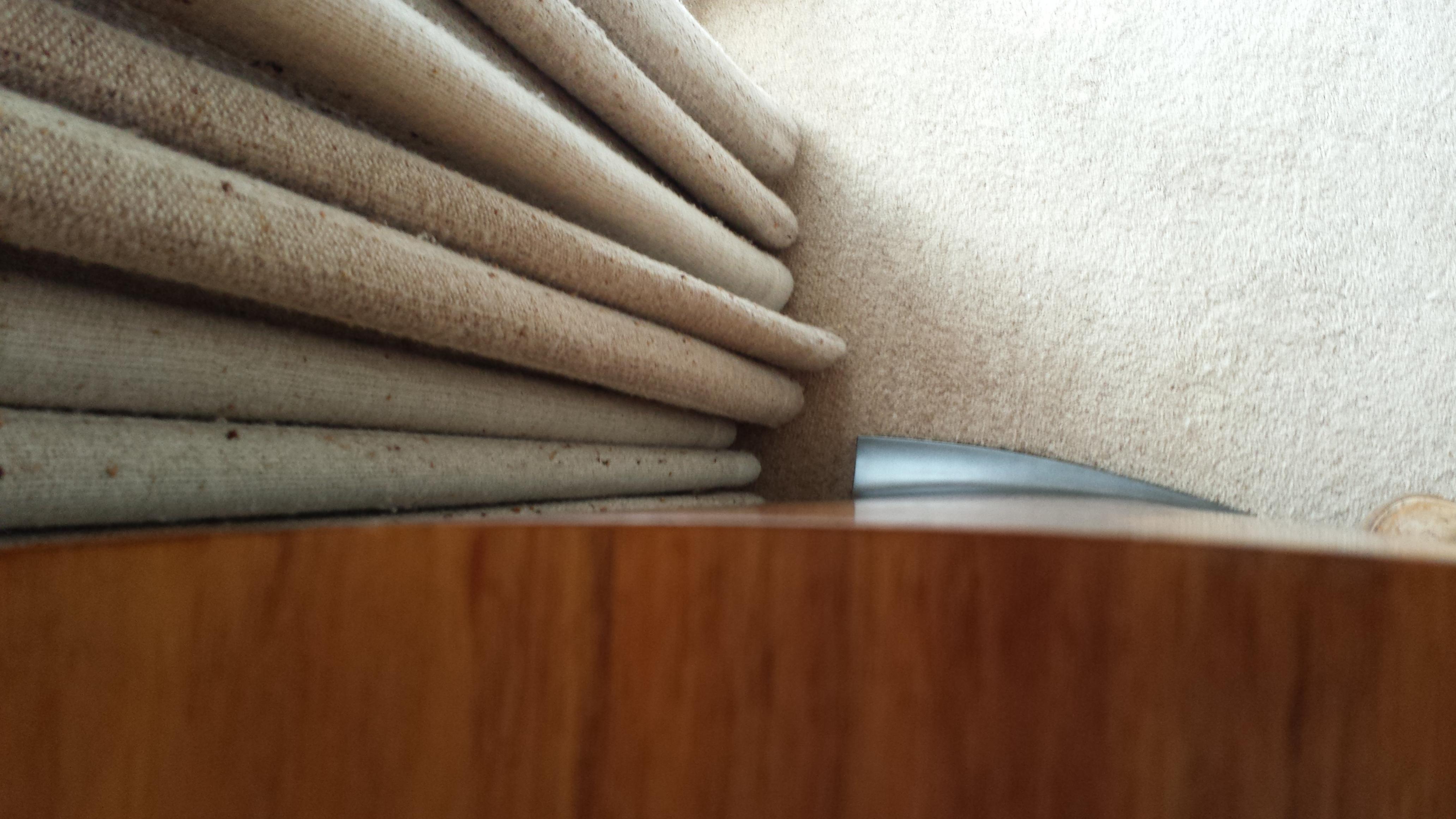

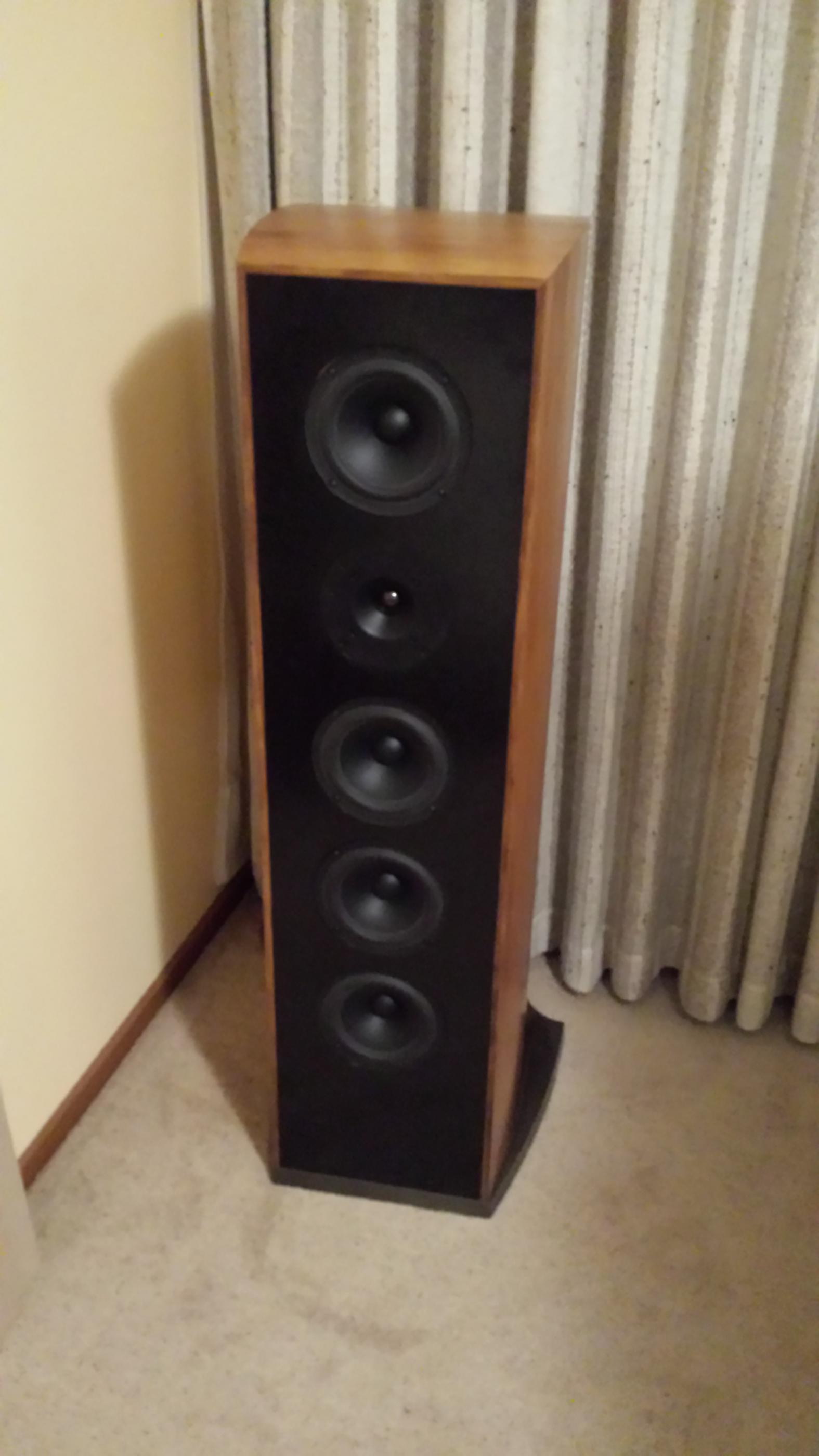

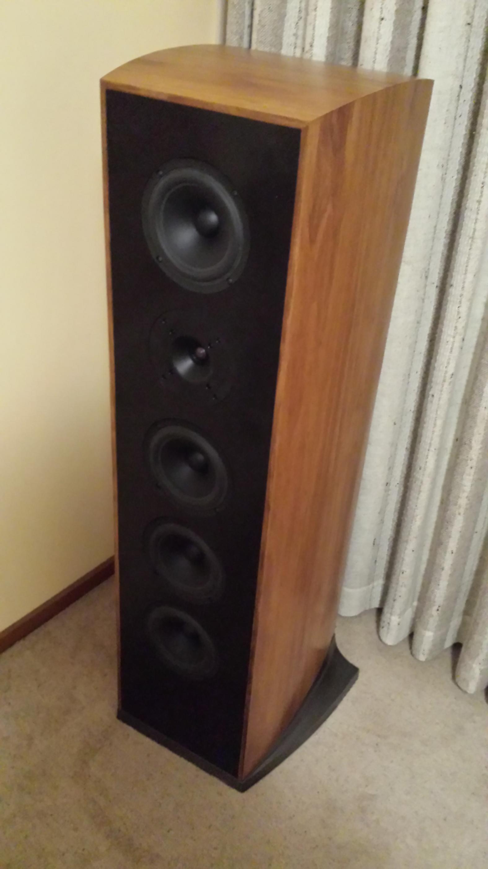

Hi guys. finally finished the speakers after 6 months of interupted work. Have uploaded some pics. i'm feeling pretty happy with the final look.
OZmOZis:
"Pretty happy"? I should think so. More photos and your reaction as the speakers break in, please!
Scott
Scott
Woah! They look great!
They turned out beautiful. The curves add an elegance and flow to the cabinets that is really quite striking. Very, very nice.
What type of wood veneer did you use?
Like a work of art.... and heart... 😀

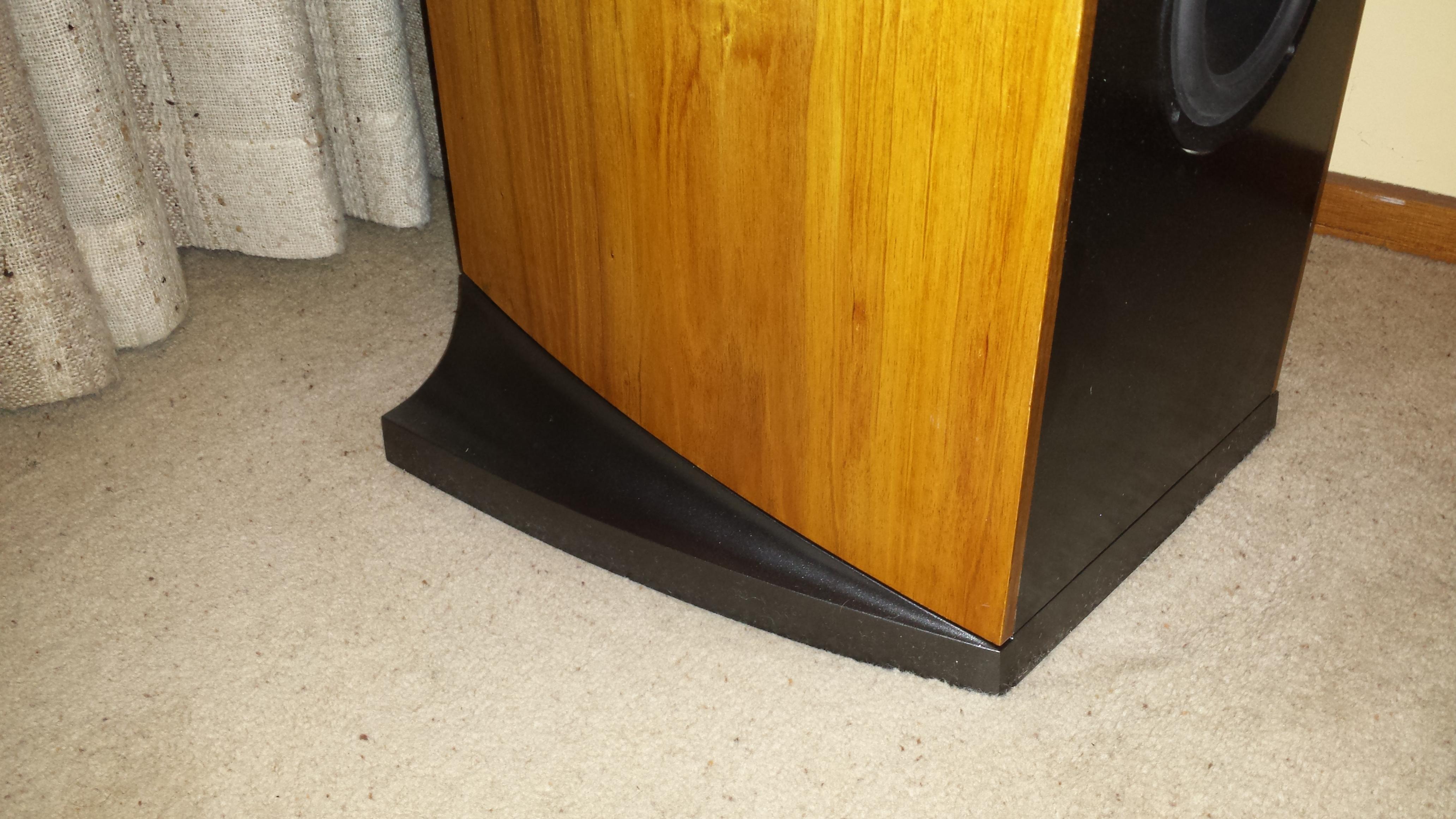

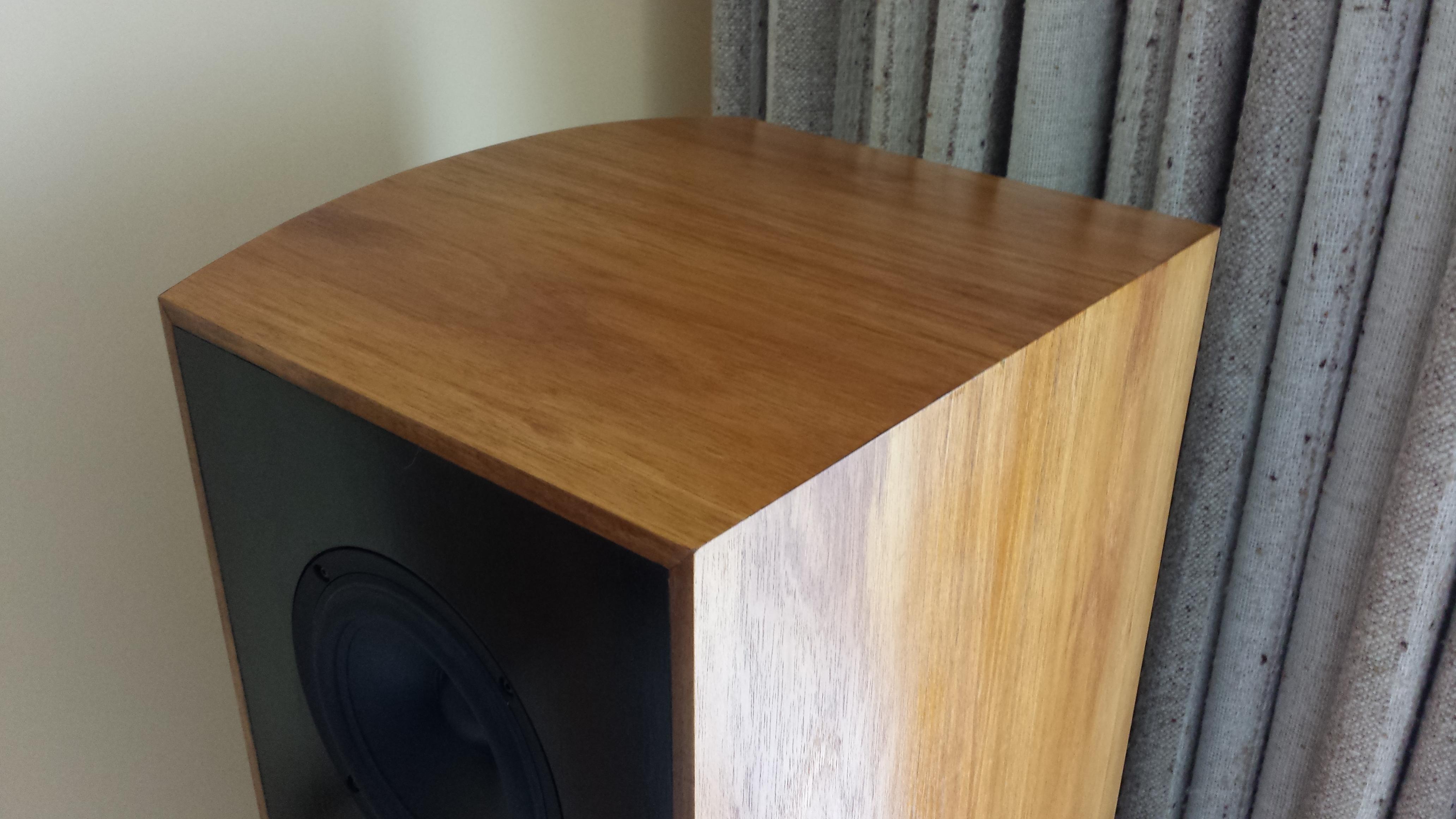

Thanks for the kind words guys. I took some more photos minus the grubby finger marks. The timber used is Tasmanian blackwood (Acacia Melanoxylon) It grows all down the eastern side of Australia but Tasmanian timbers are slower growing and perfect for furniture and Boat building. I love the geometry in the curved foot. As the height of the foot increases so does the radius of the fillet. This in turn created the graceful curve on the outer edge of the feet. The speakers are starting to open with use so i am listening to my music collection with new found enthusiasm.
