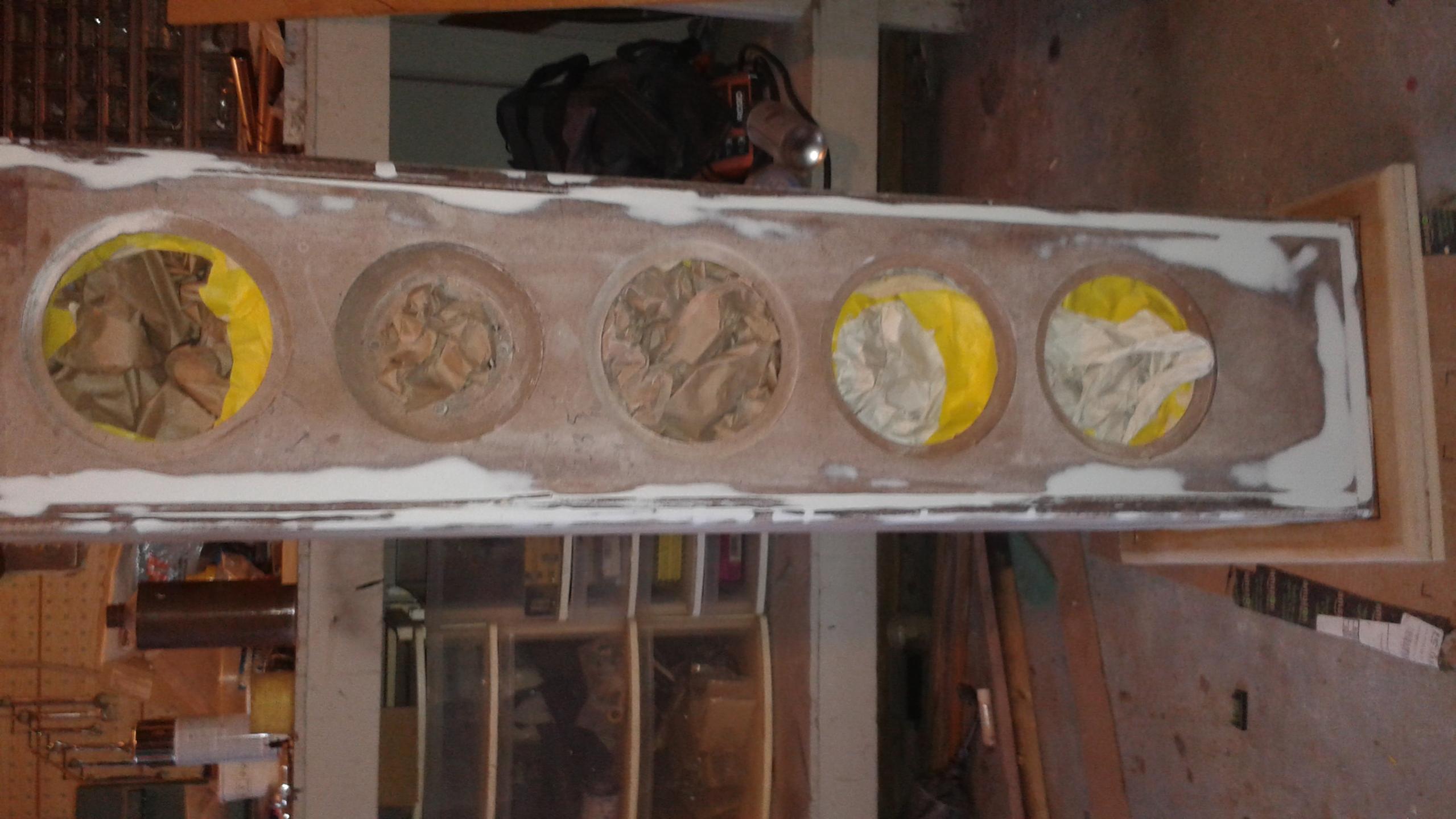

My plans to work on and finish these speakers didn't quite work out.
I had to watch my little girl Saturday, and today I tried to get them done but ran out of 2 things...time and primer. I use a 2k primer which gives the cabs a really strong substrate, and I have 3 different colors, and of course I ran out of the black. Which is fine because I would have been really upset if I could have finished them if I'd had the time and ran out of primer.
I'll get the primer tomorrow and if I get done early enough them be finished for sure tomorrow!

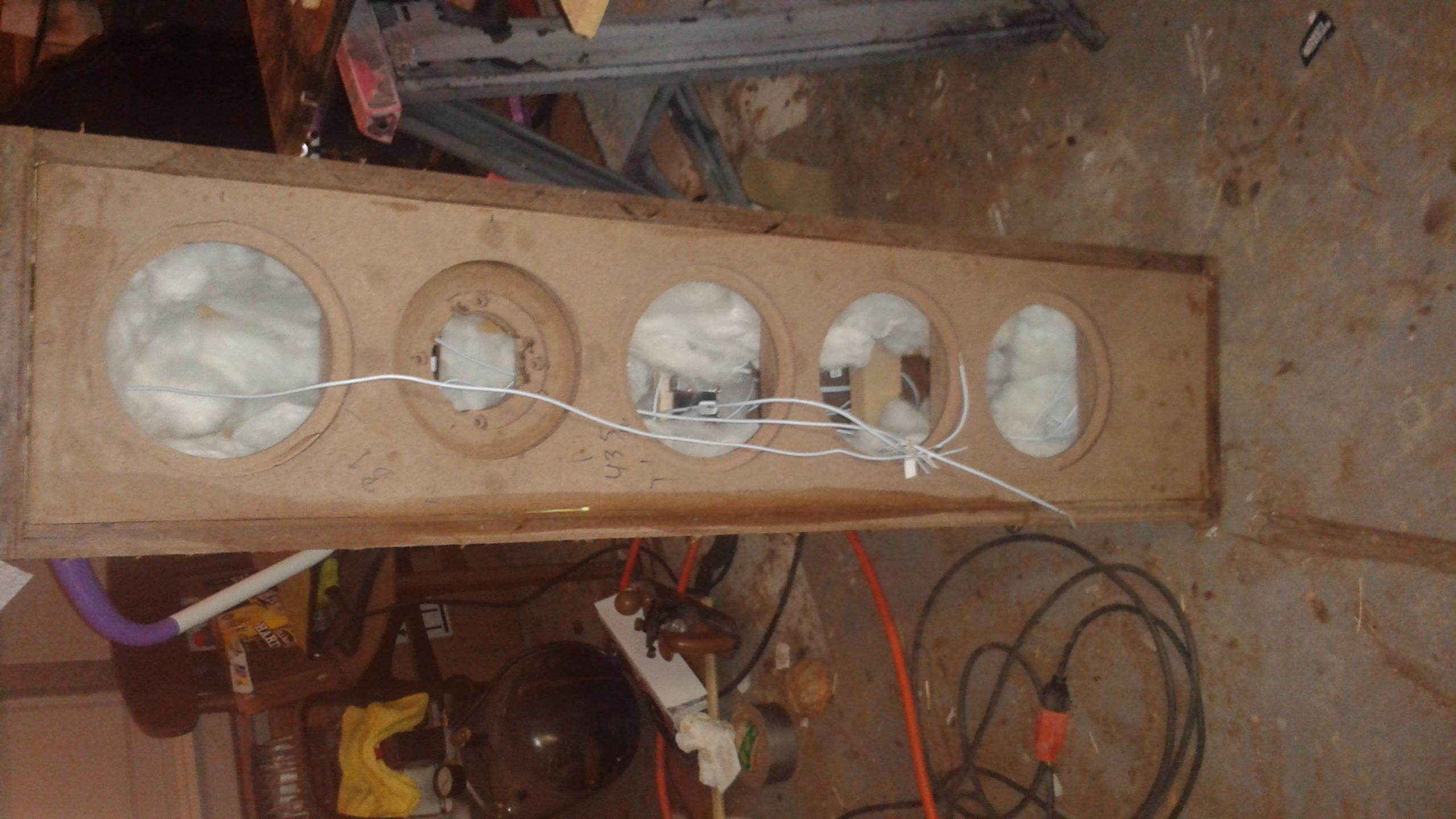

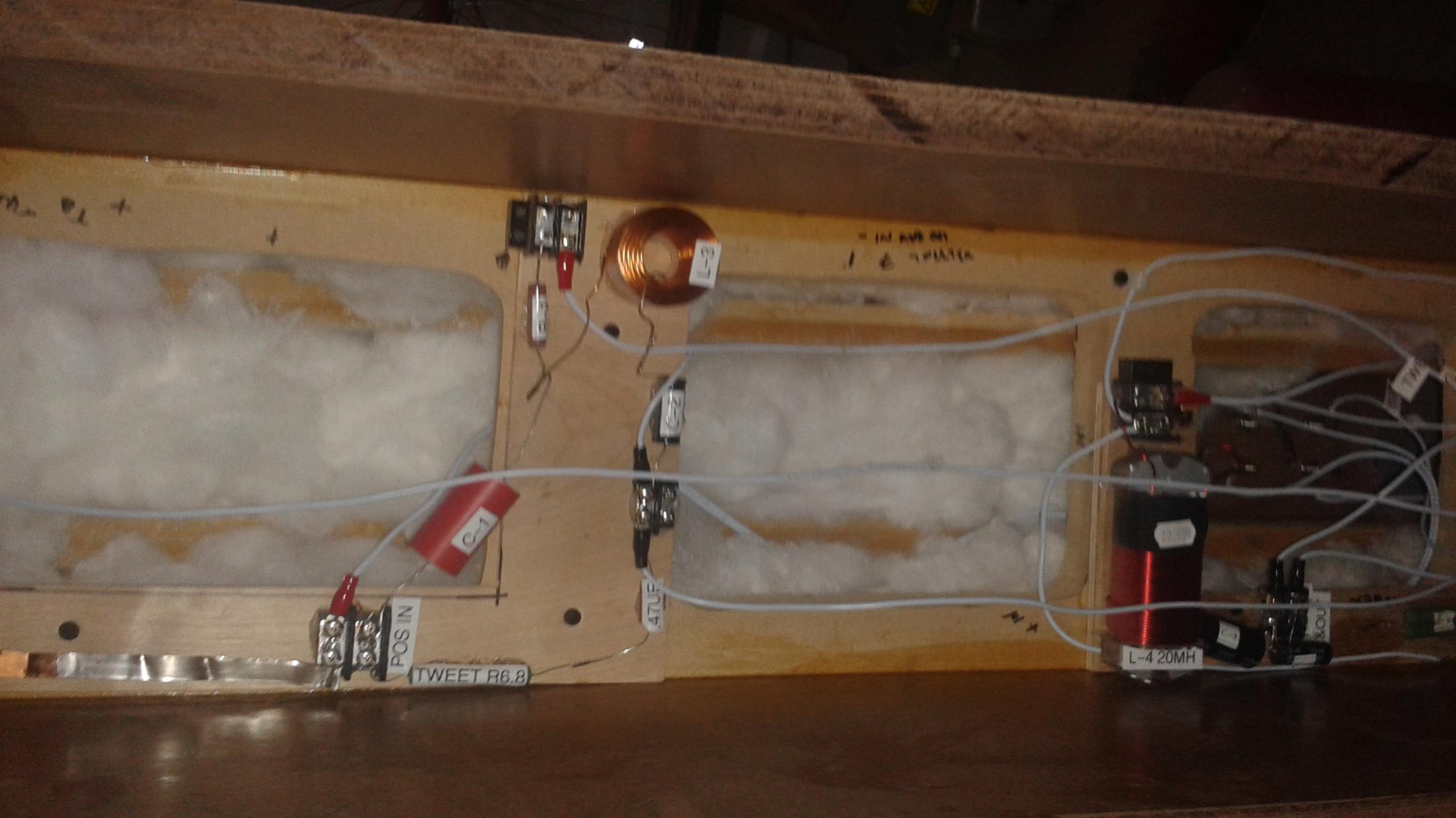

Here's the progress so far....I stuffed them with "Acousta-Stuf" Acousta-Stuf Polyfill Speaker Cabinet Damping Material 5 lb. Bag
The stuff fit in the back no problem, but I had to use spray adhesive to use it in the front of the cab. I tried not to use too much because it tends to work really well, and as it use I still used a fair amount of it.
Here's the newest pics.

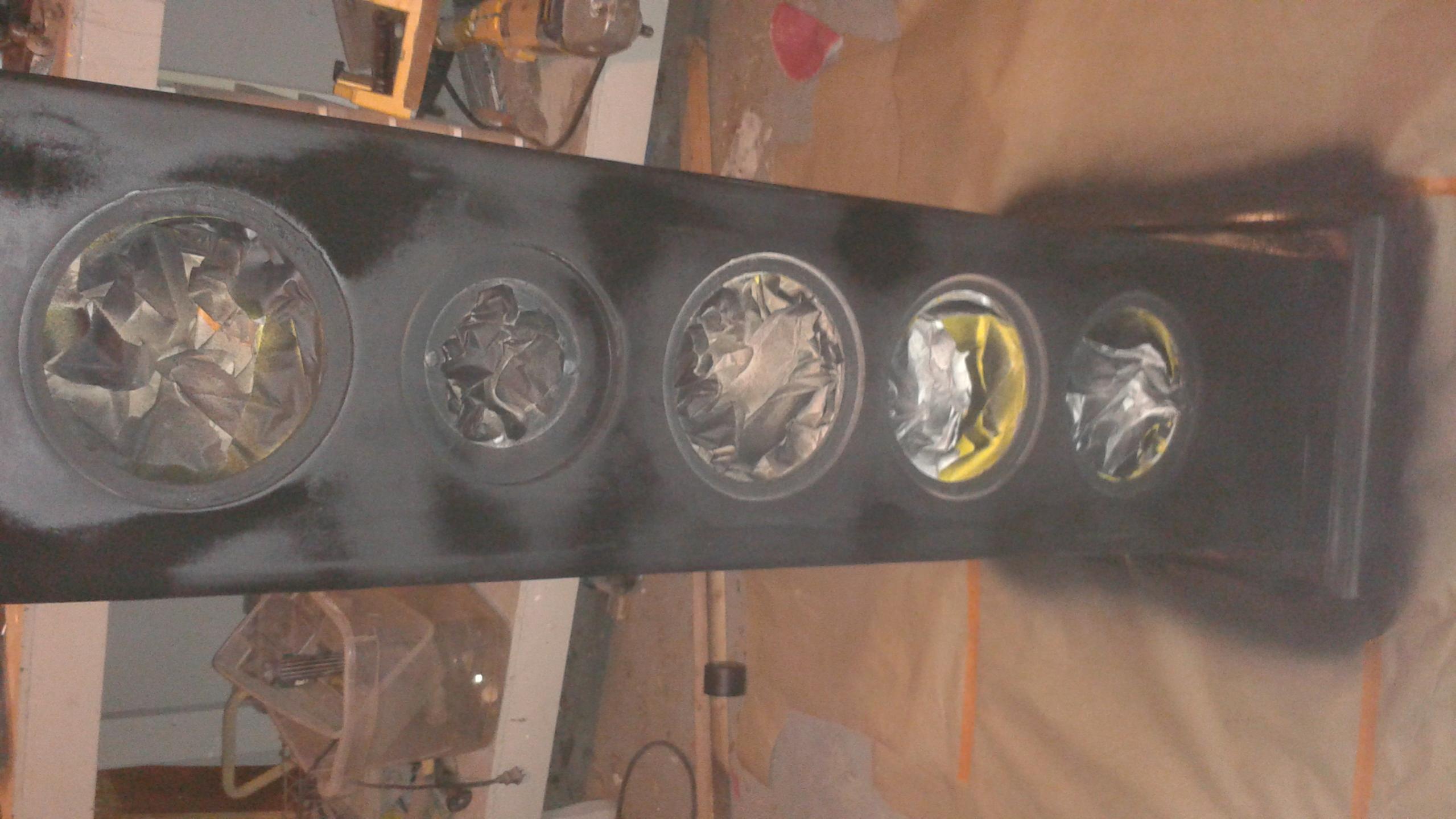

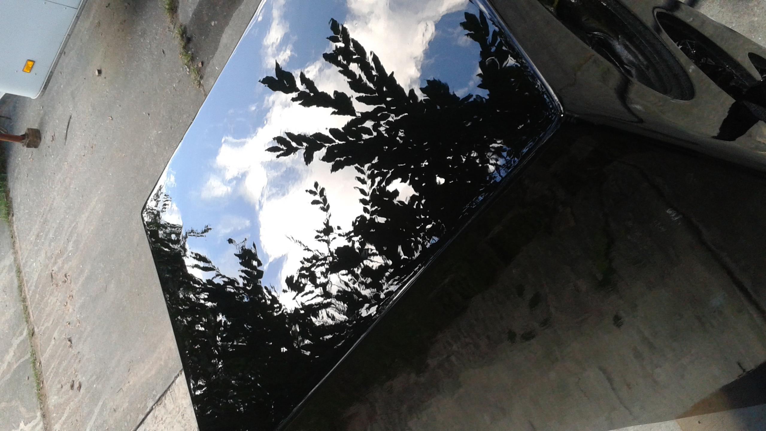

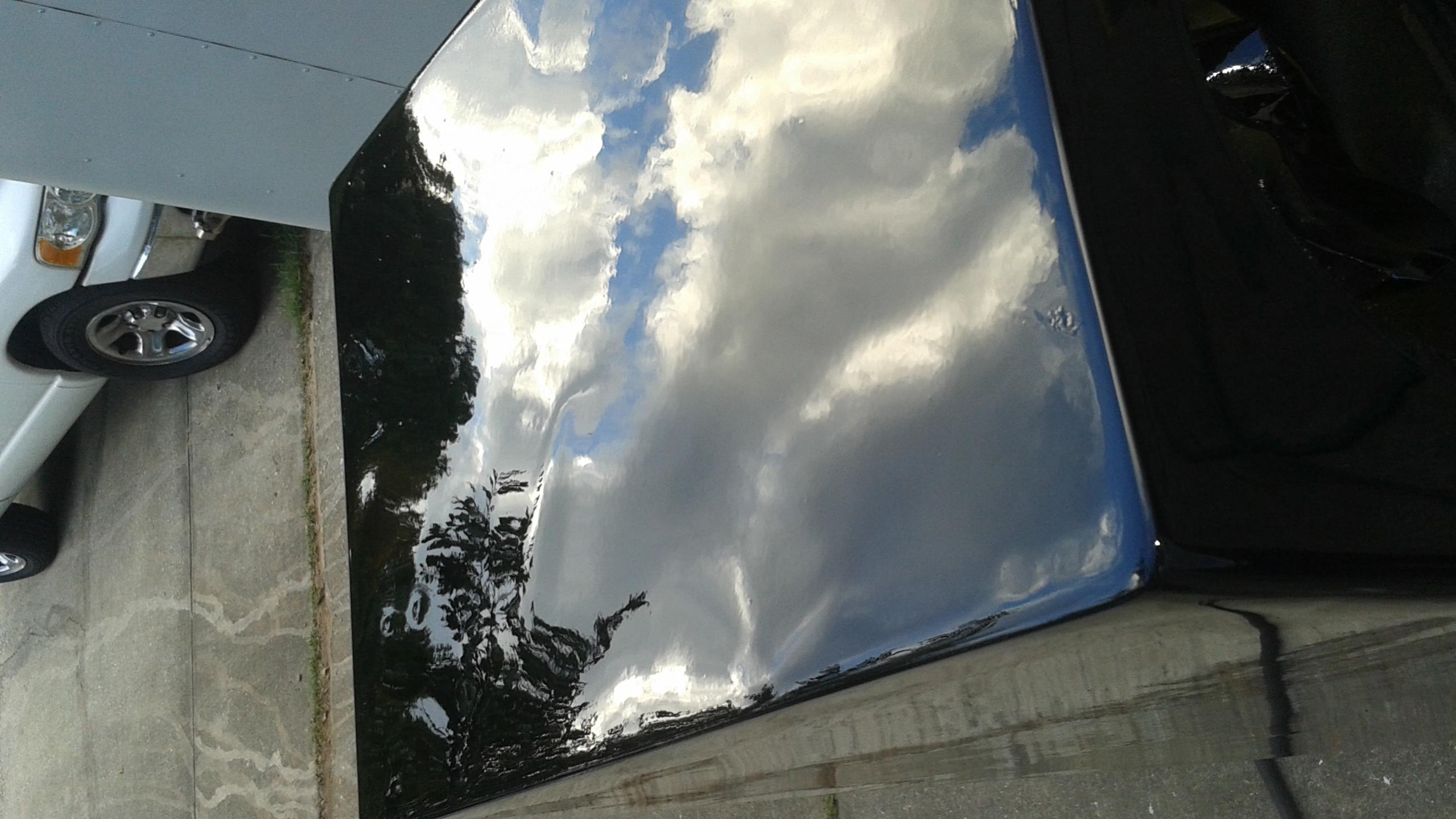

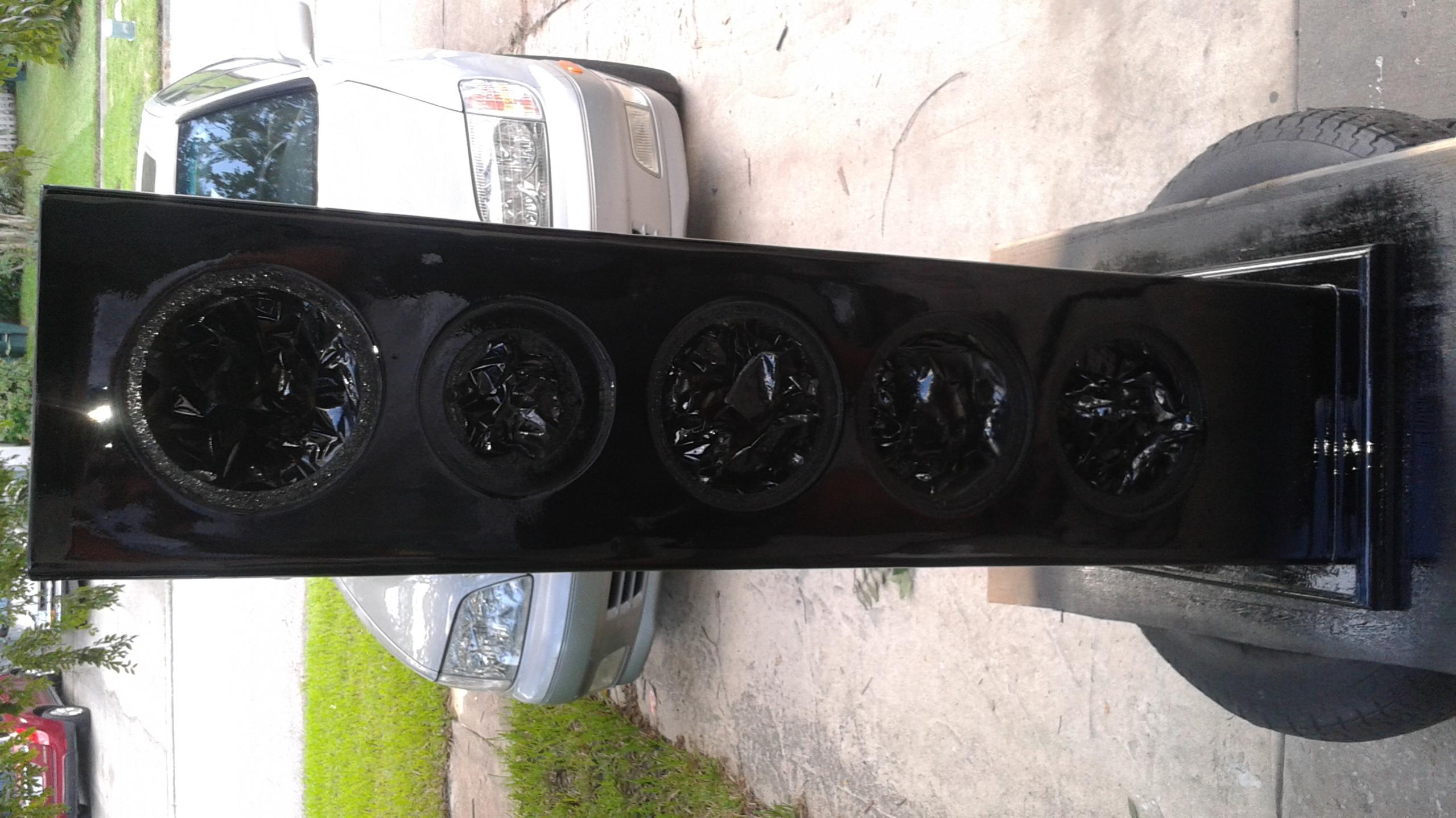

Painted...
I stayed home from work today, because my little girl got me sick, so I finished the paint work on these cabinets. I probably shouldn't have because I really feel like crap now...but the painting is done. I have to do a little wet sanding and buffing when I get the chance and then I can install the drivers and we are in business.

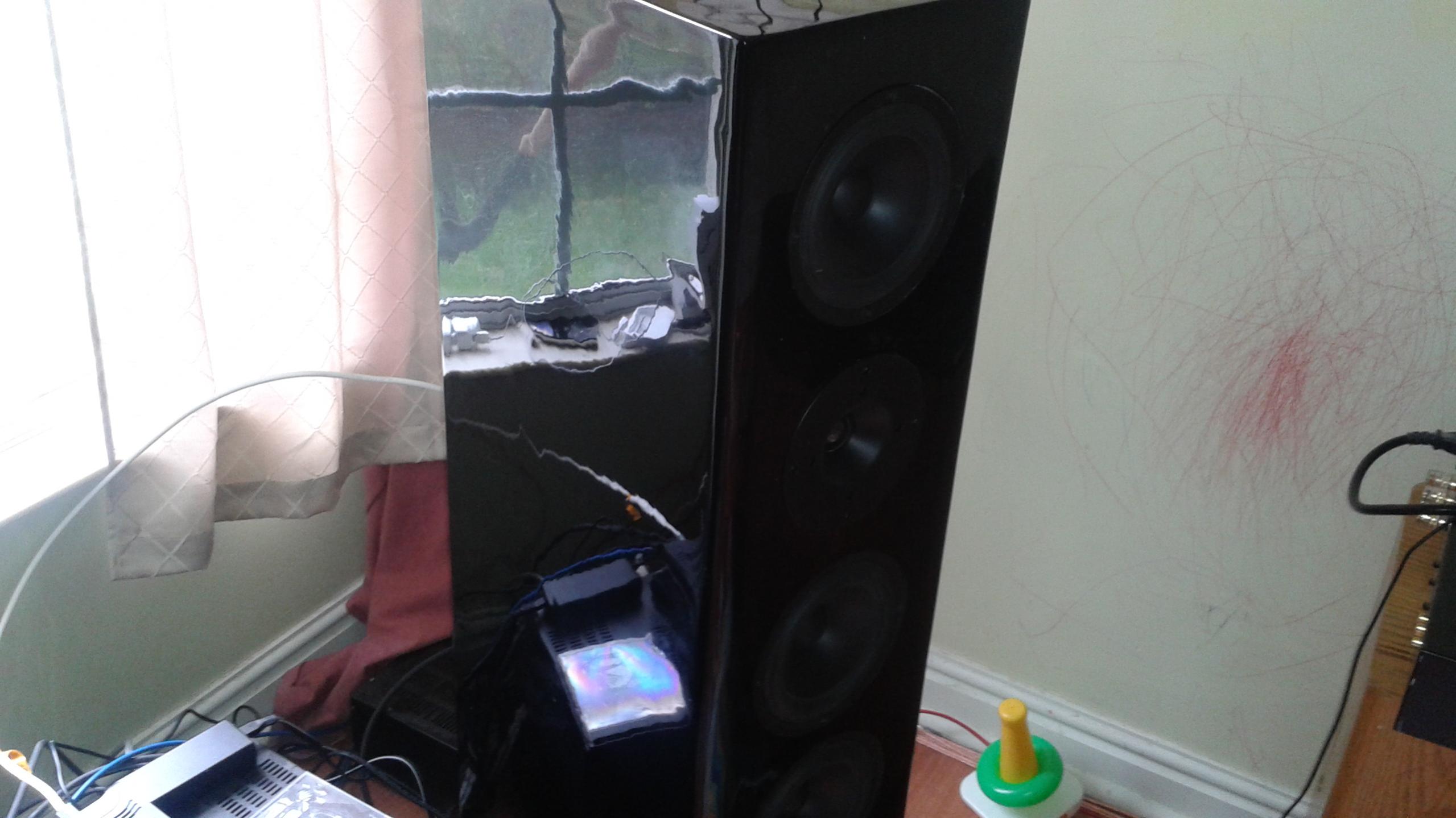

Here's what they look like so far.

Clausen:
Wow. Even without the final clean-up and buffing, they look very, very nice!

Nah, leave your build documented right here. Easier for folks to keep up with.
The paint job sure did turn out nice. I guess being in the business really came in handy. 😀 Nice work indeed.
Really starting to come together now. Can't wait to see the final results.

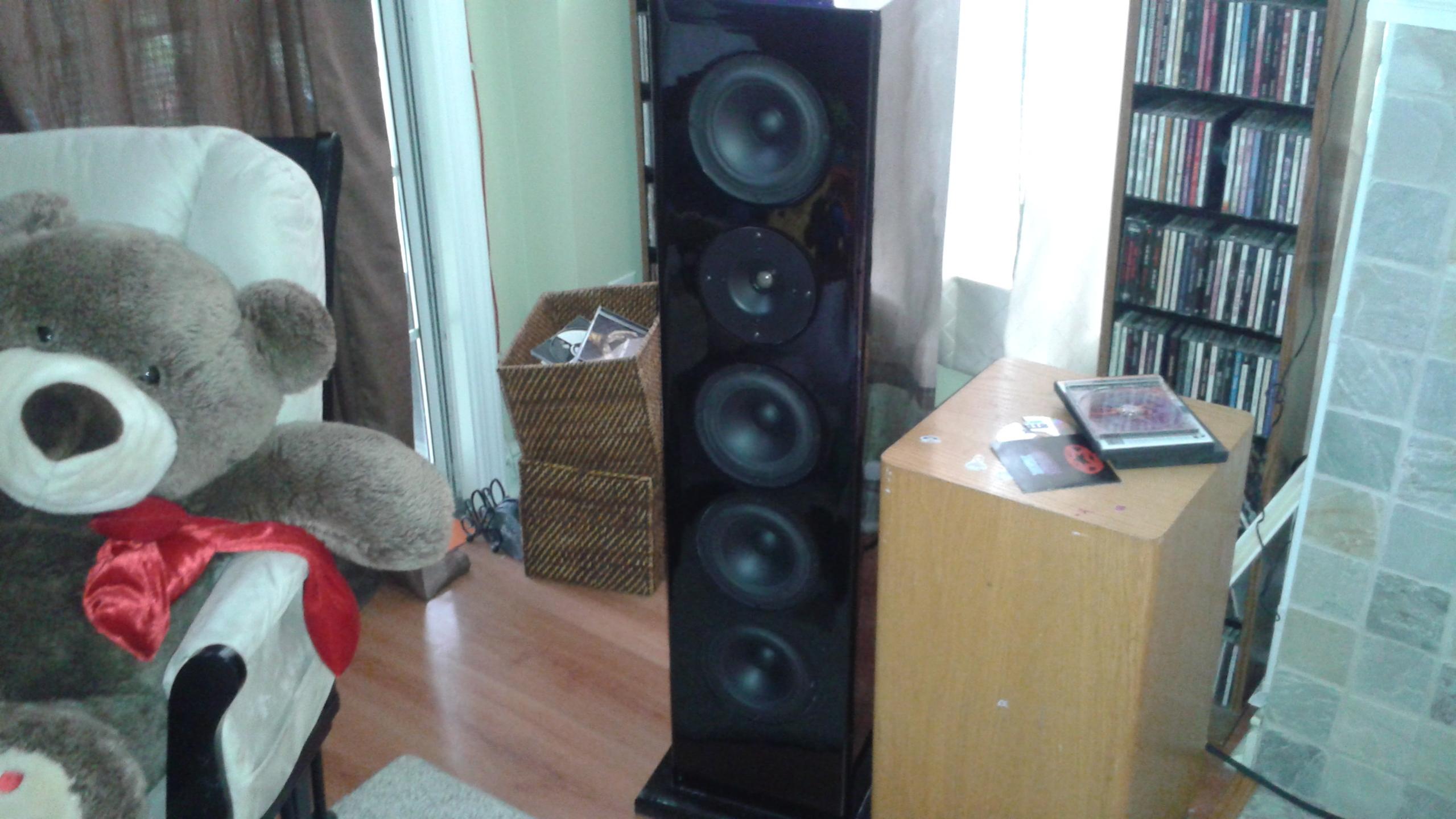

Done!!!!
Well, I got home on Tuesday after the cabs were painted and decided to finish the build since it was only going to take a couple hours...10 hours later at 3am they were done...lol.

So the sound....
OMG...let me say that again...Oh MY God!!!! Wow...it's safe to say I am extremely PLEASED!
First let me talk about the detail coming from these speakers...amazing...truly amazing. And the best part is NON-fatiguing!!! Absolutely incredible.

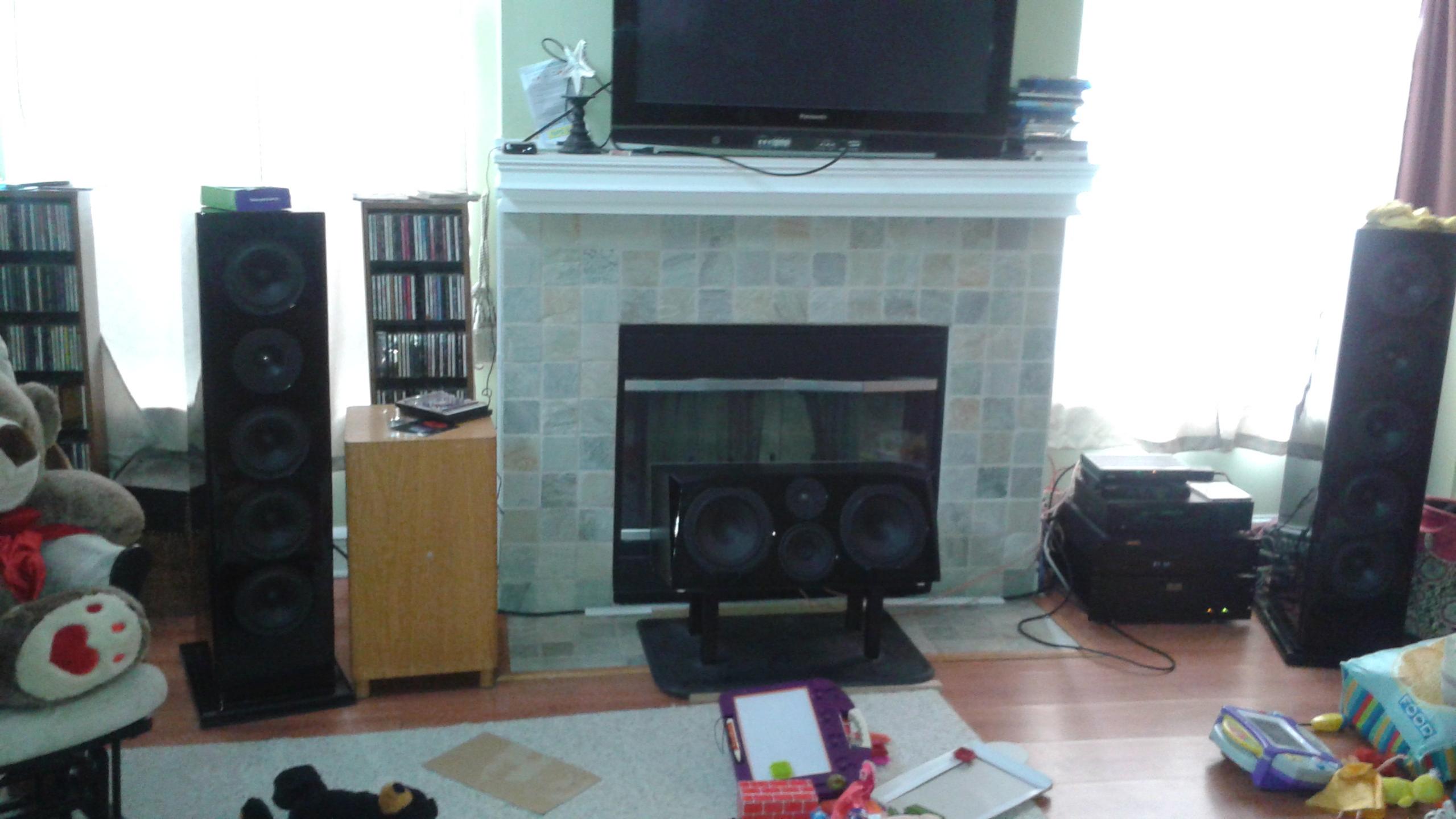

Finally here's the final picks! Ignore the toys and mess please!
I had to put all my audio equipment on the floor because my existing A/V rack was too big and I have to build something else.
