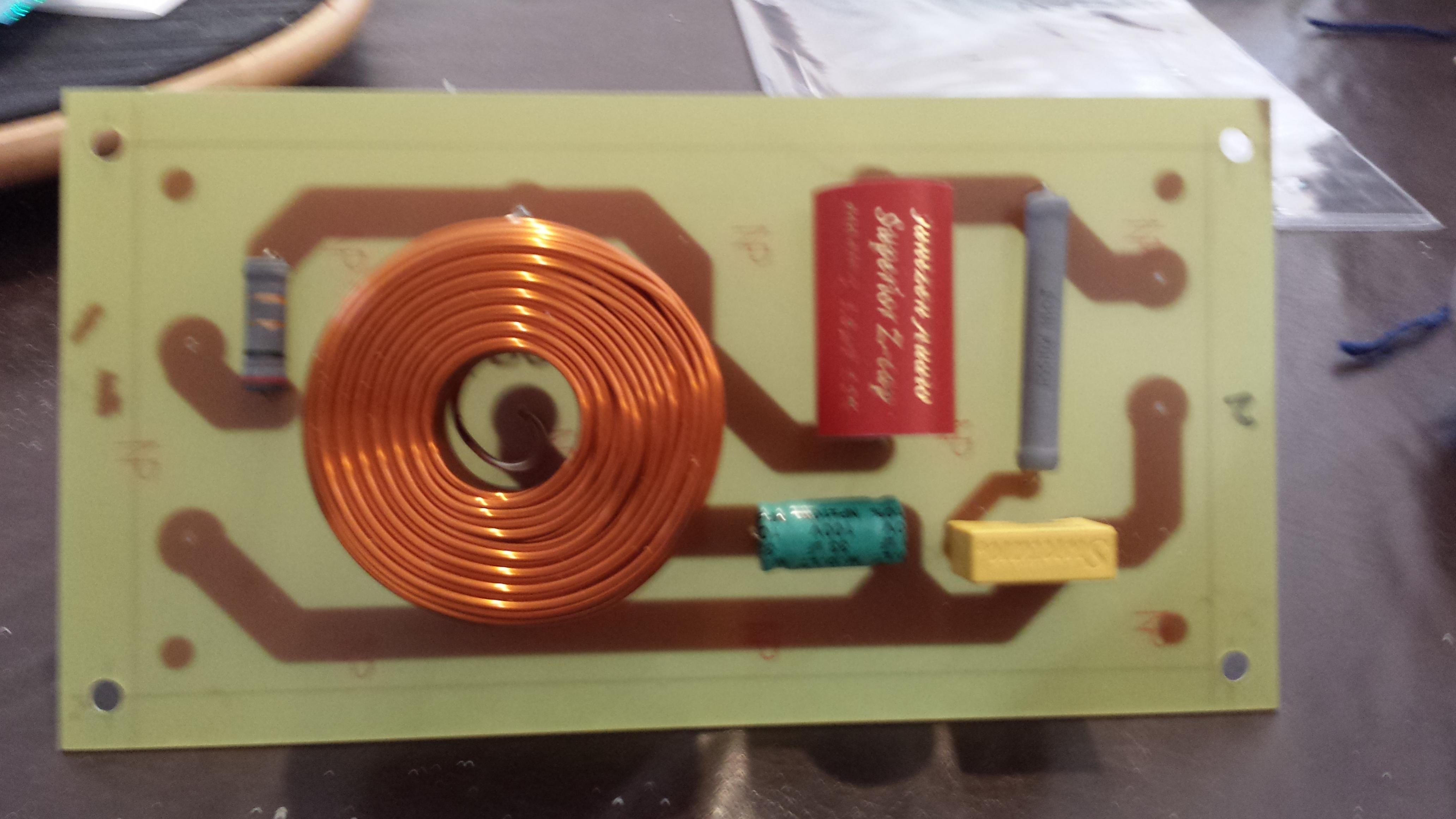

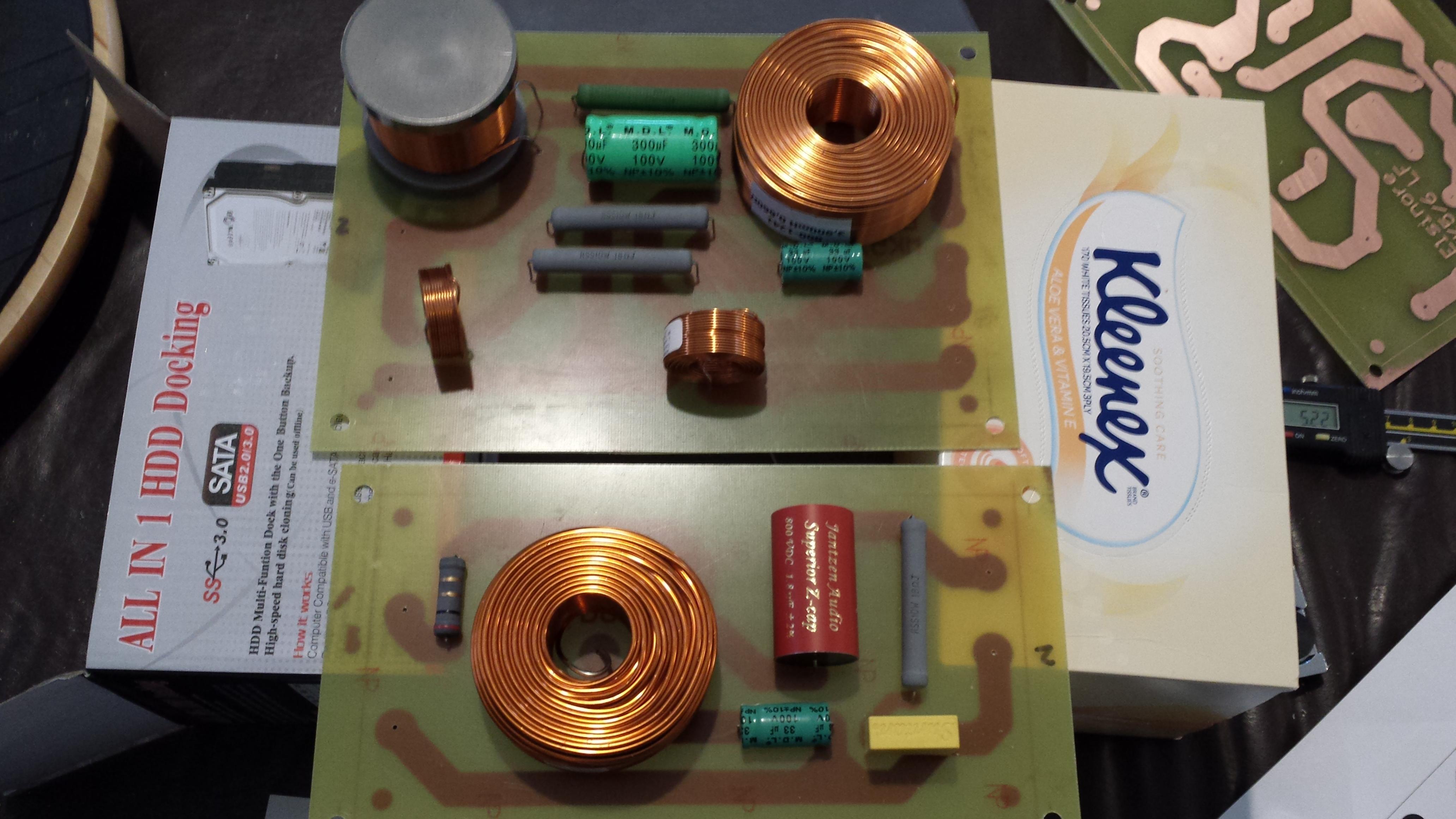

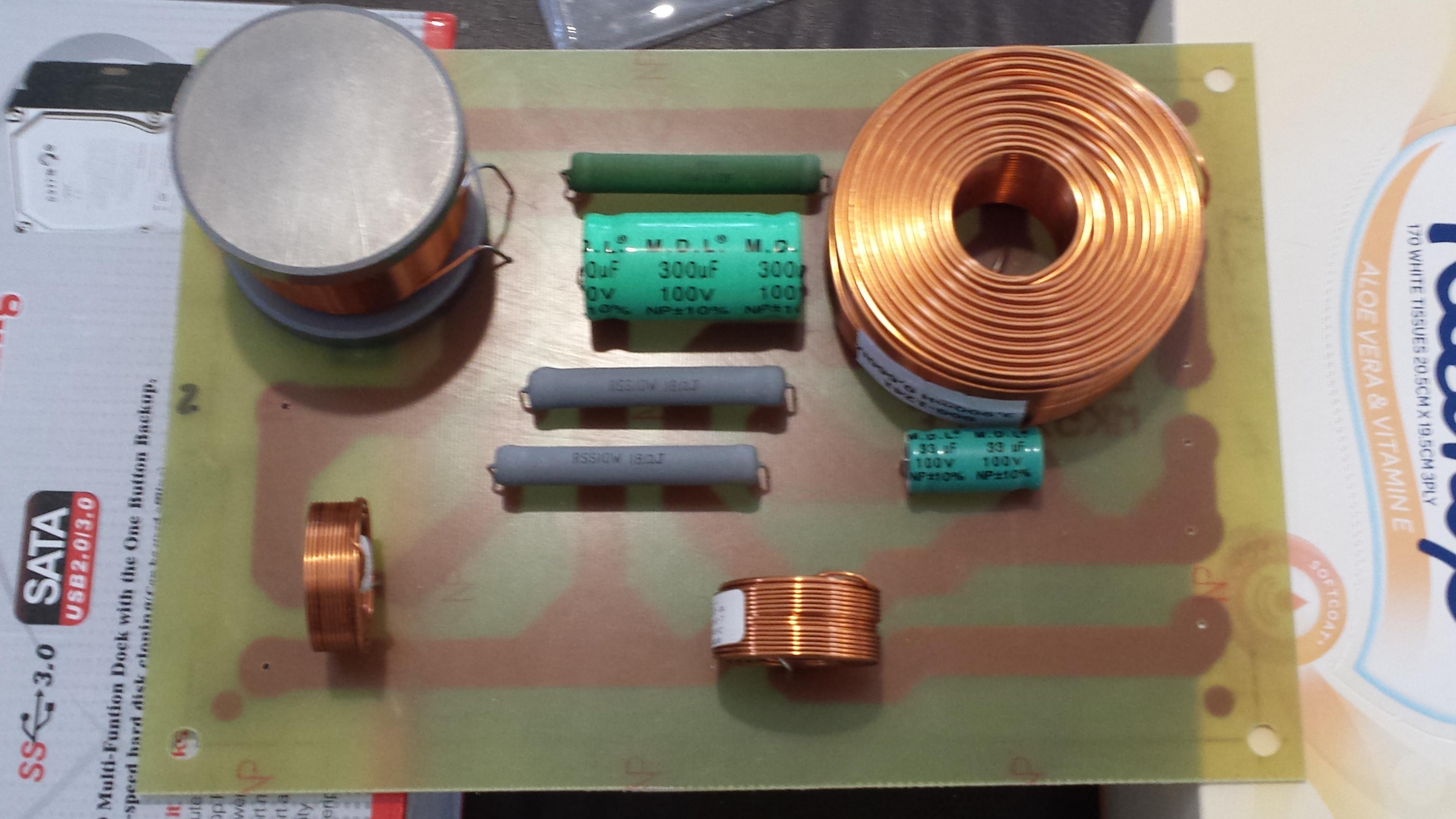

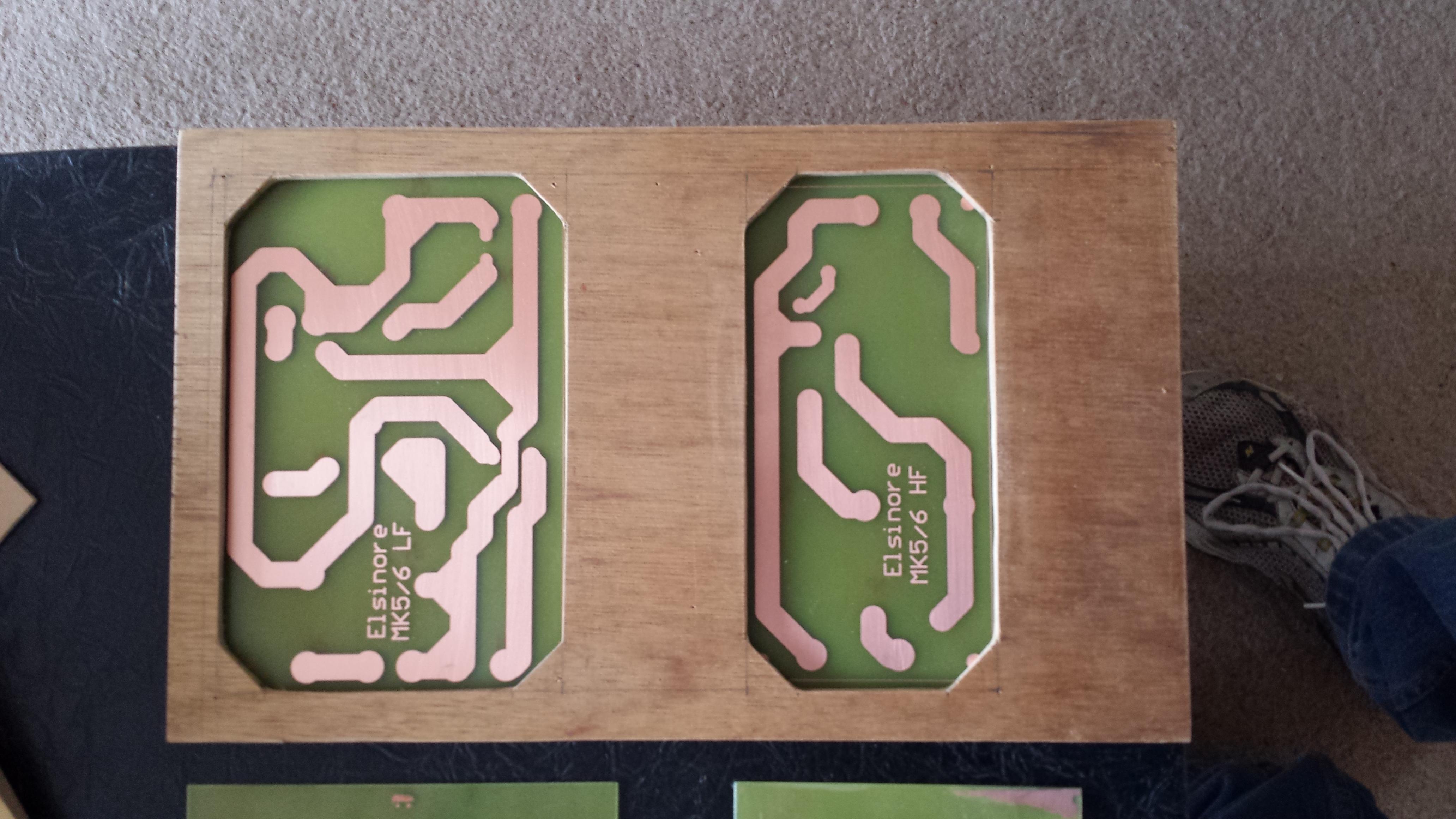

Hi Guys.
putting up some pics of my xovers. the High and Low Frequency sections are asembled on separate boards so they can be mounted as far apart in the foot of my speakers to minimise interference. components are only assembled in the board at the moment. nothing permanantly fixed as yet.

I would definitely check the wiring - the old reference had to do with the Peerless HDS drivers having a bit of a peak at 4KHz, but one that ameliorated when toeing out and listening more off axis. But the MK6 should have no such problem. I am wondering if you got the phases right.
