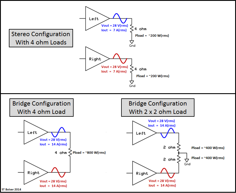

From the Parasound HCA 806a manual....In the bridge mode each
channel of the amplifier functions for only the + or — half of the musical waveform. Thus, each channel "sees" only half of the speaker’s impedance.
Several people have already provided explanations, but sometimes a picture helps the understanding.
The figure was created for a 4 ohm discussion in another forum, but the same principle applies for 8 ohm.
What the manual is saying is that the effective load on each amplifier channel is half of the load applied to the bridged configured amplifier.
Attached is a figure that compares voltage, current, and power output for stereo and bridged configurations.
Each channel still puts out the same voltage, but current has increases 2x.
Ohms Law for AC circuits tells you that the effective load on each amplifier channel has been halved.
With the 4 ohm load driven by equal and opposite voltages at its ends there is a virtual ground at the midpoint of the load.
You can think of it as replacing the 4 ohm load with 2 x 2ohm loads with the center point grounded.

You've explained it better than I did. I guess the real implication is that an amp capable of say 100W per channel in non bridged mode cannot realistically be able to suddenly produce 400W in bridge mode. It would be unlikely that it's power supply would be capable of this. It's all about how much current it can deliver. You can't get something for nothing.

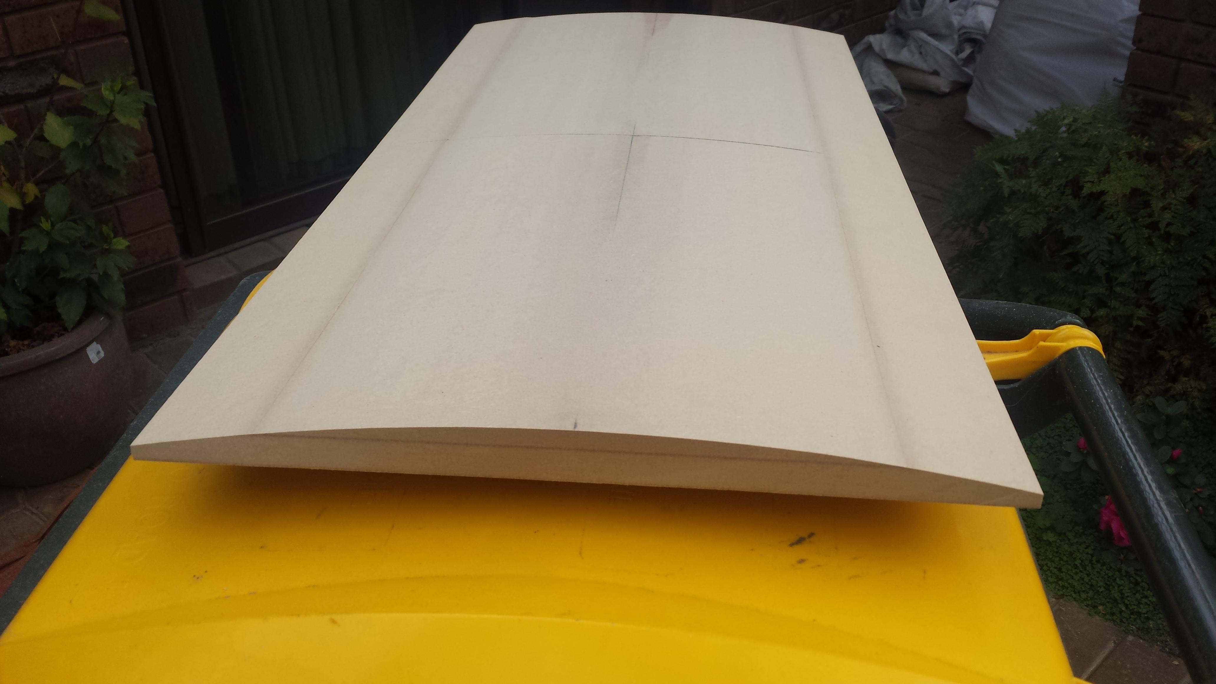

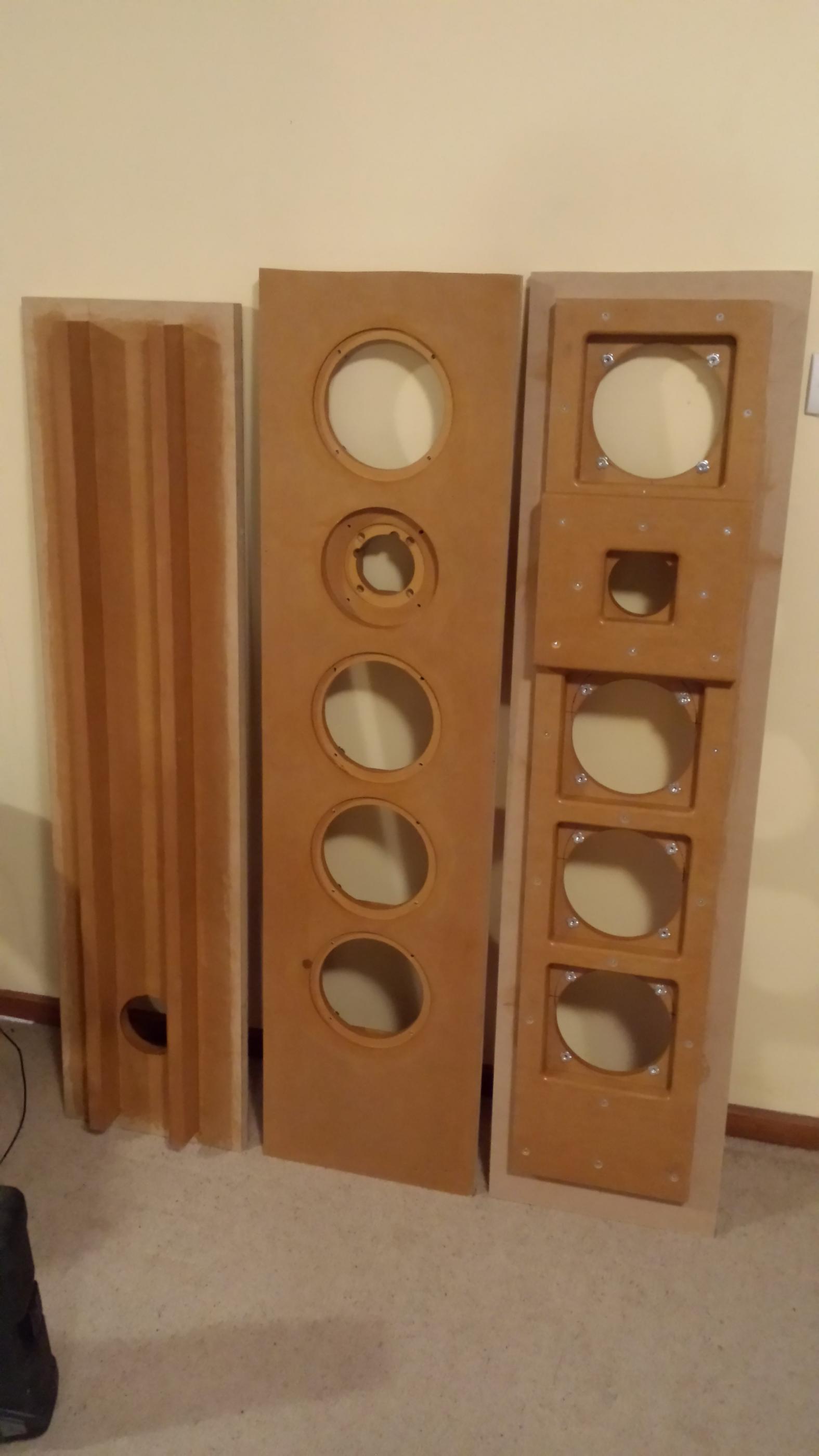

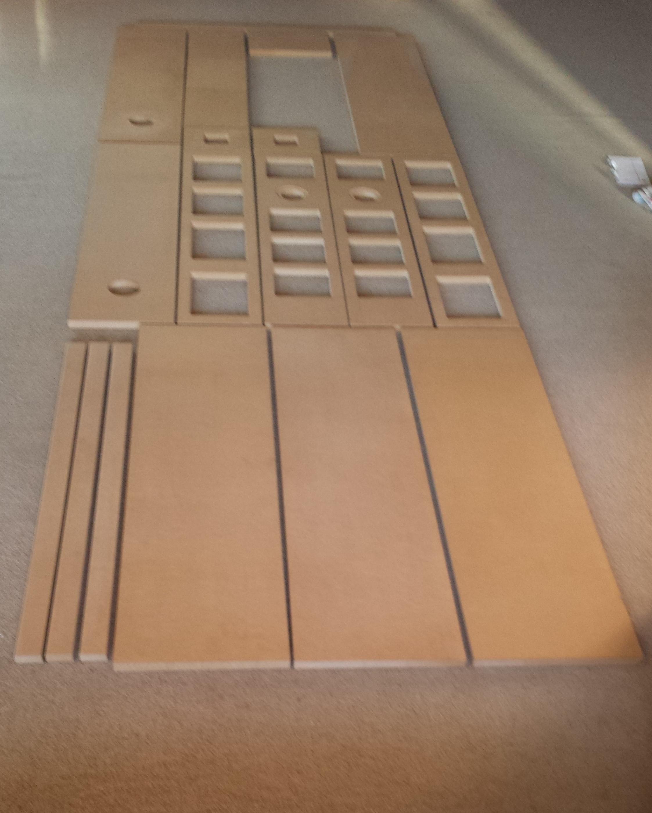

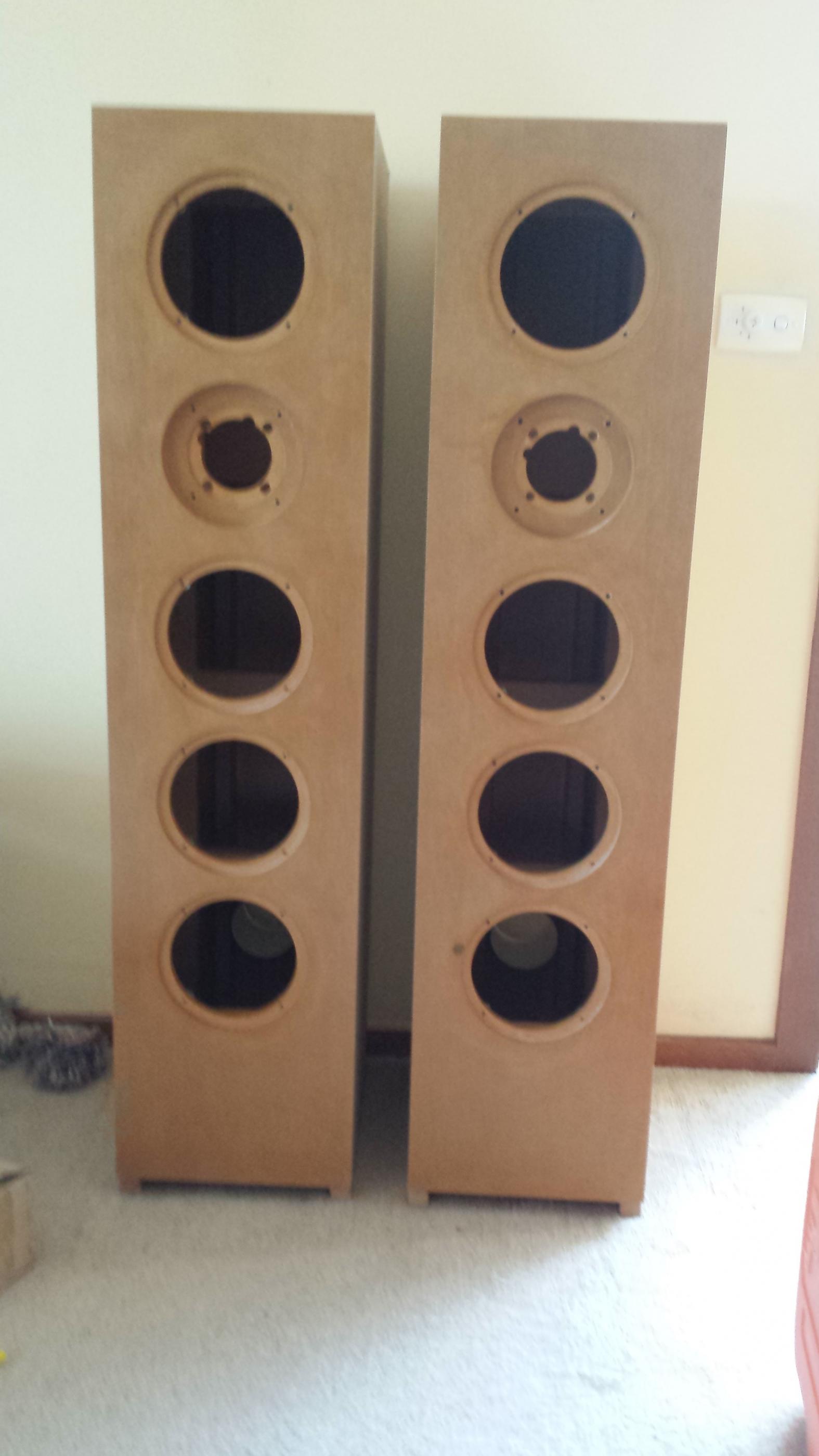

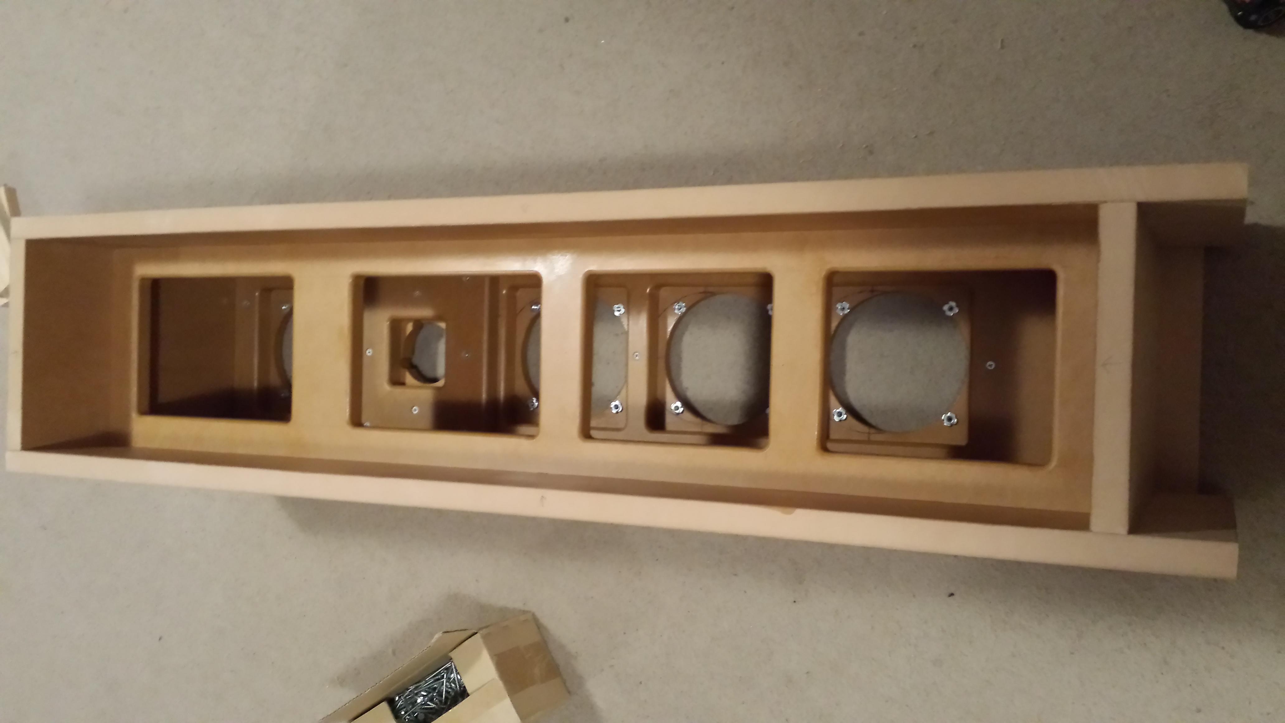

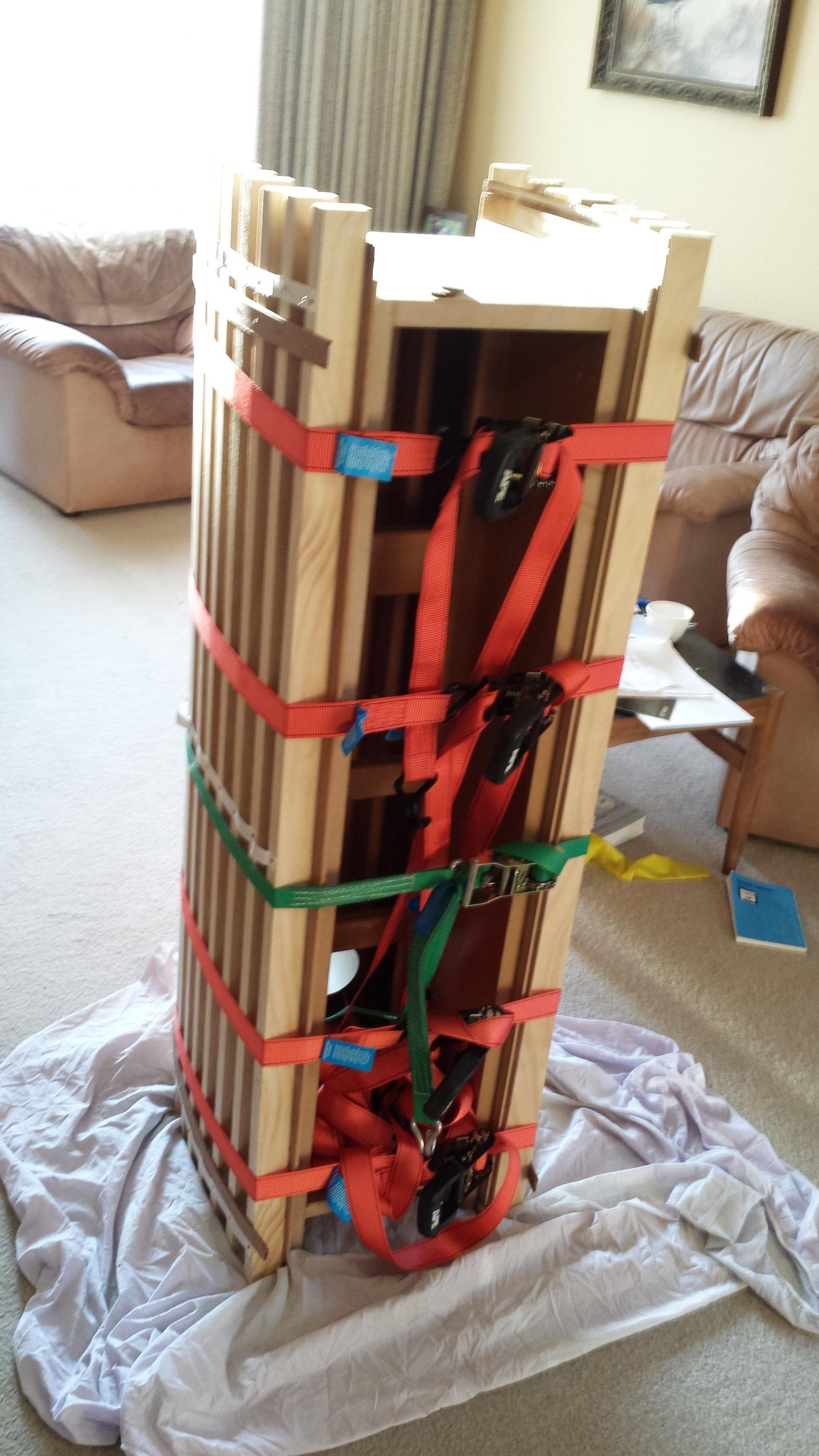

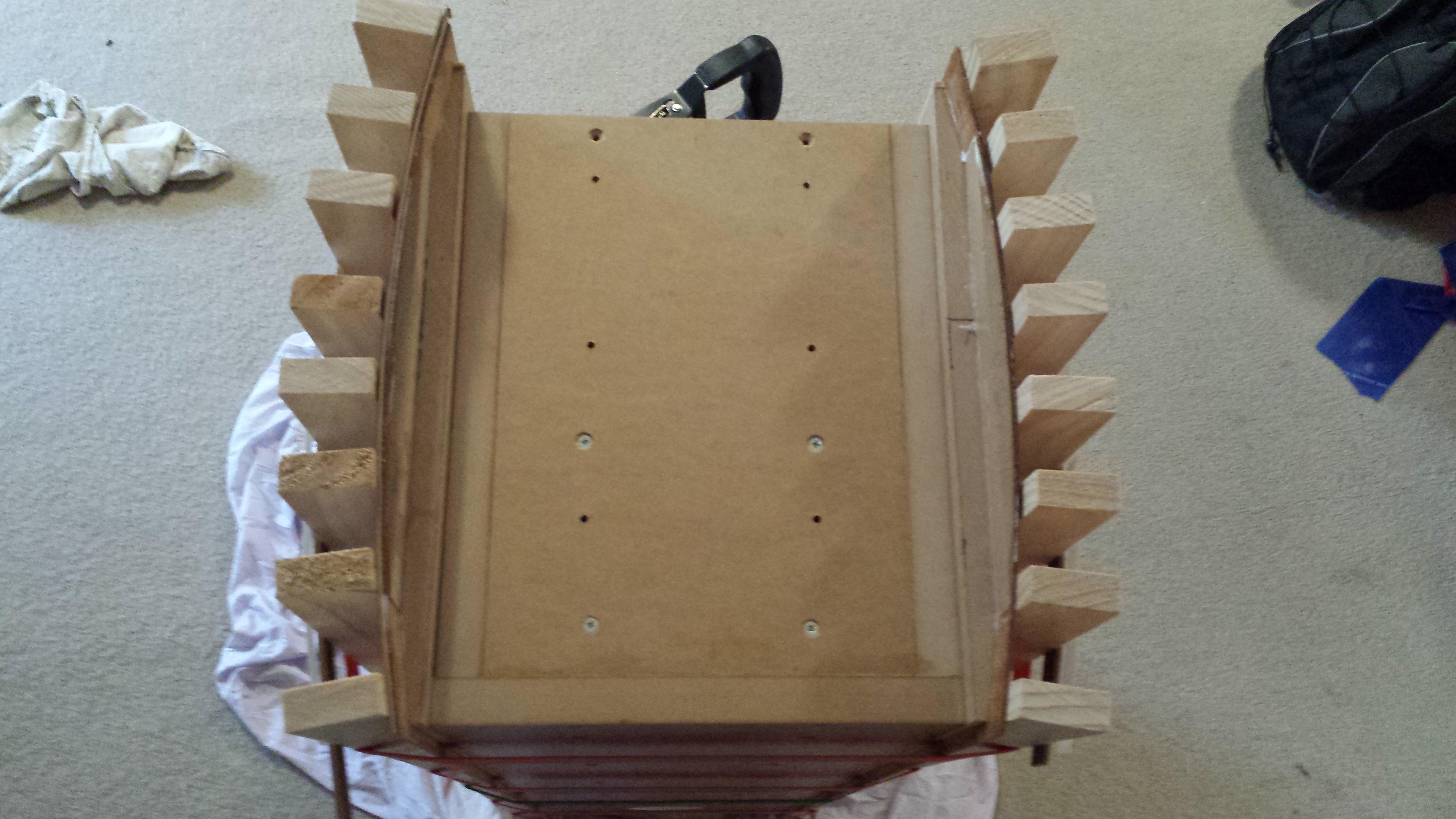

progress pics
Hi guys. irext has been pushing me to put some pics of the progress of my speakers on the forum. i have taken a few liberties with the layout of the cabinets. I have extended the sides below the cabinet to create a foot in which to house the crossover. i also made the 18mm front panel the full width and height so i could black french polish the panel haing no joint lines visible through the polish. i am also adding curved side and top panels to clad the speaker box to give a similar look to naim ovators. These panels were then covered with 2mm (1/16") Tasmanian Blackwood Ply. i hope the pics appear.
OZmOZis
OZmOZis
