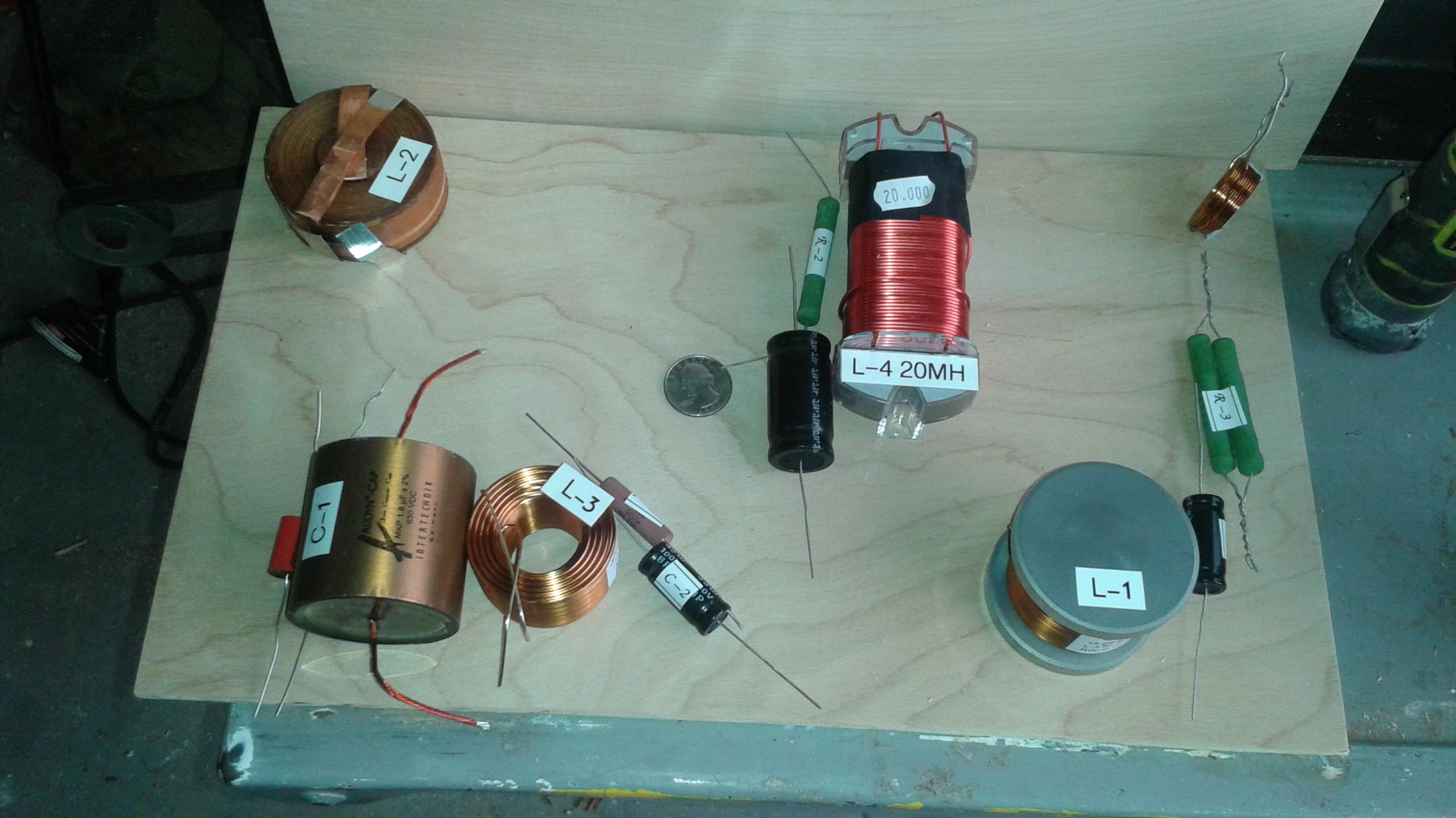

Well I haven't gotten a response but I need to know can I increase the box height a couple inches to accommodate the crossover under the box...should I lower the driver placement etc? Basically the cabinet will sit on top of the crossover box...
I have rough cut the panels and I have everything to build the xover and I want to get started.

How much higher are you thinking of making them?
Tweeters are ear level at your listening position is a worthy goal.
I have the rest of the xover components on the way, they will be here in a couple of days but I wouldn't think it would be more than 2 to 3 inches...the less the better.
I would definitely prefer the tweeters at ear level that's why I asked if I could lower the driver placement to accommodate for the extra height.
Once I have everything on hand I'll have a better idea. The 3.9mh coil is on the way and the tweeter caps are huge, probably 2 inches thick. Those I think are the tallest components.

Not sure exactly what you mean.
The shape of the front panel is critical, change it or the drivers relative to any edge of the front panel will change the response and be different from the original modeling, so don't change any driver positions.
If you add height at the very bottom of the box, then it has little difference to using taller spikes etc. So you could putting the crossover there may be OK. But don't add to the internal volume.. But give us an idea how much you want to add? Is this a separate and isolated chamber that does not change the volume?
Cheers, Joe
sorry for cutting in from the side lines, just to give/add credit to Joe's approach in this speaker: I still am enjoying tremendously the "original" Elsinores (mk5 w/Peerless). once broken in and toed in they perform really well. they seem to prefer some amp power though so I am still trying to coerce them to accept a lower wattage classA amp (now adding a sub to help that trade off if at all possible..)
I am not sure what other driver version would make me consider a new (re)build. maybe something like 18Sound 6ND430 (good reviews; see Zaph) or alike pro driver with good perf/cost ratio. since Joe apparently requires that the new work be commissioned that is not likely to happen 🙁.

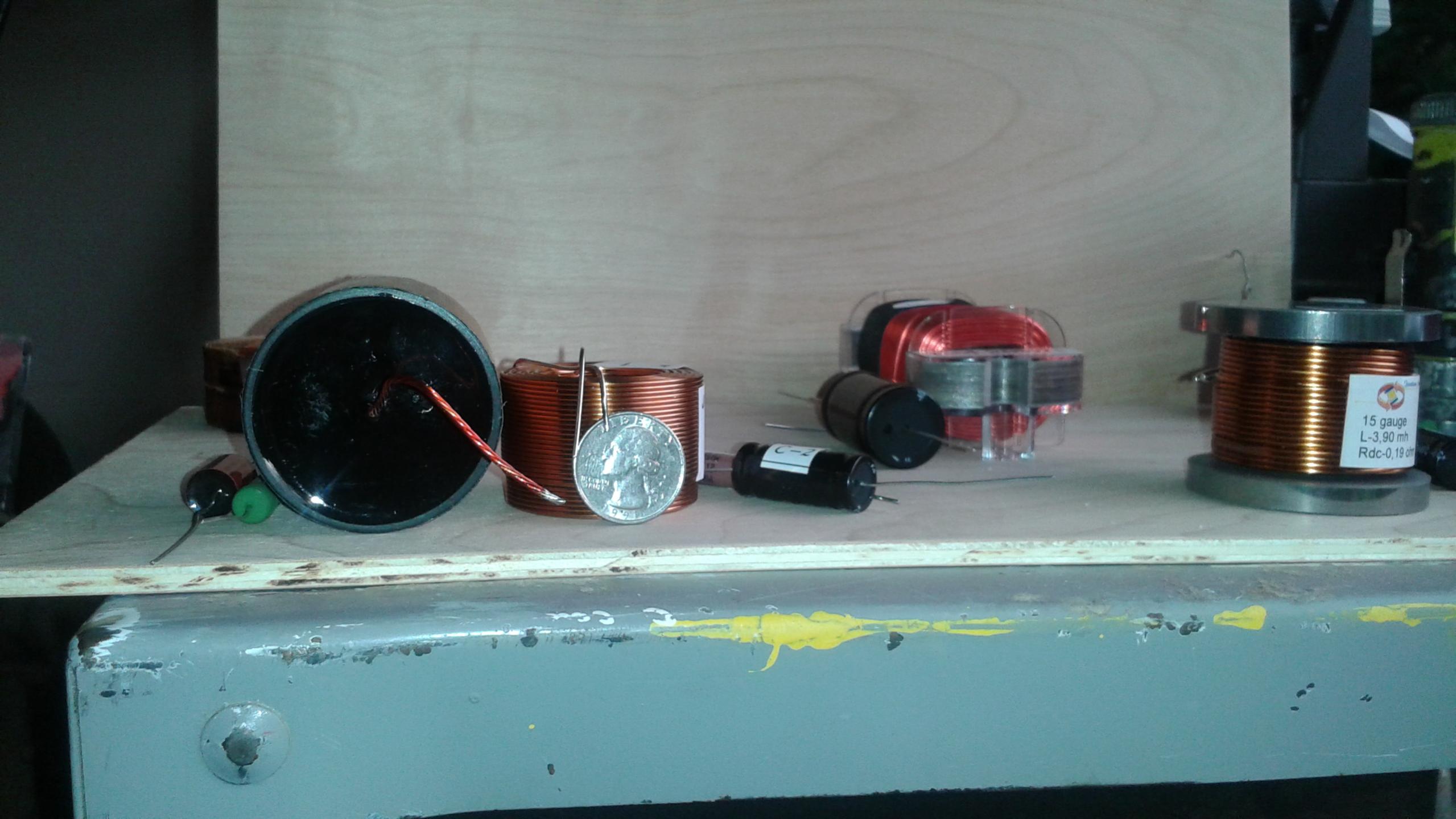

Rough Xover layout
Here's a few pictures of a very rough xover layout. Mainly I just wanted to give everyone an idea of the room I have to work with. There is a quarter in the picture for perspective. For you non-US people that is about the size of the inside of a bottle cap!
2 1/2" will give me more than enough room to put the xover under the cabinet!

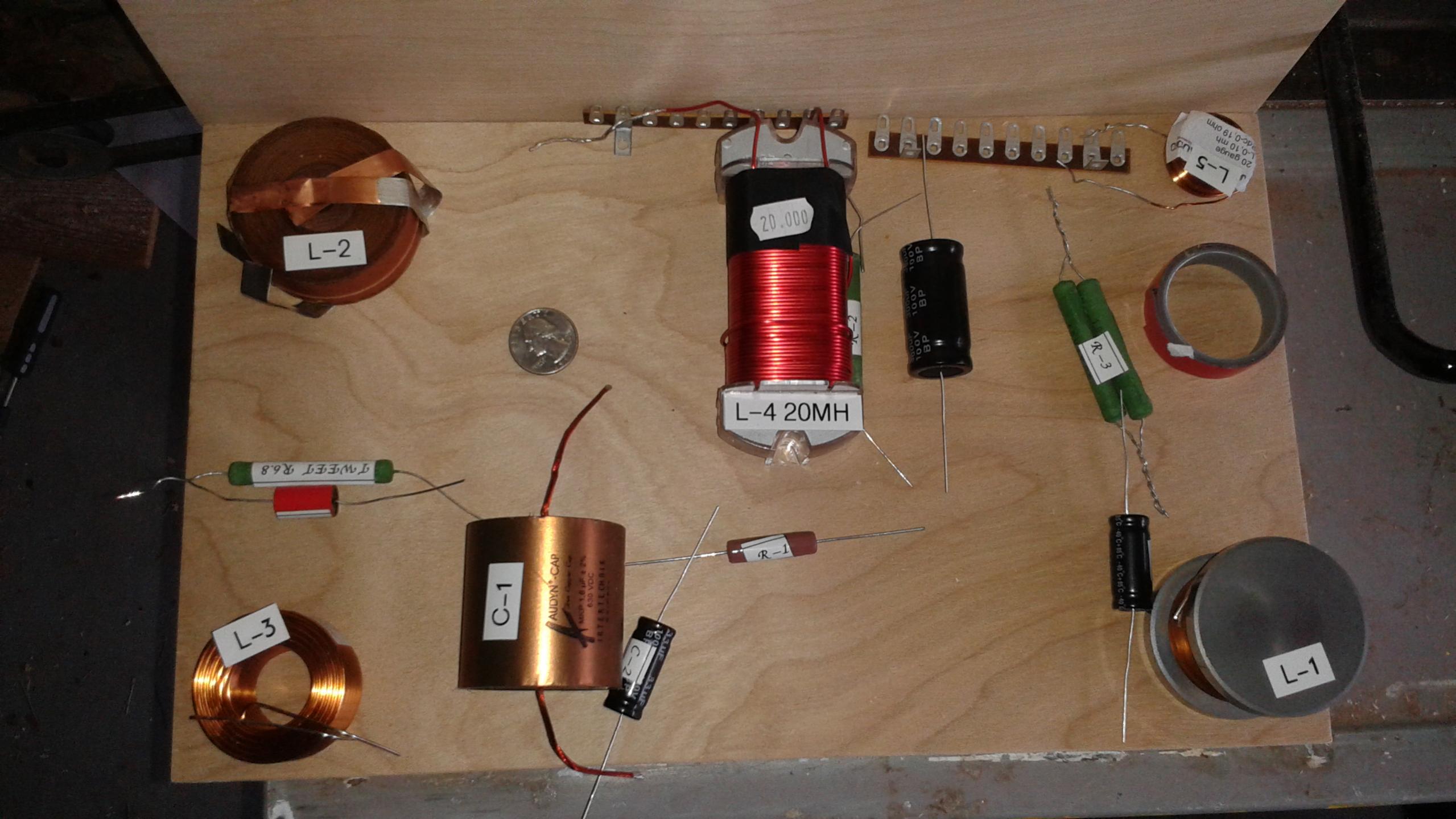

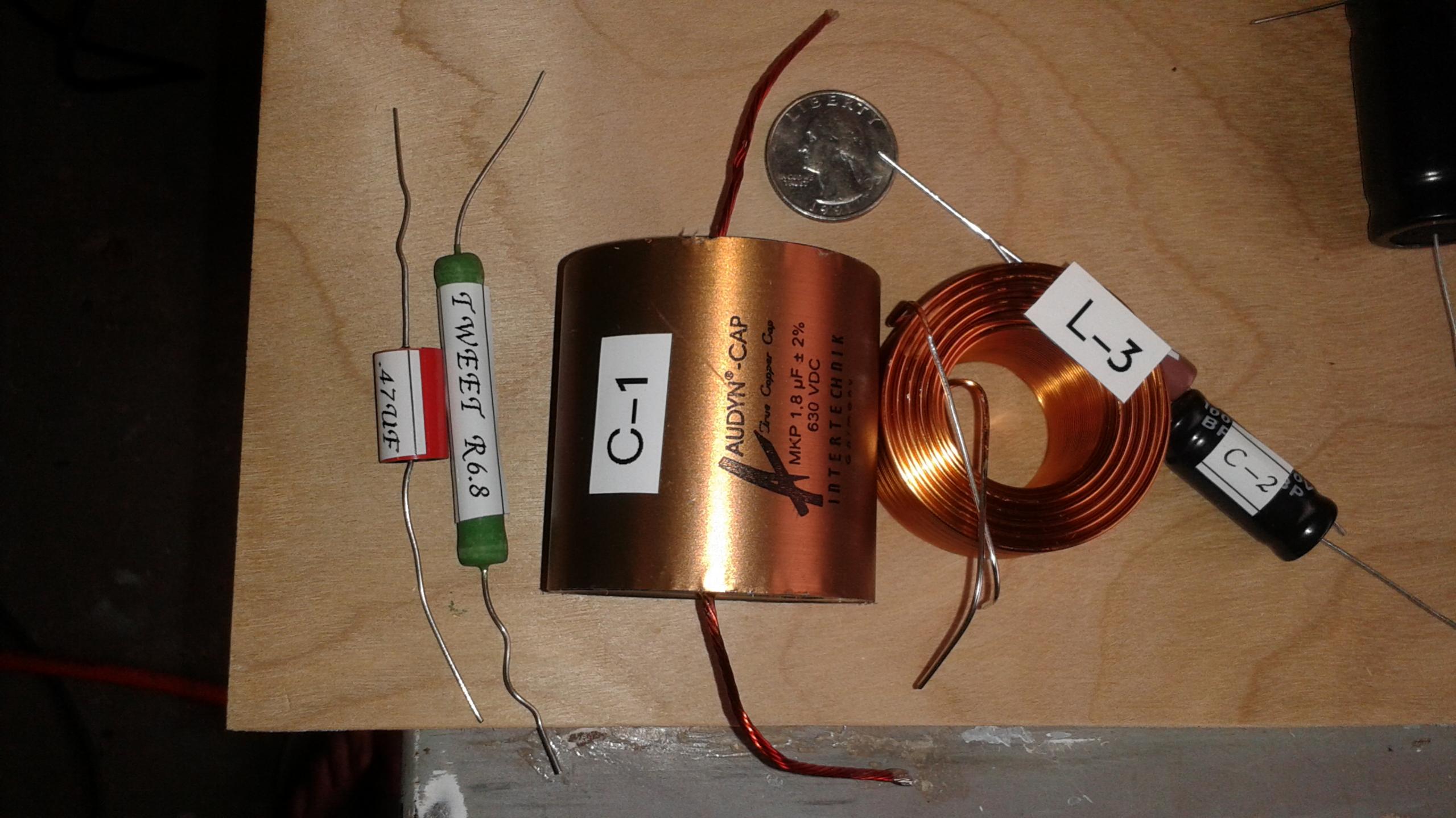

Closer to final layout
Hopefully this layout is pretty good. I need to get to work on the cabinets and when I get closer I'll play with this some more.
I'm going to add 2 1/2 inches to height leaving the internal volume the same, with a chamber for the crossover in the foot.
