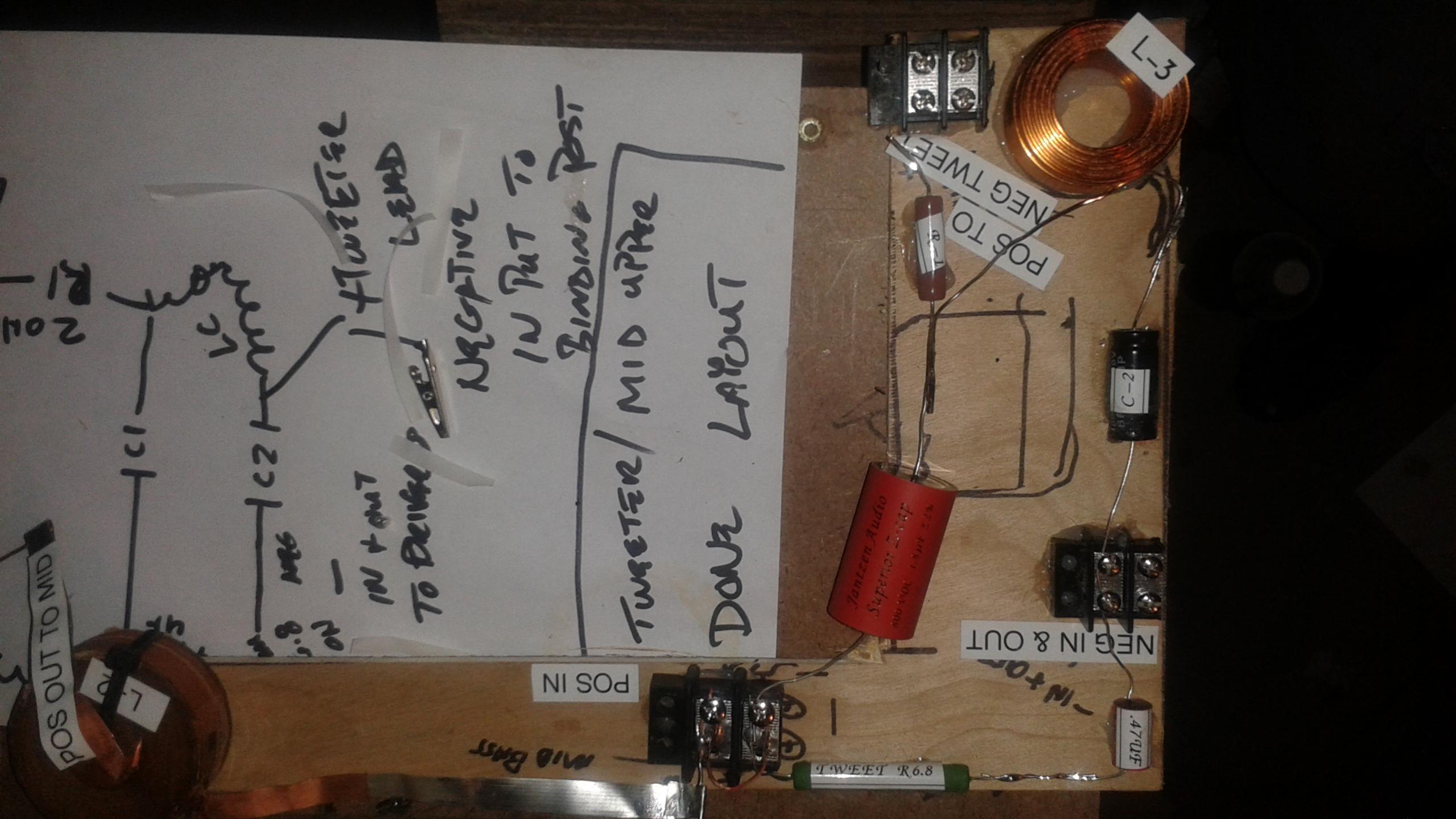

Ok so did the test "just incase" ☺ first did the battery on the tweeter - to + & + to - and it moved forward. Next put the battery on the terminals on the crossover and top two moved forward bottom two did not 😳. I couldn't understand why as the bottom two speakers where moving when I had the music on?? Basically I hadn't run the connection between L3 L4 and the movement of air in the box while playing music was moving the speakers. Anyway fixed that up and the bass was much better. (Obviously) But I must say the Toe in is really what fixed the brightness and with the extra bass it much better balanced.

Because it is internally coupled by the air that is shares by the other two drivers that are active. I can see how that can be deceiving. But good to know you found the problem - and make sure there are no more - get it right and now it should very much better. The bottom drivers not working means you have zero diffraction loss compensation - and yes, that means it will sound a lot brighter. Makes a huge difference.

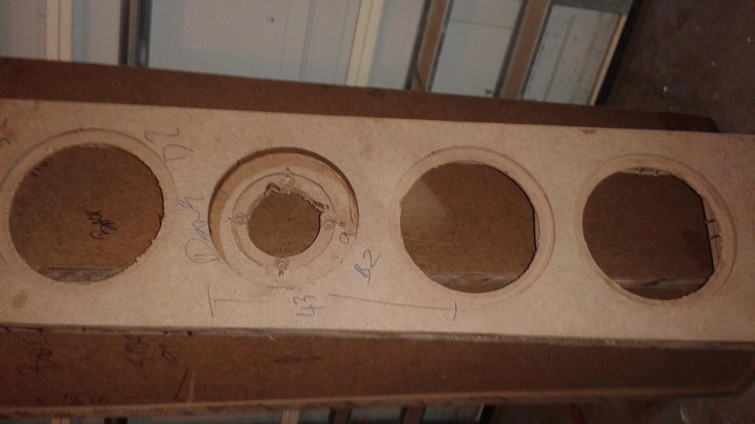

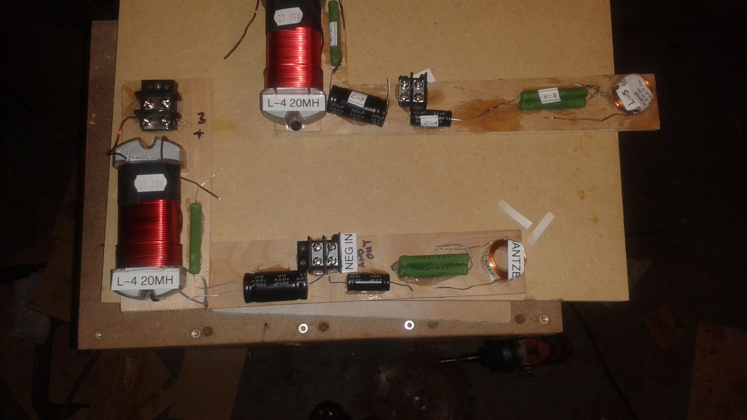

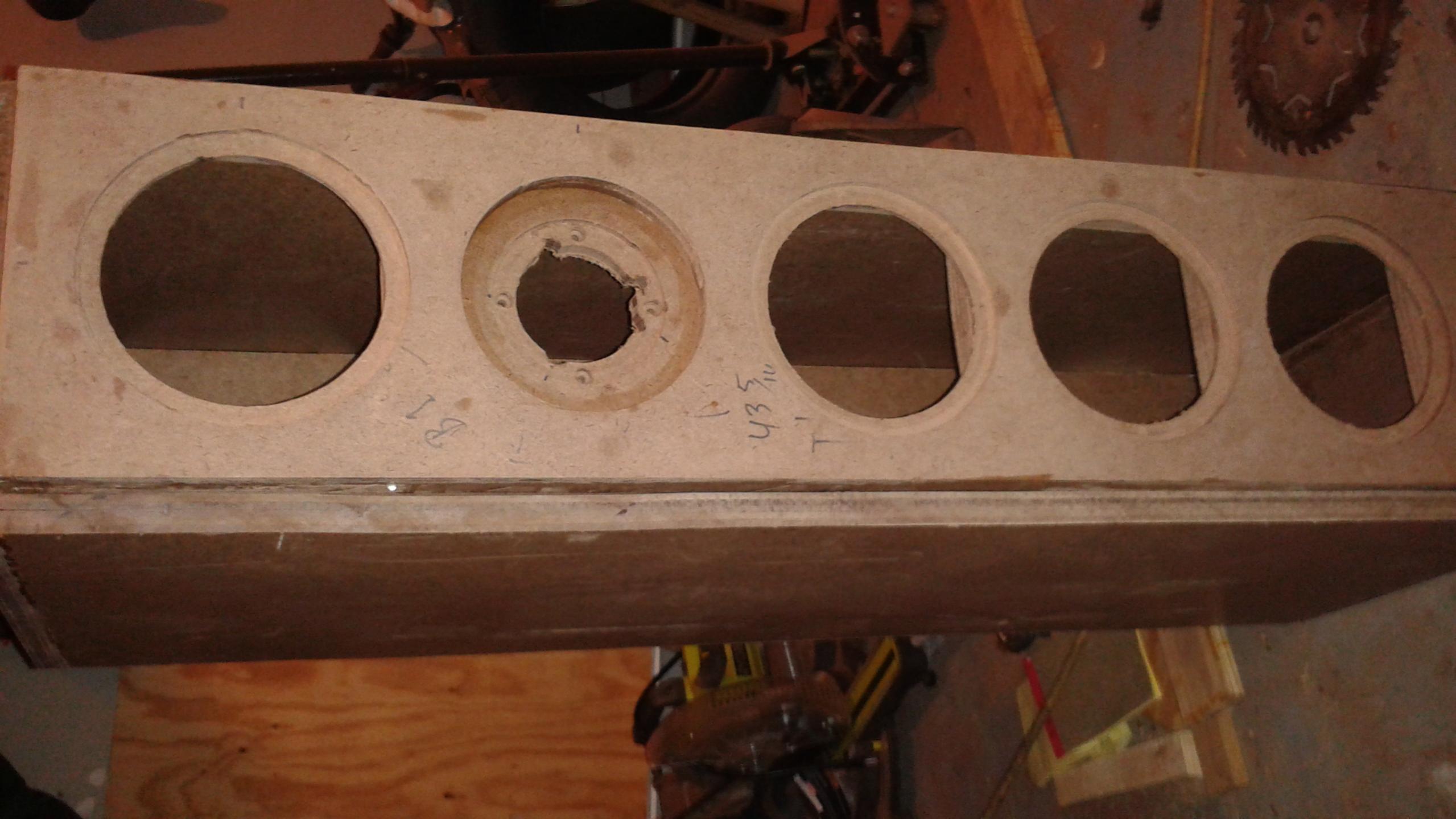

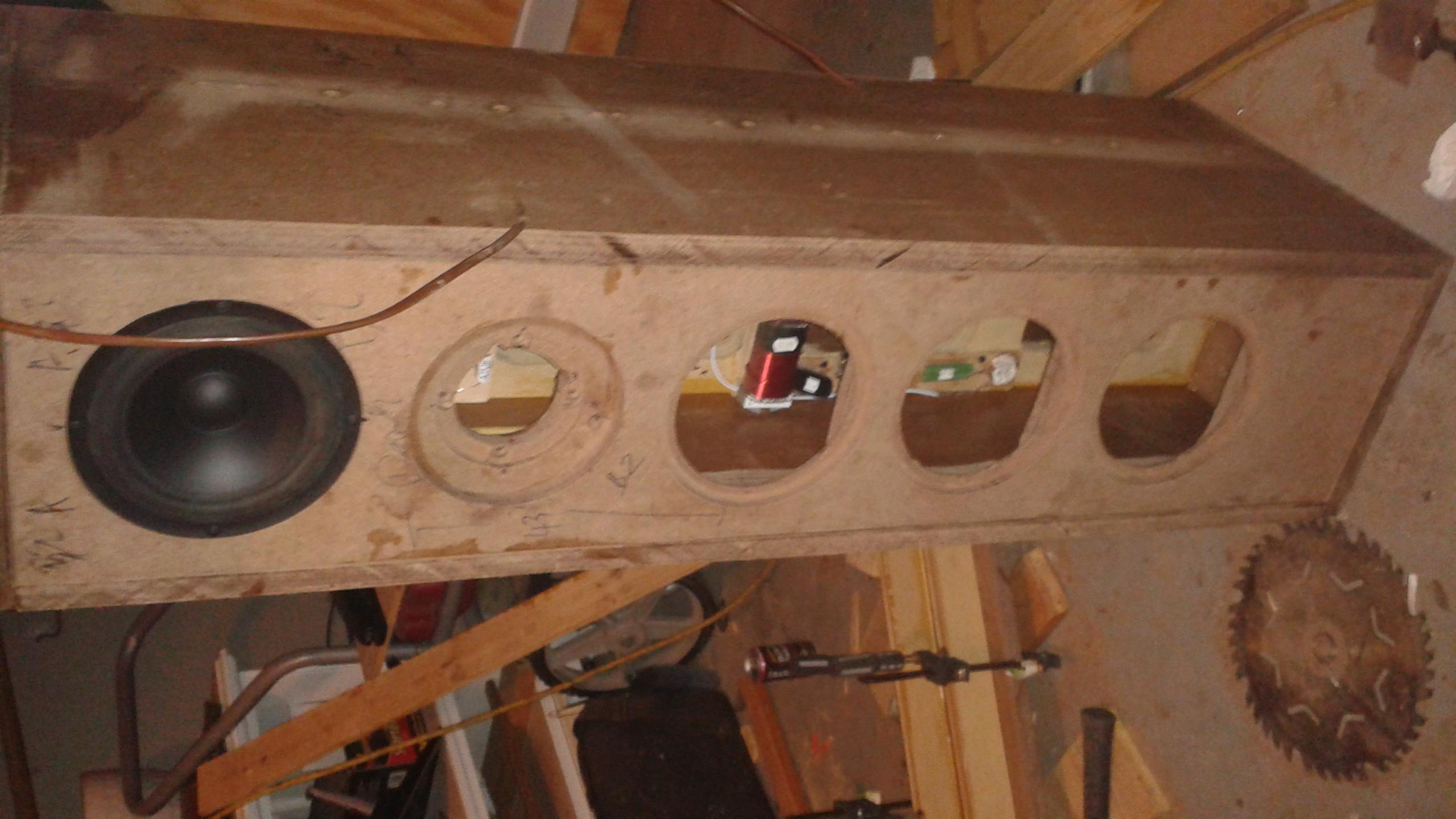

I've almost got the cabinets built. I am thinking I am going to put part of the xover in the bottom of the box, (the midbass bottom), and the tweeter/midbass top on a xover board on the back of the box. These things are so tall I scratched the idea of putting the xover under the box. I was planning on bi-wiring these so it wouldn't be that hard to do...I just have to figure out how I am going to implement it.

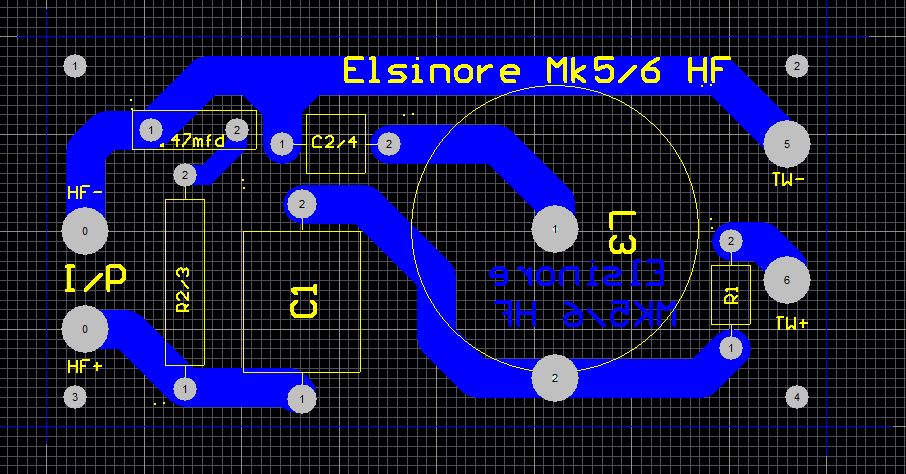

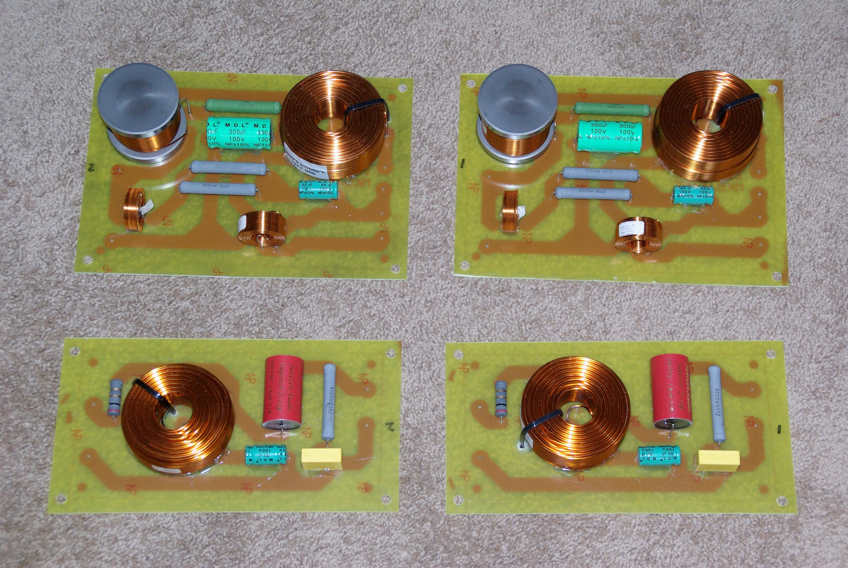

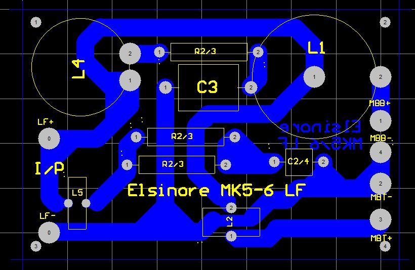

Here's the latest version of my Crossover PCB's. I decided to do separate boards for HF and MF/LF. Mainly because the etching tank was too small for a composite board but also to provide the opportunity to isolate the PCB's to avoid inductor crosstalk. All inductors and resistors and C1 are Jantzen. The bipolar electros are from Jaycar. Ozmosis's lovely MK 6 Elsinore build (seen elsewhere on this thread) was the catalyst for the redo of the PCB's but I was planning to do it anyway. I just needed a shove. I can't wait to hear his units as they have the new midwoofers. (by the way the Tweeter polarity is incorrectly shown on the HF PCB. I've corrected that since)

Almost there...

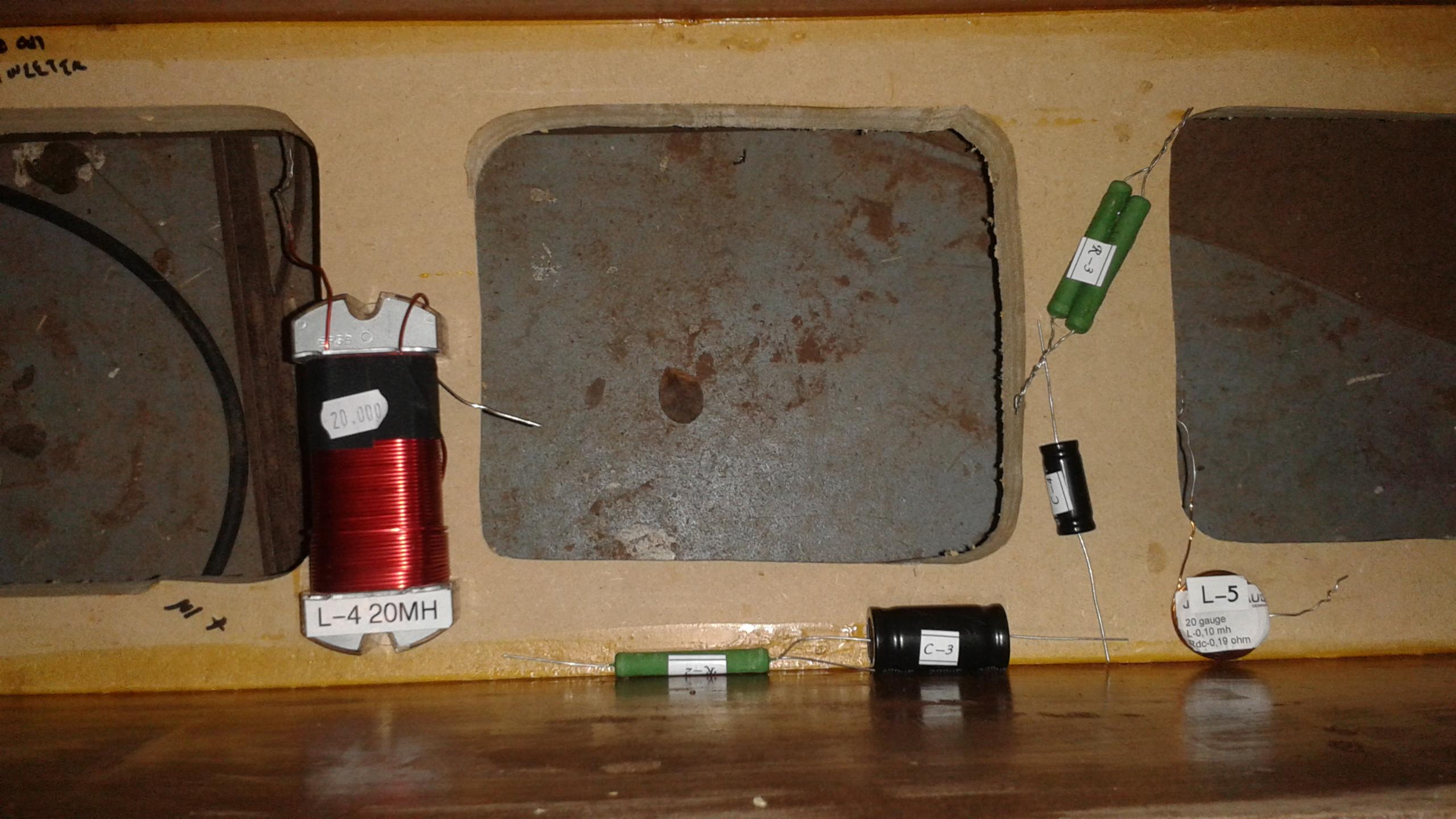

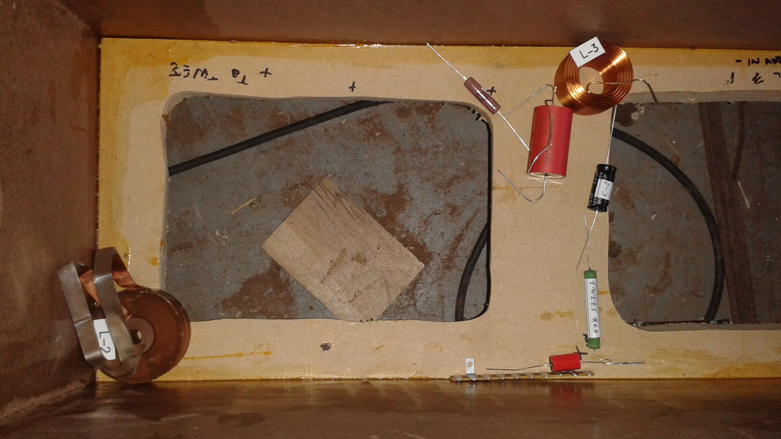

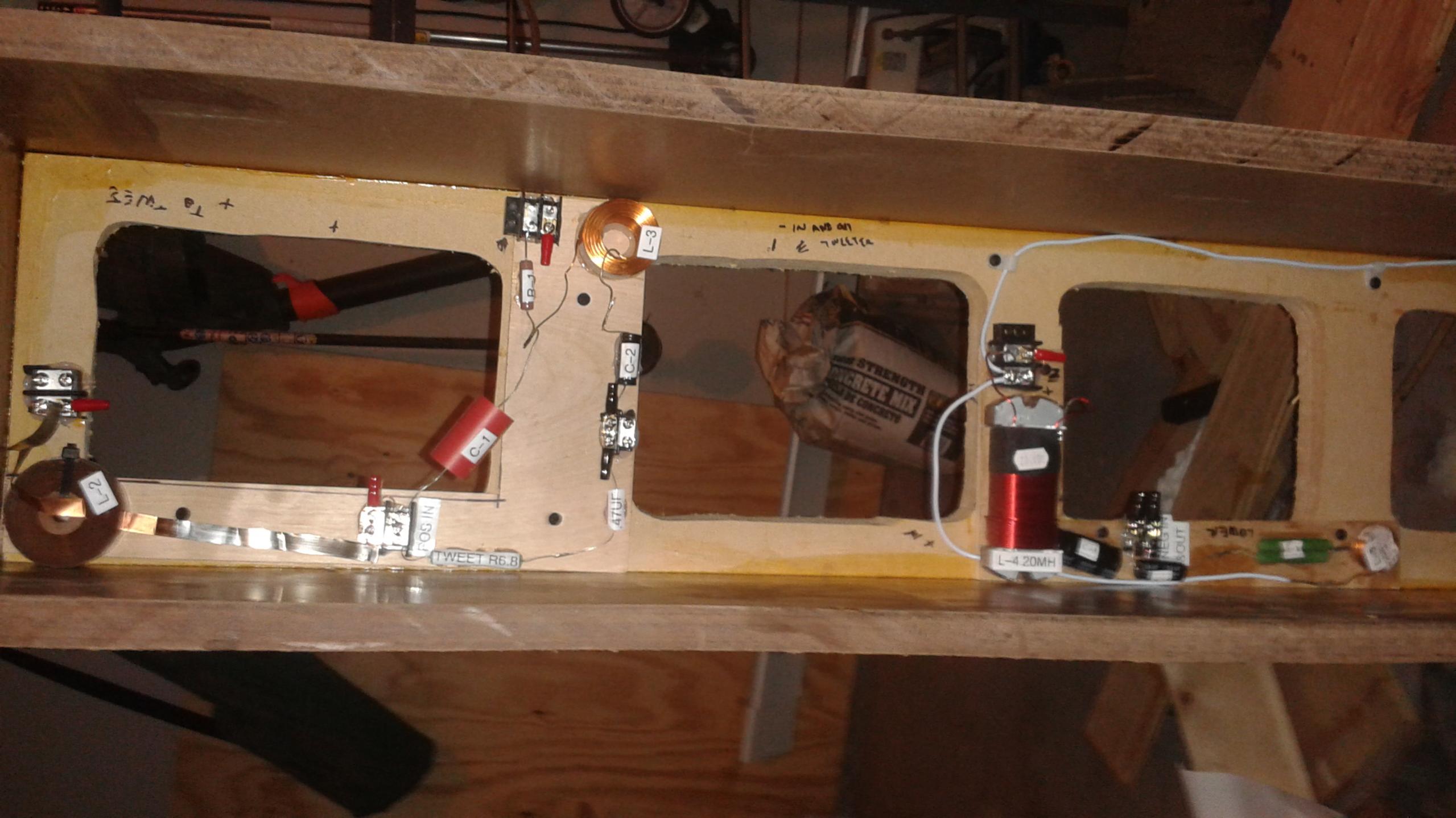

I laid out the xover's and started soldering them. I decided to put them inside the cabinets with removable panels from the driver openings. (see pics)
All I have left is cutting the port openings, installing the last two braces on the back panel, and assembling the cabinets.
Then another day in paint. I do auto paint & body so they should turn out nice. If I can the cabs done tomorrow I might start listening to them tomorrow night and paint them my next day off.

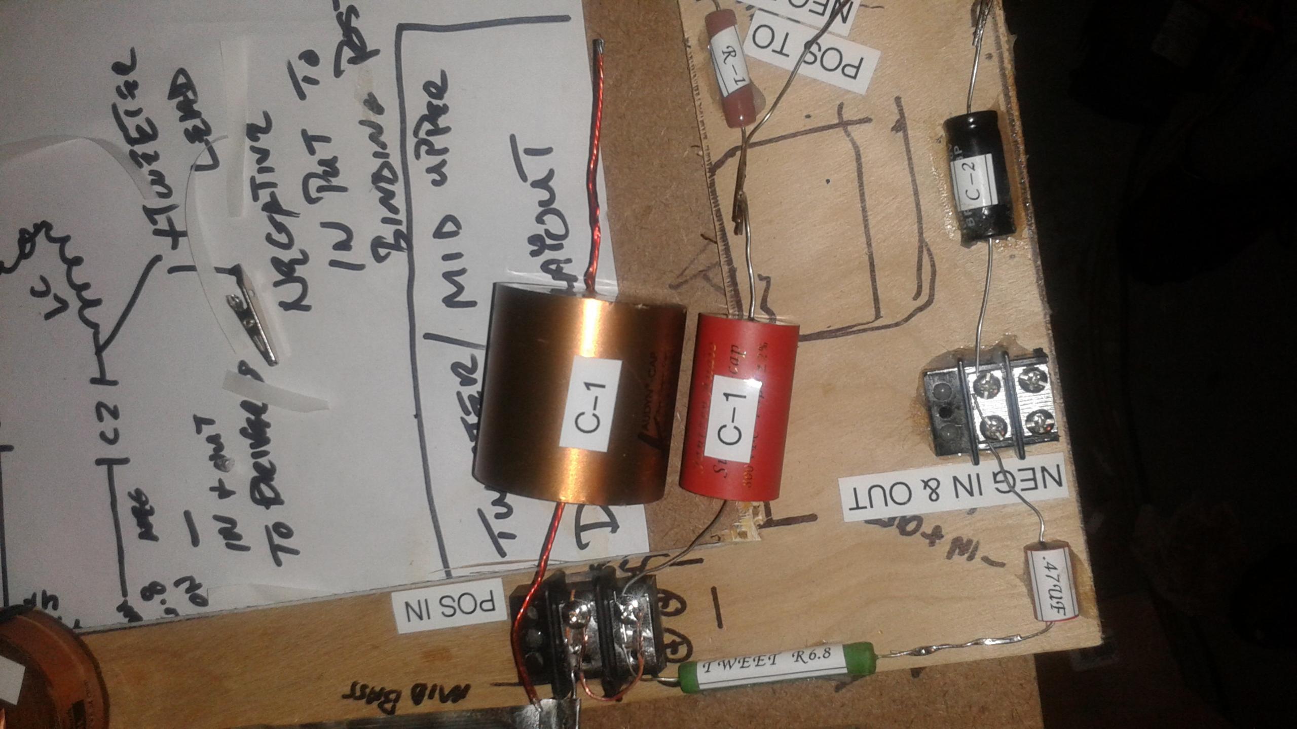

Check out the pics. I am waiting for the Audyn True Copper Cap to come back in stock, they only had one, so I got the Super caps...but check out the crazy difference in the size between those two caps.
L-1 is going in the bottom in case any one notices it's not in the pictures.

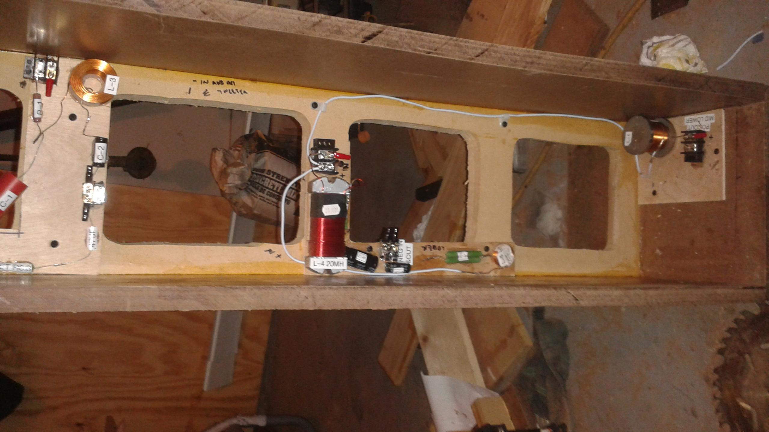

So close...
Man I am chomping at the bit...I have these things so close to being done save paint...but didn't quite get there...

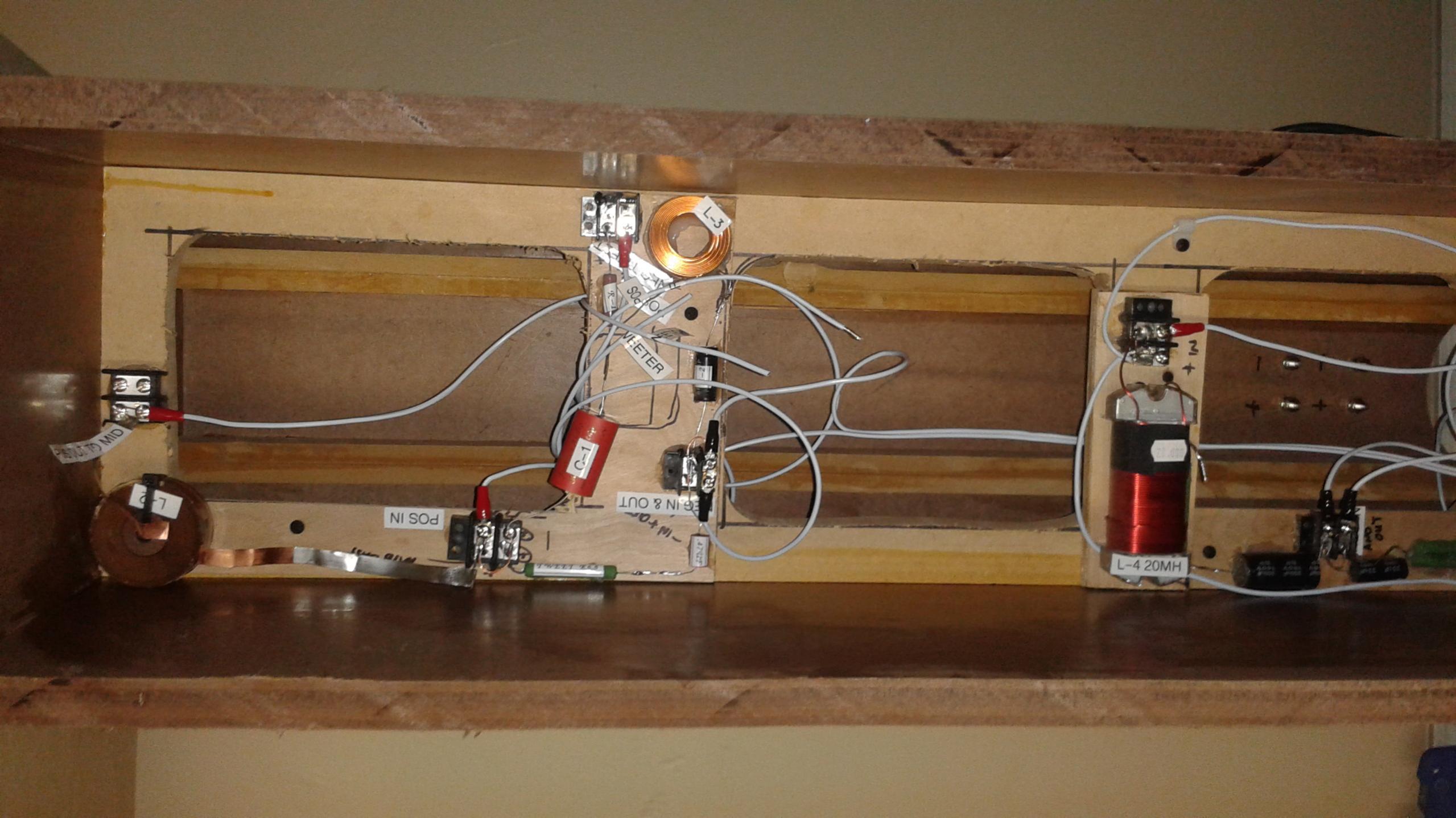

I have the crossovers installed and soldered, and all I have to do is install the front and back panels and connect the drivers.
I still need to do some sanding etc...but I'm hoping if I get home early one day this week I'l have them ready to paint in a couple hours.
Installed one driver to get an idea of what I need to do to install the binding posts and connections for the drivers....

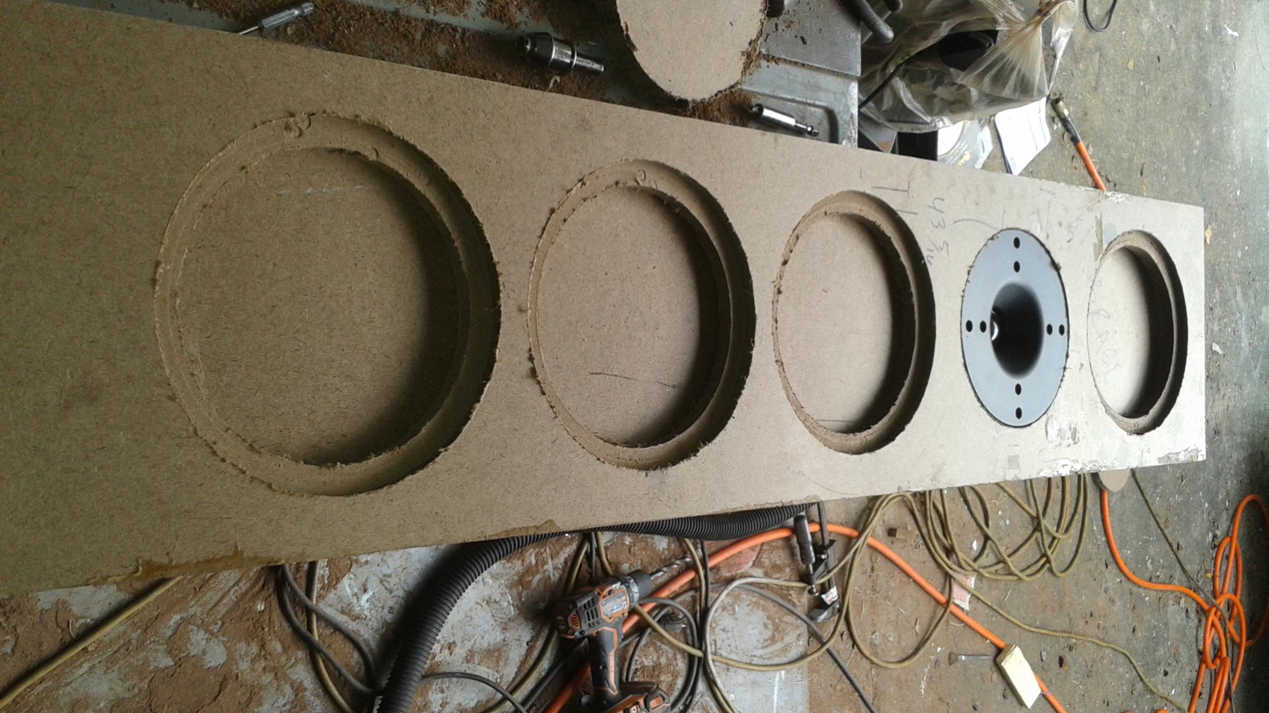

I'm done with all the internal wiring, and all I have left is to install the front and back panels and the stuffing, and paint them, and then install the drivers. I hope to get them painted tomorrow and have them ready to listen to Sunday.
I have really taken my time with these, as I laminated 3/8 in pieces together to make HDF paneling. Hopefully it's going to pay off.
Here's the internal wiring. I haven't connected to the posts yet but they are ready to go. 😀 Man I am stoked.
Incidentally, the paneling was 3/8 of an inch, and I laminated 5 panels together for the body of the cabs, including the front brace and 4 panels for the front panel. 5 panels should have made the panels 15/16 of an inch. But once they were all glued together, and I got around to measuring them they are 13/16 of an inch. Hopefully that's close enough.
irext:
Will you be offering pcbs and, if so, can you give us an ETA?
Scott
irext:
I should have asked this in the last post: if you are going to make your Elsinore crossover pcbs available, is there any chance you could add pads at each location to permit the use of different components?
Much appreciated,
Scott
Much appreciated,
Scott

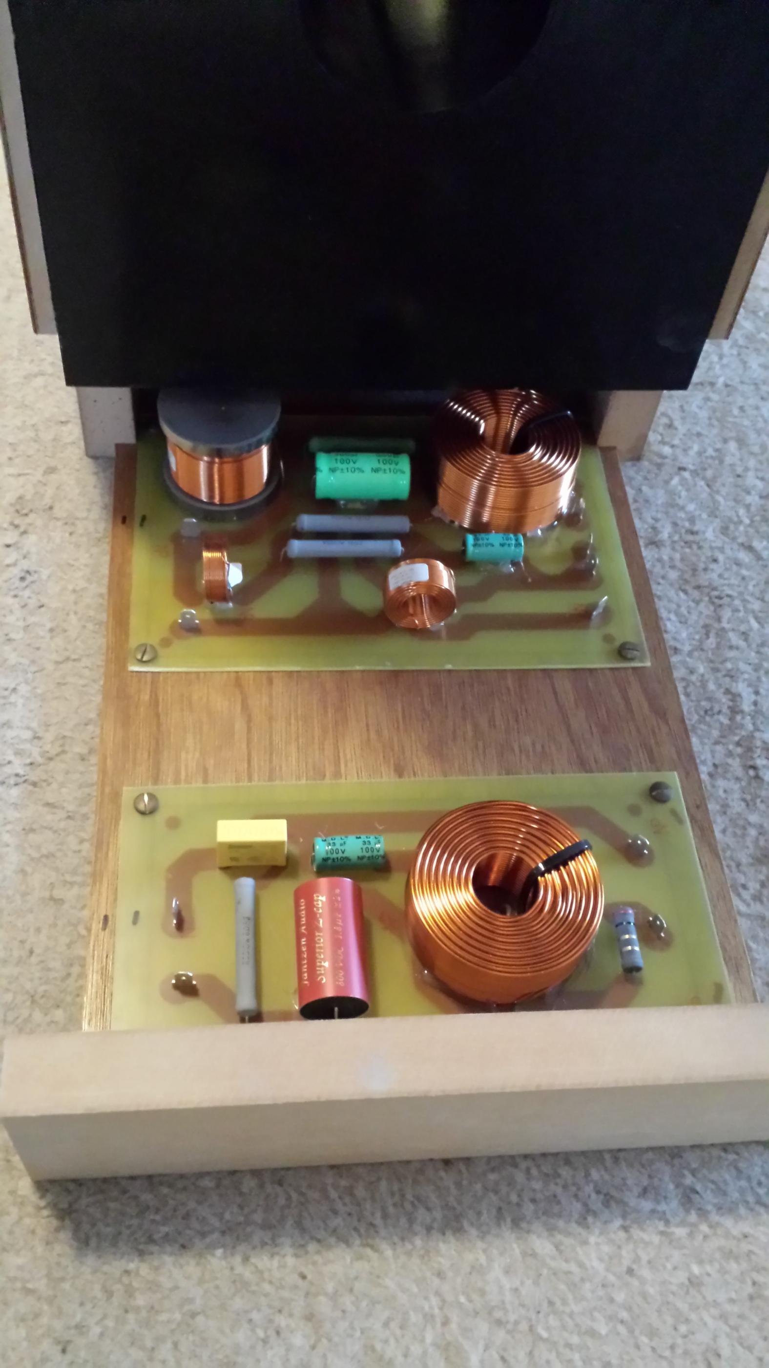

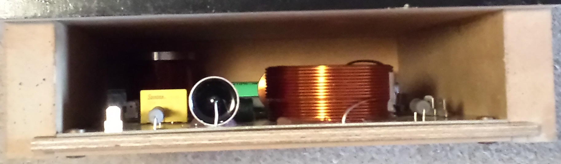

Crossovers done. Ready to be cabled. Very happy with the way they fit into the foot under the speaker.
Many many many thanks to irext for his time and skills developing the circuit boards and assemblege (is that a word)

Elsinore Xover PCB's
I am going to get some prices for professionally etched PCB's. They are done on a panel basis so you fit as many boards as you can to a panel. At present I am etching them at home which gives a nice result but is quite labour intensive. For an outside company I simply give them the Protel file and the boards are sent to me. They can even have screen printed overlays etc at an extra cost. As for different components, I've designed them using Jantzen Inductors, resistors and for the C1 cap (Superior Z cap) which I feel is as good as they need to be and overkill in some areas. If you are going for foil inductors etc they will not fit and I have no real plans to do a PCB for them. Otherwise unless the components are vastly different in size they should fit. I have taken great pains to eliminate inductor crosstalk and as you can see separated the LF and HF sections to separate PCB's. So stay tuned and as soon as I get some quotes and work out costs I will post some prices. I hope you are O/K with this arrangement Joe R. I don't want to step on any toes.
