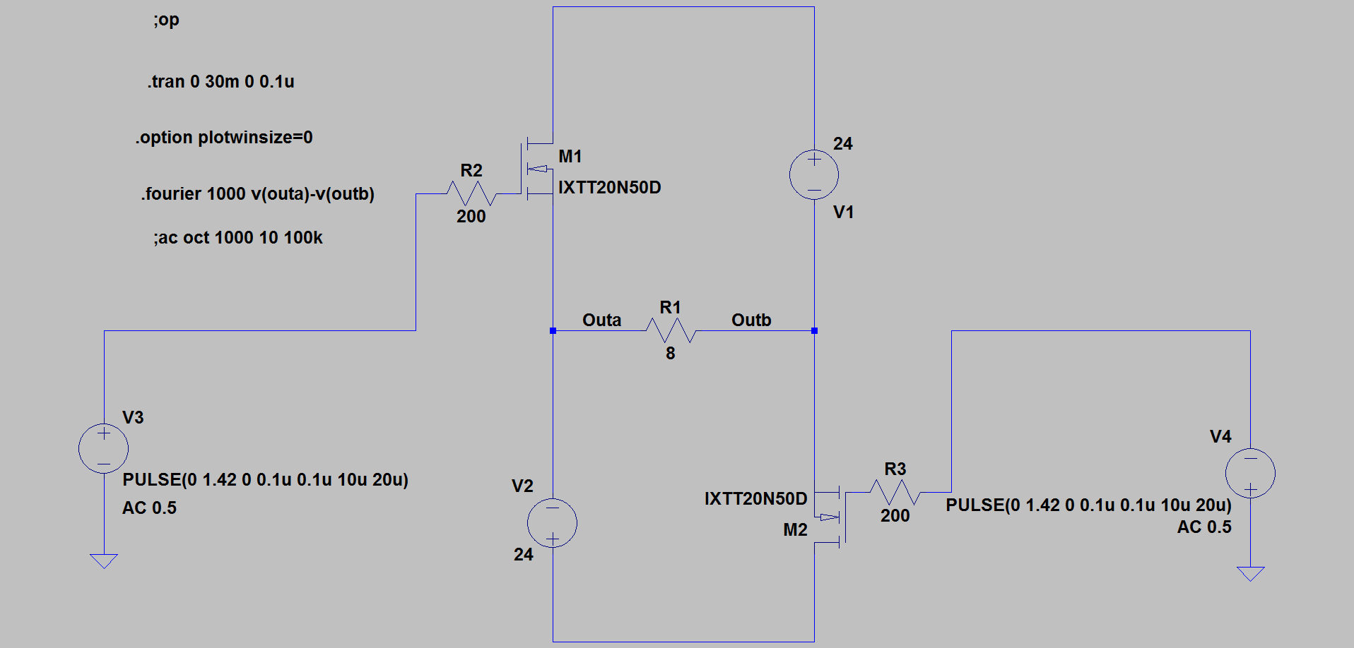

This one is even simpler. Depletion mode mosfet.
Obviously left off a few components.
Provided Id is appropriate at Vgs=0 and the Vds you want to use then this makes things a little simpler.
Not sure how tightly matched they need to be for 0 DC offset. You can always put an Elna Silmic cap at the output
