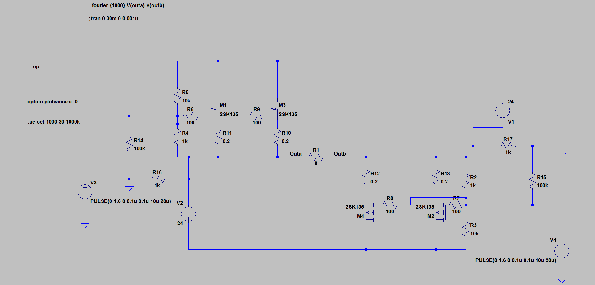

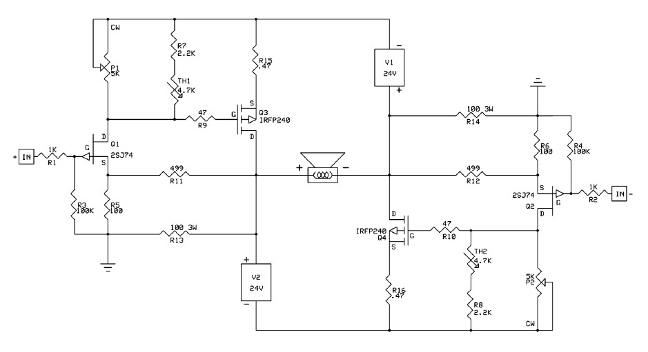

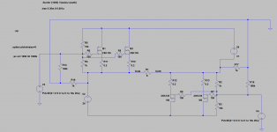

I don't want to copy Mikes amp. I want source follower. The amp works fine. I just need to know how to properly earth it. The supplies are part of the circuit if i connect it to chassis earth current will trip the mains box. Or will it?
that's easy
shall we go step by step ?
just draw one source follower without load , properly biased (we're going to stack two of them later )
in fact - what you need to draw is CCS , with gate equipped to receive the signal
so - input signal firmly referenced to gnd
then neg leg of each PSU just loosely referenced to gnd
those are earth/gnd
just matter of drawing proggie
ya see that input gnd and that what you're calling "earth" are the same
so - just to bring ya few things closer ........ and probably to confuse you even more :
gnd is referenced to input signal gnd ; those two floating power supplies are referenced to system gnd via those two 50R resistors
so - what's important - that mosfet's gates know where gnd is ......
you can bring either balanced or symmetrical input signal , it will work
say that ballanced signal you have if you feed signal from line level xformer secondary , without grounded center tap ...... so signal is floating
symmetrical (balanced) signal is when you ground center tap on secondary ......... so signal is not floating
