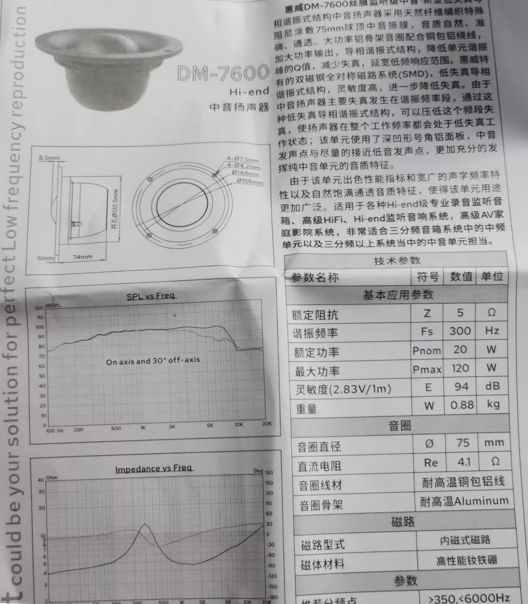

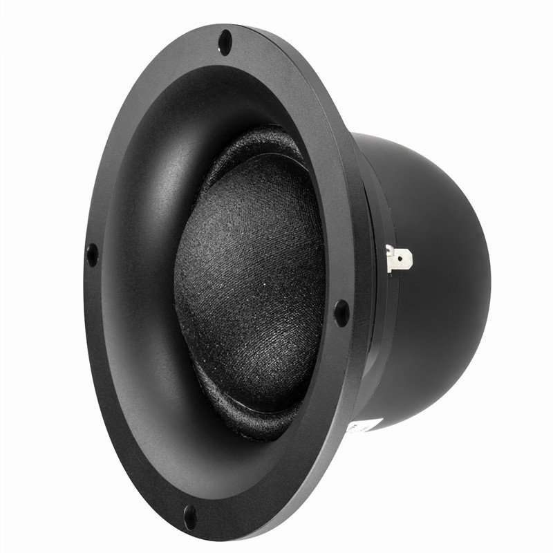

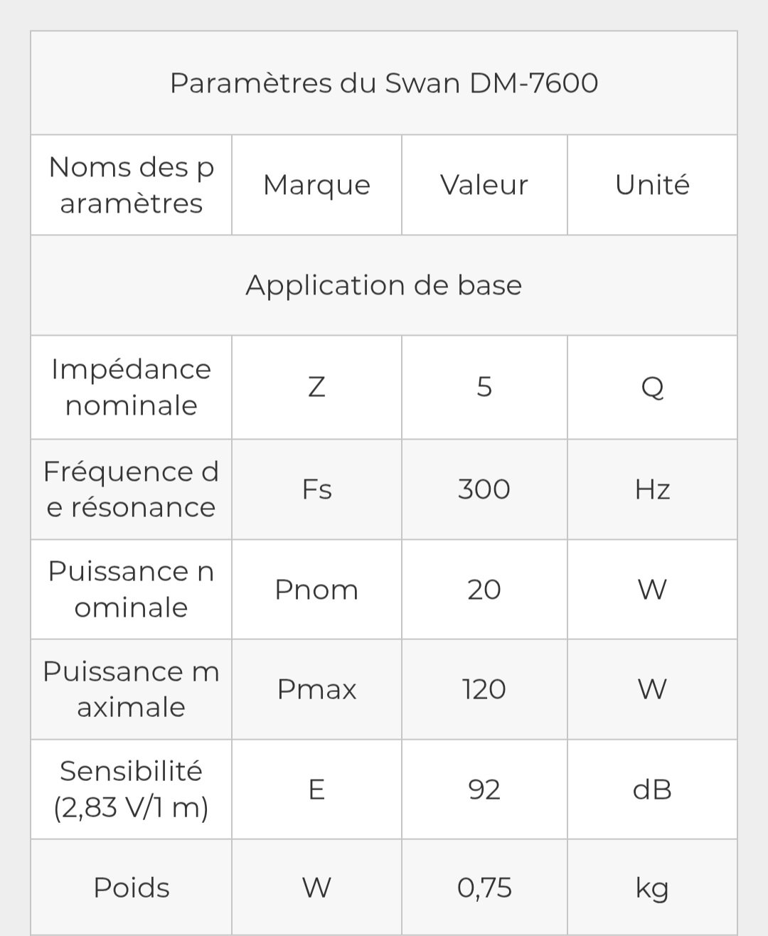

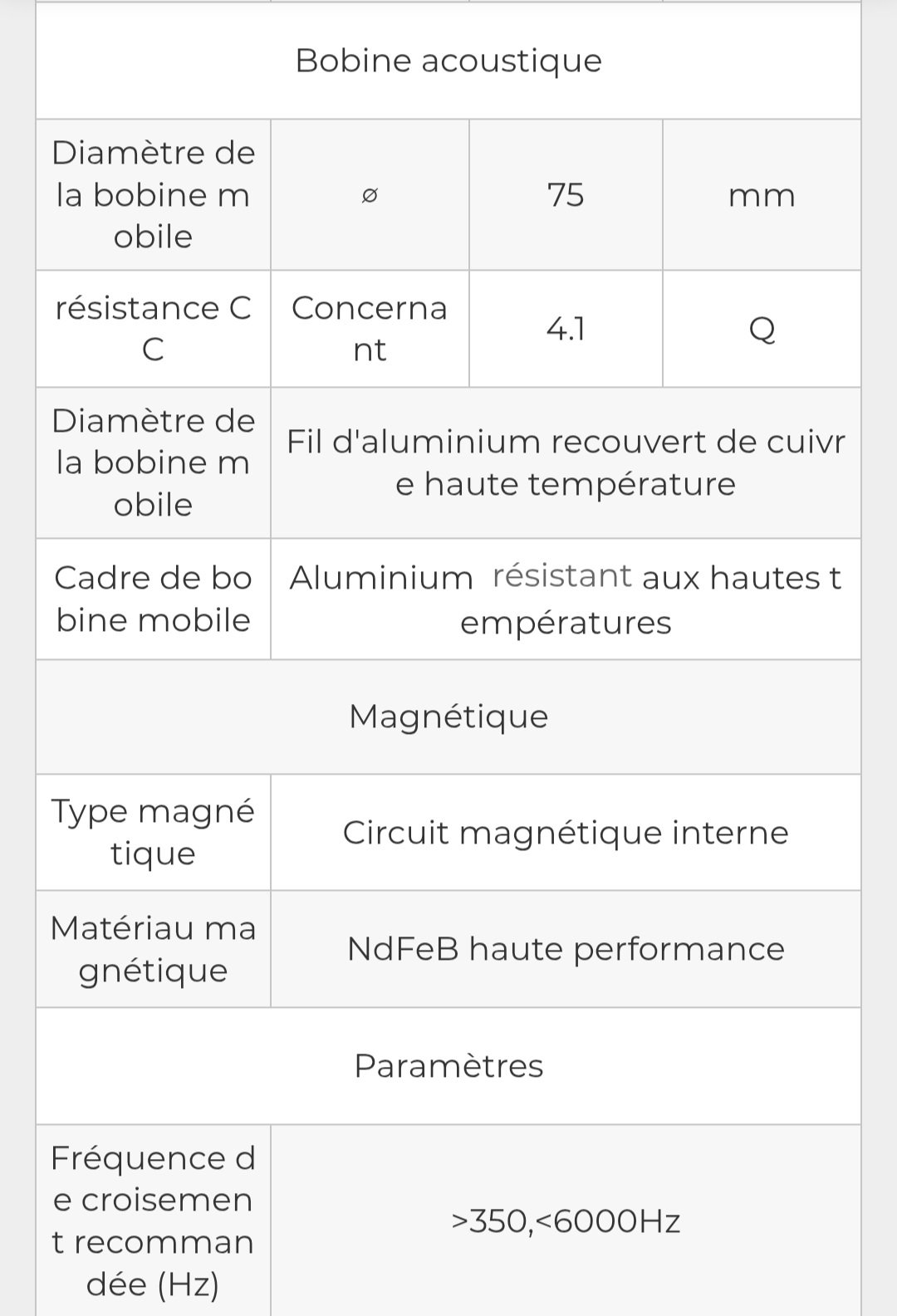

How can we get so nice low end performance, down to about 400hz, with the M74 with a moving mass of only 2,3 grams?
Regular bass driver with a light cone sucks at the deep end...
@swak I prefer all thr bass cone from the main L+R speakers, so if they can't go that low (at a decent SPL), a subwoofer needs to pick up the slack. I'd aim to cross at about 80 hz,.depending on room acoustics and placement limitations. Even so, I still try to get some overlap on the low end if the room needs it to blend seamlessly, otherwise I'd still have some flexibility of chosing the most appropriate turnover to the sub. The 40 hz rule implies that (without a sub) the main speakers need to go down cleanly to 40 hz with some decent SPL. I'd of course expect subs to extend the FR further down, otherwise there's little point of having them in the first place. I hope that explains it.
@Jonasz Well, from my POV, I'd choose a higher crossover for the M74A/B/T. 400 hz is pushing it too far and just about smack on the driver's Fs. That causes issues and you'll run into excursion limitations. Even if the mid can do this,its still not advised, just from a reliability standpoint alone. You can get a good midbass to match the distortion performance of the M74. There are plenty of midbass drivers out there which will do that and if it can't be done with a single midbass, then you can run multiple units without issue. Thats due to the WL at crossover being long enough to blend the output of two smaller midbass without any significant off axis destructive interference.
