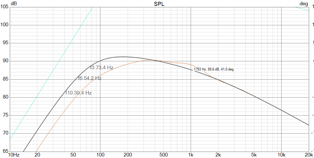

20L full stuffed / Qtc 0.6 (brown line is 4Pi FR on a 25cm wide baffle)Audax HM210C0 works well as mid-bass (XO +/-@600). What is the recommended closed volume?
