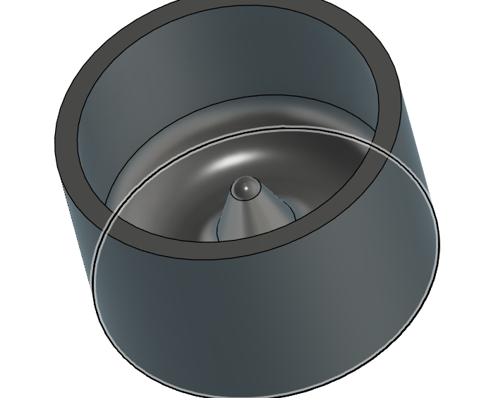

@mikessi I did two prints of the D7608 chambers out of ABS. They weren't pretty due to weird settings with new filament I previously haven't used, but functional. I took pictures before I stuck them in the small test boxes I made for my son's monitor project and for some reasons I couldn't find them in my phone, but the original chamber design worked well. At least I'll have those measurements once I transfer the whole folder from the laptop.
@stv I'd say its ok to post the files on here for people to print from. The design is close enough to print unmodified as long as the infill ratios are high enough. 50 - 60% is probably more than enough for adequately stiff walls. Might be a little resonant for standard PLA depending on grade. Printing it inverted (open side up) is likely the orientation that will yield the lowest print time. You will need to tweak the inside ID to fit exactly on the D7608 motor. I don’t recommend extending the inner center post of the back toroidal shape so that it touches the motor. I'd use a good quality contact adhesive to attach the chamber around the inner ID to motor edge so it can be removed later. You can also attach the chamber to the enclosure opening for the mid. Id personally do the later, as its a bit simpler to make dampening changes on the fly, not needing to be constantly re-glued.

Here is the modifed version of the shell with the flat bottom. This makes it much easier to print. I highly suggest you use the "adaptive layer height" function in the slicer. This will greatly reduce the layer line effect on the curved surfaces of the model.

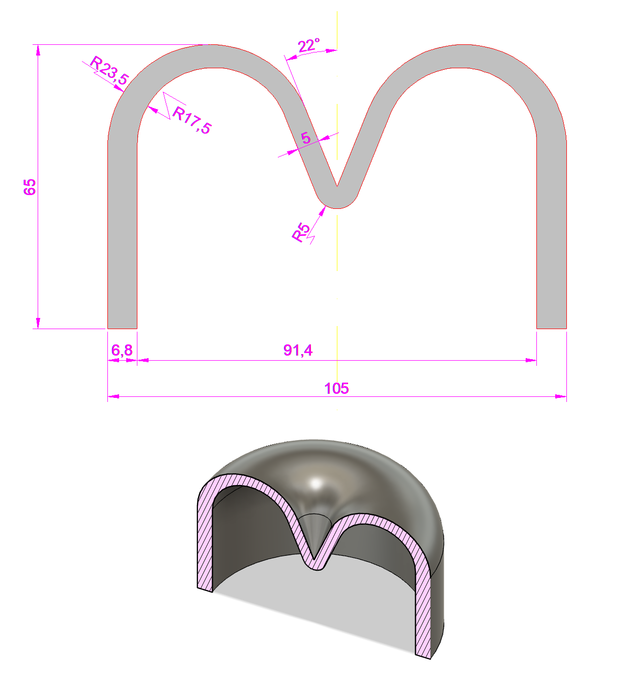

The original drawing of the D7608 chamber looks like this -
The actual diameter of the chamber opening is on average 3.590", derived from measuring 8 different units. You'll want to leave yourself about 0.005" wiggle room, otherwise you'll be doing some filing or grinding. Doing a test print to verify if your printer is close would save you potential headaches because most printers aren't that accurate in final dimensions. The 91.4mm ID is actually 3.598", so it has some variance already built in.

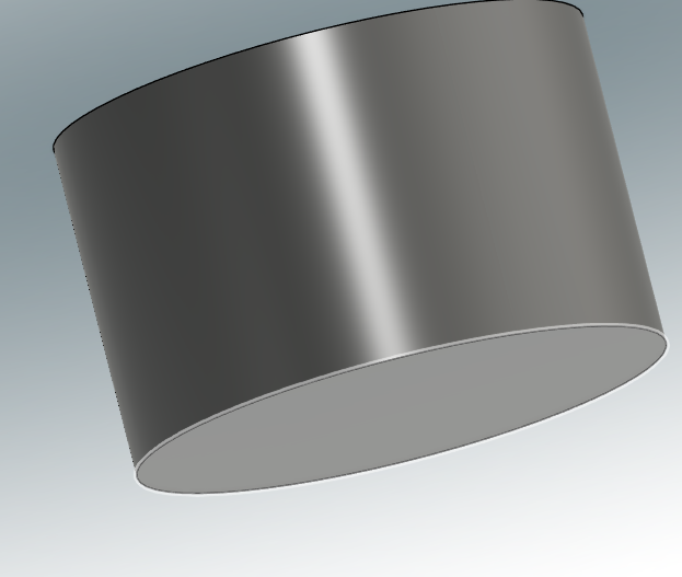

Here's a slight chamfer/fillet. Should make it a little easier to fit.
A taper fit could be beneficial if the taper is just right. I get a little concerned about using adhesive with this, mainly because it can become a little too aggressive of a fit.
All I have are a couple pictures of the back of the dome. If you just snap me a picture straight down the side (perpendicular to the side of the dome's back shell), I can use that picture to perfectly match the taper. Just send pic with a ruler along the top for dimensioning.
