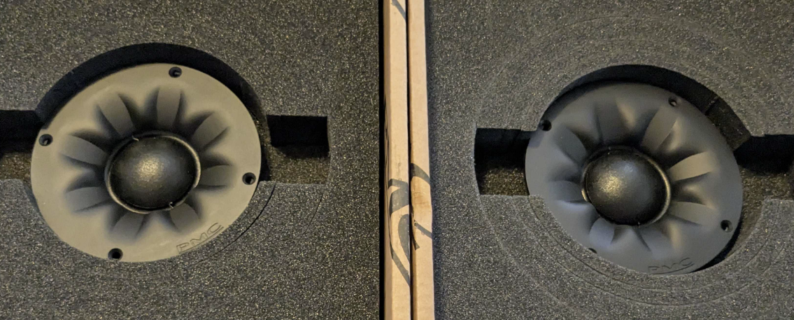

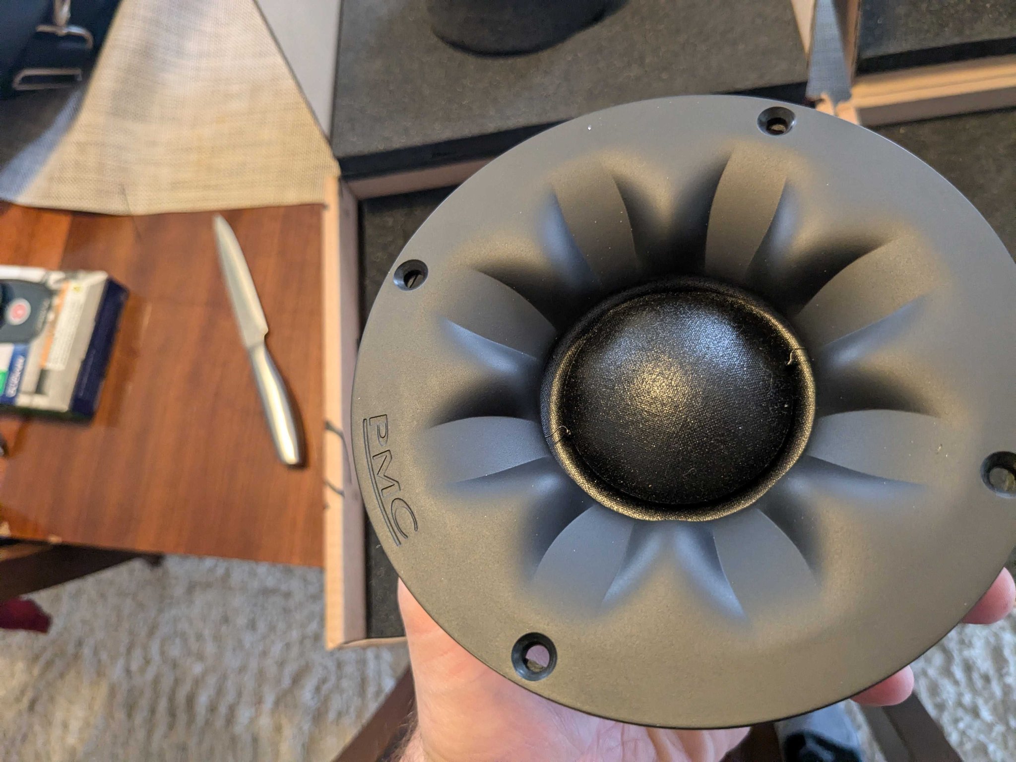

I recently received my pair of D7608s. After opening the box, I noticed a mark on one of them—about 4 cm long—resembling a trace left by something that had contact with the membrane. It seems unlikely that this occurred during shipping, as the packaging made it almost impossible for anything to contact the domes. Therefore, it probably happened during storage.
I'm a bit irritated by this, but perhaps it won't affect performance. Any comments? I can ship them back if I wanted to.
One option could be to take photos and send them to the supplier/Manufacturer and ask for their view.
I would say their current pricing puts them at a point where they should have passed through some kind of QC check for acoustics and visuals. Possibly I am being naïve on that point.

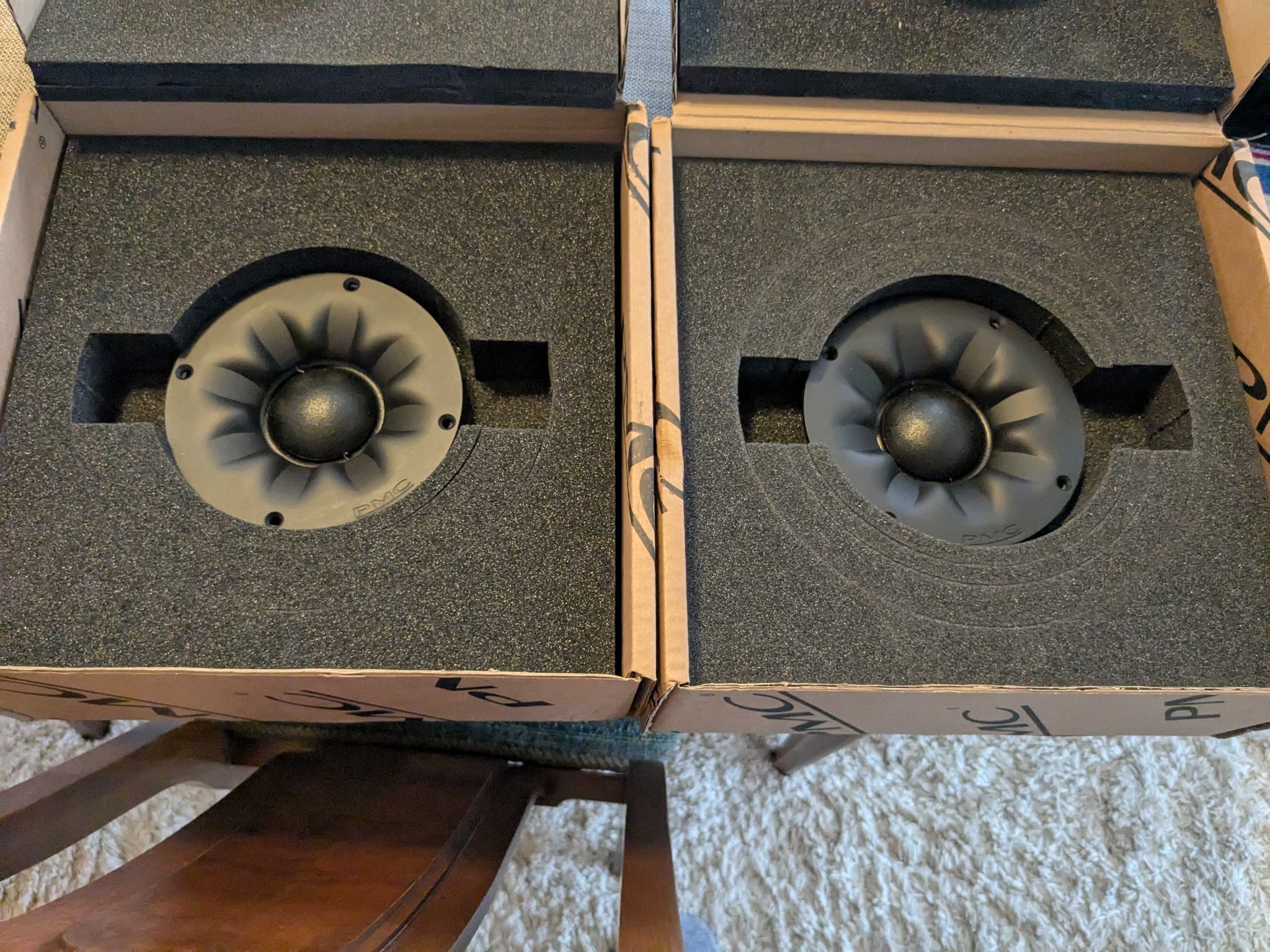

My oh my, these are sexy looking.
$380 for the matched pair has me feeling like I got the deal of the century.

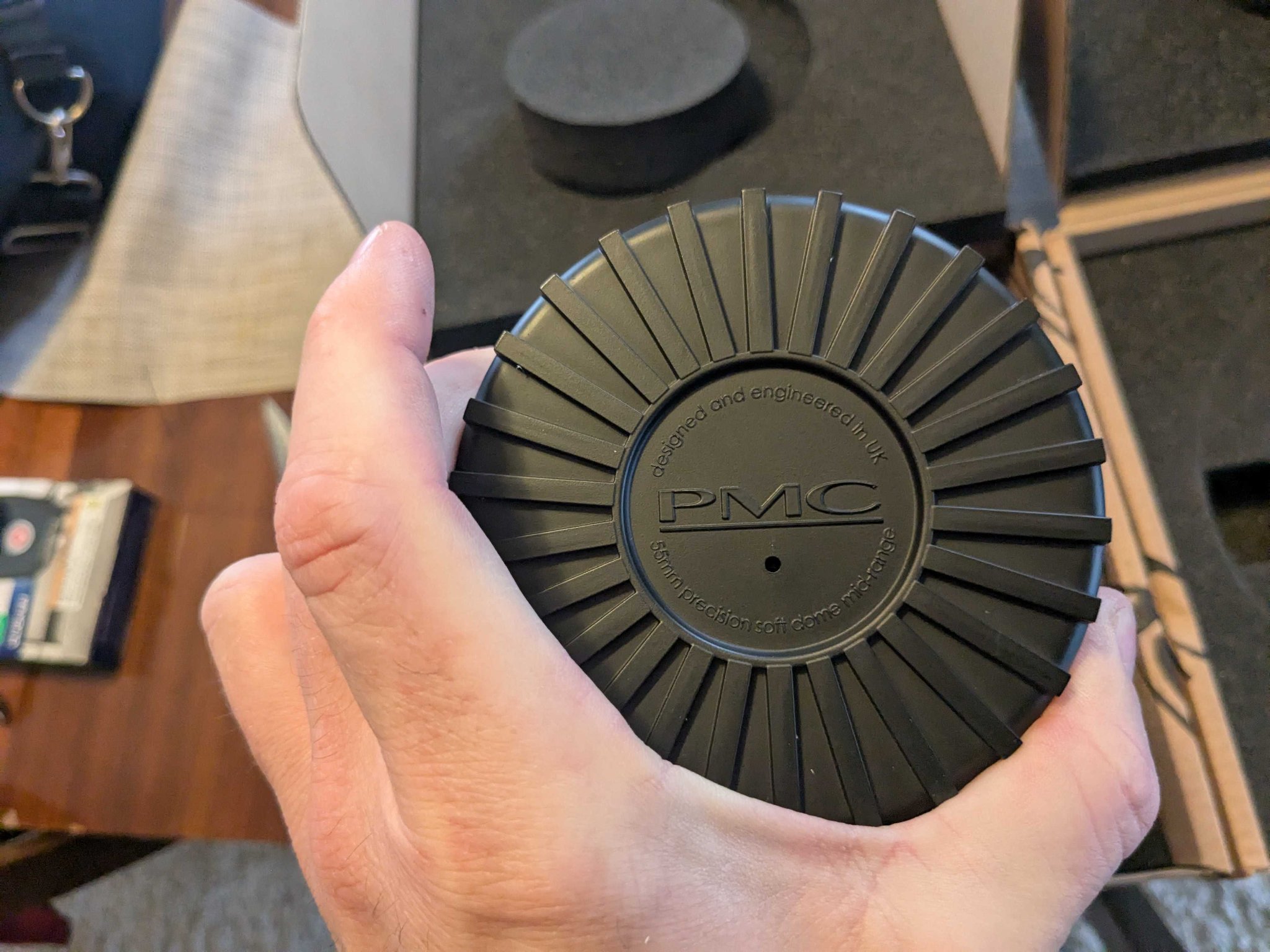

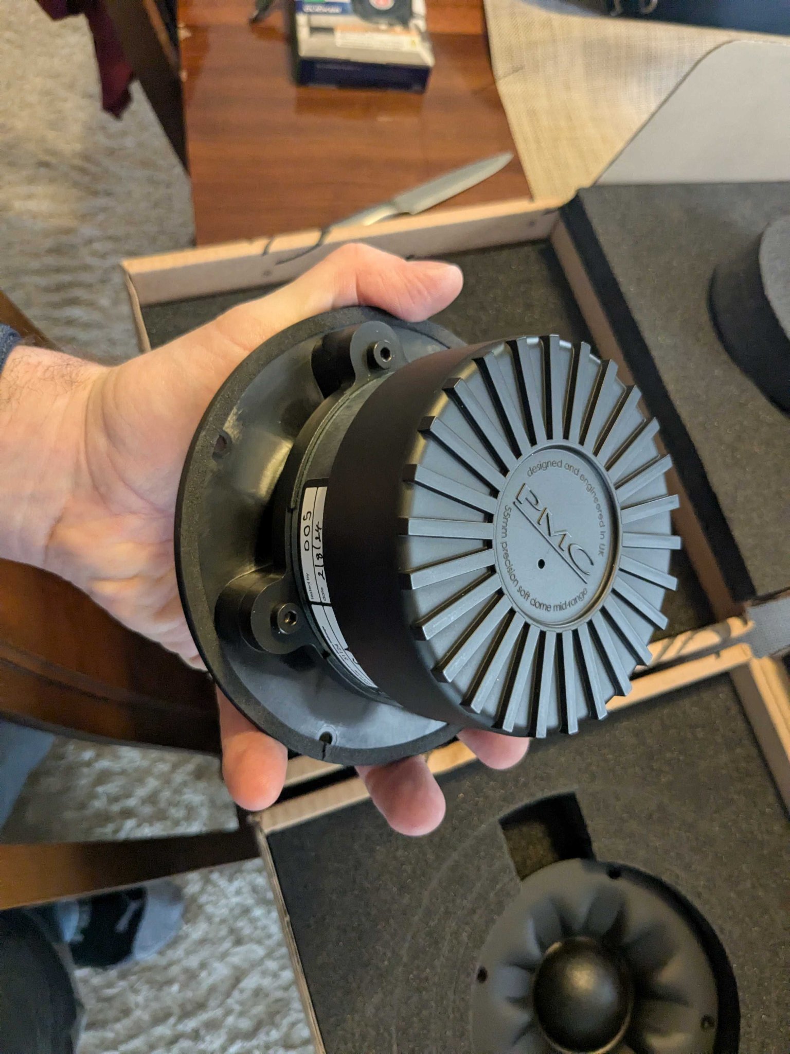

As a reminder, this is out of the PMC speaker I heard at AXPONA 2025 and was the absolute BEST mid range I have ever heard. These will be going into a rather large build that involves either Wavecor balanced drive woofers, NE line Peerless, or Satori woofers. Will have to see how well they play the upper mid and treble to see what I want to do with the tweeter.
I like that they come with the waveguide. Now I don't have to reverse engineer that. The build quality here is superb.
