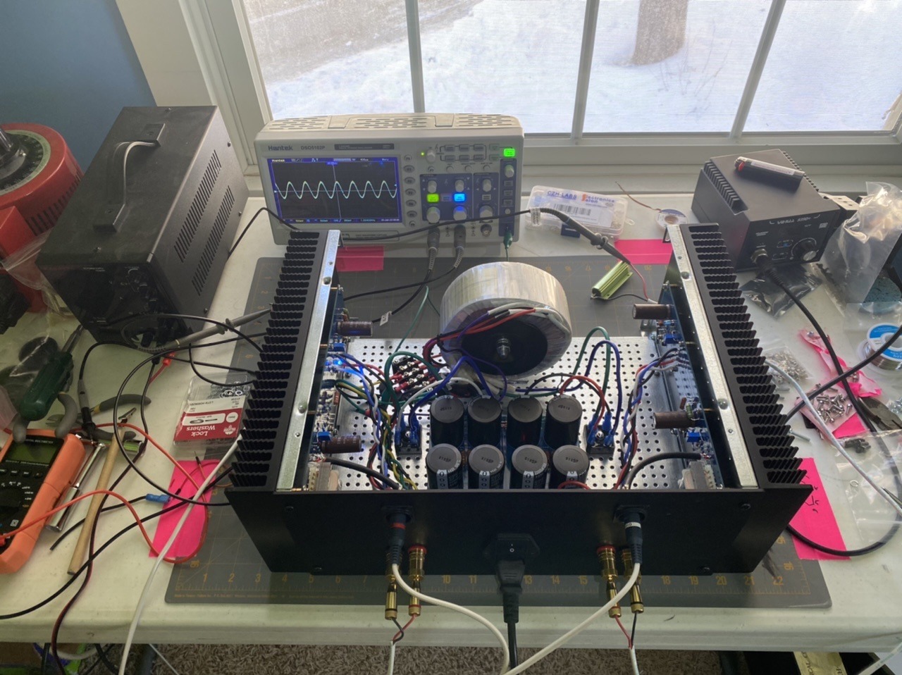

Last Friday night, I finished baseline wiring up of both channels into the half-assembled chassis, enough to bring them up on power with a DBT and a variac. As I had the bias pots fully minimized, it took me a long time to get current flowing and registering bias on R2. I thought something was wrong and even took a break to ponder what I was missing, but then, one last turn and the bias started climbing from 0.000 V up to .01, .1, and into the hundreds. Whew!
I got both channels fairly well balanced to 500 mV and low offset and called it a night.

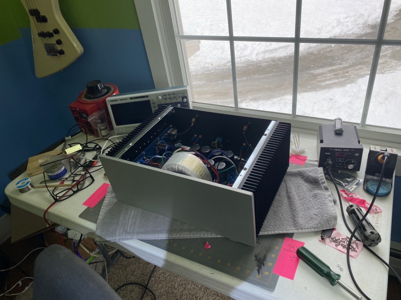

Saturday morning I went through the chassis assembly and hooking up inputs, outputs, getting wires routed and the whole thing assembled enough to carry it down to the listening rig once the bias and offset were in range. I then spent an hour listening and tweaking the bias, letting it warm up and settle in. I think I spent five minutes with the scope and a sine wave, "Yap, it's amplifying the signal. Next!"
I did lose an R2 up in smoke, I don't know why, but it was easy enough diagnose (not so many components on the board to check, eh?) and replace, and it's been a rock since then.

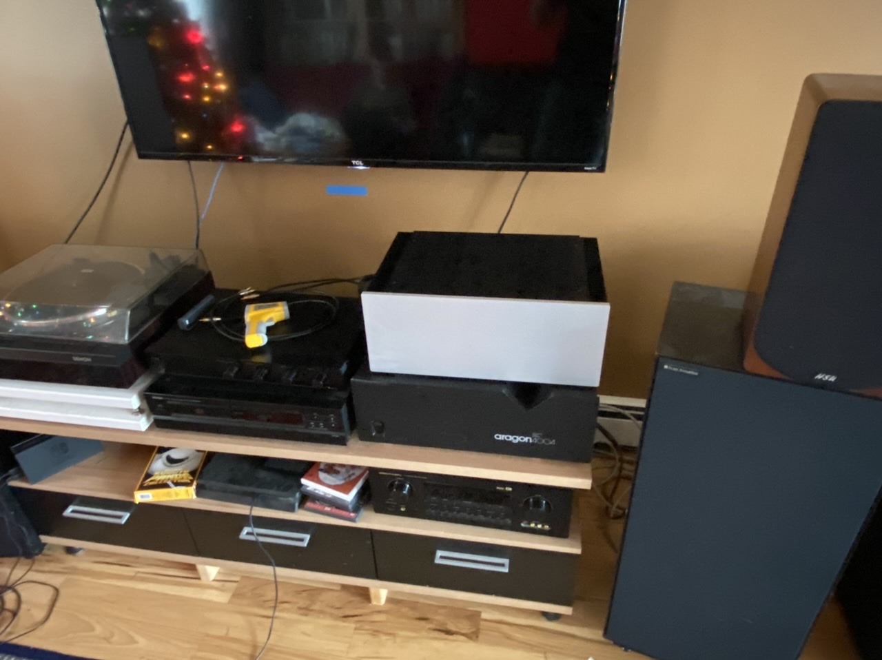

What, you no likey my mid 80s motif?
I’ve got a real Japanese-front-end through American-iron vibe goin on there.
*By the way, this thing is dead silent. If you want to sit in silence and contemplate the universe, I highly recommend turning this thing on and playing nothing. You'll just get more silence, but with a better sense of the room where nothing is going on.
You sir, win the internets for the day! 😀
Congrats on that build. Also love the 4004. Still have a 2004 for some fun stuff. Had a 4004 and an 8008BB. Wish I had the 8008BB back.
I had a 2004 once. Sold it and regretted it. But... glad I got some diy 1stW now!
Thanks!
That 4004 has had some adventures. I bought it off of Ebay in, oh, 2002; seller was in Augusta, Maine shipping to me in the Denver area.
Fast forward a few years and I'm living outside of Augusta, Maine and it needs some servicing. Turns out there's actually a tech in town. I take it in, he looks at it, asks where and when I got it. Yep, it was originally his. Small world.

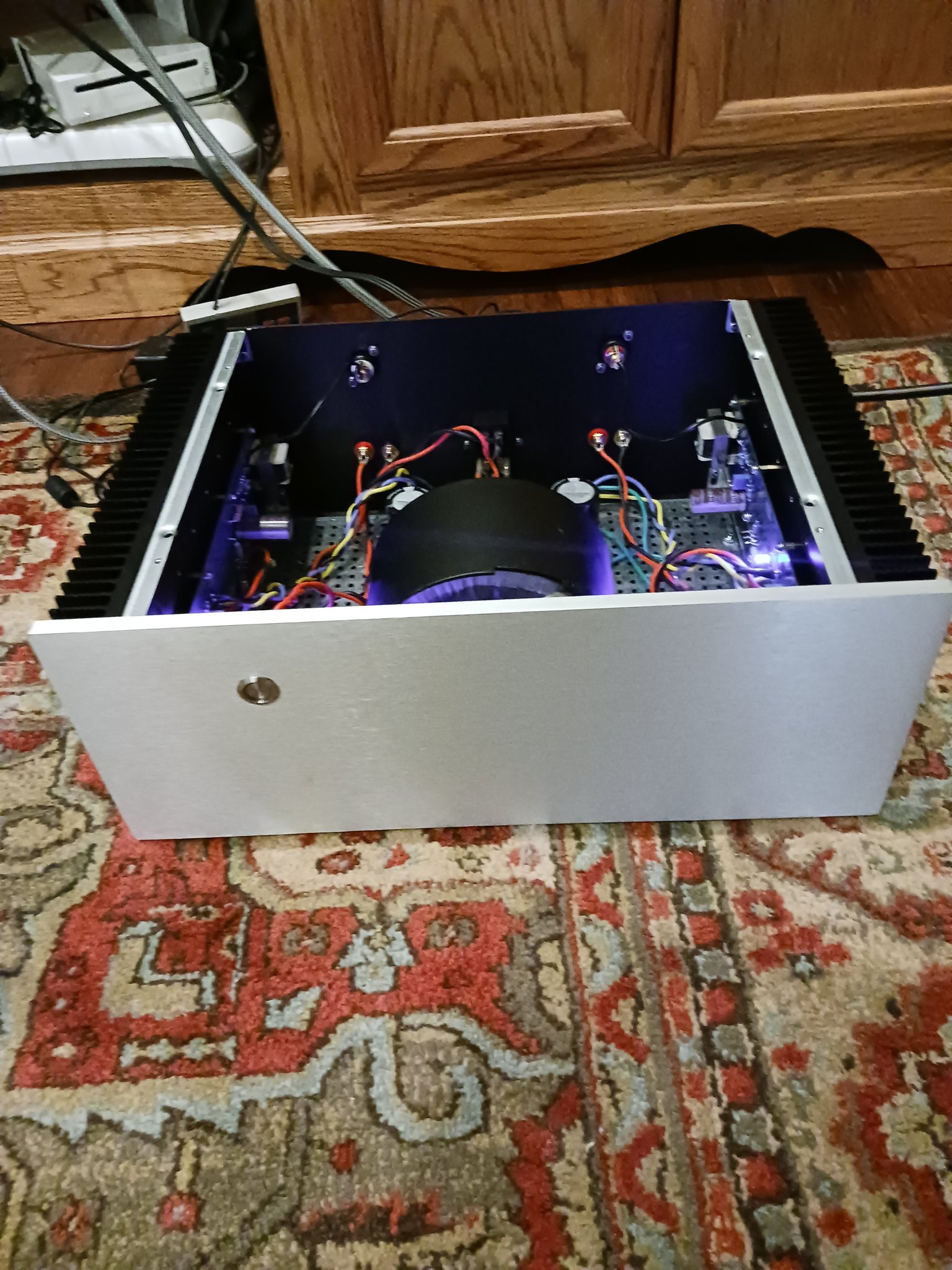

I just finished the final bias adjustment for my first non-kit project, an F6 in a Modushop case. I ended up going to 620 mV - hopefully it won't get too hot. I had no trouble whatsoever setting the bias thanks to the suggested mods. There is no hum. In fact it's dead silent with the DAC cranked and no signal. I still need to do a little wiring housekeeping and hook up the power button LED. I also plan to add snubbers to the bridges when the parts get here. This amp sounds absolutely wonderful. It really shines with live recordings - especially strings and percussion. I'm listening to some Nils Lofgren and it sounds like he's sitting in my living room. I'm blown away. Thanks to Nelson Pass and all the folks who make this site possible.
Well done and congratulations, the F6 is a very musical amp to enjoy!
Are you wiring that front panel latching toggle between the IEC inlet and the transformer?
