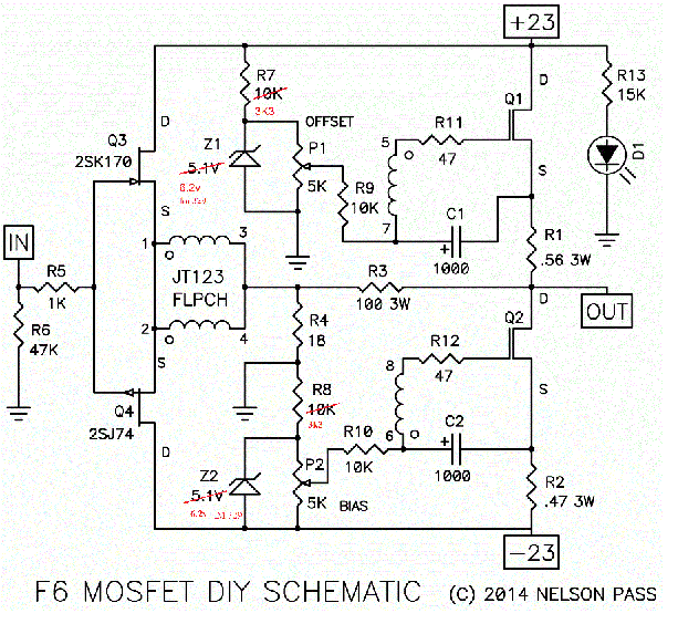

i have purchased the kit First watt F6 and I am able only to get on R1 or R2 with only 0.3V when I turn the Bias to the end. Everything seems to be right but I cannot get 0,5 V.It’s the same on the both PCB.From power PCB I’m getting 24.6V.
Have you experienced same problem ?
What are your Z1 and Z2 zener values? If they are 5.1V, apparently your kit has some ~6V ones you can try.
While you're at it, if you're using 10K for R7 and R8, consider replacing them with something lower (say 3 to 5k)
I used Z1 and Z2 5.1 V , P2 -5k, R7,8 - 10k.Tomorrow I will try change Z1 and Z2 for 6v from kit.give specifics of values in biasing circuit

Hello all, I have changed Z1 and Z2 as recommended and now the bias is fine. Thank you all for the very helpful advices! Cheers!I used Z1 and Z2 5.1 V , P2 -5k, R7,8 - 10k.Tomorrow I will try change Z1 and Z2 for 6v from kit.

Schematic in use at the moment.

I use FQH44N10 as Q1 and Q2 with good effect, and of course the green led bias solution. I have not used any other mosfet as output device so can't compare directly. I changed R11 and R12 to 100 R as a result of my tests with my ACA. Less than 60 ohm for the gate resistor gave a harsh upper register and 120 ohm a bit more muted sound for whatever reason. How that will apply for F6 I don't know.
I leave changing the values for R1 and R2 for for now, maybe add 50 mOhm to the source leg of Q1 as a test at some point. That is relatively easy to do, just cut off the right leg of Q1 and add a small resistor as a crutch.
As it is right now, distortion levels are at about 0.04% at one watt and with very equal levels of 2nd and 3rd harmonics.

I have done some modifications to my F6. The first intention was to "correct" bias pots working the wrong way.
New pots fitted and all correct and logical now.
Whilst doing this I changed the bias from lm329 to three green leds. This went well, it just needs attention in getting the diode clusters in the correct orientation. (opposite way to the zenners.)
Biasing (measured across original 0.47 resistors) to 650mv was easy and very stable.
Also, I changed the big fets from IRFP240 to On Semi FQU44N10-F133 which has been mentioned previously.
This was done just as an experiment "because I could."
Listening now and any change is subtle. If anything, the overall sound is "warmer" with very slightly less harshness at the top end.
