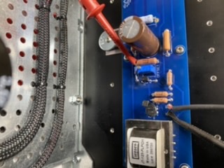

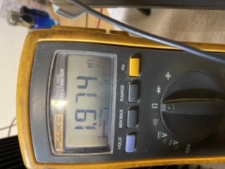

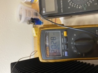

Hello,
I’ve completed the build of my f6 amplifier. I tested the power supply with both channels disconnected and got 26 vdc for each channel, no problem. Before powering up each channel I wanted to set P1 and P2 trimmers in the middle of their range. Using a DVM I tried to do this but can’t seem to get a consistent reading out of all 4 of the pots, offset and bias on both channels. I made each adjustment slowly and watched for changes on the Fluke dvm as well as the LG. Both show similar responses. Both meters have new batteries. I tried changing locations for negative lead with same results. I’m unsure how to more accurately test? The pictures show high (2.03k ohms) and low readings (1.974k ohms). Please see pictures and advise.
Also, take a look at R9 as it’s larger than some of the other resistors. It’s 1/4 watt 10k but a larger size. Is that an issue?

Thanks Zen Mod,
What I discovered is that the trimmers only adjust in one direction, cw or ccw. Once the maximum is reached the resistance begins to decrease. This was consistent with P1 and P2 trimmers on both channels. That was counter intuitive to me as I had assumed once a maximum was reached that rotation would need to be reversed to reduce resistance. Does that make sense?
So, I’ve set all trimmers to minimum. Specifically, offset at 13.5 ohms and bias at 91.5 ohms. Interesting to me also that offset and bias on both channels were very close. Odd? Anyway, I will proceed this afternoon with powering up both channels individually.
Thanks for your help
