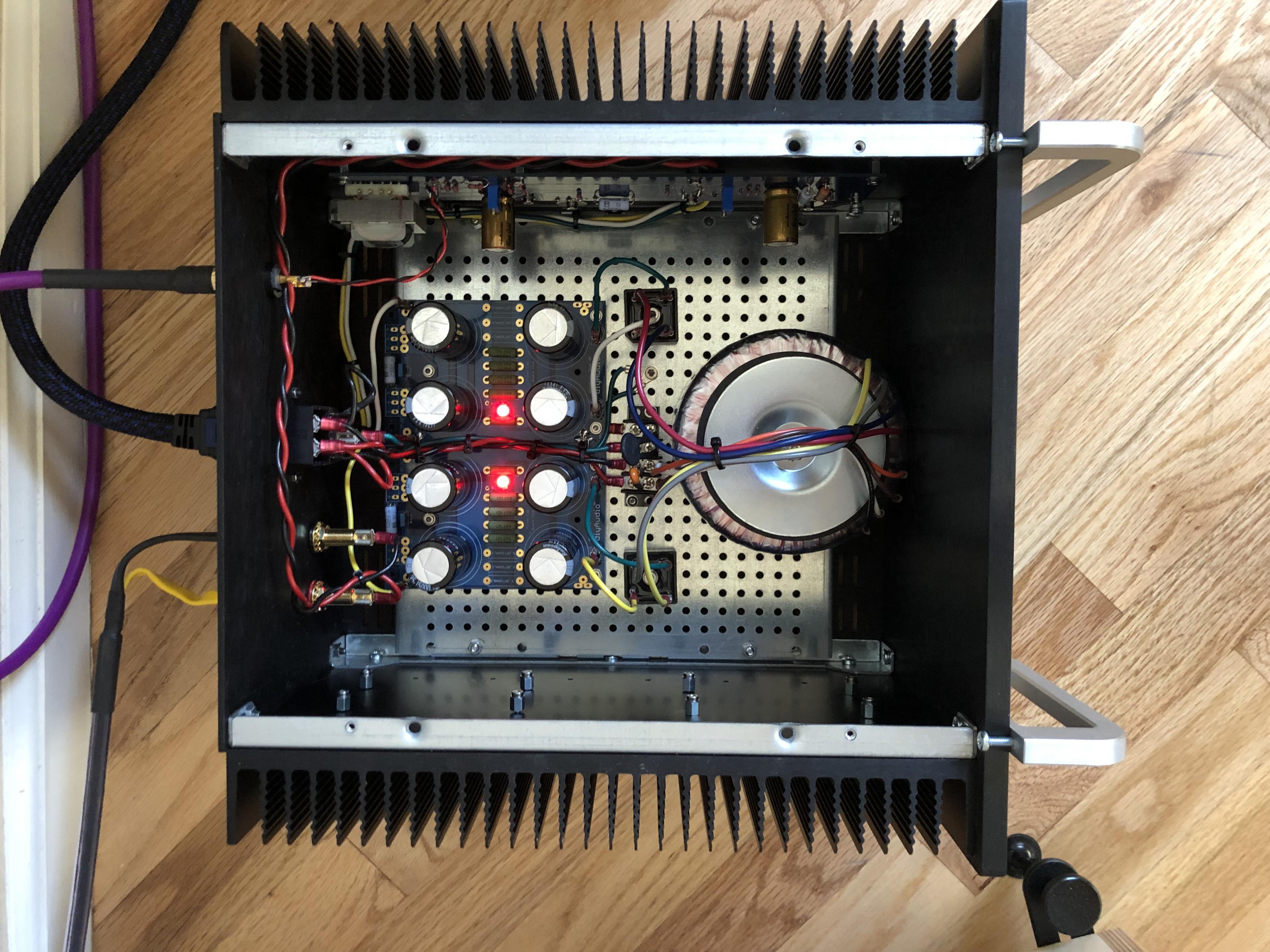

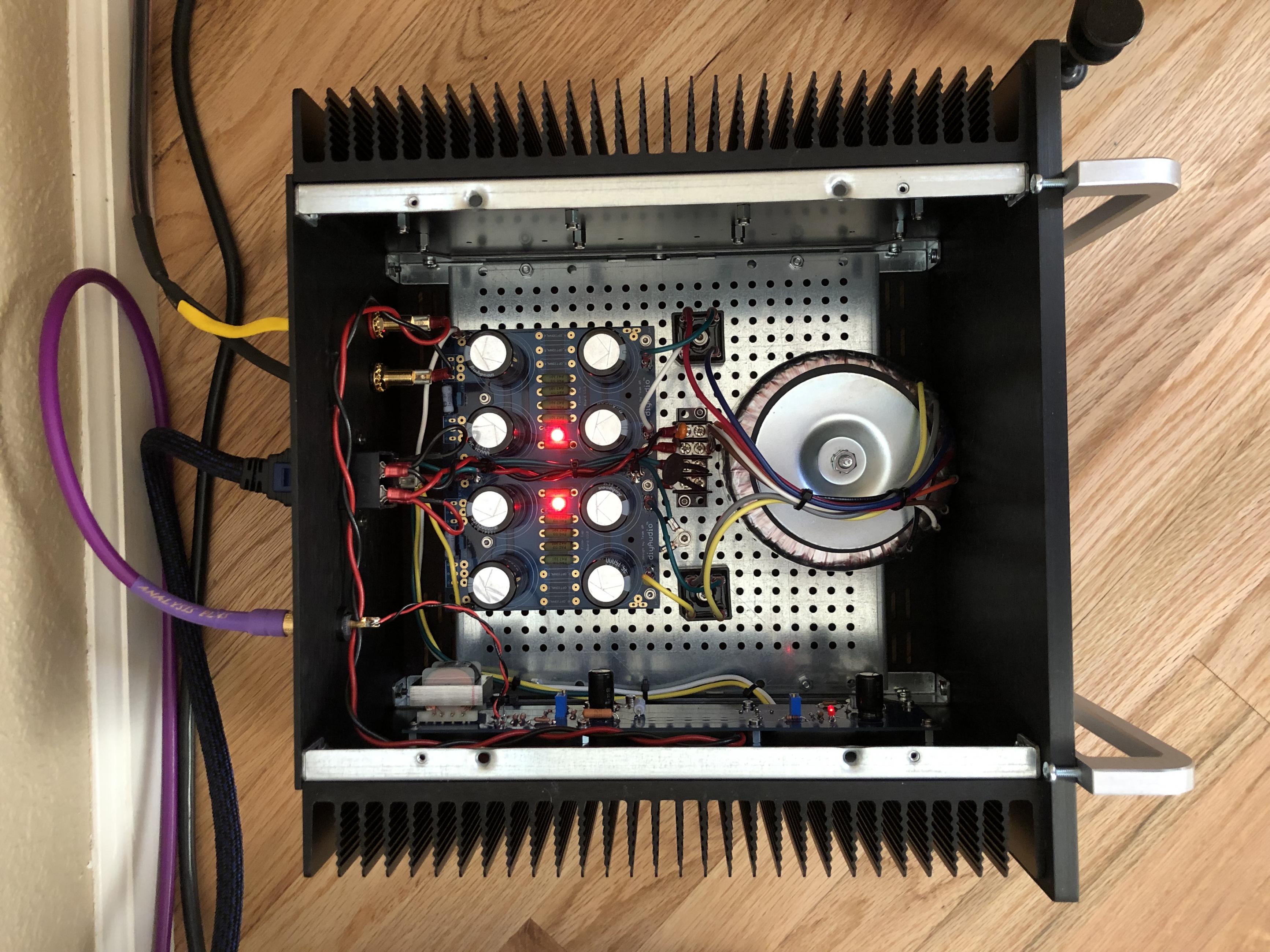

I keep wishing I could turn the gain up more. That's how much I like these F6s.
Might have to see about a preamp.
Thank you. I didn't swapped the input transformers, I will try to do so and replace the mosfets if they are not the root cause.
Whatever it is, you will smack your forehead when you find it.
Build a Wayne’s BA2018 or IronPre.![]()
I was really hoping not to complicate my system much more! 😉
The original plan was to morph these monoblocks into monsterblocks, balanced F6s that I could switch one half off to operate SE in the summer then switch everything back on for balanced operation in the winter. Nothing quite like a space heater to help out with these Denver winters, eh?
So, yeah, got these F6s in a monoblock pair and was thinking the balanced operation would help with the gain a bit more. I even have a second set of boards completely stuffed and ready to mount, just need a second pair of transformers and to build up the second set of PSU boards sitting in the bin o' parts. However, in a behind-the-scenes, scheming and dreaming email exchange with zman01, he pointed out the output impedance of the F6 was a bit high for running in balanced mode (0.5 Ohms). I immediately realized the error in my machinations and my evil audio genius pivoted to the possibility of some monsterblock F5s. All the bits are there in the chassis to add in the boards, psu and transformer and the F5 has extra bit o' gain and a nice svelte output impedance of 0.1 Ohms. Good room warming times!
In the meantime, need to finish these up and enjoy them for awhile. I say I'd like to turn them up some more but they already shake the house. They just sound that good. Time to go dial up the bias.
