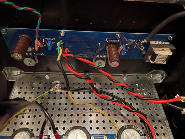

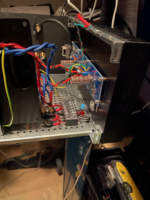

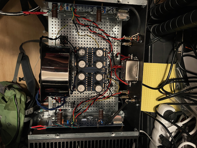

Hi guys, I have some pics of the build i'm just trying to set the bias now
the right Channel set perfectly
the left channel has an issue
bias set ok to 500 mv but the offset has 17-18v coming through the speaker terminals and the pot does not have an effect something also my led is not on this side either. I checked the jfets and they were ok but I replaced anyway. so
any thoughts before I replace everything

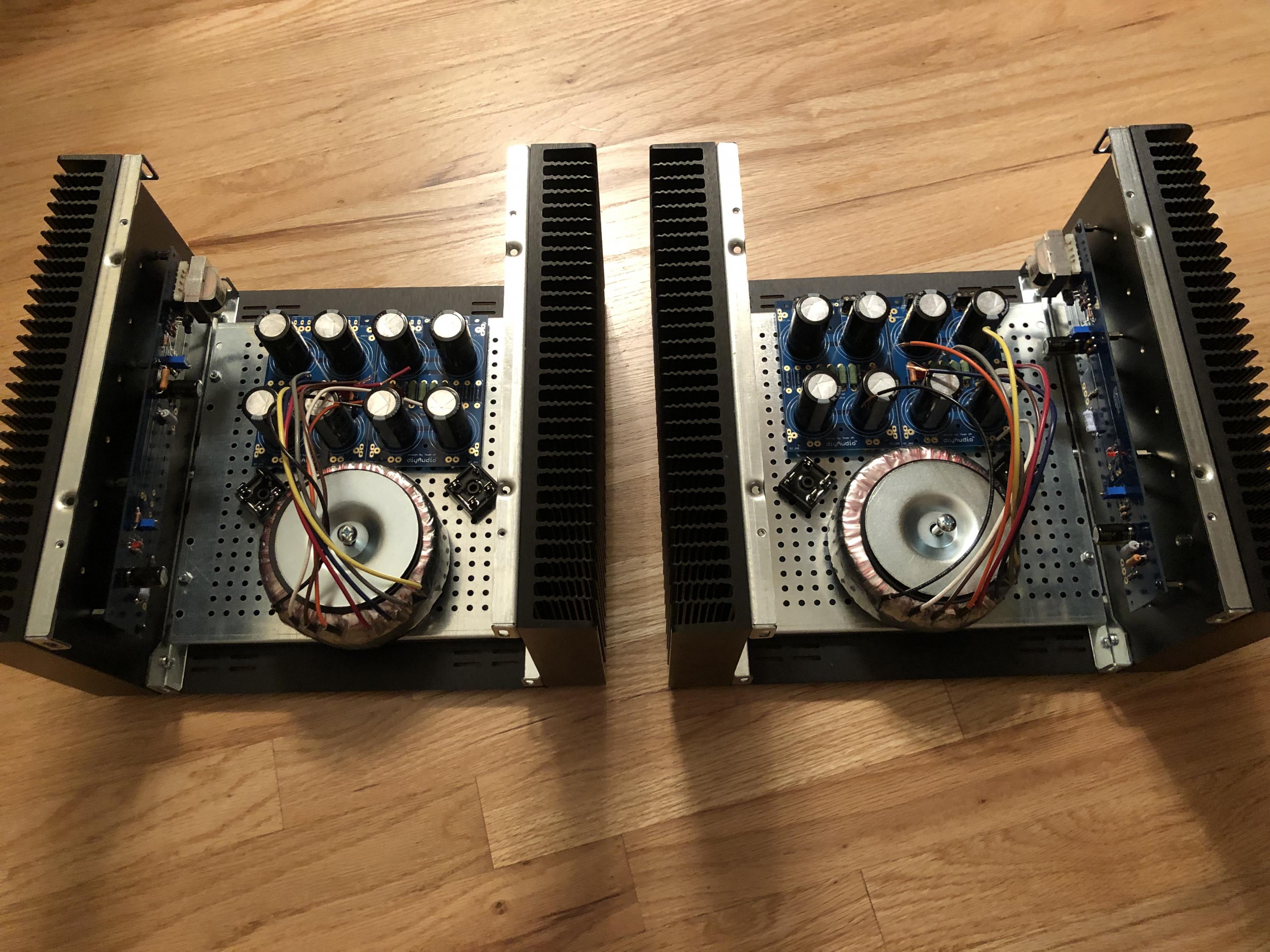

That's the plan! Going to contact HiFi2000 to see if they can do some custom face and back plates but if not, time for some heatsinkless cases and some frankensteining.
Mono-blocks are sweet. 🙂 Looks like you are close to starting work on the internal wiring?
So close, Z! I still need to make another Mouser order to get all the quick connects. Also having to work a separate order with for more of the hardware. I've been hoping the DIYAudio store would get their hardware kit back in stock as I've been having a turrible time tracking down the correct standoffs thru Mouser. Resorting to McMaster Carr but still have to pull the ACAs apart to make some measurements.
If anyone knows the screw lengths, washer dimensions for all the M3 hardware, it'd be greatly appreciated.

Tom,
You are referring to the following?
1. M3 spacers and screws for fixing the amplifier PCB on the heat-sink
2. M3 spacers and screws for fixing the power supply PCB to the floor of the chassis
3. Washer and screw for holding down MOSFET on to the heat-sink
Z!,
Yes. This is what I got so far if you can check my work:
1. Signal PCB/Heatsink:
a. Standoffs: M3, brass, 6mm stand-off height + 5mm thread length
b. PCB screws: M3 x 3mm thread length (maybe 4mm)
2. PSU PCB/floor:
a. Standoffs: M3, brass, 6mm stand-off height + 8mm thread length (have these already)
b. PCB screws: M3 x 3mm thread length (same as 1.b)
3. Transistor/Heatsink (from ACA hardware):
a. Screw: M3 x 10mm, stainless
b. Washer: M3 x 4mm ID x 16mm OD x 0.5mm thick - think this might be a No. 6 fender washer
Is this about right? Close enough?

Tom,
These look good to go. You should be making sound soon... 🙂
Soon!
hardware is expected Monday.
Putting in a final Mouser order tomorrow for the quick connectors and the last bit of resistors, caps and wire.
Thinking of having some fun and getting some fancy rca jacks and speaker binding posts.
Also, approaching HiFi2000 about some custom front and back plates. If not, Frankencase!
Over the weekend, I'll pop in the new zeners and matching resistors and do a trace thru to see if there is anything missing or needing a touch up.
Then it'll be learning about all things in-rush current and other solid-state quirks.
