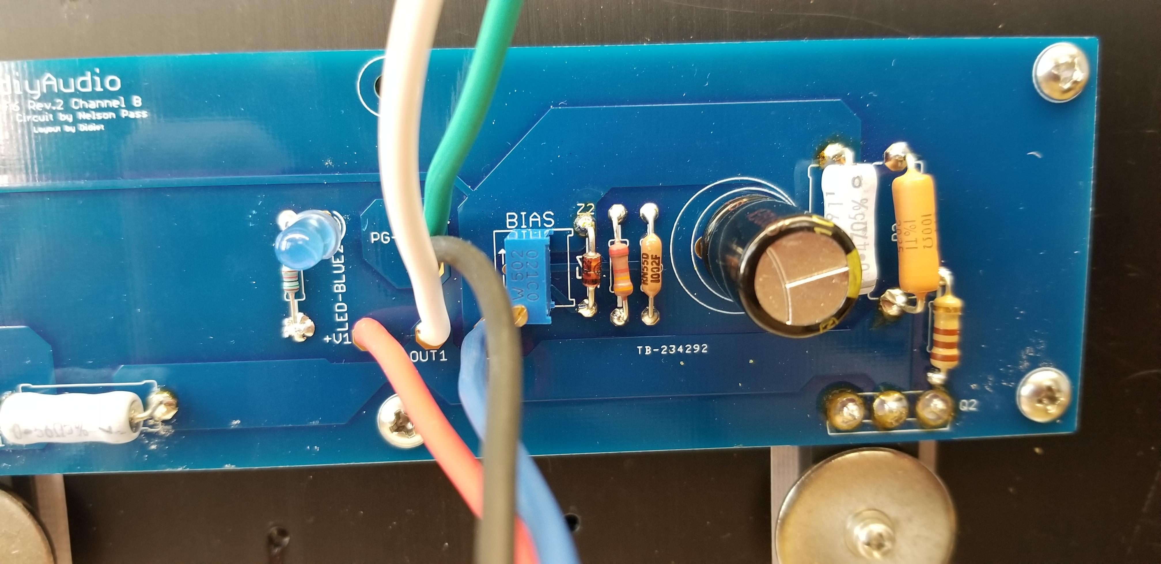

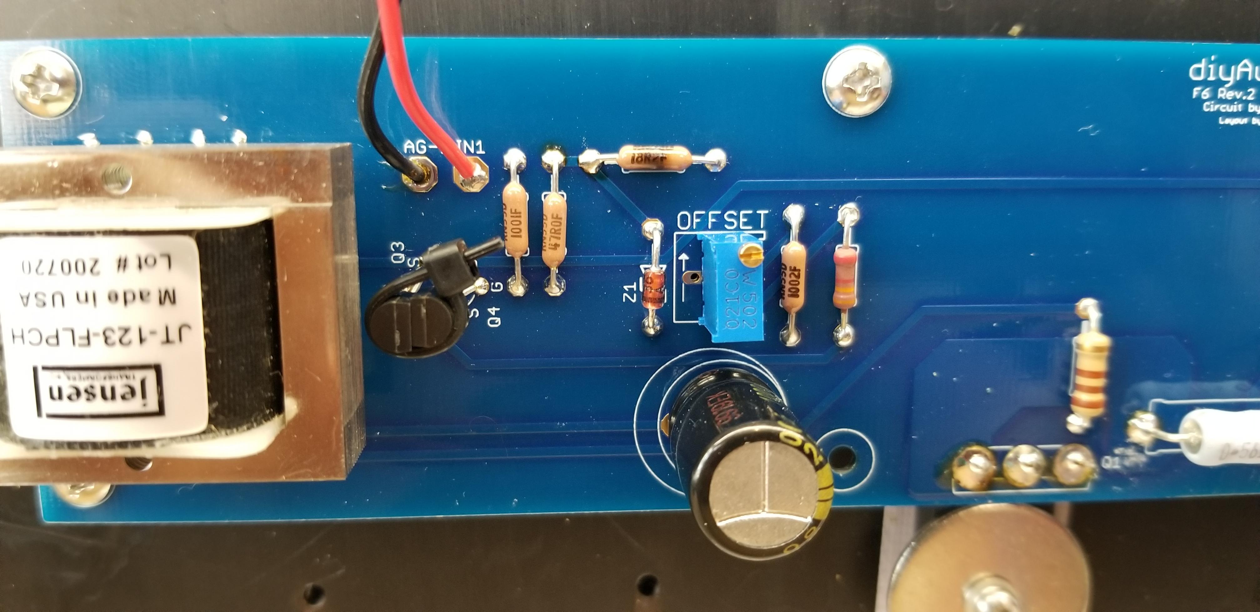

Cooked my R4 18 ohm resistor
Hello,
Need a little help. I tested my PSU with the dim bulb.
PSU shows +25.15/-25.1 with a Antek 32-18
I then tested channel B with dim bulb. Passed.
I was starting to adjust the bias with the dim bulb still in place.
And I fried R4. I used a Dale 18 ohm resistor [RN55D 202IJ 18R2F] from the F6 parts kit.
I had checked and have now rechecked continuity at the Mosfets. All good.
I used the 6.8V Zeners and 3.3K resistors.
I had positioned the pots in the middle of their range.
Nothing else looks fried.
I triple checked Q3 and Q4.
Wires: red to V+, blue to V-, black to ground. White is out and green is out ground.
Led works [yeah].
Any thoughts are appreciated.
