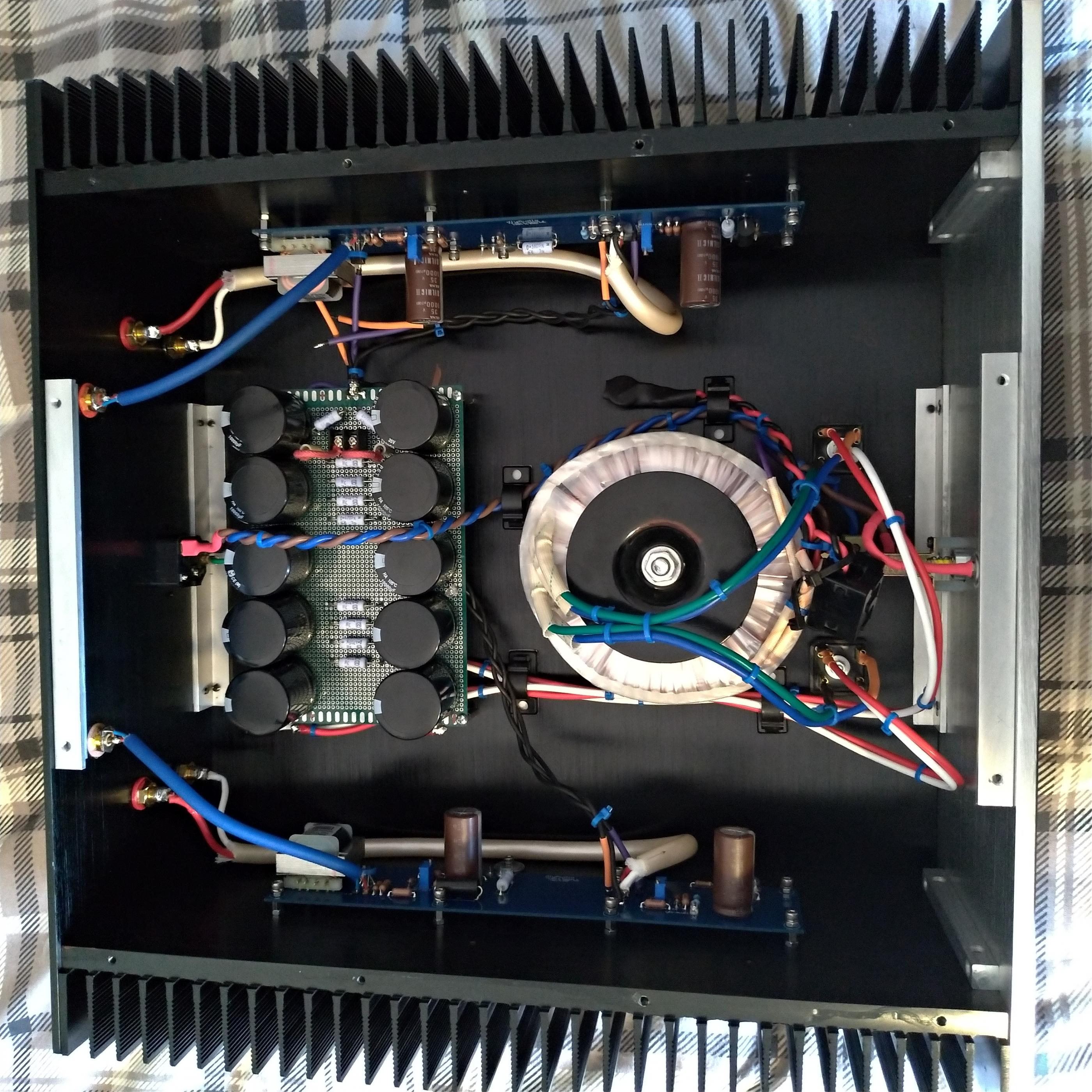

Hi Everyone,
After two years of waiting in the boxes as parts because of house move and not encouraging circumstances, finally I finished my F6 clone within a week with slow, careful steps.
Boards and Transformers and matched JFets and Keratherm isolators are from diyAudio store, PT is Antek AS4218 all other parts are from Mouser.
But I am hesitant to connect any speaker to it.
After 5 hours of bias and offset adjustment and monitorizing voltages;
Right channel offset is under 10mV with 630mV bias on 0.47Ohm resistor. During 5mV up and down voltage drift offset stays within +- 20mV.
Left channel offset fluctuates rapidly and when set at 630mV bias it is ~ +-40mV but then within 10 minutes voltage drifts + or - 5mV and if +5mV offset becomes ~150mV, if -5mV offset becomes ~ -150mV.
R7, R8 is 5K and Zeners 6.2V.
So,
1- What should I check or replace?
2- Left channel Led did not light up, because it is too much work to change its orientation on an already mounted board, I cut it off but its resistor stayed, any problem with that?
I did it to the right channel also for the sake of symmetry.
Thank you in advance for your suggestions.
Hakan

1) Are you using spring washers on the mosfets?
2) Also retighten the mosfets now that you thermally cycled the amp.
Then retest drift.
Also it would be worthwhile using the LED voltage reference mod if you're not using it, make sure you do the 2 things above first.
The main thing is you don't want it to drift much after it hits thermal equilibrium. The drift at start up is less concerning provided its not a stupid amount.

Today, I remounted the boards on the heatsinks through different taps.
Now Mosfets are firmly attached but left channel offset fluctuation still exists but smaller degree than before.
I decided to do 6L6's suggestion and set bias at 540mV and offset is within limits of ~ +-50mV for a few mV change of bias.
I think it's somewhat safe to hook up a speaker now. I can't wait longer to hear it.
Both Mosfet's Vgs is 4.45V and stable.
Thanks for your help,
Hakan

Hi everybody,
Today I also replaced the 6.2V zener close to offset adj. trimpot and now all is working well.
Bias is 600mV, both channels offsets are under 10mVs.
No hum, no noise.
So the culprit was both faulty zener and loosening bolt.
Thank you all for help.
