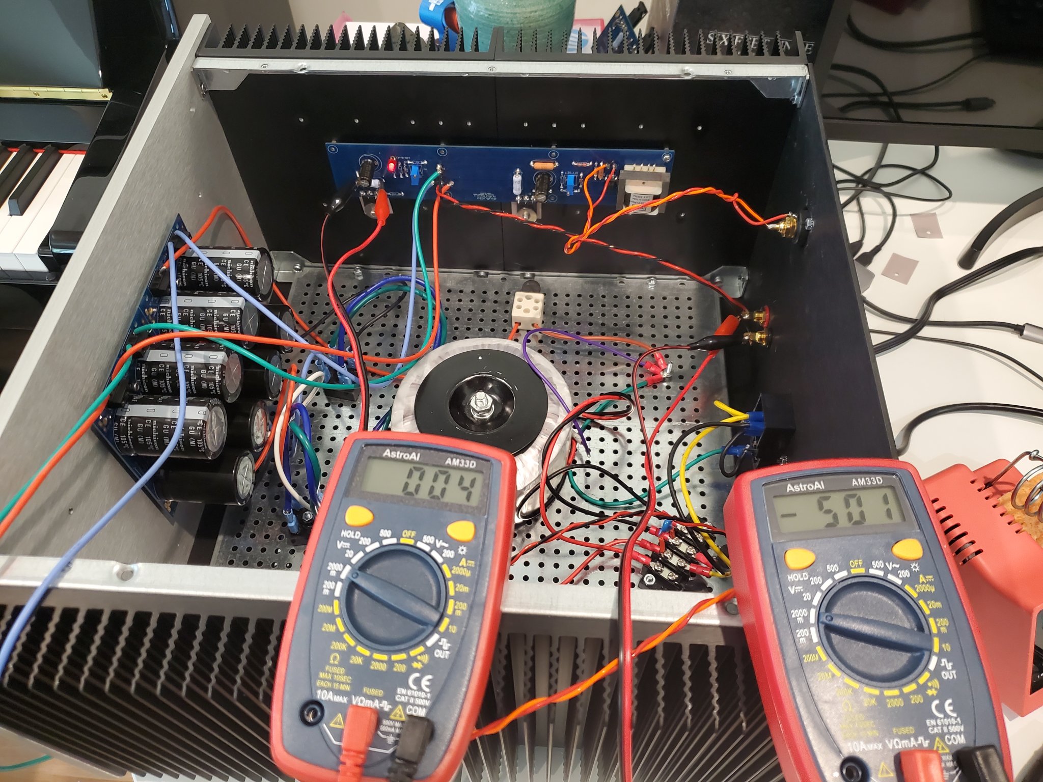

OK. Power supply by istelf measures just over 24v. Put in left channel, looks perfect. I adjusted to 500mv bias, 0 offset. Mosfets started heating up too. Right channel not good. LED lights up, but it's dim, and I measure no voltage across the source resistor. No heat off the mosfets. Below is a pic of the left channel wired up. Guess I will triple check the right channel.

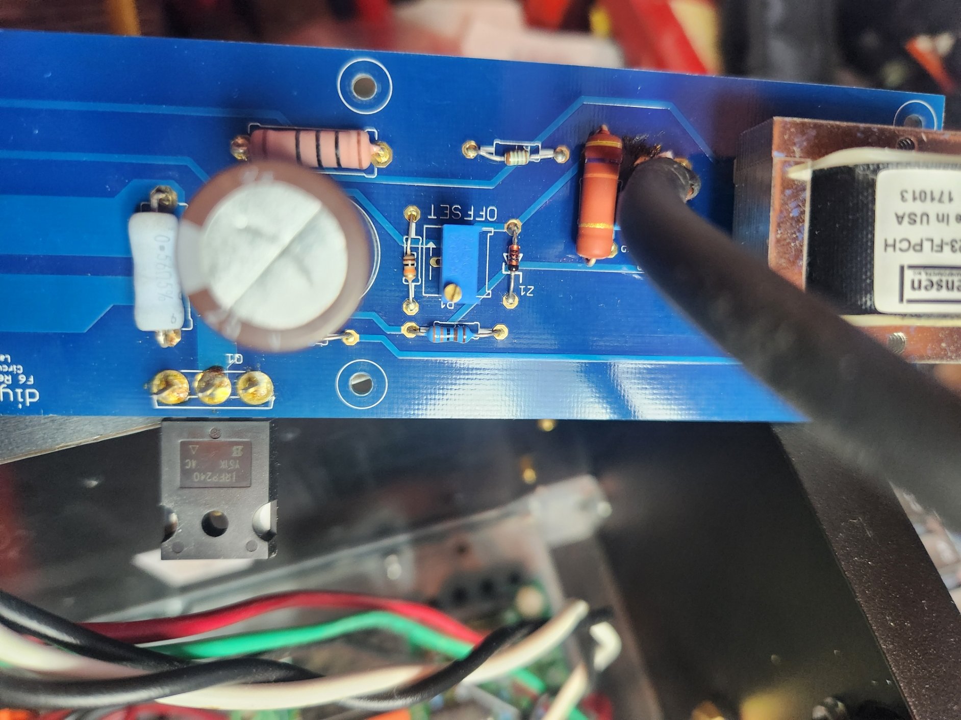

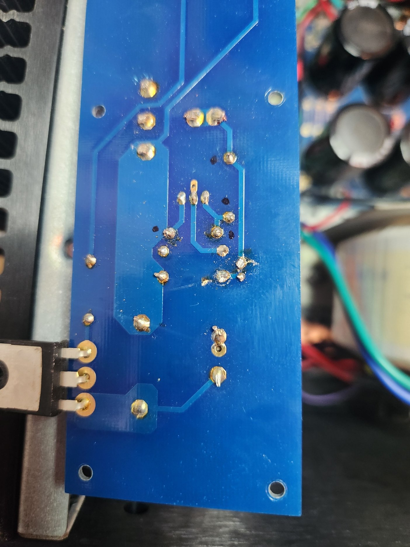

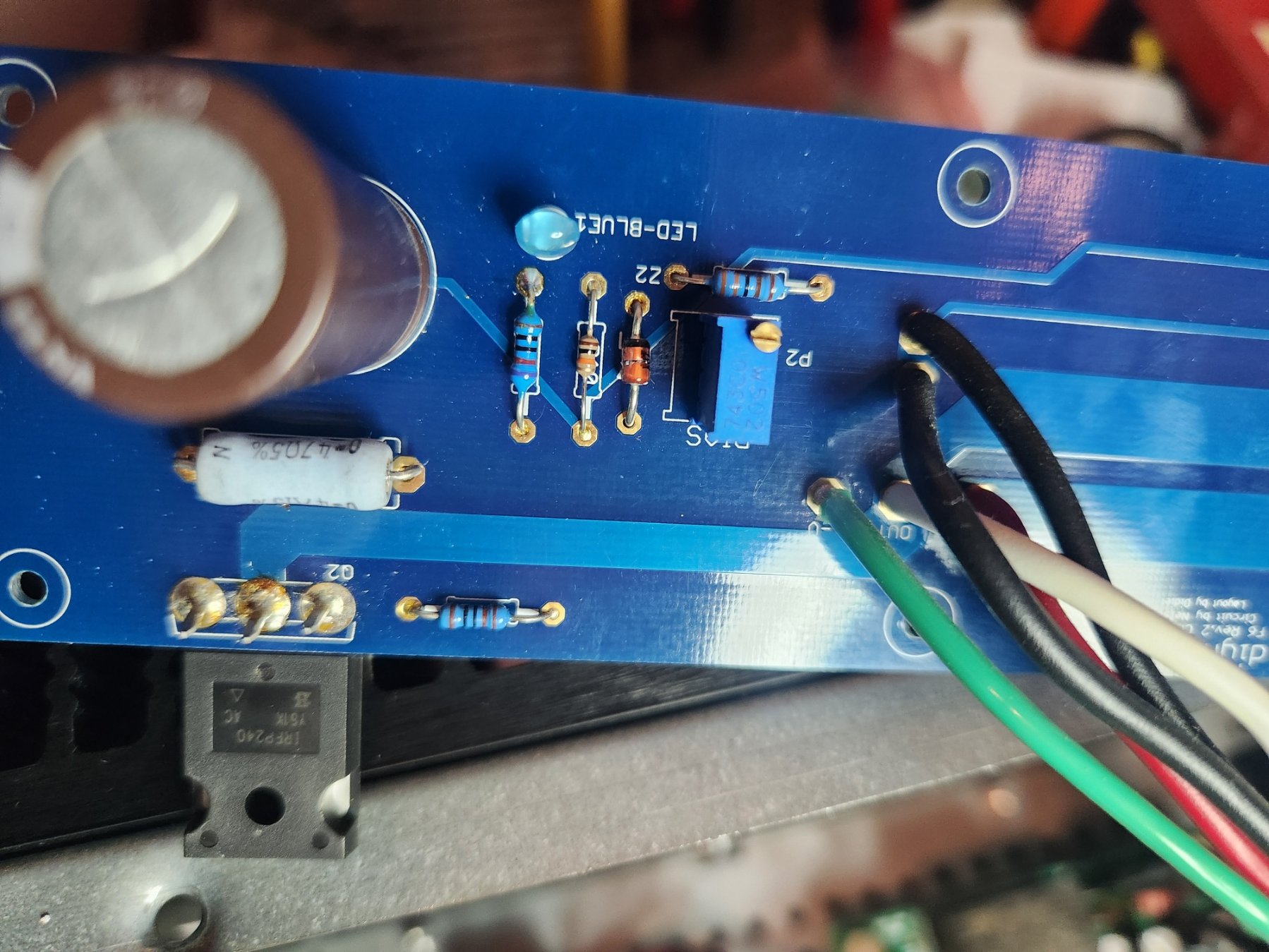

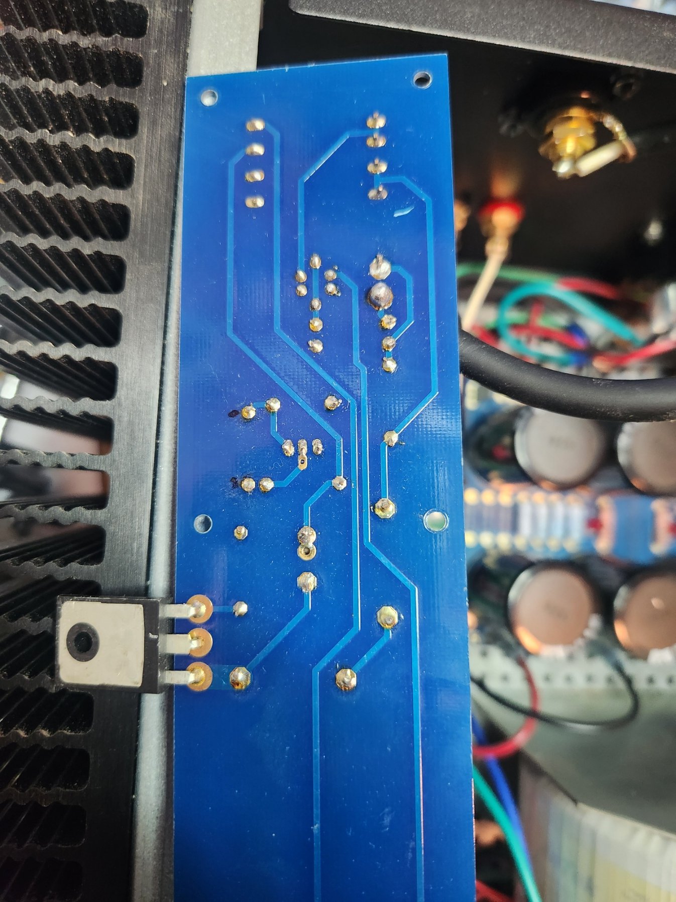

This amp has been running every day for a few years now. Will have to desolder input and outputs to remove the board completely. When I built it one side would not bias up until I replaced Zeners with higher value, cant remember if that was this side for sure. I don't see anything obvious.
