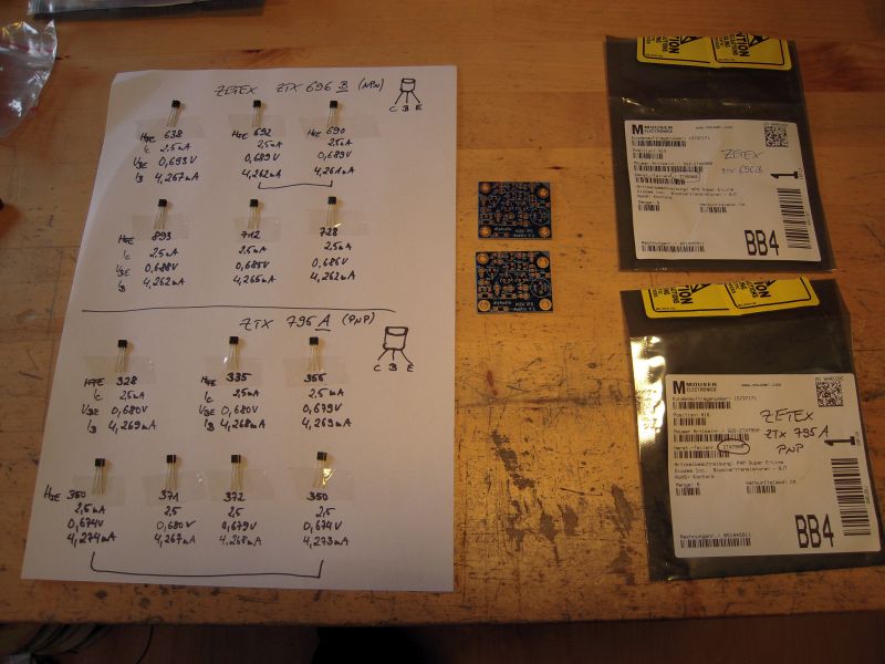

I am building an M2X like you do.
At the moment I am working on the Austin inputboards. I am matching
the ZETEX devices.

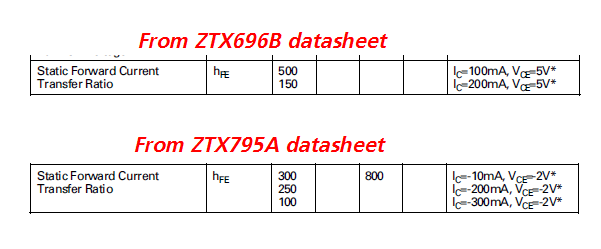

Why are devices used with different hFE from NPN to PNP side?
Zetex 696B (HFE around 600-800)
Zetex 795A (HFE around 300-400).
Sorry for this stupid question - I am not an electronic engineer!
Does the different HFE-factor shift something more to the NPN - side?
Short answer is enough.

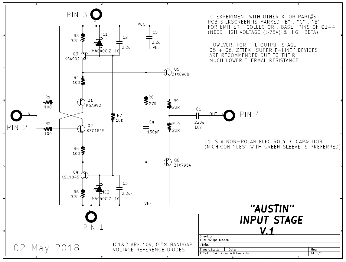

The ZETEX devices seem to be like a follower (complementary devices).
Shouldn't they have a similar HFE?
KSA992 and KSC1845 (Q1/Q2 at the input) seem to be the first stage. (looks like a diamond configuration)
The second pair of KSA992 and KSC1845 (Q3/Q4) seem to be a ccs (together with the LM4040 + R3/R6.

By all means, please feel free to substitute different transistor part numbers when building your Austin boards. To make this a little bit easier, I put recommendations on the Austin schematic itself (upper right), and I included additional remarks in the Notes For Builders (post #4 in this thread), quoted here
2. Transistor Orientation. I expect that many builders will substitute different bipolar transistors in their Austin boards, either to use what they’ve already got, or to “improve” the Austin circuit, or to avoid ordering a new transistor type they’ve never used before, with a goofy sound prefix (KSA/KSC?? c’mon, really?).
So I’ve used a PCB footprint that is circular and symmetric.
It will accommodate Japanese transistors with ECB pinout,
it will accommodate European transistors with CBE pinout,
it will accommodate American transistors with EBC pinout.
In my opinion, the (hFE / current gain / beta) of Austin's output transistors Q5 and Q6, need not be matched. As long as (hFE / current gain / beta) is large, greater than 100, the circuit will work well and sound great.
Of course, the circuit will not perform worse if you do select Q5 and Q6 to have matched (hFE / current gain / beta). So, please feel free to do so if you wish. Buy 20 or 30 of each part#, measure them carefully, and find two pairs with good matching.
However, if you want to choose different devices, I recommend that you ONLY consider transistors in the Super E-Line package, made by Zetex, because that package has superior thermal resistance. This is an important requirement for the Austin output stage transistors.
Please notice that the 220 uF output coupling capacitor "C1" is not optional on Austin (unlike Ishikawa). Any DC offset present at the junction of R9 and R10, is prevented from entering the Edcor transformer primary; C1 blocks the offset. If you are worried about DC offset, rest easy, it's been taken care of.
If you're contemplating a complete redesign of Austin, including a new PCB layout, then you could change the PCB footprints of Q5 and Q6 to accommodate either Super E-Line transistors OR medium power transistors in the hefty TO-126 package. This would give you a significantly larger set of possible transistors, from which to choose your Q5 and Q6. Beware, the board layout is pretty tight already, and this modification would make it tighter still.
I've attached the datasheets of the ZTX696B and ZTX795A, below. I downloaded them from Diodes Inc's website this morning.

Big thank you!
Hello Mark Johnson,
Hello ZenMod,
thanks for your explanations! I have the parts from Zetex and I am looking
for some good matches.
I am relaxed. And I am learning from you.
I understand that the decoupling cap will solve the problem with any offset
at the output of Austin to the edcor.
Have a nice weekend!
Dirk

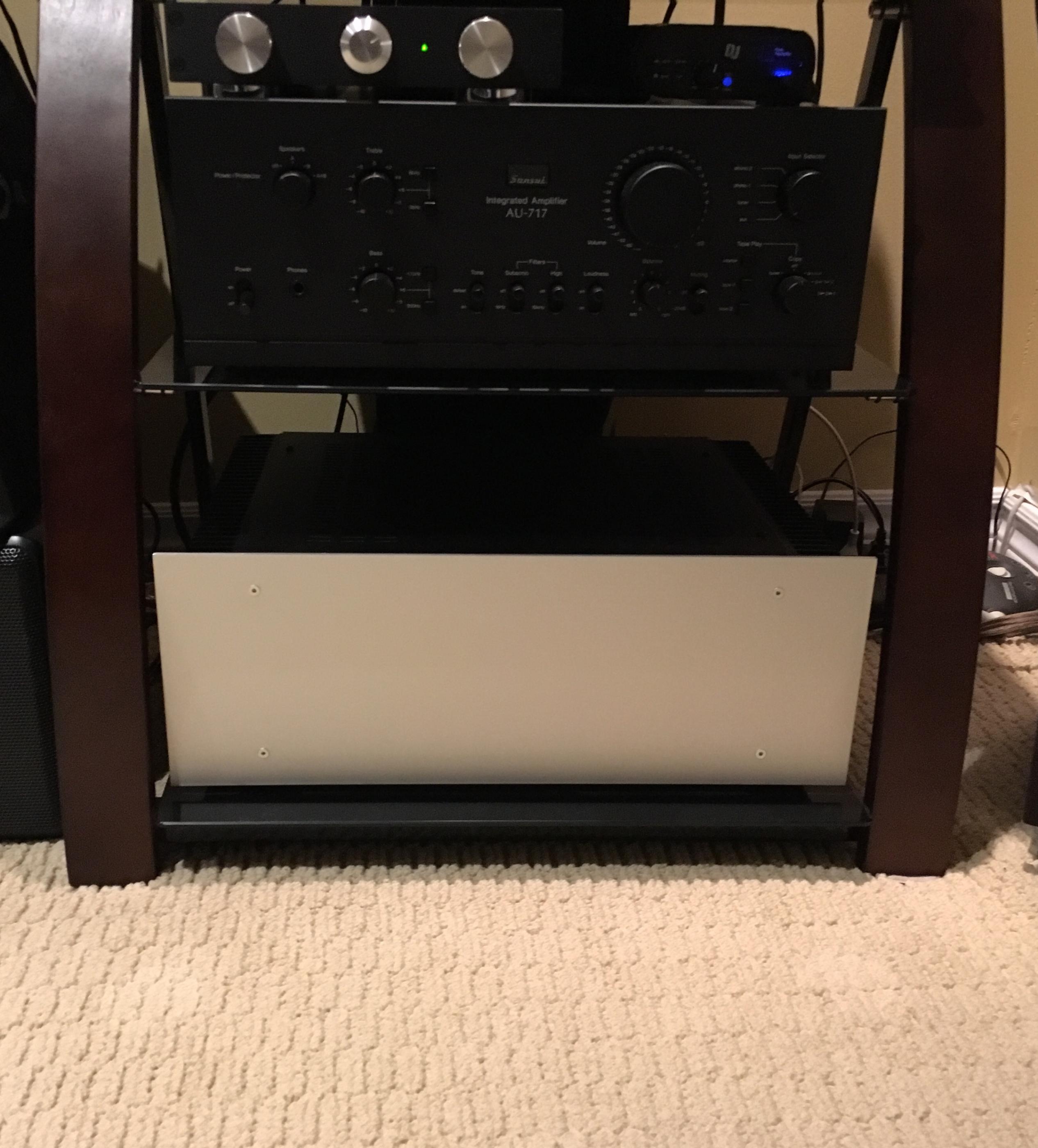

Finally had time to finish off and install the front panel of my M2-X (and put a selector switch on my B1) and get it properly installed into my audio rack. Decided to just go with a plain 3mm aluminum sheet. In the meantime I’ve been listening to it daily and it sounds fantastic! Thanks again to Nelson Pass for creating the M2 and Mark and Jim (6L6) for bringing the M2-X to the DiyAudio Store.

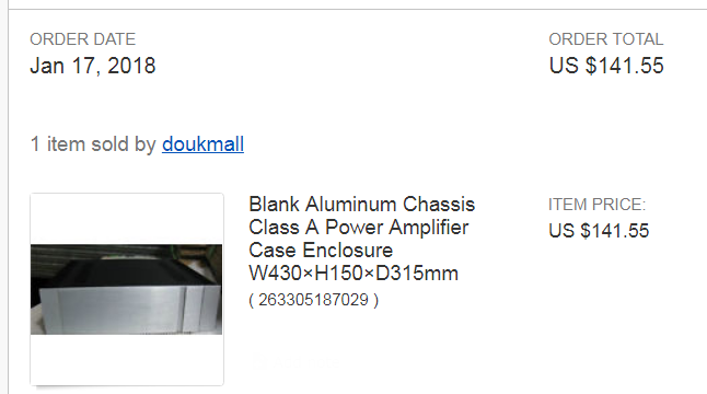

Here is the eBay chassis that I used for an M2x build. Price was $141.55 for the chassis plus $59 for shipping to California, USA. Total $201.55.
I had to drill and tap 9 holes in each heatsink: 7 holes to mount the PCB on the heatsink, plus 2 holes to bolt the output transistors to the heatsink. This drilling and tapping gave me an excuse to purchase a drill press which I had been coveting for quite some time. I also had to make a rectangular cutout on the rear panel, to accommodate the IEC mains inlet module. Drilling & hand-filing took care of that in a couple hours.
It appears the eBay chassis prices have risen, perhaps due to Trade War tarriffs or perhaps some other reason. So the money you save by purchasing a Chinese chassis and doing all the drilling and tapping yourself, compared to buying a pre drilled chassis from the diyAudio Store, is less than it used to be. On the other hand, doing it yourself is fun! And you have my permission to purchase a bunch of new tools, if you think you want/need them. BTW a tapping kit for M3 holes only costs about $25. And a can of Tap Magic is another $7 or so.
