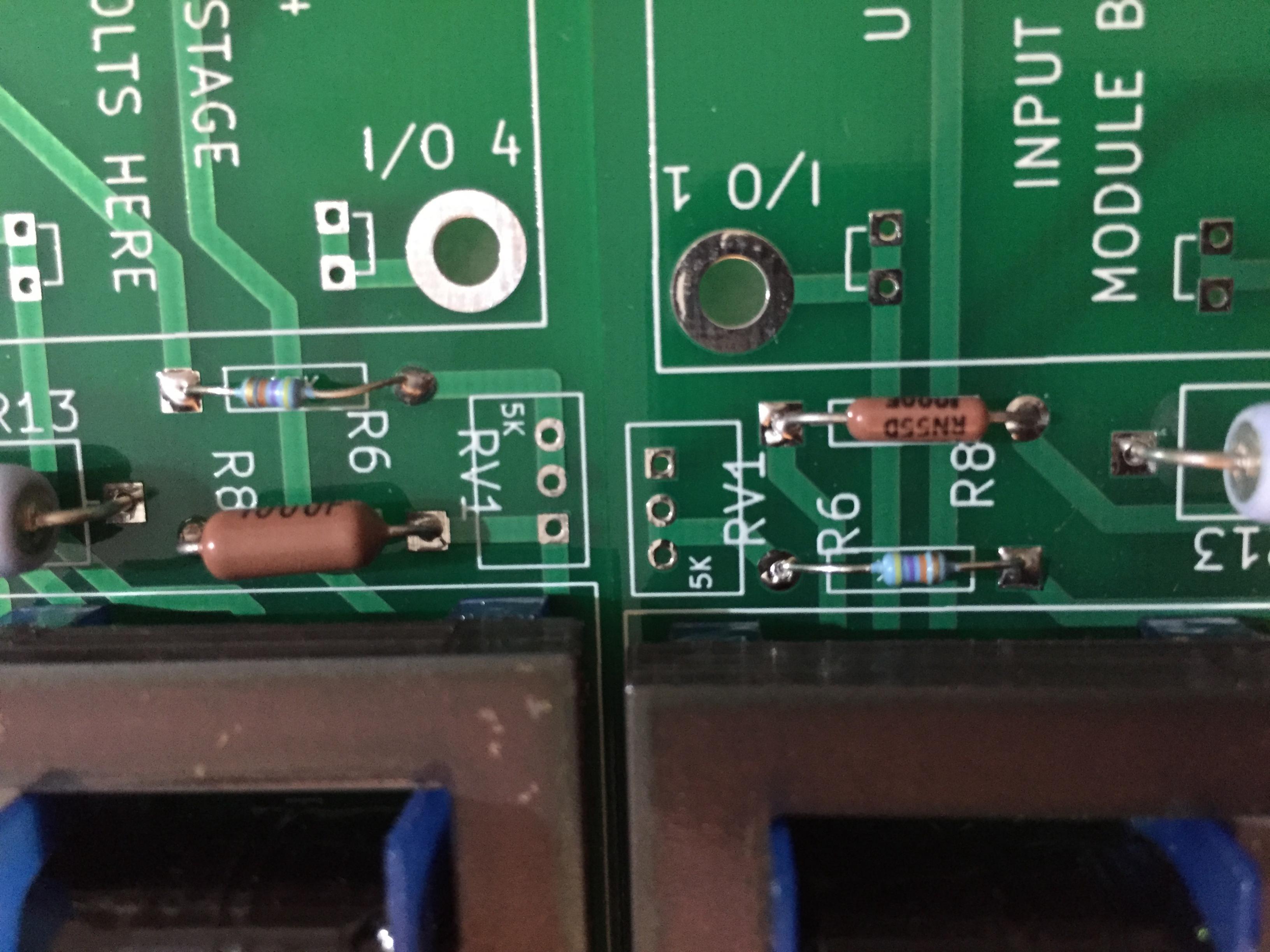

A quick question for mounting of the RV1 trimmer. I have the Bourns 3296W 502 5K value, which is different to the BOM one from a different company. So confused with the orientation where does the screw come (which side)?

I have the same doubt on the Ishikawa daughter board as well with the Bourns 3296W 200R trimmer what is the orientation of 1,2,3 pins?
The PCB are clearly marked;
Opto has a notch shown in the silkscreen outline, the dot (or notch, probably a dot) on the package goes on the side with the notch.
The trimmer silkscreen has a dot on one side, that's where the adjust screw should go.
Photos from earlier in the thread -
Doesn't show the markings on the PCB silk, but you can see orientation of the pots.
As for trimmer on Ishikawa, orientation does not matter.

Coming to the amp boards trimmer 5k I just took the pic and there is no mark/dot to indicate the screw side goes there. Here are the pics from my amp boards.

The mark IS the 5k on the green boards... 🙂 🙂 🙂
And anyway, it doesn't matter which way they go in, they'll still be operational.
