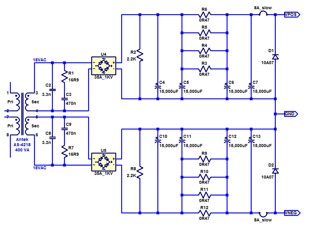

I built an M2x in a "Class A amplifier" chassis with BIG heatsinks, which I bought from eBay. The box was not very deep (front to back) so I laid out a custom PCB to fit standard First Watt power supply circuit, into a wide-but-not-deep area of the chassis floor. My board came out approx 23cm X 8cm. Circuit is shown in Figure 1 below. Receipt from purchasing five of these PCBs is shown in Figure 2 below. Please note: I only paid USD 45 to get five of the boards (!).
It uses off-board bridge rectifiers in the beefy GBPC package, bolted to the chassis floor. Connections between the bridges and the PCB are 1/4" FastOn blades, just like the ones on the M2x amplifier boards.

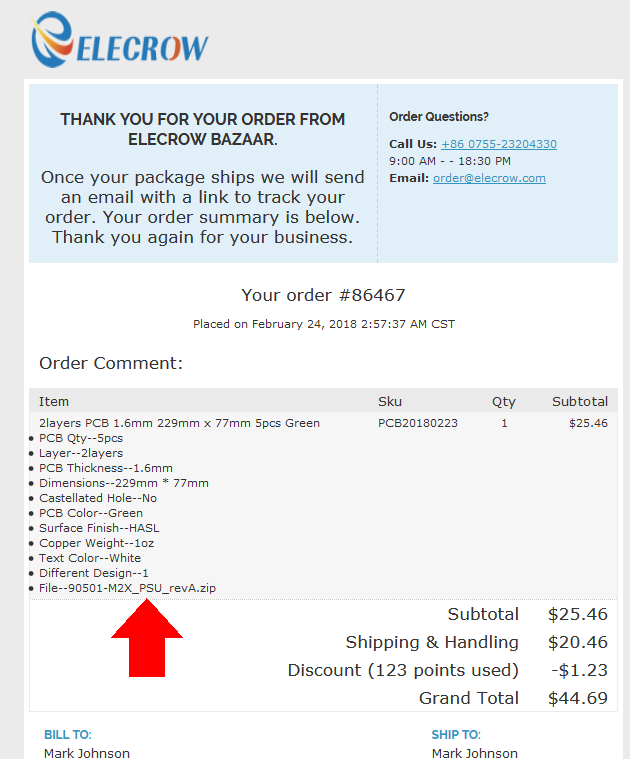

You can see from the receipt that my PCB uses "only" 1 ounce copper (35 um thick). But the traces are wide and I am very comfortable with the resulting current density J. [J = Current / (width * thickness)]. The PCB fab I used, Elecrow, only increases their price by 15% to 20% when you order double thick 2-ounce copper, so an extra double safe PCB, with wide AND thick traces (belt and suspenders) wouldn't be super expensive. However their quoted leadtimes do increase a bit for not-1-ounce orders and I WAS IN A HURRY. As most DIYers are, I imagine.
Executive summary: M2x power supply PCBs need not cost hundreds of dollars. Mine didn't, mine cost only $45 for five boards, and here is proof.

Testing Methodology for M2X Amplifier
Sorry for my inexperience. I am learning a lot and am very thankful for everyone's kind patience and help - with which I hope to be grinning ear to ear soon
Thank you. Based on that, I developed the following, more detailed steps. Perhaps you can fill in gaps/corrections if you could, please?Test PSU without amp channels attached, connect one amp board, test and adjust, disconnect that one, connect the other, test and adjust, if all ok, try them both and listen to beautiful music.
- Wire AC Mains switch to ground and through block/thermistors to the toroidal primaries - Attach AC power to switch, turn on, and test using DMM set to AC on toroidal secondaries for proper (18V)
- Power down and wire toroidal secondaries (blue/green pair 1 -> PSU Diode AC1A/AC1B and blue/green pair 2 -> PSU Diode AC2A/AC2B). I have an assumption I want to check with this wiring. As long as the winding pairs stay together, as it is AC, it does not matter whether the blue or green goes to AC1A or AC1B or vice versa, correct?
- Power up and test both the diode arrays, with DMM set for DC voltage, with red/black to V+1/V-1 and V+2/V-2 to check DC voltages are correctly appearing on output of diode boards
- Power down and connect V+1/V-1 to D+1/V-1 on PSU board and V+2/V-2 to PSU board D+2/V-2 respectively
- Power up and set DMM do DC and re-verify DC voltages are found V+/V- on output blocks on PSU
- Assuming all is good with power to this point, power down and connect, one channel at a time:
- PSU V+, V-, and GND to M2 amp board VPOS, VNEG, & both GND.P points.
- RCA jack center to M2 board INPUT and RCA outer barrel to M2 board GND.I
- Speaker channel red to M2 OUTPUT and black to M2 GND.O or PSU ground for potentially less hum?
- Before powering up to test a channel, and here is another assumption I would like to check, turn the M2 board RV1 potentiometer to the HIGHEST resistance (approx 5K).
- Power up, connect the DMM to some test points and adjust the RV1 pot to get desired reading. I am not sure of the test points/target values, but believe Mark Johnson is addressing this in post #748. I believe I am supposed to:
- "insert shorting plugs to RCA" (Not sure what those are or how to do it properly).
- "Connect a dummy load resistor rated for at least 25 watts..." but how and where exactly to connect it, I am unclear. I also do not shop on ebay and I am not sure I have one or how to make one, if I could - or somehow [safely] test/do without?
- Place the DDM to DC volts and span the speaker posts measuring for zero volts while dialing "the potentiometer RV1 until the DC voltage across the loudspeaker posts is zero." Repeating at least two more times after +1 hour amp warm ups.
- Repeat for both channels and then hook up speakers to hopefully blow my mind, not my amp!

1) Be careful, an open transformer can supply a TON of current.
2) Yes, if the secondaries are properly paired, which can be determined with a simple continuity test, they can be attached to whatever input you desire on the bridges, but you've got to be consistent on both primaries/bridges. If you get them "inside out" you'll blow fuses
3) Yes. This number will be pretty high as you'll be testing a large transformer under no load
4) Yes
5) Yes
6)
.1 Yes
.2 Yes
.3 Speaker ground may be quieter at one of those locations, you've got to test and see. Start with it attached to the amp PCB
7) Nope. Leave it where it is, which is 1/2 way, as supplied by factory.
8) RV1 will adjust the DC offset on the speaker outputs.
.1 Get some RCA males (like on the ends of cables) and electrically connect the outer ring to the pin, which will then make the input + connect to ground, shorting it (the input) to ground. See photo.
.2 Across the speaker jacks. Having the dummy load is not strictly necessary.
.3 Yes
9) Yes.

Thanks for the tip. I didn't bother with them because they look sketchy, and they do not offer 3oz copper. The board I was looking for is much bigger, and is designed to carry a second single rail PS, the diodes/sinks, and circuitry for a micro-controller.
I did a quick compare to EasyEda, they would make your boards for $14.00 + shipping. Might be worth checking out, never used them myself but they are trying to get into the market.
I will definitely consider them if I ever need a small board with 1oz Cu.
Most of the vendors I found that had good reps and get recommended wanted in the neighborhood of $5.00/sq" plus a one time set up fee. One actually quoted me over $1300.00 for 5 boards.
