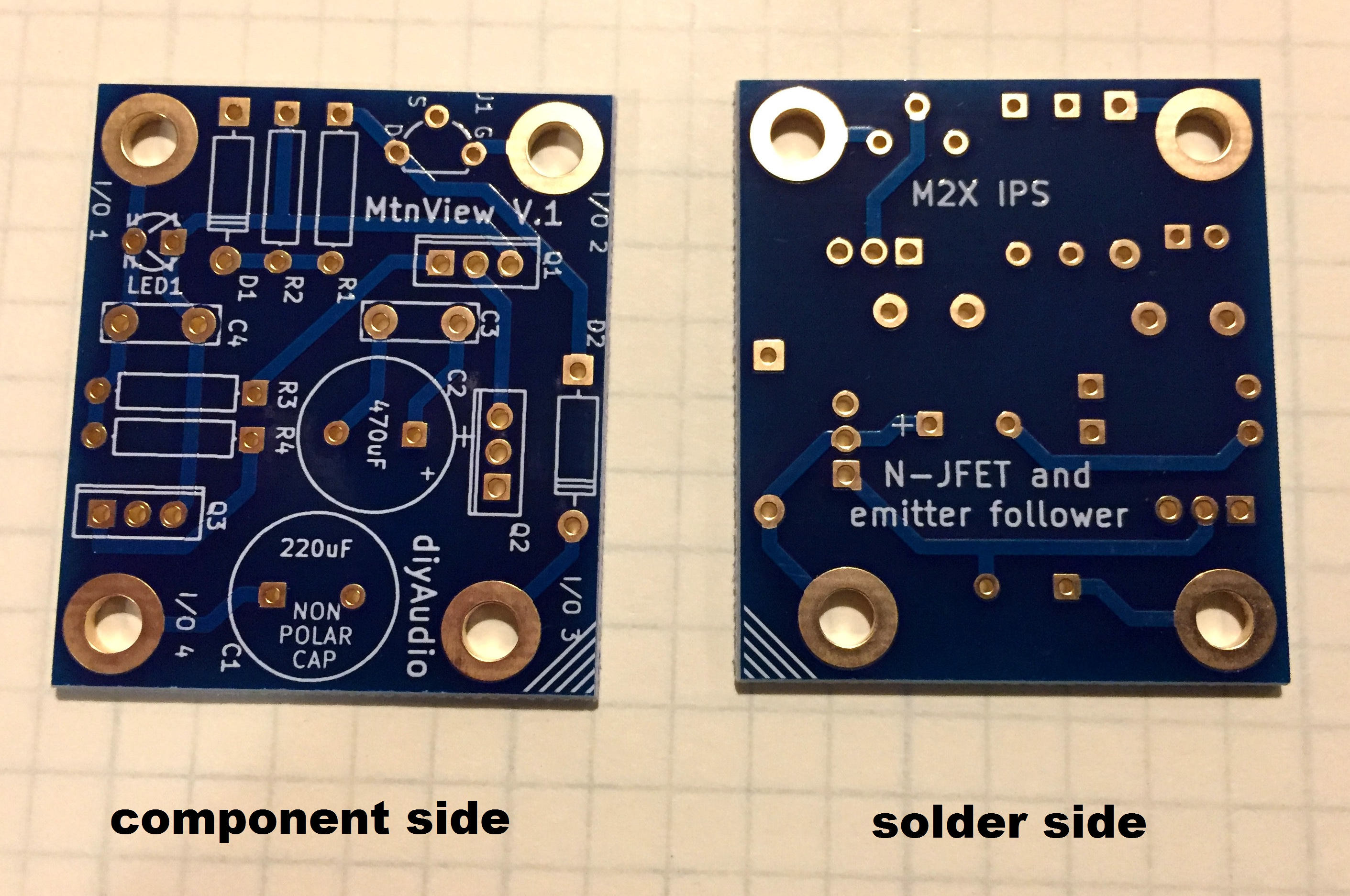

Regarding transistor orientation on Mountain View: one side has a silkscreen with some numbers on it and the other side has a small circle with an A in it. I am assuming that the silkscreen side is the front and should be opposite the PCB double line silk screen. If so, I have a bit of desoldering to do.

I am looking at my completed Mountain View board right not, and I d not see a circle with an "A" in it. So I must assume the "A" is being covered by a capacitor.
All of the boards should have the parts installed on the same side the name of the board.
The builders notes that are in the .zip linked in post #1 gives specific directions on orienting the transistors.

Here is the Mountain View PCB showing both the component side and the solder side. These boards were purchased from the diyAudio store. The epoxy fiberglass is blue colored.
There is a circle on the component side silkscreen, in white paint, where the (cylindrical) light emitting diode "LED1" is stuffed and soldered.
Click on the image and then click on the white cross at bottom left, to see it full size & undistorted.

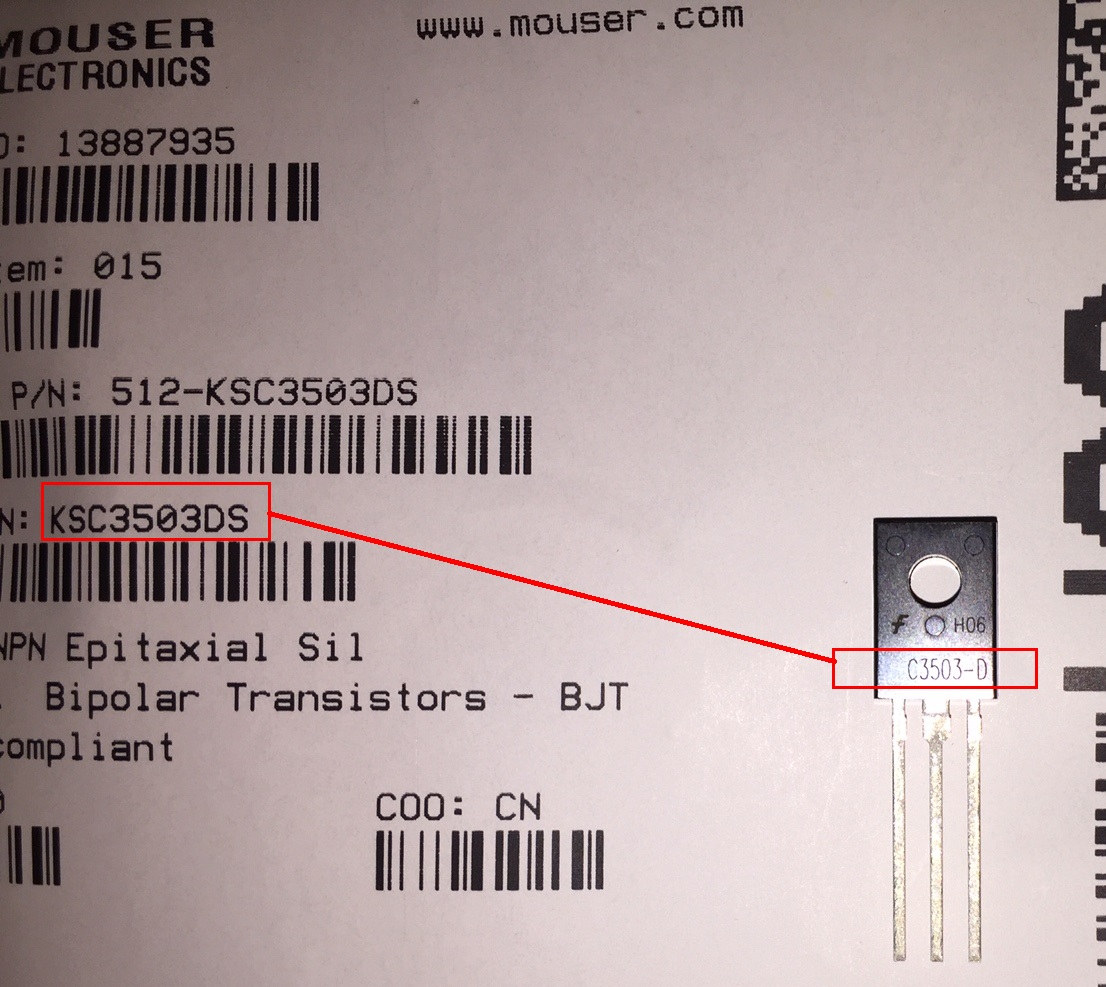

I just realized that wcwc is probably referring to the "silkscreening" on the transistor itself...
From the builders notes
2. Transistor Orientation. Bipolar transistors Q1‐Q3 are encased in medium power
packages called TO‐126. These three parts are marked on the PCBoard silkscreen
as rectangles. Each rectangle has a double line along one of its four edges. That
double line signifies the REAR of the transistor, i.e., the side where the part
number does NOT appear. The FRONT of the transistor is the side where the part
number DOES appear.
Fortunately the phrase "part number" helps you decide which side of the TO-126 is the front and which side is the back. Here is the shipping bag in which Mouser.com sent me 30 pieces of KSC3503DS transistors. I laid one of the transistors upon the label of the bag, with the front of the transistor facing the camera. You can see its "part number" quite cleary. BTW my transistor part numbers are laser etched, not silkscreen printed.

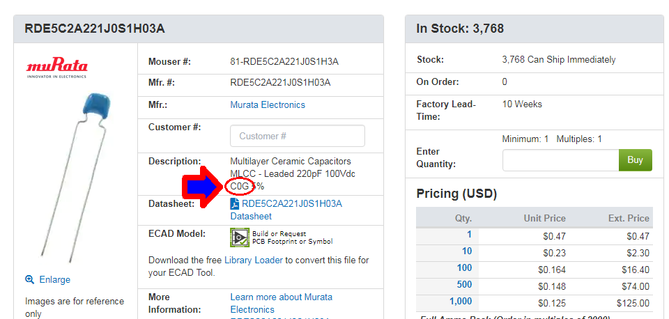

5. Capacitor “C0” is not present in the original M2 amplifier by Nelson Pass. The M2 owner’s manual explains that this makes it easier for tube preamps to drive an M2. However C0 does perform a useful function: together with input resistor R1, it filters (removes) unwanted radio frequency interference. The transformer’s HF rolloff helps too. I suggest that if you’re absolutely certain you’ll never drive M2X with a tube preamp, never ever ever, consider soldering C0 into the amplifier board. C0 is a NP0/C0G ceramic capacitor, 50 volts, 220 pF. Of course you can cut it out later if you change your mind.
In text description of the use of C0, which I believe I do want, it states C0 is 220pF and 50v. The BOM for the board has a mouser part number which is 220 pF and 100v. Which is correct, and is there any directionality/polarity on this and C1?
As long as you make CERTAIN to buy a capacitor whose dielectric is NP0/C0G for capacitor C0, its voltage rating can be anything above 40 volts. So I suggest you get price and availability quotes from Mouser.com or whoever is your preferred vendor, for both 50V and 100V capacitors. Then choose whichever one is on the shelf. If they're both on the shelf and similarly priced, buy the higher voltage cap. If they're both on the shelf and priced very differently, buy the cheaper one. Just be CERTAIN it's NP0/C0G.
*If some dunce applies an input signal greater than 40V to your M2 amplifier, not only will this damage C0, it will also damage the input stage daughter card. Voom! Your $50 Toshiba JFETs on Ishikawa just joined the bleeding choir invisible.
