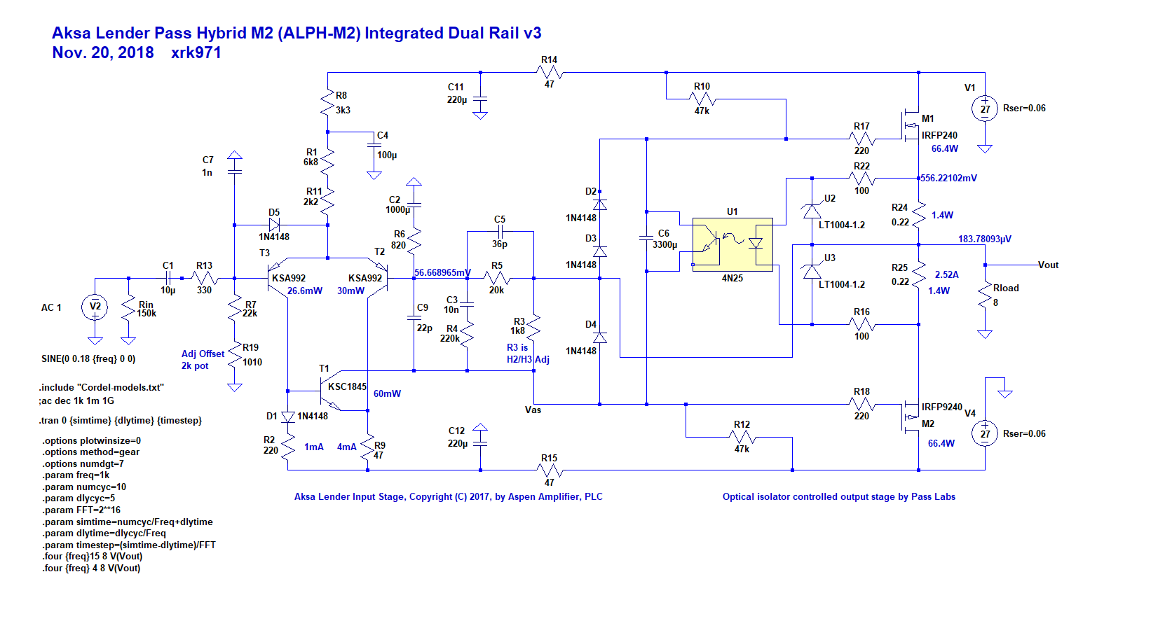

Modification required, connect feedback resistor R10 of a dual rail Aksa Lender preamp (or Melbourne) directly to the speaker output terminal.Would it be possible to avoid the coupling cap between preamp and irfp buffer stage? Something like in the alph-m2 hybrid trad schema but keeping the mosfet bjt output stage of the preamp?
No. More explanation required. Directly connecting the Melbourne (as of presently shown) to an M2 output stage without C2 will disrupt output stage biasing and introduce DC offset at speaker output terminal.The output coupling cap on the Melbourne is optional. It is nominally 0Vdc output. Even with Edcor bypassed, you could even couple directly to the output stage without C2.
what I mean is to integrate it without any coupling cap like you did in one version of the alph-m2
https://www.diyaudio.com/forums/att...lph-m2-amp-alph-m2-schematic-dual-rail-v3-png
but keeping the mosfet mu follower / BJT preamp output stage.

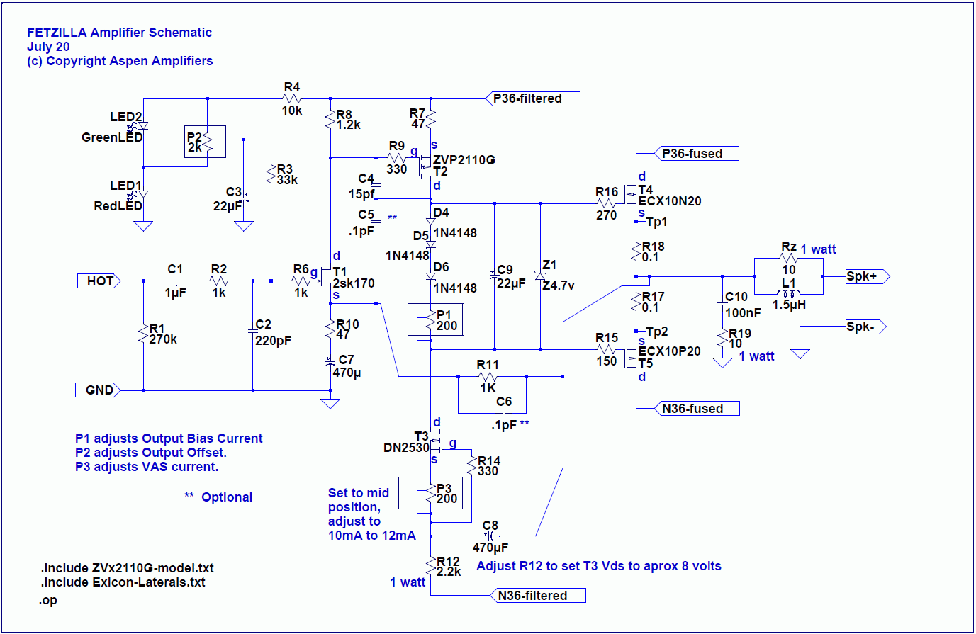

a bit like the in the fetzilla amp:
Yes in this case we have global feedback including the output buffer stage in the loop...
this may lead to a different sound than having local feedback to the preamp only!?

No. The side of C2 connected to the opto is at ~ -4V, not 0V. If feedback is not taken from speaker output terminal, connecting Melboune bypassing C2 will disrupt output stage biasing and introduce DC offset at speaker output terminal. Please verify.... One more thing, with the Melbourne, you can leave out the output coupling caps on the Melbourne and even bypass C2 for a DC coupled drive from the front end to the output stage. The Melbourne is designed to have close to 0mV output DC offset. ...
You are right, my mistake. On the ALPH-M2, I was able to make the output offset by about -5v (adjustable) and thus, was able to bypass the C2 cap. It would take some tweaking on the Melbourne DC setpoints to get it to have a -5v DC output. Not worth it so let’s keep C2. If one wants DC coupled then just go wth ALPH-M2.
I hope that the ALPH-M2 V3 or maybe a V4 with the mosfet mu follower / bjt buffer stage (same as Melbourne ) will have same performance as the Melbourne card
Latest sims of V4 here and they look very decent. Using bootstrap caps on output MOSFETs, separate rail voltages for input stage. We have a 39Wrms capable amp with 27v rails.
Simulations here:
https://www.diyaudio.com/forums/sol...ass-hybrid-m2-alph-m2-amp-10.html#post5616853
Here is 8Vpp into 8ohms at 1kHz:
And here is 22.6Vpp into 8ohms at 1kHz:

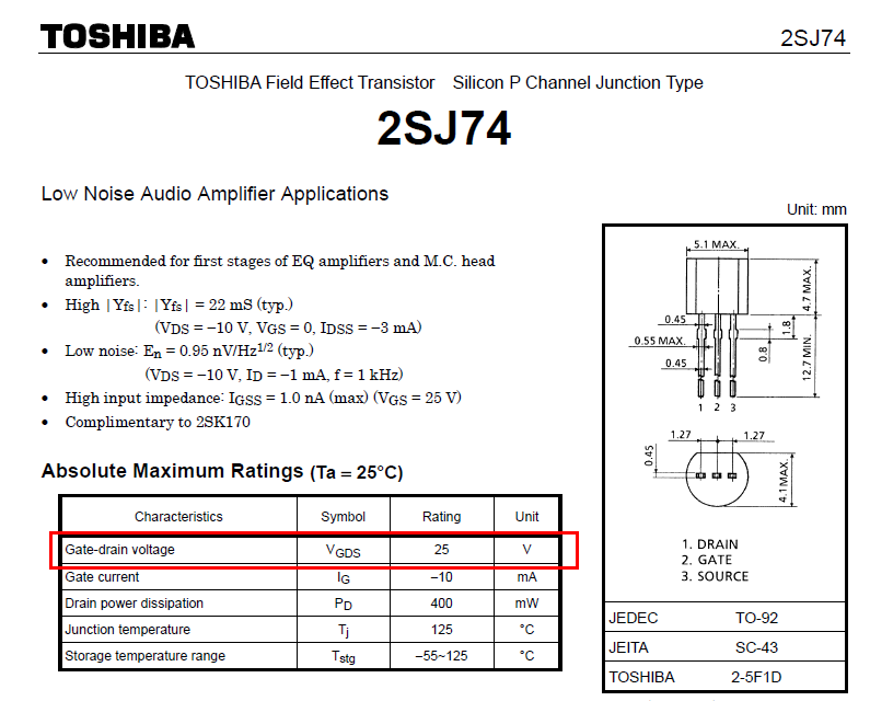

Running the M2x main amplifier board from ±27 volt power supplies, will prevent owners from using all of their existing daughter cards that are designed to the First Watt M2 power supply spec: dual 18VAC secondaries + bridges + CRC filtering, giving ±23 volt supplies.
One of the daughter cards users cannot connect to a ±27 volt M2x, is "Ishikawa", thanks to the limitations of its Toshiba JFETs. Datasheet below. I assume you'll issue a complete list of approved and disapproved daughter cards for ±27 volt operation.

While it is a danger, the Toshiba parts are conservatively rated. 6l6's build guide used 24 + 24 volt transformer (I did as well) which results in 30-31volt rails. Mine has run for years with no problems. This is, obviously over the advised limits. Seems like I have read somewhere on this forum they burn as 40 volts is approached, way past safety zone....I have NO idea if the L.S. versions from the store are this robust...I have only used Toshiba to 31 volts.Running the M2x main amplifier board from ±27 volt power supplies, will prevent owners from using all of their existing daughter cards that are designed to the First Watt M2 power supply spec: dual 18VAC secondaries + bridges + CRC filtering, giving ±23 volt supplies.
_
Russellc
You don't mean his build guide for the M2x, do you? That guide is only a few months old.
No, sorry I didn't say which amp! This was his build guide for the BA3 amplifier.
Sorry, but same Jfets....Toshiba. Have not done this with the L.S. Jfets.
