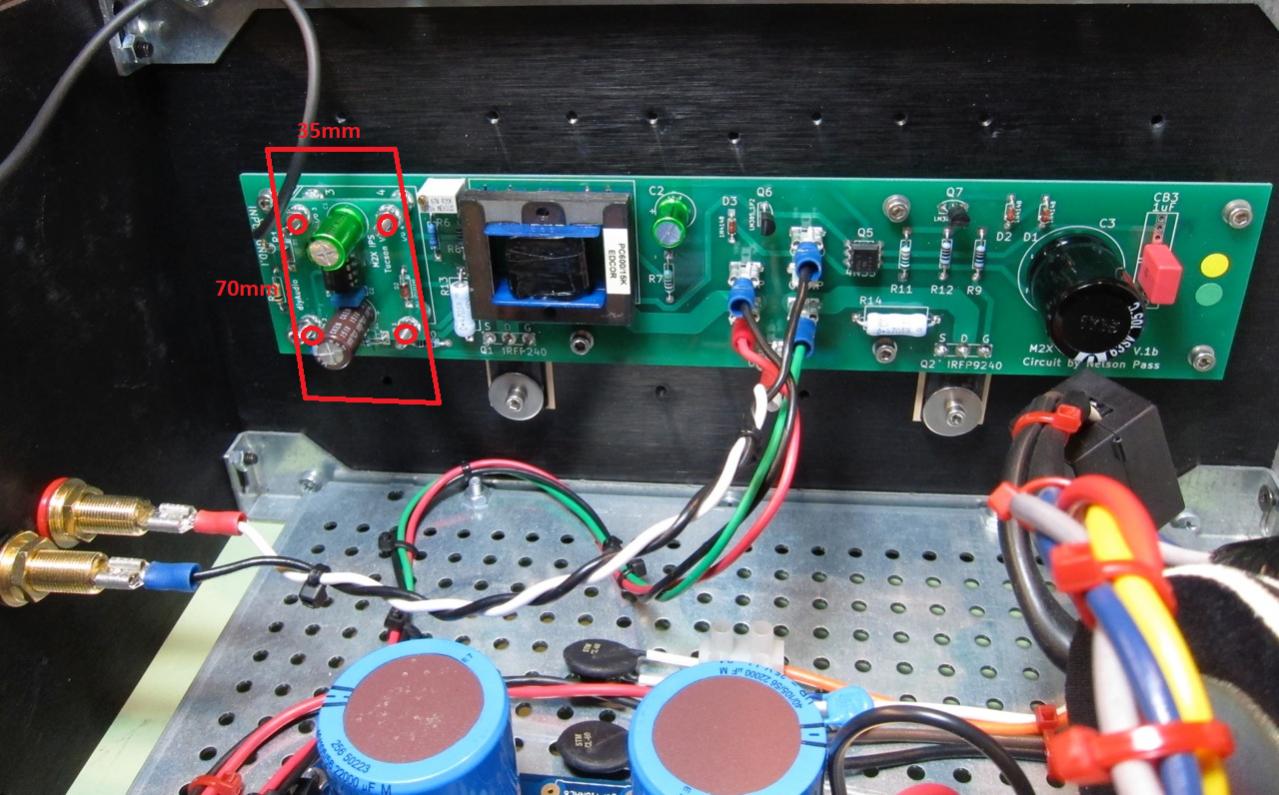

Frenchy,
I do not as of this moment have an M2X yet. I have a Teabag M2, which I modified by bypassing the Edcor and drove it with an externally mounted Aksa Lender preamp (same preamp as the "Melbourne" M2X daughterboard). This is described here:
https://www.diyaudio.com/forums/sol...pass-hybrid-m2-alph-m2-amp-3.html#post5604098
I found that it sounds great. This was the inspiration to make an M2X DB form factor for others to try the same preamp easily. You can of course, leave the Edcor in place, and it will work. But it is also easy to try without the Edcor and see what sounds best to your ears.
Here is FFT without Edcor in place:
I ordered the M2X boardset and it should be here in a few days. The mew Melbourne DB PCBs should also arrive in a week or so and I will build them all up and test it out to make sure it works before offering the Melbourne in a separate GB.
So basically I am taking the Aksa Lender preamp (shown here in stereo with built in power conditioning cap Mx and CRCRC):
And shrinking it down to one channel that looks like this:
So that it can fit here:
Both through hole and SMT versions of the Melbourne will be offered.
I think the M2X is an excellent modular design amp and perhaps more amps should be offered this way with one's choice of input stage and choice of output stage. Within the Pass Labs, there are about 3 or 4 output stage topologies that come to mind: opto-coupler controlled bias push-pull (like M2), there is the Aleph dynamic CCS, there is the F5 style push pull with NTC bias regulation, and probably many others including simple MOSFET follower like the MoFo. They all have their signature sound. With the Aleph having been modifield to accept the Aksa Lender front end and have a PMOS on the output in the so called, ALPHA amp. I look forward to building the M2X and listening to the various input stages.

Would it be possible to avoid the coupling cap between preamp and irfp buffer stage? Something like in the alph-m2 hybrid trad schema but keeping the mosfet bjt output stage of the preamp?
The output coupling cap on the Melbourne is optional. It is nominally 0Vdc output. Even with Edcor bypassed, you could even couple directly to the output stage without C2.
