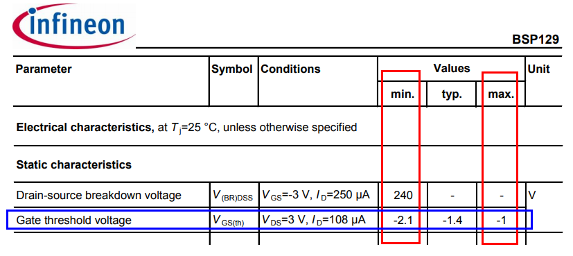

... No [BSP129 current source] trim needed for bias - it is pretty steady and consistent with source resistor(s) used to set it.
I'm surprised but, if you've measured it, you've measured it. Mfr datasheet below.
The SMD package means a greater inconvenience for builders if you ask them to measure GateThresholdVoltage and discard units outside the range (YourValue1 <= GateThresholdVoltage <= YourValue2). It's inconvenient because the SOT223 package is more difficult to connect to a low cost curve tracer, or to a homebrew Depletion NMOS measurement jig made from a scrap of Veroboard.

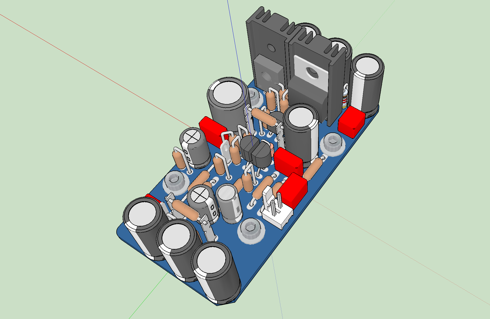

A TH version will also be available, standby... DN2540 will be used for depletion mode and it is TO-220.
I so appreciate efforts, and especially providing TH boards. Love the fact can be Amp front end or stand alone preamp...I intend to do both...cant have too many preamps in this house.

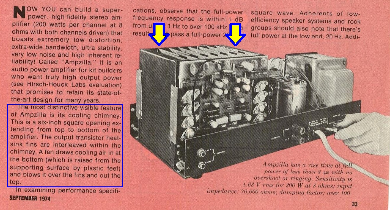

How could I forget James Bongiorno's AMPZILLA from 1974?? It made quite a splash and launched several companies including G.A.S. and Sumo.
Ampzilla had a tunnel heatsink plus fan, mounted vertically. Because the tunnel was rectangular, and vertical, they decided to call it a "chimney". Here is the first page of the circuit design article, in Popular Electronics magazine. I have added little arrows to the photograph, so you can quickly find the chimney.
