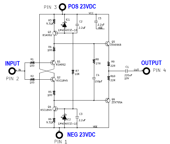

Yes I agree, there are only four I/O terminals on an M2x daughter card.

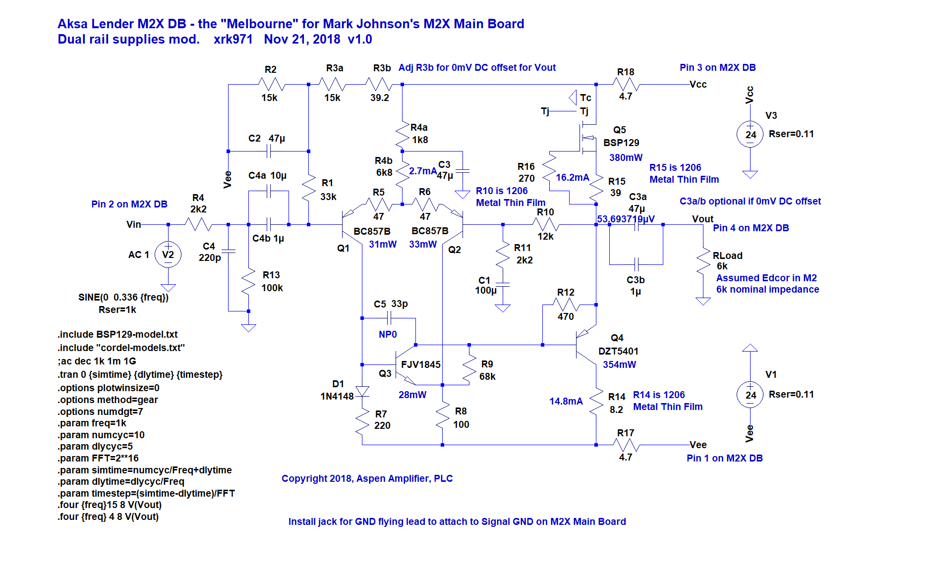

I revised the single rail schematic for dual +/-24v supplies. This input stage will require a flying lead connection #5 to the M2X's signal GND lead (somewhere on the M2X, TBD).
Here is the schematic, now revised for 0mV DC offset at the output - thus the output caps are optional and may be bypassed with a jumper:
attachment.php
Here is predicted FFT for 4vpp into a 6k load (label on plot says 2vpp and is incorrect, someone correct me if I have assumed incorrect load impedance presented by Edcor):
attachment.php
The predicted distortion components are quite low for 2vpp into 6k with THD around 0.0004% and all of it as second harmonic:

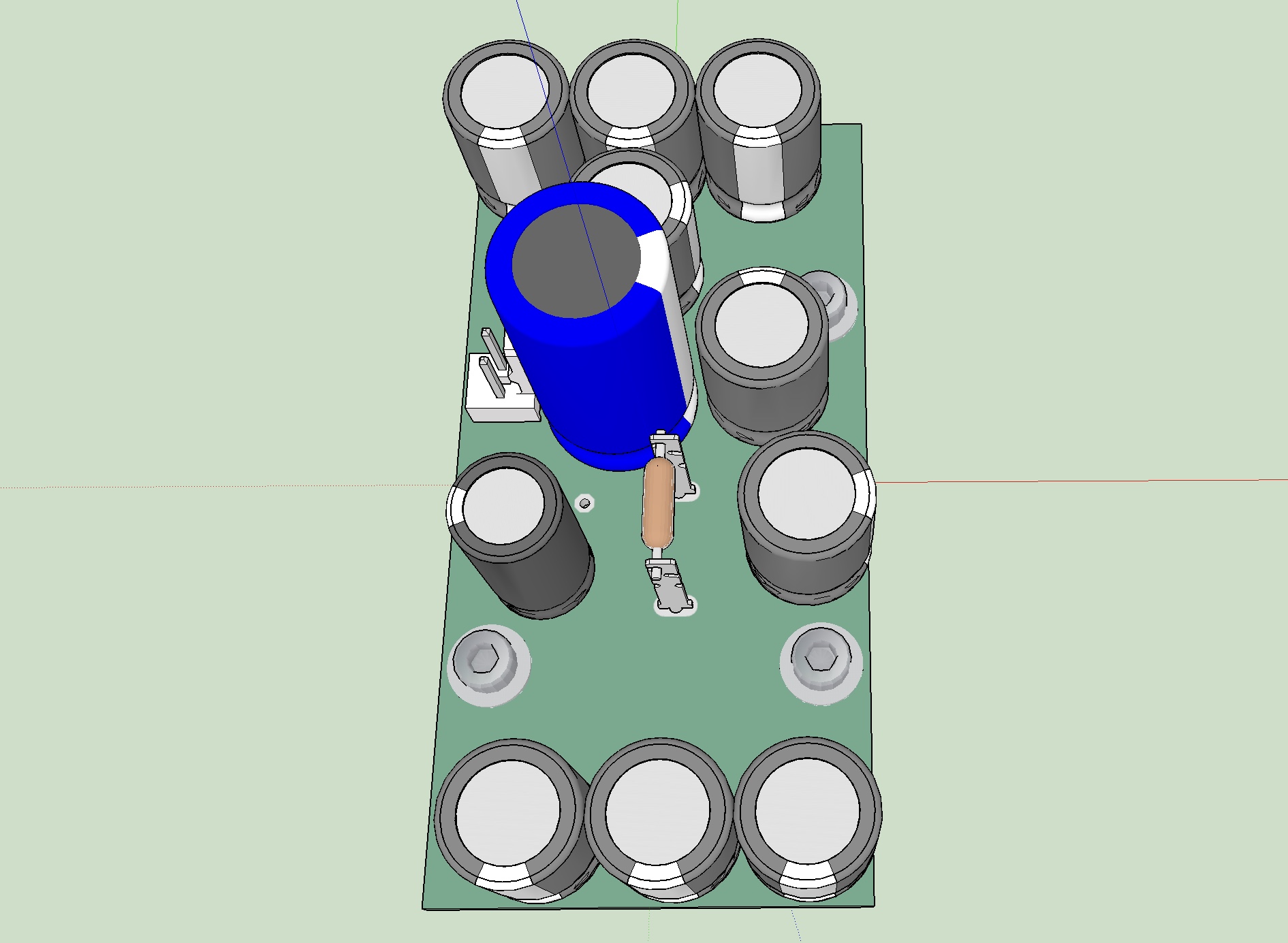

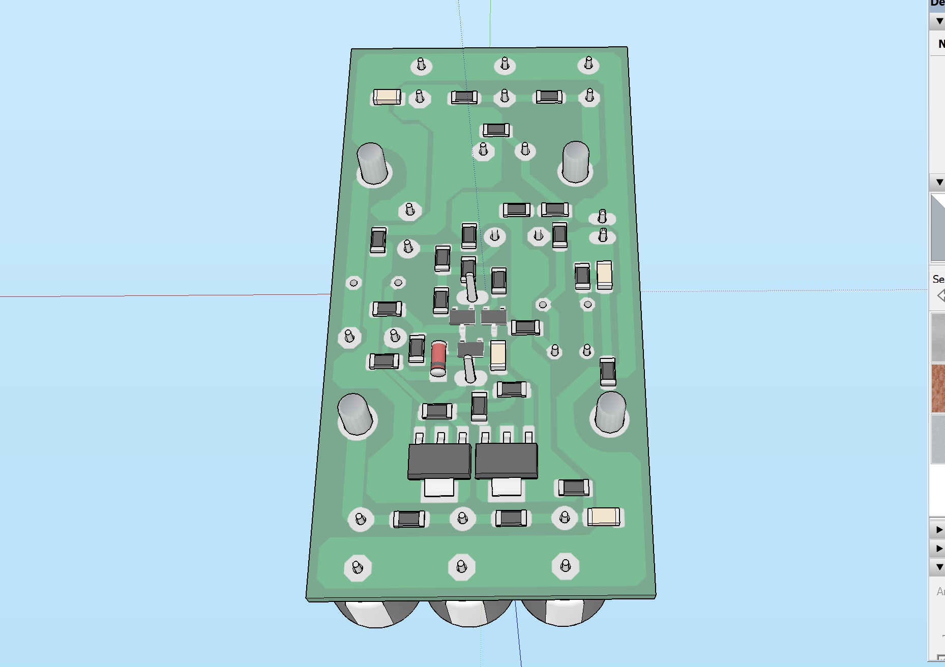

Here is an initial 3d render of the TH version of this board, although I think an SMT version using 0805 and 1206 chip resistors with SOT23 and SOT223 might be much easier to make as I hate assembling stand-up axial leads. But if the TH version is possible, we will go with that as most folks seem to prefer it for assembly.
attachment.php
A mezzanine board can be made with qnty 6x 470uF 35v (10mm dia x 20mm tall 5mm pitch) caps and 10R resistors. It will take the typical 12mV ripple seen on these types of Class A PSU rails and reduce to under 0.5mV ripple.

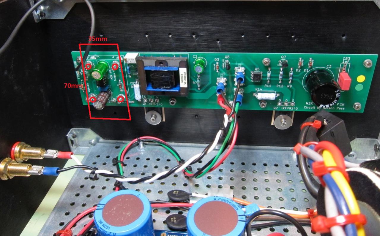

Very cool to see another DB in the works for the M2x. These possibilities are what made me choose this amp. While tempting to create DB's to match the originals' outline, they can be quite a bit larger in some directions as long as the mounting holes align.
X,
If you look at the first two pics in post # 2 of this thread, you can see the R&L main boards very well and their DB connections. Scroll down in the same post and you will see an assembled board mounted to a heatsink. That mounting looks to be what I would consider typical, and would allow easily an inch or more in the vertical (extending outward from 1-2 and 3-4) and horizontally outward from pins 2-3. You can't go horizontally in the direction of 1-4 because of the potentiometer and autoformer.
You could conceivably go much farther out, but there will be no structural support beyond the 4 mounting pins unless you expect folks to use additional mounting hardware.
Though probably a non-issue for most folks, a DB oversized by much more than a few mm may require that the main board be mounted to the heatsink before the DB is attached unless you provide cutouts for the main board hardware.
If you would like particular measurements, let me know. My boards are unstuffed at this point and I can easily measure anything you like. As well, I could scan them in "mounting position" so you can see just where things line up.
Tsmith1315,
Thanks, I see that this photo indeed shows it mounted in what looks like a 4U x 300mm UMS heatsink case. There is plenty of room and perhaps all I need is another 15mm on top and bottom edges for overall 35mm x 70mm to fit everything. The dimension that goes towards the end away from Edcor is possible too but would mean DB has to be installed after main board in installed. Let me think about it.

Mark Johnson informed me impedance of Edcor in M2 is actually closer 600ohms, so here are sims with 600ohm load for 4Vpp - nothing in circuit changed. The bias current could be increase to allow driving impedances as low as 32ohm headphones if needed.
attachment.php
Predicted components:

If I may make a strong suggestion, please do not extend the daughter board past the edge of the main board on the mosfet edge. Doing so will prevent the option of mounting the board horizontally (like the original M2).
You mean like the Pass Labs M2? I don’t really see anyone using a UMS compliant board for these types of sinks? Will let JPS64 decide that as it may be to hard to shift overhang all to one end.
Also, note that overhang would be above main board, and would actually fit in this case. The Edcor transformer even is extended a bit.
The board can still be mounted horizontally to the DIYAudio heat sinks, it will just require a frame to be fabricated to support it. Not much effort for those of us with a shop full of tools.
There are good reasons for doing this. What most appeals to me is being able to reach the underside of the board with out removing it, and not having to put my hand deep into the case to adjust the trimmers. It will also allow the use of a shorter case since the torroid can be mounted horizontally, giving more flexibility to heatsinking for folks considering water cooling or fans.
Also, the channel B board has R5 and R10 pretty close, and an oversized daughter board will have trouble clearing them if 1/4W parts were chosen (taller standoffs will fix of course).
Given the design of the main board, the only "safe" direction to expand is off the side opposite the power transistors. I expect one could overhang it 20mm or so easily.

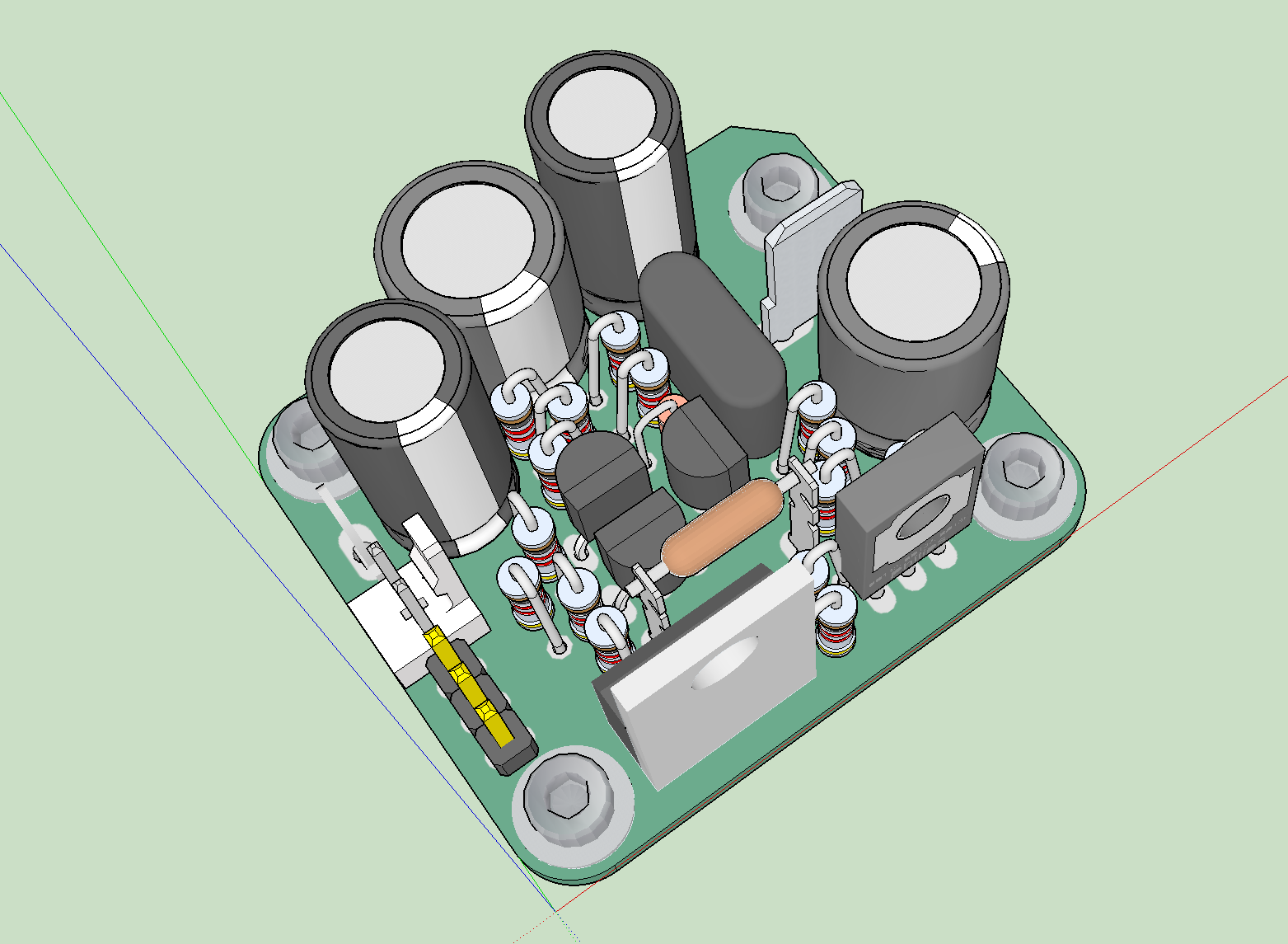

Here is an initial 3D render of the layout - sorry but JPS64 did this before we got the request for offsetting it just to the side opposite of the MOSFETs. Would this require two different DBs due to symmetry or same offset towards pins 3 and 4 isnok for both channels? First version is SMt plus through hole electrolytic caps.
