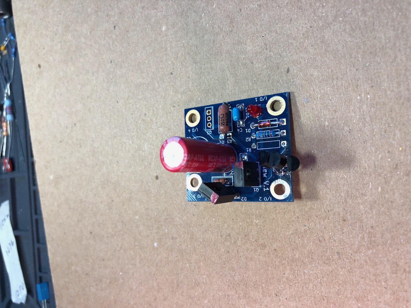

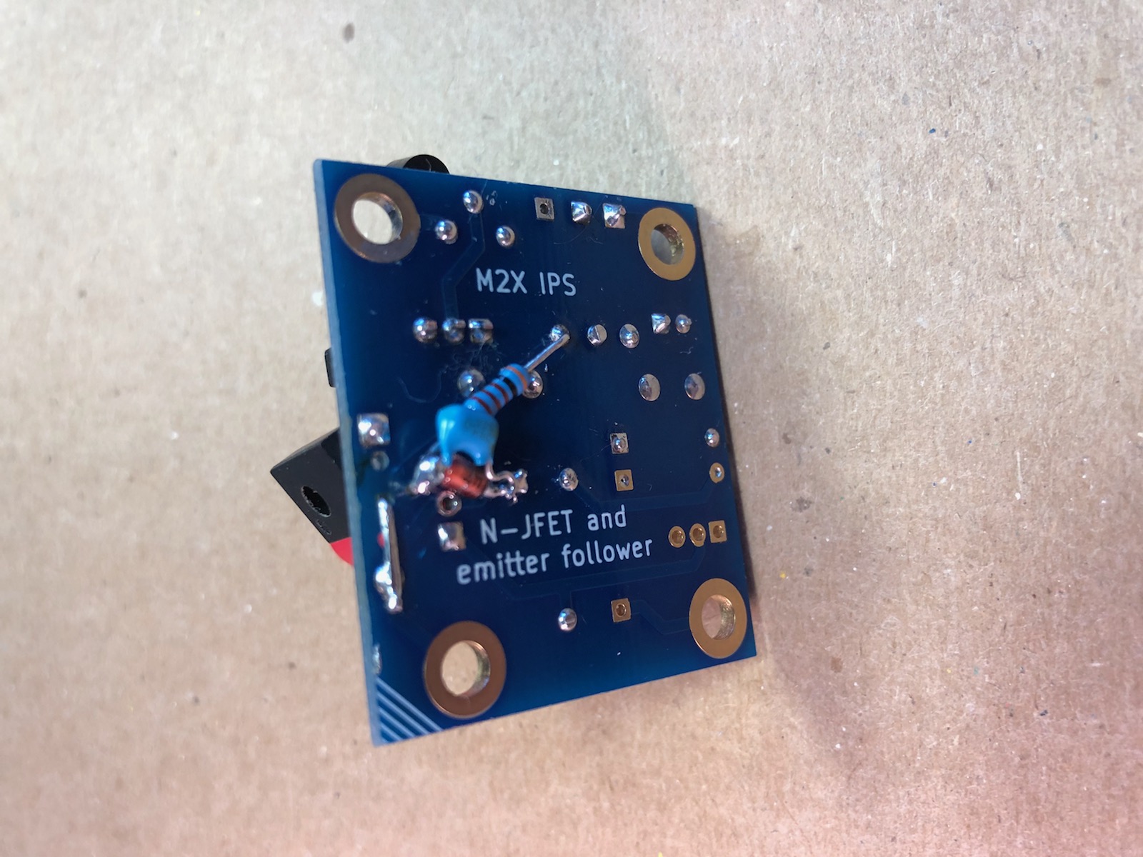

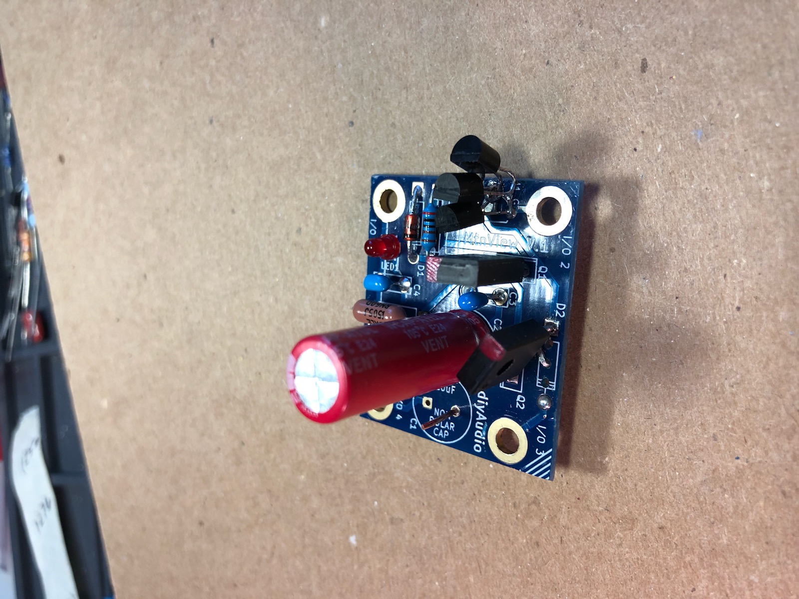

The 30mA version of Moffet Field looks great on a 'scope and runs reliably for days. 1 MHz square wave looks great. I'll post schematic and info tomorrow with another much simpler version at 24mA.
In use, there is a small heatsink on Q1 and both BJT's are Toshiba TC004B which has a higher, flat gain curve than KSC3503 at that current.

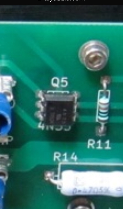

Any way to determine the orientation of the octocoupler? There is what appears to be a circle in one corner of the octocoupler. I would guess that this is over Pin 1 and that I am to align this with the notch indication on the circuit board.
Hi Wcwc, yes the circle in the corner should match the end of the screening on the pcb. In the picture below taken from the first page of the thread you can just see the circle you’re referring to and the rectangular notch on the screening below it. It’s a little blurry, hope it helps you out.

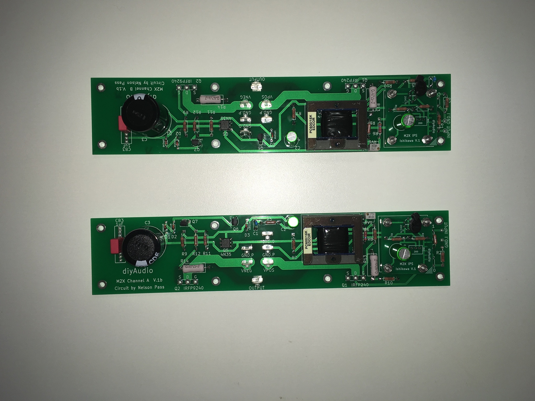

Here’s another pic of my completed boards before the output transistors were soldered on. Good luck, and have fun with your build.

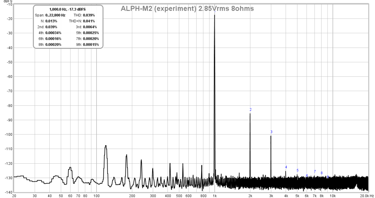

I've build and listened to all of the cards, except for the Norwood, and in my opinion they're all worth building and evaluating. Not a bad one in the bunch. To me, differences are slight and the the dominant voice of the amp is set by the Edcor and everything else downstream.
This is very true because I have now heard the M2 without the Edcor and for me, the sound without it and with an Aksa Lender Preamp doing the voltage gain was truly unbelievably more dynamic, clear, and noise free. The noise is now measuring under 100uV and the amp sounds the best that I have heard it sound after nearly 2 years of messing with it.
Here is the M2 with JFETs and Edcor:
610806d1491806355-strange-forest-noise-linear-psu-m2-fft-1khz-8.0v-8ohms-right-channel-no-preamp-linear-psiu-no-cap-mx.png
And here it is, sans Edcor and Aksa Lender doing the voltage gain:
716129d1542499116-aksa-lender-pass-hybrid-m2-alph-m2-amp-alph-m2-experiment-2-85vrms-8ohms-fft-png
I think having a level of third harmonic that is much lower than the second and absence of higher orders is a much more refined and pleasant sound. The overall reduction of THD is less of a concern as the distribution is much more audible. So if you are looking for ways to experiment with the sound, try bypassing the Edcor with a jumper. It’s a simple and reversible mod.

It seems to be bit of an improvement without the Edcors. I am building the BA-3 pre so it could be something for me also. How does your schematic look after the bypass? ….you also bypass the "compensation circuit" for the Edcors? …...what about C2?
To XRK971:
More details here.
AKSA Lender Pass Hybrid M2 (ALPH-M2) Amp
Basically, I cut the traces after the Edcor and before the JFETs. Then junpered the input to C2 (10uF Silmic II). I then drove the Silmic from a stand-alone Aksa Lender Preamp. But what I did has same effect as schematic in post 1 of above thread.
